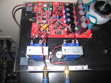

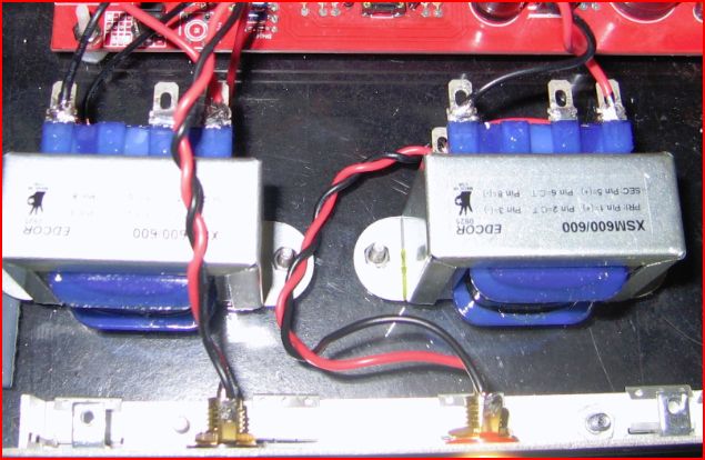

Hi Guys,
I think this is the one you've been waiting for, Edcor transformer, XSM600/600, $ 12.94 each. It's very cheap and everybody can afford it, especially like me that doesn't have much money.
How about the sound? It's definitely terrific! better than the opamp, IMHO. I haven't tried comparing with another transformer since I don't have any and that's the first one I have. I measured the DC offset and it measured 0mV, nothing to worry about. I haven't tried filtering yet but I might try Legarem's combination.
I think I'm beginning to believe on burning process, which before I don't but I think it works. Why don't you guys give this tranformer a shot. It won't hurt your pocket. You may like it or you may not like it, it's up to you 😀
Sorry the image is too small, that's the maximum size I can post.
Good luck!
