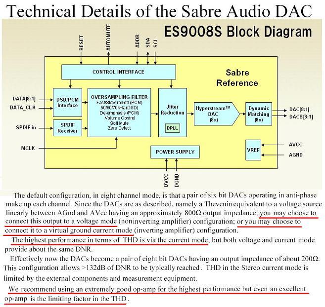

Can you clarify this for us. Unless I am mistaken, the Buffalo is a current out dac so you are using a tube circuit for the I/V conversion, then you are feeding that to the trafos. And you need two more trafos for what? Doesn't sound simple. What is Tamura's output impedance?
Best, Bill
The Buffalo DAC 9008 has two modes : current and voltage, you can connect it has you want
It has an output impedance of ~190 Ohms ( Twisted Pear Audio board configuration )
So I connected it as another voltage Dac, CS4398
Regarding Legarem's advice (Thanks !) about the loading ratio of 1/10, I connected the dac + 600R primary 600R -
a 1,5nf capacitor is across primary
Secondary is loaded with 600R only (must test RC network)
This is my first configuration , have to test other values as filters
Sound is natural, details and bass are there !
R.C.

In a voltage DAC, like CS4398, Buffalo, there is offset between + and Gnd, - and Gnd
There's no offset between +-, (already said by LeGarem I think )
I have NO buffer in my Dac
Buffalo + > R600 > Primary > R600 >Buffalo -
1.5nF // primary as LPF
Tamura Secondary : // R600 > McIntosh Pre
That's all ! Nothing more !
R.C.

Hi Bill,
The voltage offset is 1.65V, from + or- to ground.
I tought of using transfo on my Buffalo too. No need for series resistances in the primary.
The sabre DAC is a current output dac. That is the prefered mode of operation: lower noise and reduced distortion. It can be used in voltage mode, with reduced performances, theoricaly.
The performances of this chip are so good that it may not show at all.
I discussed it with Russ White about it and he is convinced that transformer coupling will work very well, although the dac will operate in voltage mode now. (40 ohms at primary)
Personnaly I did not do it because the IVY is designed for current mode operation. The overall performances of this Buffalo is so good, I don't know what I could gain with a transformer.

Marc, transformers are essensially current devices. Adding series resistors acts as current limits and also reduces signal level. The I/V conversion is accomplished by the loading resistor in the secondary. This is not necessary with the Sabre; you can short the output and it won't damage the dac.
The IVY supplied by Twisted Pear presents a virtual short to the Sabre chip. This is the prefered mode of operation.
The Tamura transformer has a primary resistance of 40 ohms, not zero. Although this will work fine it will automaticaly change the operation from current mode to voltage mode.
I am always very carefull with absolute statements that say one thing is bad and the other is the only avenue, etc. I have seen too many.
I was planning, when I purchased the Buffalo, to design my own tube section as I did with my present dac based on the TDA1541A. For balanced operation this would require 4 tubes and all associated esoteric components, plus change to voltage mode.
Of course it would be very good as is my present set up, but hours of listening to the Buffalo, convinced me that the effort was not justified sonicaly nor money wise.
Did you tried to connect transformers, at the Buffalo output, without resistors as current limiters ?
With 190 Ohms as internal impedance with Buffalo, and 40 Ohms primary transfos as load, what would be the voltage at secondary ? 40/190 x primary voltage ... No ?
May be I'm wrong ?
