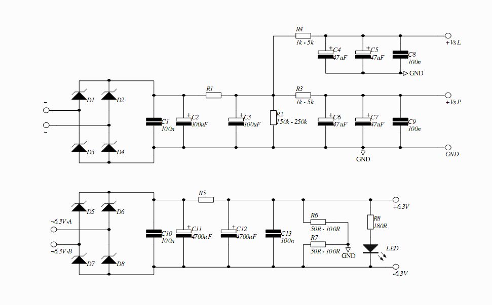

McGyver said:
Cathode follower... You need two triodes, it's one tube. You need one power supply PCB with 2 or 3 caps and 2 output caps.
Mcgyver
can you answer a few more questions please,
1. regarding the 3 power caps, what uF, V do I need to get minimum and preferred.. and should I stick to 105c rather than 85c
2. on your power PCB I could not see a bridge rectifier is this not required ?.
3. regarding the Output caps are 2 Obbligato Film Oil 2.0uF 630V good for the job or is Obbligato Copper Caps a better choice (double price) what others that are readily available do you recommend that are not crazy expensive.
OBBLIGATO]Link to OBBligato Film Oil Cap
4. will any double triode do I.e 6h6p/6n6p or is this overkill, if so can you recommend others.
5. I found this power board on ebay that is already made up that will work out to about $8 more than buying parts & making it myself would this be sufficient or are the components on it rubbish or overkill as there 4 caps on board. If I do it myself I'll purchase the same bare board.
Power Board
6. how much power do I actually need to power the valve in case I see other board fully assembled.

1. There should be good quality caps. I used Nippon-Chemicon.
2. You don't see not means there is no rectifier. Rectifier is indispensable.
3. Soviet teflon caps.
4. ECC88 or E88CC will do. 6N6P or E182CC fits too, even if it's a little overkill.
5. This power board is intended to feed transistor power amplifier. You can't use it for a tube stage.
It makes no sense to copy my circuit upon my pictures, you can't do it properly. I'll draw schematics and post it later.

The voltage should be at safe level. If the tube stage is powered from 200V, then safe voltage of the capacitors is 250VDC.
McGyver said:The voltage should be at safe level. If the tube stage is powered from 200V, then safe voltage of the capacitors is 250VDC.
Ahh got it, so I need to build or buy the power-board first to get an idea what power I'll need for the caps.
I'm still trying to find a suitable board with no luck, did you get a chance to draw a schematic of your power board to give me a rough idea.
No. You need to know first what voltage needs the tube you're going to use. And then you get an idea what voltage must give your power supply. For example ECC88 needs about 90V, and 6N6P needs about 120V.
My power supply is something like that:
