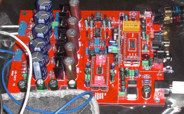

Steve, I think you'll have to tell us which one you have, there's at least three different versions. How about a pic.

I Bill. I'm new to the site but will try posting a picture.

Atlplasma said:Hi Bill:
I think the file was too large for my first two attempts at posting.
Steve
You have the upsampling version, same as mine. I believe with the upsampling board in place you cant use it in single speed, but I'm not a digital guru and could be wrong. I got a CD with mine that shows only two settings, with upsampling and without. To use without I pulled the board and had to jumper 3 or 4 positions on the board socket. The jumpers were not supplied with the board, I was lucky enough to find some in an old amp.
Hopefully, someone else will read this and post a better reply than I am capable of.
Keep reading the thread, there's nuggets of info dispersed throughout.
Best, Bill

Thanks, Bill. My board came with the jumper in place. I understood that you had to remove the jumpers and plug in the daughter board to use the USB port. Maybe I misunderstood. One way to find out, of course.
Sometimes I'm not very clear with my explainations, I used to get comments at work.
My board came with the daughter board installed. If you pull the daughter board to use the unit without oversampling then you need 4 more jumpers to install on the daughter board socket. They were not supplied by the seller but the CD supplied shows where they go. They have nothing to do with the input selection.
I hope that explanation was better.
Bill
Hi Bill:
It's not your explanation. It's my understanding. The daughter board was uninstalled on my DAC.
I'll experiment with taking it out and see how music sounds without the upsampling.
Steve
