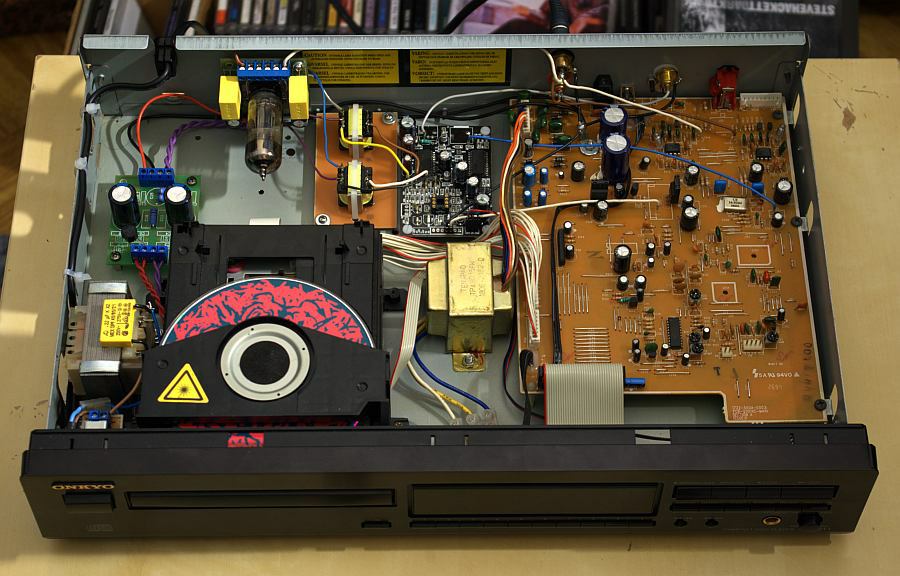

Franz Gysi said:McGyver
I am very impressed, how you managed it to install all this circuits very small in the CD player.
There is a lot more such players on my homepage. Take a look: http://www.audiosurgery.beepworld.pl/odtwarzaczecd.htm
Franz Gysi said:
Is it a Marantz player?
No, it is ten years old cheapest Onkyo, DX7211.
Franz Gysi said:
What SMD version is this DAC? Did I miss it?
Look here:
Franz Gysi said:Regards
Franz
Regards

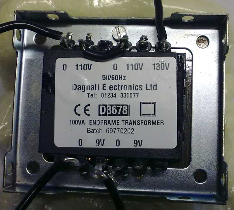

Power Tranny
I have tried my new 50VA EI power transformer. It seems to make the sound less smooth, with harsher mids and less bass, than the toroidal that came with the DAC. Even when it is warmed up
I did notice that it is giving 10.6V a.c., not the rated 9V, so could this be causing a problem? My mains electricity reads correctly at 240V. I would be grateful if someone could have a quick look at my connections (image attached).
legarem said:It should be a great transformer
No resistor needed
