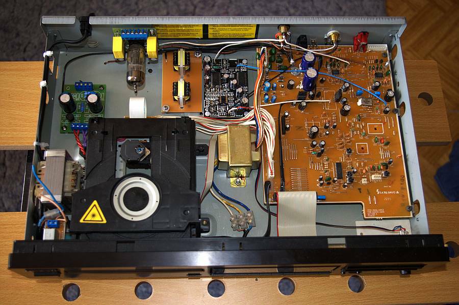

According to my observations if the solid state amp has low input impedance, the sound of our DAC with trafos alone sometimes becomes "dead". So I'm soldering Version with cathode followers after trafos. There is a picture of my test setup built into CD player. There is mini SMD version of our DAC:
