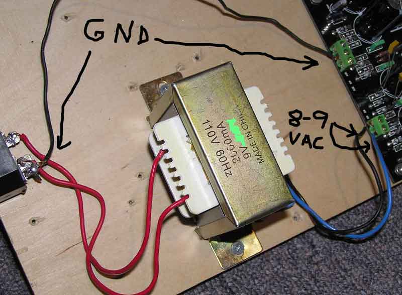

Grounding
Hi
Things aren't sounding quite right. Probably due to an incorrect filter cap being sent to me (giving cutoff 1693kHz). But I also have other confusions and would be grateful for advice;
1 - Should any other part of the DAC or power supply be connected to ground (apart from the RCA shield & output tranny, as shown in legarem's post #418)?
2 - I have connected three leads from the toridal tranformer - the two 8V and the 0V (between the two 15V inputs), but not the two 15v connectors. Is that correct?
Re: Grounding
hoverdonkey said:
Hi
When using output transformers you don't have to supply 15-0-15 vac on the 3 screws analog supply.
I use the center screw on analog supply (which is a ground) to go to the IEC ground of the 3 prong plug
You just have to supply 8 to 9 volts vac to the digital supply so take the two leads of a 8-9 vac transformer and feed the digital supply which has only 2 screws.
