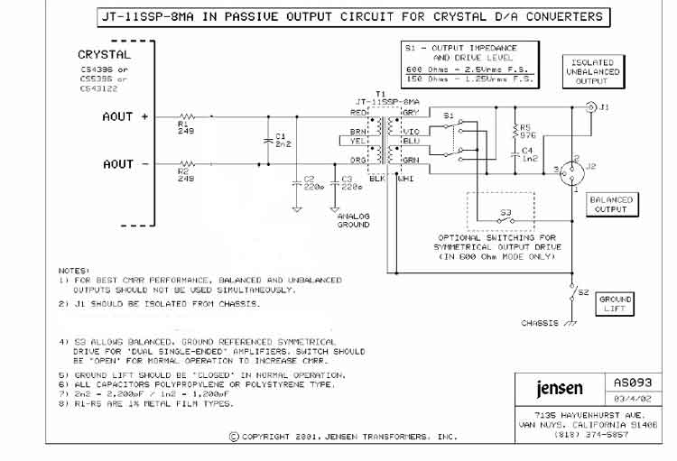

In legarem's diagram in post #418, the black wire is connected to the ground connection. Is that the analog ground of the DAC?

Also, on the same diagram, is the type of capacitor across the transformer primaries important (0.0047uF)?
Yes, it is connected on the analog ground
In my diagram, I forgot a 0 on the cap value. The good value is: .00047 uF not .0047 uF. Sorry.
If you keep the ,0047 uF, you can also change the 1K for 100 ohms and you'll get a lot more gain with the right cut off frequency.
The capacitor can be polypropylene, polystyrene, mica.
I had emali exchange with Bill Whitlock from Jensen transformers. Here is some interesting things related to the schematic included in this message:
1. The low-pass filters are used to supplement the characteristics of the transformer itself. Since the Faraday shield in the JT-11SSP-8MA (or any transformer with such a shield) functions well only below a few MHz, the two 220 pF capacitors and 249 Ω resistors function as a 3 MHz low-pass filter for common-mode to insure that RF energy does not interfere or cause strange intermodulation distortions in downstream equipment. The differential filter, consisting of the 2.2 nF capacitor and 249 Ω resistors, is set to be -3 dB at 160 kHz. This frequency is sufficiently high to add negligible phase distortion (that's deviation from linear phase, not phase shift) while low enough to control ultrasonic artifacts that can also cause strange distortions in downstream equipment (see the 1988 AES paper by Deane Jensen and Gary Sokolich for details on "Spectral Contamination").
2. The differential voltage across the transformer primary must be kept to an absolute minimum (<1 mV) to prevent a shift in the magnetic operating point of the core material. Any significant dc flow in the transformer will alter its distortion characteristics. Normal (for Jensen-selected core materials) transformer distortions consist almost entirely of 3rd harmonic, but adding a dc component creates a series of even-order distortion products (2nd, 4th, 6th, etc.).

As stated in a previous message, after modifying 6 of these dacs, there is always 0mv between the + and - of each output. You don't have to bother with any voltage across the primary of the transformers with the CS4398 and CS4397.
Use matched resistors at the primary of the transformers.

Just to clarify my understanding of this. The Resistor (1K) and Capacitor (0.00047uF) are acting as an RC filter.
My calculations, using the formula F = 1/(2 * pi * C * R), have the cut off frequency at 338691.43 Hz (338 KHz). Is this correct? If it is correct, why does it need to be so high?
Using the value of 0.0047uF for C, gives a cutoff frequency of 33KHz. Is this not high enough?
You have to do the sum of the two resistors so 338 khz become 169 khz
If you don't have a preamplifier, use 2 X 100 ohms instead of 2 X 1K .
The caps value become 680 pF
33Khz is too low. Remember that the cut off frequency is at -3db
Legarem, I am new to this and so would be grateful if you could explain the reason for raising the cutoff if not using a preamp (I used the formula for 2x100 Ohm with 680pF, giving 1170kHz).
I use an integrated amp (Primaluna ProLogue 2) which I guess, by definition, has preamp built in. I am therefore planning to try your original filter (2x1K res, 470pF cap). Am I heading down the right path?
Sorry
I made an error
2 X 100 ohms with 4700 pf
2 X 1k with 470 pf
This gives a cut off frequency of 169 khz

Does the 2 x 1K with 470pF filter have any advantage over the 2 x 100R with 4700pF? I understand it will be quieter (less voltage across the primary).
hoverdonkey said:
Thank you!
There's more gain with the 100 ohms resistors . The sound can be mellower with the 1K.
