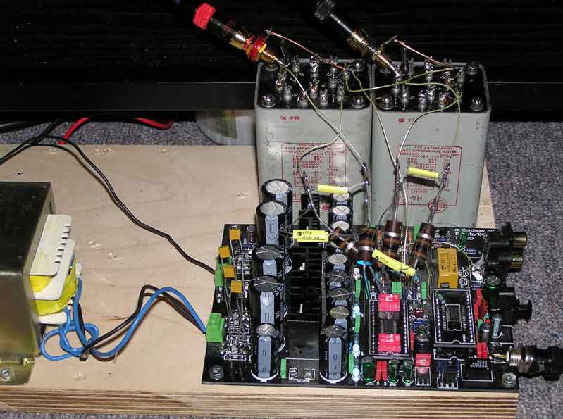

I received the UTC HA-108 today
They are big and heavy transformers
I listened them for a short period of time and I can tell that the bass is terrific and listening piano reveals probably the best mids I never heard
More on that later
Last night I took the three dacs with different transformers to one of my friend's system ($$$$$) and we done some testing.
As soon as I will finish to compare the UTC to others, I'll give you the results (shootout)
So the shootout was partially done in two different systems with 4 peoples.
Here are the UTC monsters
More on that later

McGyver said:Now the setup is ready and singing. Really singing:
Hi
I got the same dac
would you please describe the mods you have done to get pleased results
Yes, I would.
After CS4397 are Sowters. After Sowters are cathode followers.
When I got time I'll post drawing.
thx
I will use audio transformers only - have you compared Sowters to other brands - Lundahl, Jensens, Neutrik, Edcore
regarding PS 5V - what regulator you are using
have you replace any components on dac board - resisors, caps
I didn't compare various transformers yet. But I will do Lundahls.
I use LF50CV or LT1086 regulators.
There's no need to replace resistors IMHO, Dale are good enaugh. I replaced most of capacitors and used Rubycon MBZ, Nippon LXY, LXZ, Sanyo WG and Sanyo Oscon.
