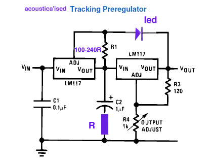

Like this, maybe? (C-R-C-R-C filtered LM317 tracking preregulator)
Here are the PDF files for the preregulator board. It is made to fit to the DAC board. I've ripped off the whole PSU stuff from the DAC board and feed the prereg's outputs to the DC sides of the diodes on the DAC board.
This is the schematic for the prereg, borrowed here: Using 3-pin regulators off-piste: part 4 )
The C-R-C-R-C filters and diode bridges need no explanation, I think.
Edit: I've just noticed that the LEDs are drawn reversed in the component layer PDF!

I think theat Teddy Pardo sells a complete regulator board the upgraded "Super Teddy Reg".
Paying 142 whiplashes for three regulators ... Never!
The R value is well hidden ;) in the text on the Acoustica page: "As to typical values ror C2 = Polyester 0.1uF in series with R5= 10ohms, or C2=1uF in series with R5=2R7 - 3R3; or a cheap 10uF electrolytic cap all work well here."
I've not tested the Teddyregs in curcuit yet. The preregs alone gave a noticeable improvement, no surprise. The original onboard LM317 implementation is in the most basic manner without any kind of filtering.
