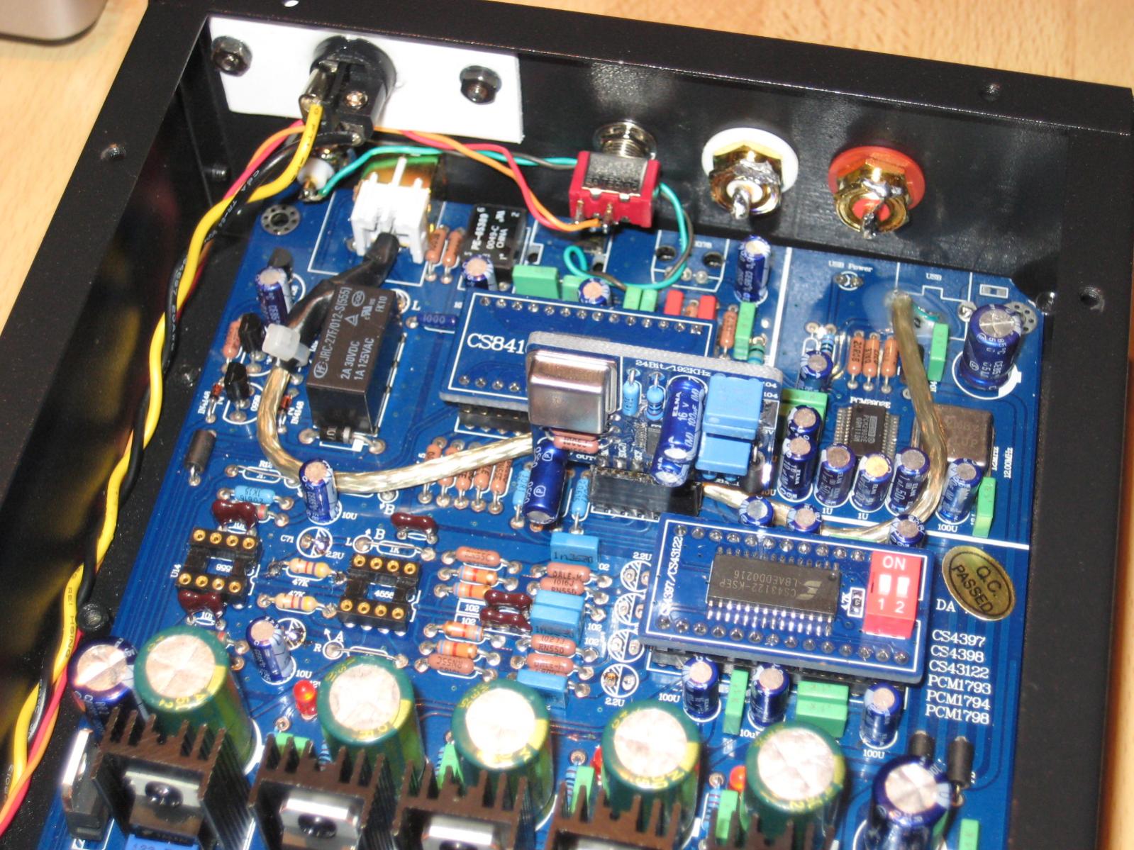

I own the old version of the Gigaworks DAC:
New 24/192 DAC DA CONVERTER CS8416+CS8421+CS4398 USB | eBay
You can see it in the third picture, some people here have built the same version or the very similar version that was sold before.

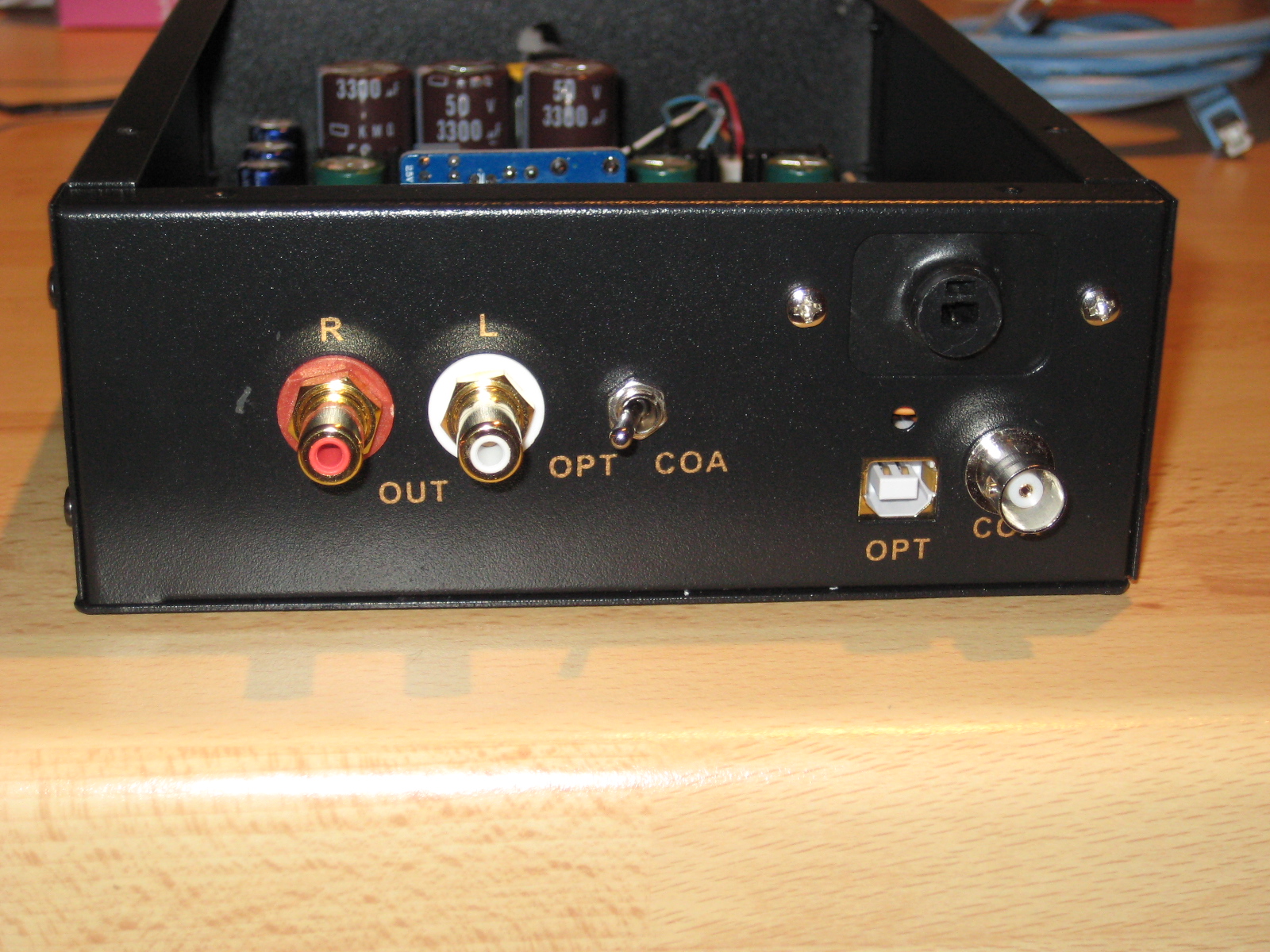

I wonder if anyone made it possible to switch the input from the outside of the enclosure? In this version the inputs can only be changed by using the jumpers.
Any1 got an idea how to do that?
I use dual-ganged 3 position toggle switch with the following wiring referenced to the board connections (which are labelled incorrectly):
Switches
USB SA=1
Opt SB=1
Coax Both SA, SB open
Mine is the latest board though and may be different from the earlier version.

The Lars Audio version of this DAC which was sold to me in a case, also uses the same three position switch concept. I see that they have now gone with a rotary switch. I've never hooked this DAC up to USB, but the coax and optical work as expected.
Sheldon
The only other switch I see that is needed, is to switch from upsampling to non-upsampling. 192k files do not work with the upsampling module installed.
Has anyone done this?
The max sample rate in upsampling mode is 176.4k, because if you already have 192k wav file, you don't need to upsampling.
In my opinion, only if you are using unproper digital source, such as DVD player, otherwise, the upsampling module is not necessary.

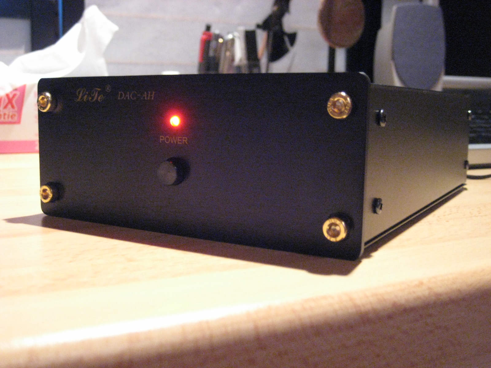

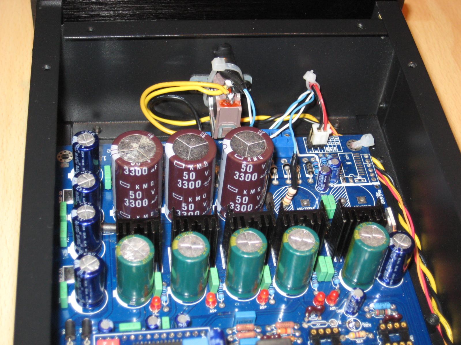

Almost finished !
Some pics of the almost finished DAC, inside a case left from another DIY DAC, the
LITE DAC-AH (http://cgi.ebay.ch/LITE-AUDIO-DAC-AH-96-24Bit-HI-END-Mini-DAC-/320669530848)
A 96/24 using 8 parrallel TDA1543, quite nice but not in the same league...
Anyway, I find this case nice looking, and just big enough to accomodate the board.
Quite a lot of work to make it fit, but in the end il looks more like a finished product
than some garage job.
And the vendor of the AH DAC also sell the naked case, around 25$.
I'm just waiting for the Sowther transformers to make it sing 😉
And I got a dumb question, as I put the board in (tightly secured with strong double sided tape), I didn't write the output order of the DAC, doh ! Can somebody confirm it's R+, R-, L-, L+ ? Thanks !
