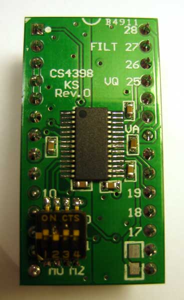

my CS4398 adapter PCB’s came in
A follow-up, my CS4398 adapter PCB’s came in. The original on the Ebay big DAC board is a poor design and with mine near death after rework lifting traces, I laid out a new board.
I wanted low impedance traces and nearby SMT decoupling caps for the CS4398- there’s no other way to meet the demands on the VREF pin (6ns/80mA spikes).
I succeeded in getting 1mVpp noise on the analog power pins and about 4mVpp on digital power pins. I kept the split grounds and there’s 5mVpp noise between them. I find huge improvements to detail, imaging and rhythm when there is decent (local) filtering of the rails and have to say the CS4398 can sound pretty damn good. But you have to do heavy mods to this board and it can’t take a lot of soldering/rework 🙁
The PCB was $5, CS4398 $13, caps/dipswitch/pins about $7, so it cost ahem 1/4 the price of the DAC :sigh: I have a few spare blank pcb's if anyone wants.

prairiemystic,
I would suggest to avoid any X7R, X5R, X8R, Y5V, Y5U, Z5U ceramic capacitor, especially in decoupling, as these are subject to the piezoelectric effect.
On one side you are killing high frequency noise and on other side you are increasing low frequency noise, which will affect jitter even harder.
You may use NP0/C0G ceramic capacitors or even better silver-mica.
Just try one single 1nF silver-mica across ASRC oscillator and you´ll immediately notice the benefits.
Tibi

That is funny, I would suggest strictly against silvered mica.... sound very harsh and don't do much to actually snub the noise from the supply pins to ground, mostly because they have leads....
My recipe is parallel combination of 100nF, 22nF and 1nF -> all X7R dielectric of at least 50V DC.... outstanding results... I also measure broad spectrum noise - the combination I suggested above snubs all noise at all frequencies (if the ground plane is of low-noise design). I can go from very clean, clinical, superbly defined sound at all frequencies (with excellent bass detail, definition and extension) to mellow / mushy sound (suitable for basic audio set-ups) just by applying the right amount and combination of SMD capacitors at all supply pins.
