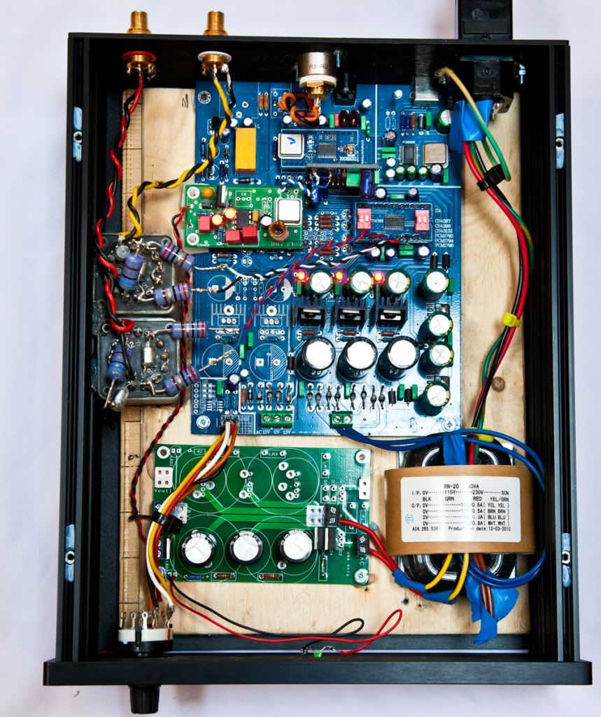

Alex_twn, your mods look really good. What is wrong with the sound? The main board grounding has a couple faults but not enough to make it sound poor.
I note your transformers are big, which means they have big magnetization currents and I'm not sure the 'lil 4398 can do well there.
I truly admire your modding attempts and your attention to detail, to correct some of the design flaws. Your comment about the trafos being physically too big, however, has no basis in fact. You should refrain from making speculative comments on subjects that you apparently don't understand. Bigger IS better. Better bass response, greater headroom, and lower distortion.
No disrespect intended, just being blunt, as I usually am.
Best, Bill
Once you maxed the mods in the abovementioned areas, AND if you wish to do so, you could use external oscillator clock for the resampler / upsampler plugin module, if you decide to use the upsampler module of course. This oscillator will need completely separate, very low noise power supply AND will have to be grounded to a point on the DAC PCB with lowest noise.
Good luck,
Boky

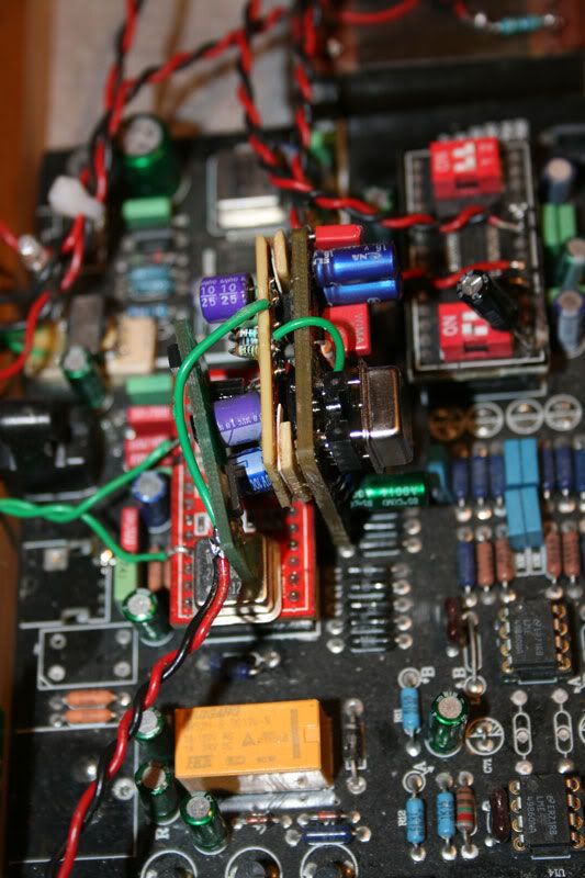

I did something similar following some advice from the guys on Pink Fish Media -
I removed the clock from the upsampling board & mounted it on a modified "Flea" low-powered regulator fed from its own power supply. This made a significant improvement but it's important to keep the new regulator away from other components as much as possible.
I'm using UTC A-20 transformers so I've space where the old op-amps etc. originally sat.
If you want to send 2.5v dc through along with the signal.
The 2.5Volts is on both sig+ and sig-, the transformer only cares about the differential voltage, not the offset from ground. That differential voltage is fractions of a mV.

Maybee you will get the same result if you feed the onboard XO with its ownI removed the clock from the upsampling board & mounted it on a modified "Flea" low-powered regulator fed from its own power supply. This made a significant improvement but it's important to keep the new regulator away from other components as much as possible.
regulator?
Edit:Where did you get the new XO?
Is that a LCR Polystyrene. Have you been testing Polypropylene before this with the traffo???
It's the one i took from the upsampling board. Not an XO by the way.

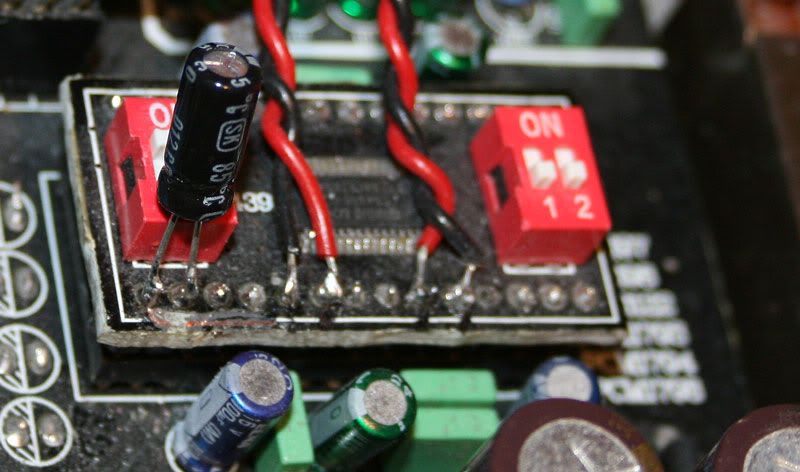

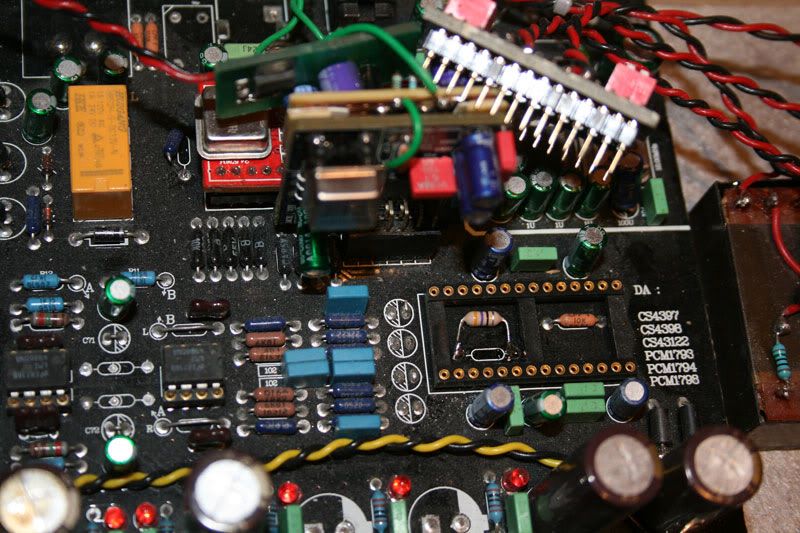

I did al littlte modding tonight..
The Vref mod with the inductor:
And the trace and the e-lyt:
And I gave the oscillator on the upsampling module its own shunt regulator from Paul Hanes I had laying around:
I can´t swear that I hear any difference to the better,but on the other hand it doesn´t sound worse....😉
Hi sorry for my late answer here.
Those transformers were one the parts recommended on this thread long time ago, even if this is more the low end model from edcor, they are working with the DAC.
It is hard to see on the picture but I do have series resistors to adapt the impedance and match the DAC output requirements.
Thanks for your comments,
Well I remember to have done everything with some measurements before applying the mods.
First thing, looking at the schematics, I found out that the supply decoupling was not done as recommended in Cirrus data sheet so I decided to optimize the circuitry.
I tried to separate as much as possible power rails and analog / digital also separate the rails from each devices (i.e. 3.3V for DAC different than the one for the receiver with a common ground of course), I was able to do it by using the additional free LM317 on board.
Then I used some good parts (NPO / Nichicon MUSE) and yes I get better figures on the noise level but could I really hear something different from this mods? Not really actually.
I agree with you, the small DAC PCB is a multi purpose one and may sound better with 4397 even if I never try swapping the DAC.
I never went to external clock circuitry, I feel I am not going to get a huge improvement again here.
Transfo and PCB are grounded together, they are screwed on an aluminium plate together.
I agree with you for the controller, it can inject some noise here, but I also tried with no controller, actually the controller was the last mod when I was thinking to put all the system in a case and implement some nice control features like remote and display.
I don't have any capacitor, I just have the DAC output connected to the transformers through resistors.
I have been following this interesting subject here since the beginning I guess and implemented all the modifications recommended.
While some (transformers) gave a noticeable improvement, others gave close to nothing.
I feel that the PCB design + the modules on DIL sockets introduce some parasitic / noise that prevent to get the DAC best SNR, so improving the supplies don't really change something (in my case).
But I don't forget as well that this DAC is cheap and is a good value for the money spent + it is fun to try the mods (for some time only ... 😉).
Mine ended up in a drawer as I mentioned, because I decided to try a full balanced DIY DAC with dual DAC chip in mono mode and I got just after assembly a very good result, so I forgot a bit about the CS4398.
Alex.
IMHO putting a shunt for the clock on the upsampler board didn't really improve much for this dac. I did a comparison listening using the upsampling and without upsampling board and there's no differences to my ear.
I did change the caps on the upsampler board too with same result...
