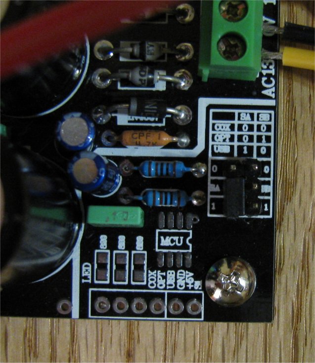

A question
I've got this dac plugged into a WinXP machine via USB. I've noticed 2 things:
1) My volume slide in the OS doesn't work. The media player volume slider works. The OS volume slider works with my previous USB dac. Not so much this one.
2) This DAC seems louder to me than my last usb dac.
My dac came in an empty box, with no documentation. So I looked at the board and tried a jumper settings for USB operation, and I got sound to come out, so I left it at that. But now I wonder if I have it wrong, and that's why it doesn't respond appropriately to OS volume. I looked back at post 301 of this thread and saw some info on jumper settings, but with the various revisions to this board around I don't know if that info is still good. Could someone go over the current setup for input selection with me?
Attached: current jumper setting
