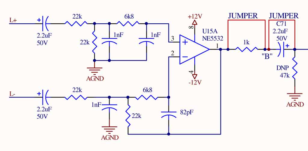

DAC's output (reconstruction) filter
Has anyone questioned this DAC's output (reconstruction) filter?
It's quite different from Cirrus CS4398 datasheets and the values look weird for a 2-pole differential filter 😕 One leg is 45kHz and the other looks like 7.34kHz, which means a 1nF cap should be an 82pF cap...?
