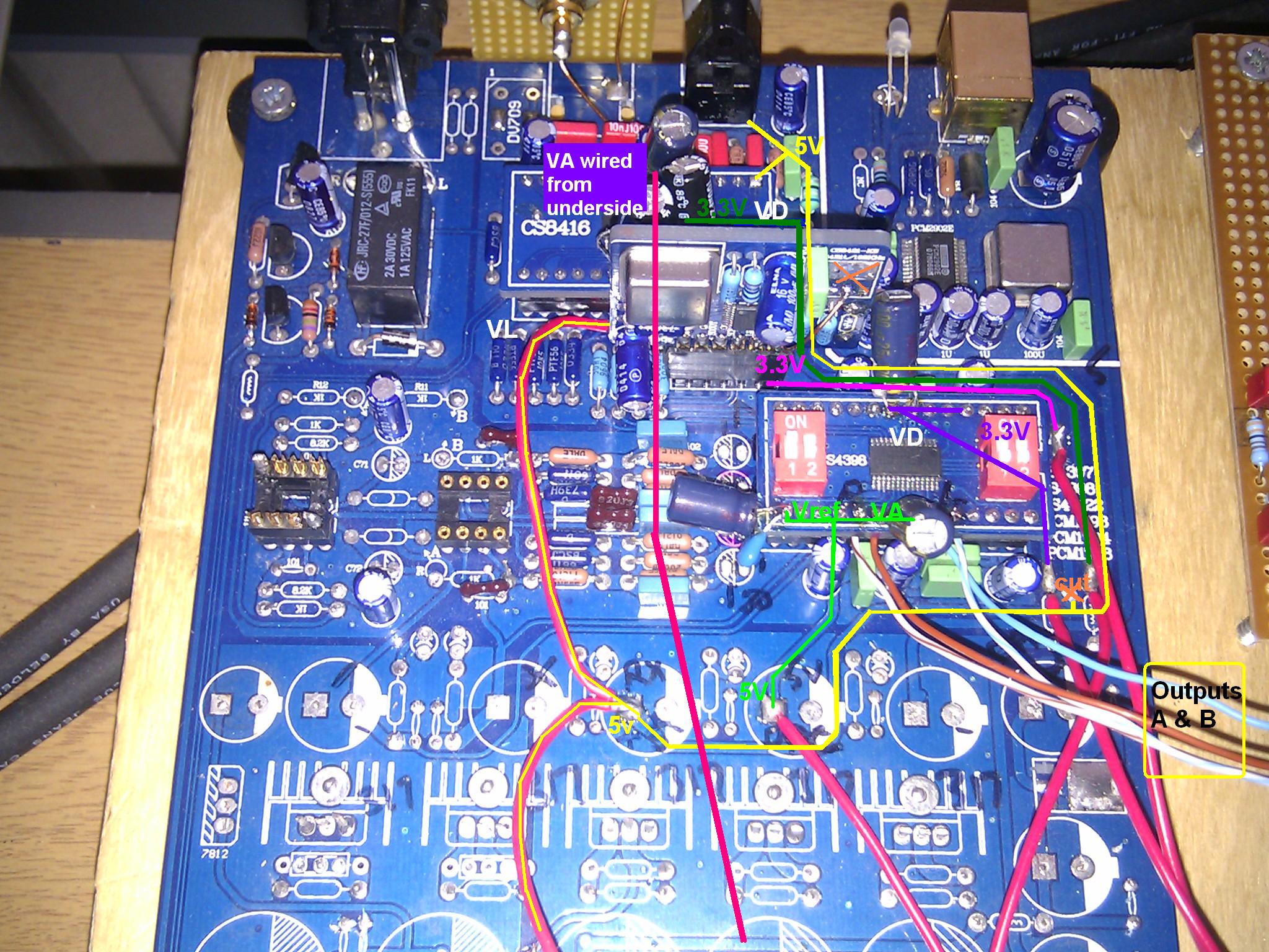

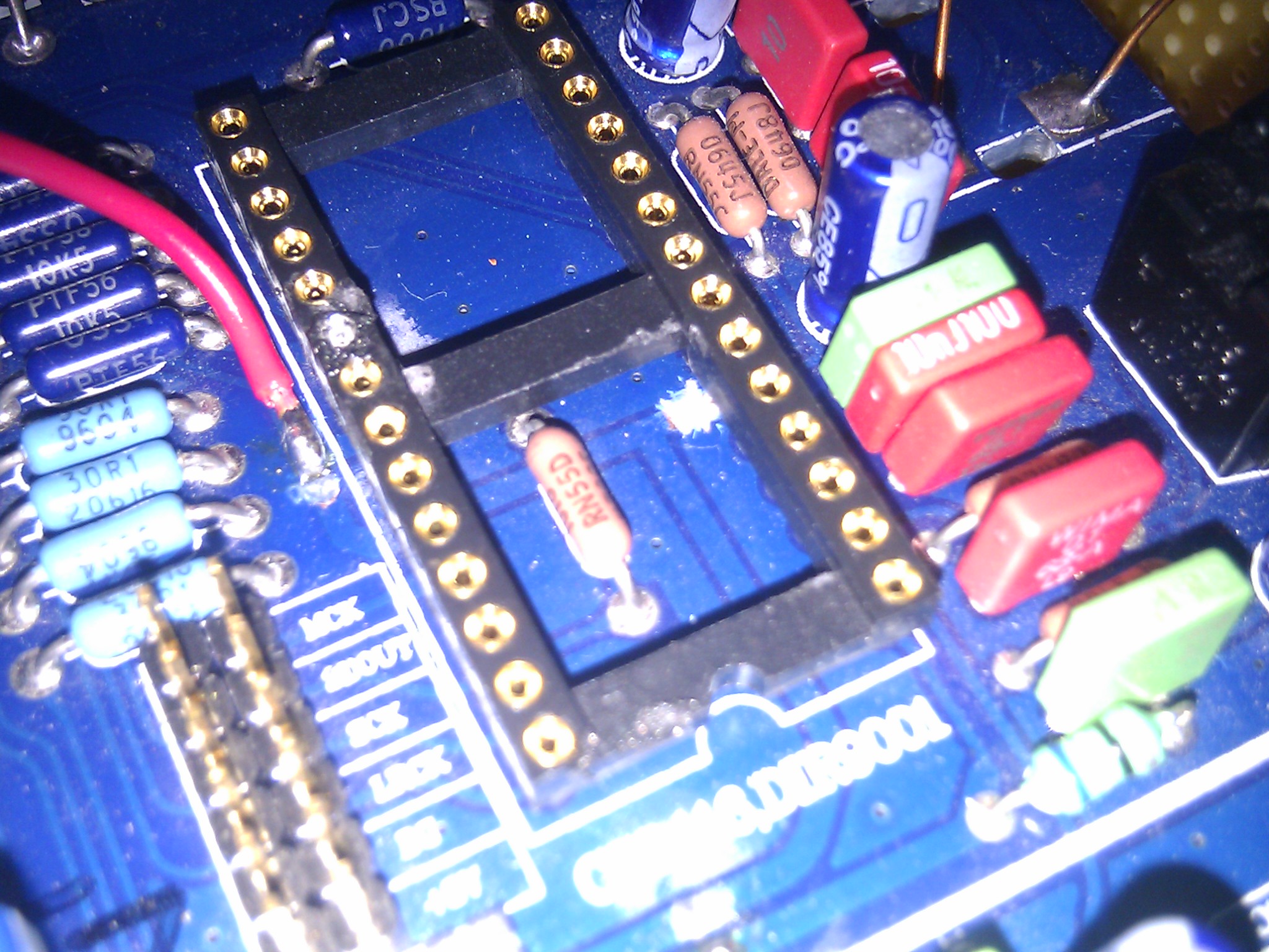

G'loops I have attached a bunch of photographs. I will attempt to explain what I have done.
OK so the power supply rails on the board are shared in a crazy way as standard.
The whole 8416 board is being supplied by a single 3.3v rail with no capacitor decoupling evident.
There is a dedicated 5v supply for the SPDIF toslink socket???
The upsampling board and VA for the CS4398 share a 5v rail.
The USB has a 5v dedicated rail.
The relay has a 12v supply.
Opamps have a bipolar 12v PSU.
I think thats everything.

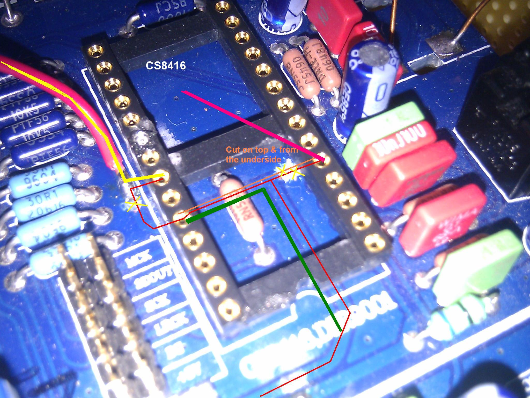

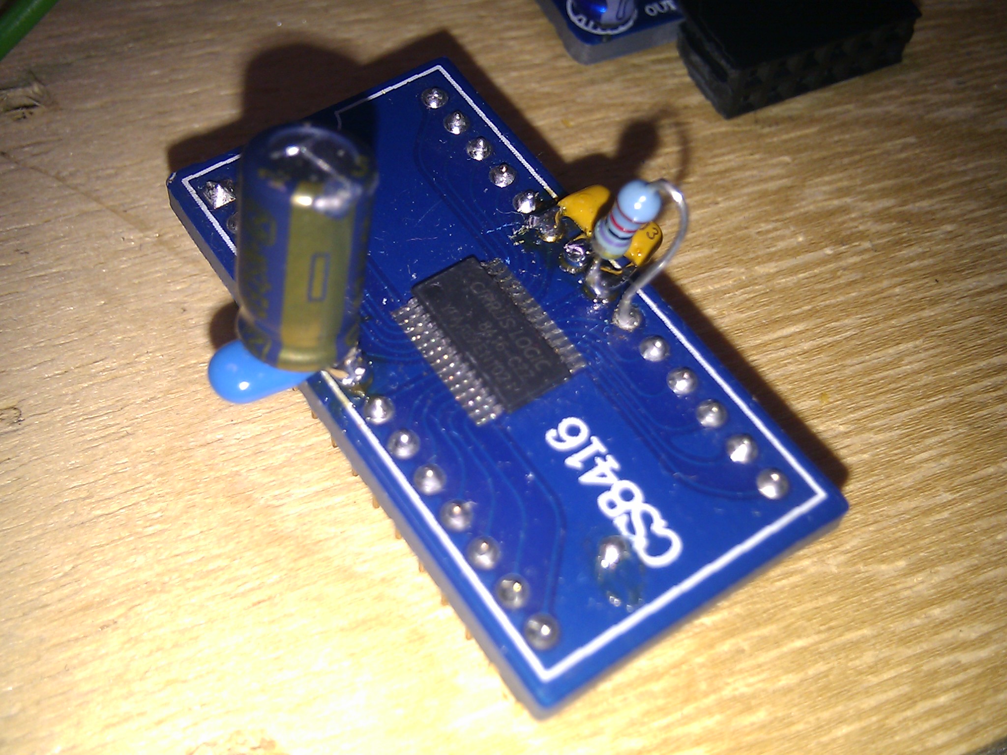

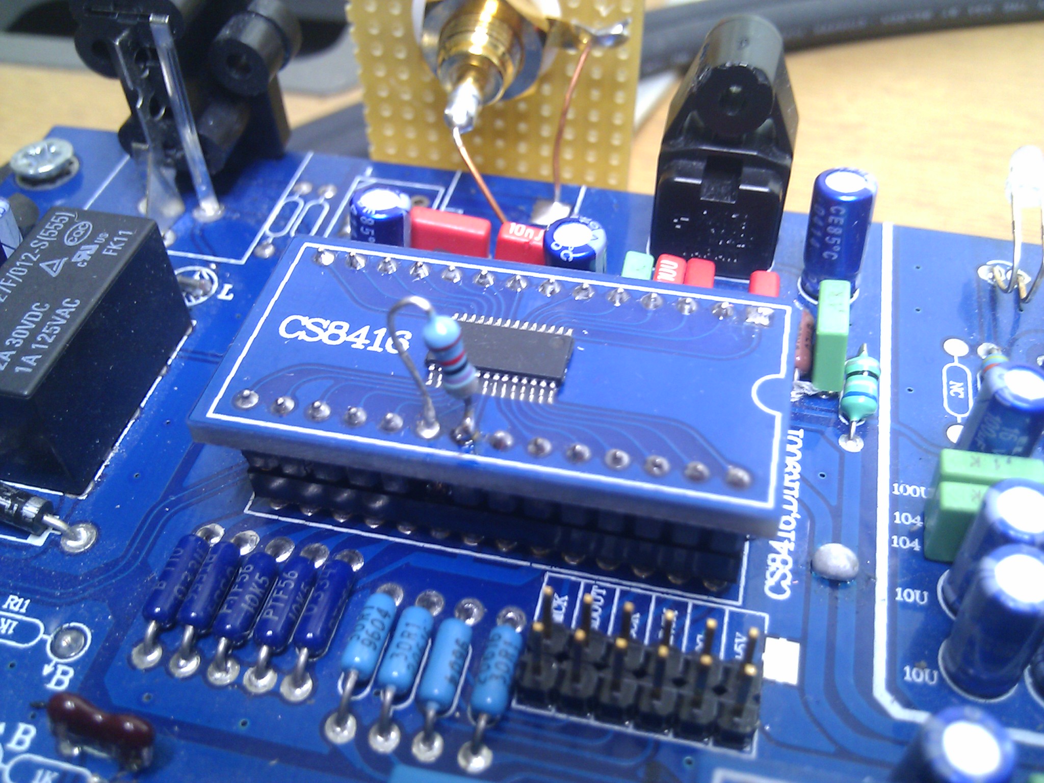

CS8416
OK I cut traces on both sides of the board under the CS8416 smurf board to isolate VA[3.3v] pin 6. I cut a connecting trace between pin 23 & 21 just outside the socket for the 8416 this isolated VD and VL. Traces on the MAIN BOARD under the smurf board area not actually on the smurf board.
I added 0.01uf X7R caps with 100uf electrolytics directly to the pins of the 8416 smurf board there is a ground pin on the neighbour pins 7 & 23
** note I havnt soldered 2 100uf caps to VD & VL yet.
So 3.3v seperate PSU for pin 6 VA & pin 23VD and 5v on pin 21VL.
The 5v VL PSU is used to power the optical SPDIF and the pullups for selecting the input.
Also put a 47K resistor from VL to pin 20 to change the jitter something as discussed early on in this thread.

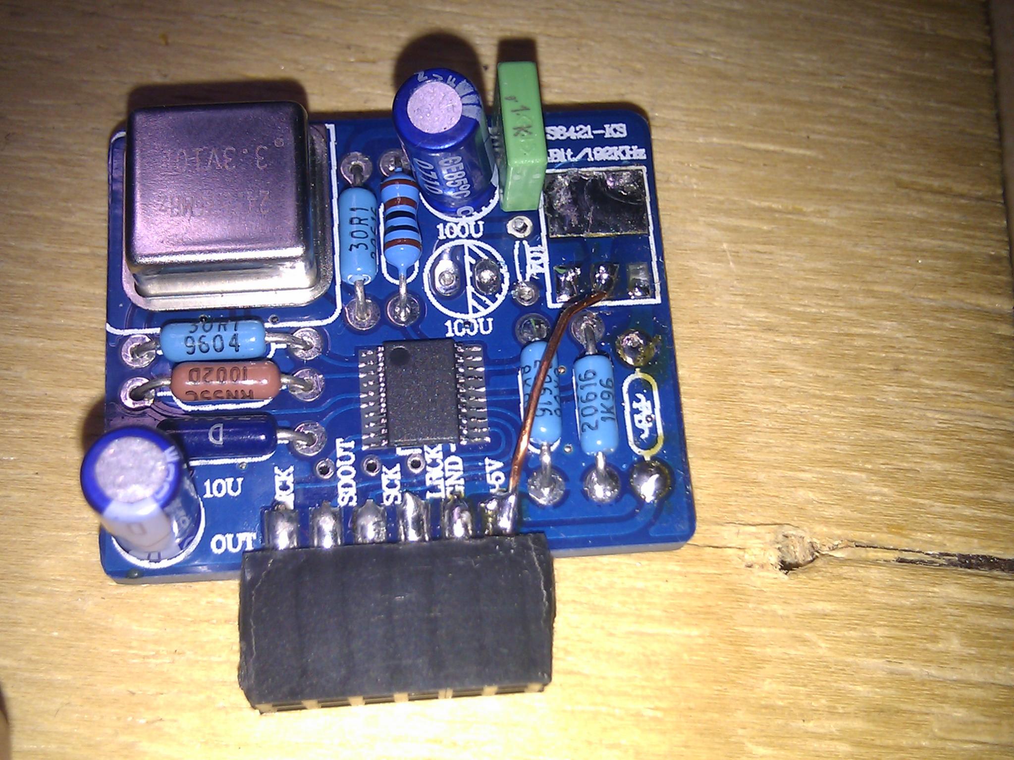

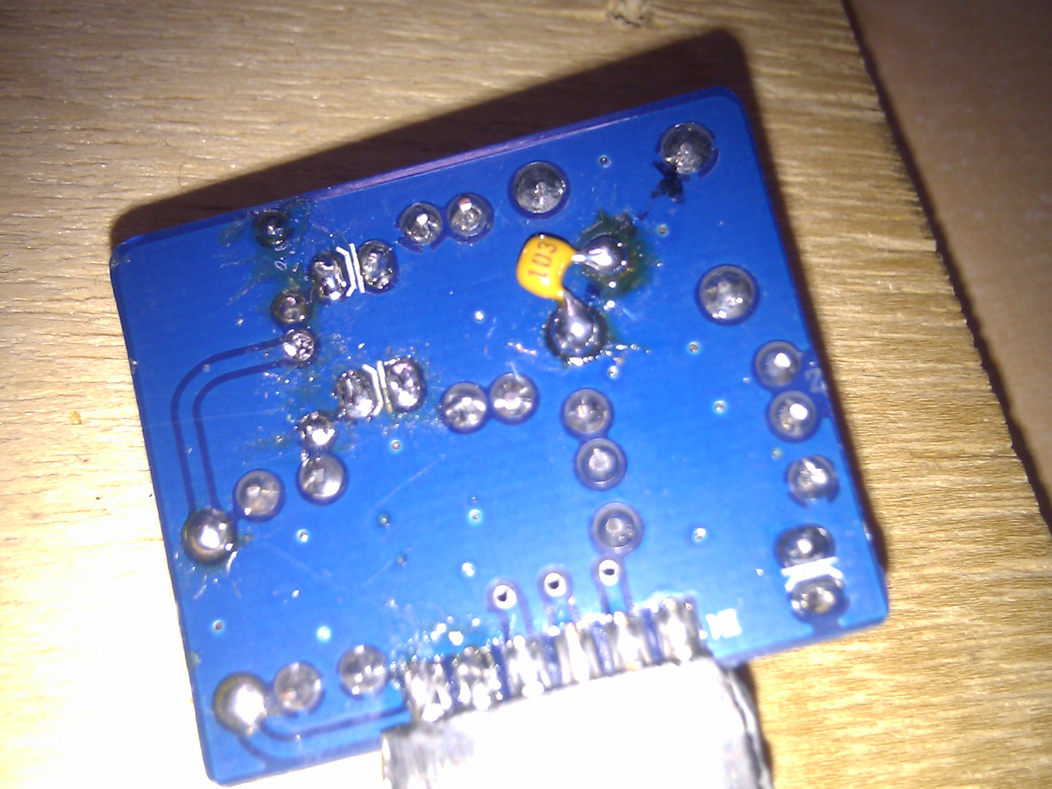

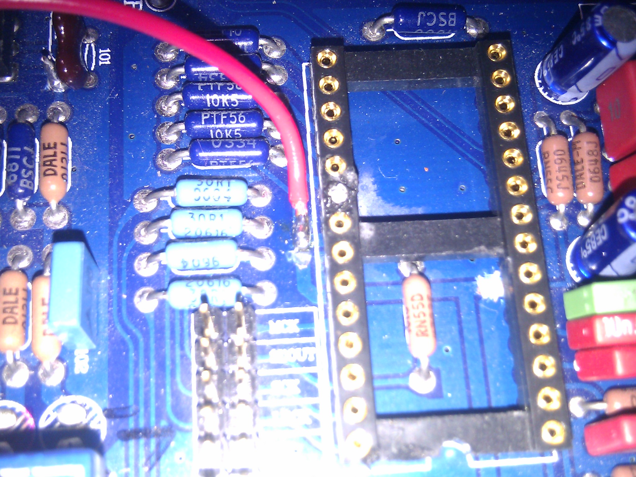

CS8421 board.
Cut trace next to the CS4398 chip between the 3.3v rails from the SMD regulators, this seperates the 5v VA for the DAC from the CS8421 board.
Added a 0.01uf X7R cap to the supply pin to ground on the CRYSTAL.
Remeoved the regulator and associated input caps and jumped the supply using a copper wire.
Now supplied by a dedicated PSU using LM317 etc.

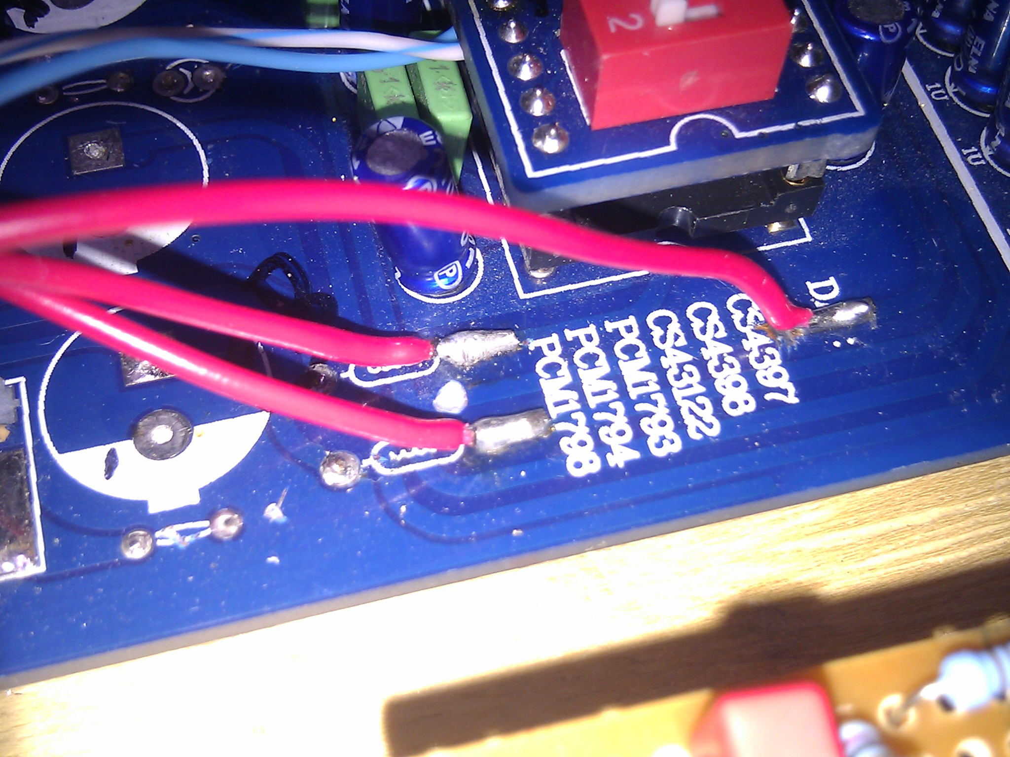

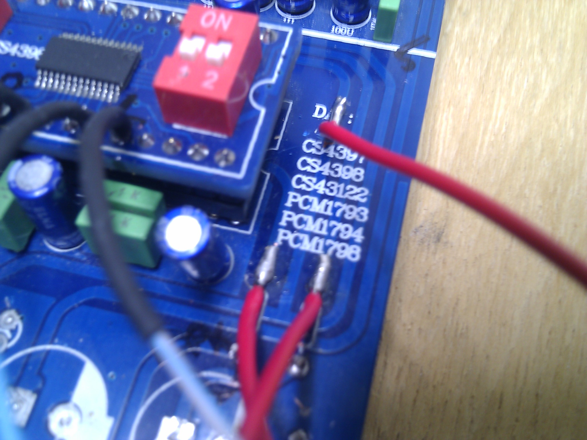

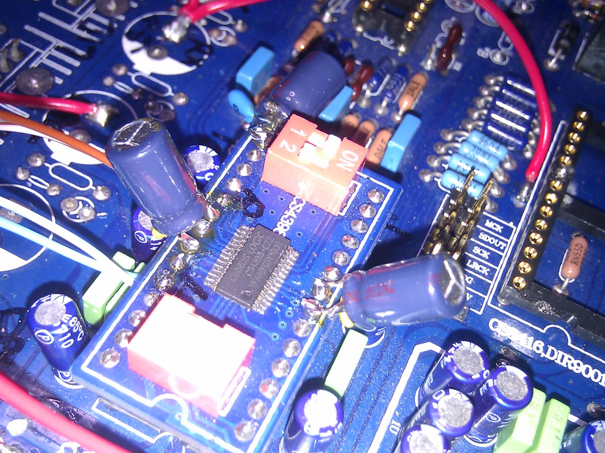

CS4398 board.
Supplies have all been seperated now so power this up as required with 3.3 volts and 5 volts.
I added 0.01 X7R with 100uf to VD VL and Vref - for Vref there is ground plane just below on the underside of the smurf board use this and solder side on to the board. The CS4398 board is NOT exactly pin for pin like the CS8416 board so be carefull.
*** Vref is pin 15 on the smurf board but its leg 17 on the chip please be warned.
So I think thats it.......

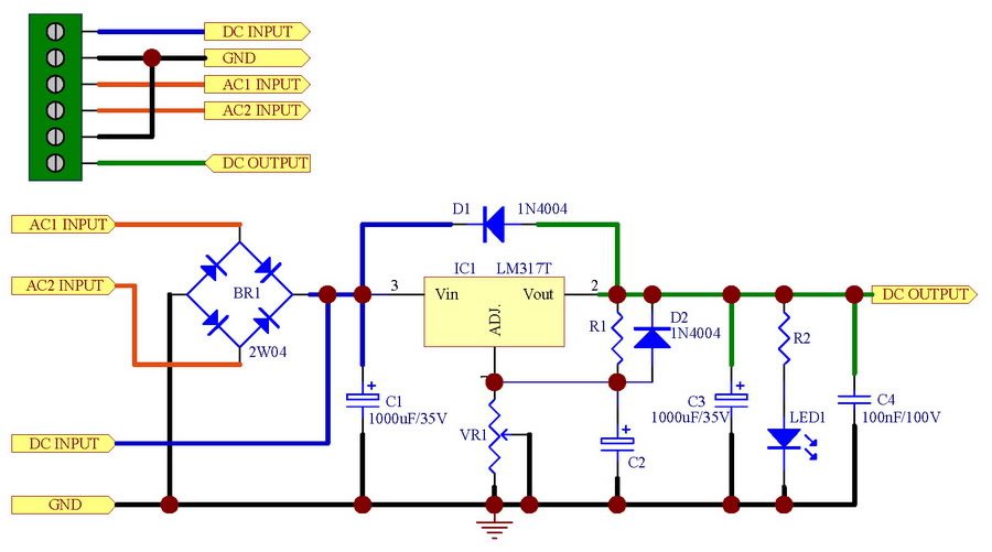

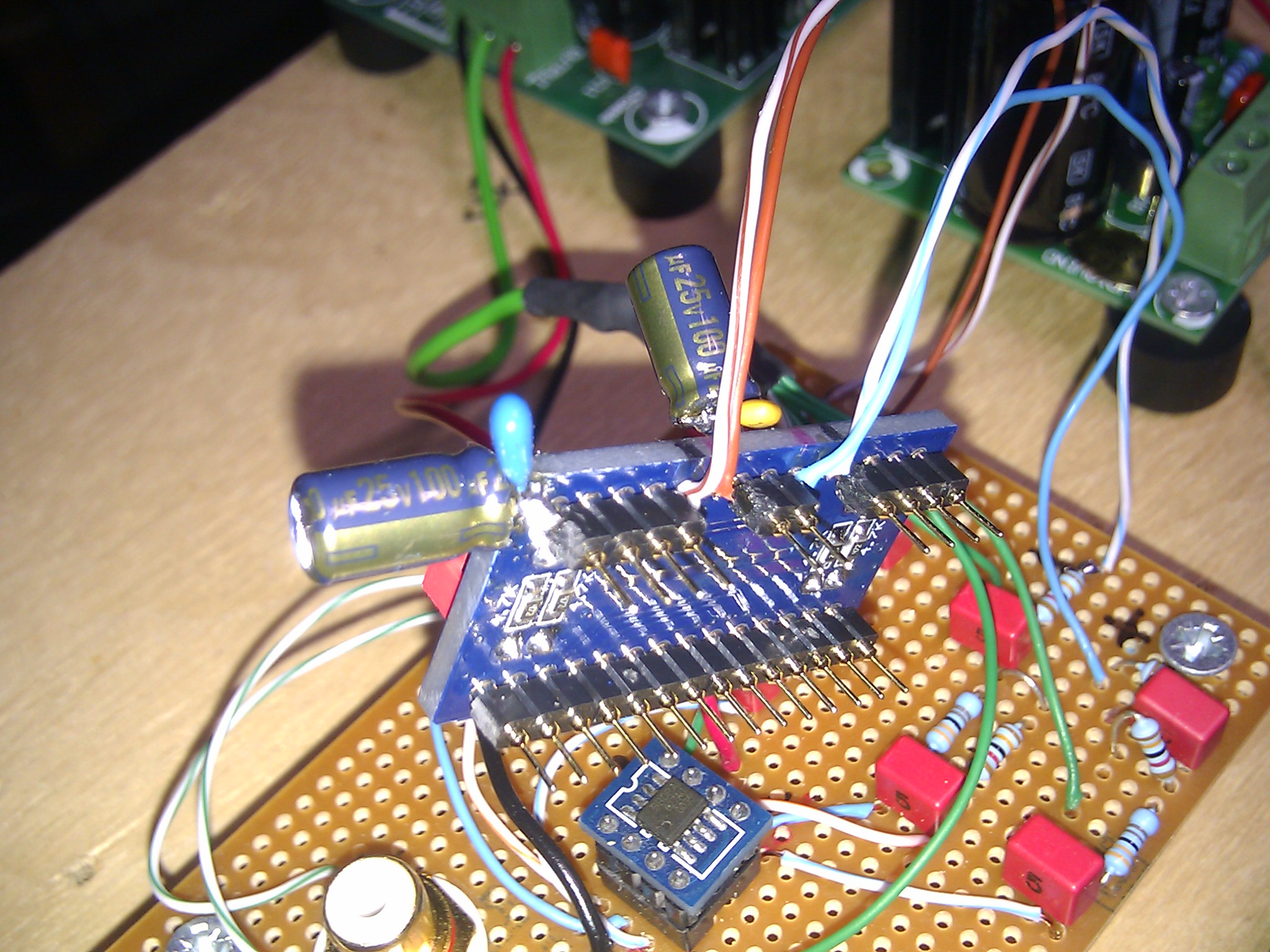

In total I have 6 PSU lm317 to power the chips and a 15v bipolar for my opa627 output board.
I think its best to do this in stages. Seperate the supplies and get rid of all the ferrite beads they suck the life out of the sound.
Phew.......

And if you get rid of the opamps and install a pair of OPT you get to hear theIn total I have 6 PSU lm317 to power the chips and a 15v bipolar for my opa627 output board.
CS4398´s potential..🙂

I have 3 transformers which gives me 6 seperate windings each with its own regulated PSU. [overkill, but makes a difference]
Now here is the issue:
The 8421 needs 5.0V/3.3V for VL and 2.5V for VD and I have 3.3V on both, in an ideal world I would run VL at 5V and use a seperate regulator at 3.3V for the clock with another at 2.5V for VD. In total I need 3 regulated supplies, I need to add another 2. I will get round to it at some point. I will share a couple of the transormer windings to do this by adding fully rectified PSU.
I buy these power supplies, fully rectified variable LM317, I change the smoothing caps to 4700uf.
Voltage Regulator Kit, AC/DC in, DC out, Based on LM317 | eBay
I have included a photograph of where to look for the shared track its the middle one between the tracks. If you lift the DAC out and follow these tracks you will see how the supplies are all mixed up.
I cant express the difference it makes to seperate them, even if you dont add seperate transformer windings.
I pointed out the problem with the design back many pages ago, that they were running the 2.5V VD at 3.3 volts (really really close to the absolute maximum rating). Apparently the chips can handle it, but it's not a good idea. Back toward the beginning of this thread there were a bunch of folks who were toasting 8421's and I found that issue with the design. I haven't heard of anyone having issues lately, so apparently the 3.3 volt regulator on the newer ASRC board does the trick.
