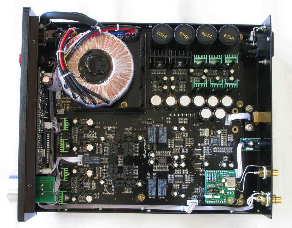

Here's the Audio-GD NFB 5 with much better design, case, power supply, no OP's.... and the shipment is cheaper as well!
ºÍ§Ó*µ响
http://www.audio-gd.com/Pro/Headphoneamp/NFB5/NFB56.JPG
