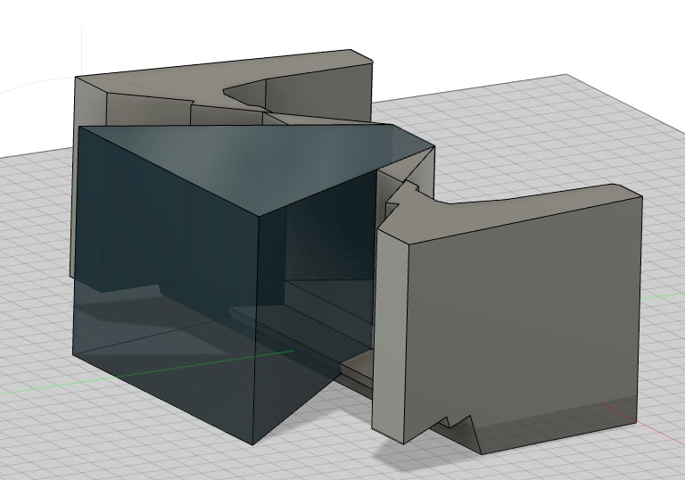

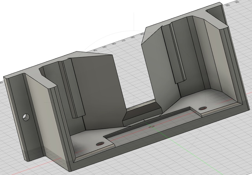

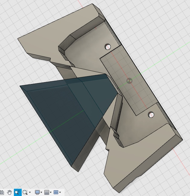

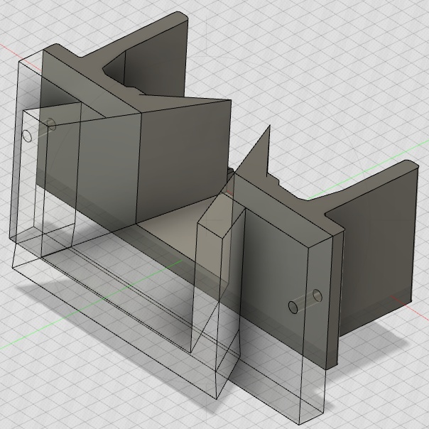

This is a work-in progress on getting closer to the diaphragm. It shows a half cut of the front attachment (not finished) and half of the horn inner volume ("glass" material). The horn is 50 x 30 as shown. Is there any particular pattern I should aim for? I think the HF vertical is limited by the length of the diaphragm anyway.
The port of the Synergy mid driver can be located in the AMT slot (the inner edge of the port can be 20 mm from the diaphragm at minimum) or any distance further - any suggestions on that - like the center should be 1/4 WL of the expected 800 Hz crossover frequency? Two drivers can be fitted (top, bottom) or four smaller on the sides, but they would need to be a bit further away.

Nice work Pelanj!

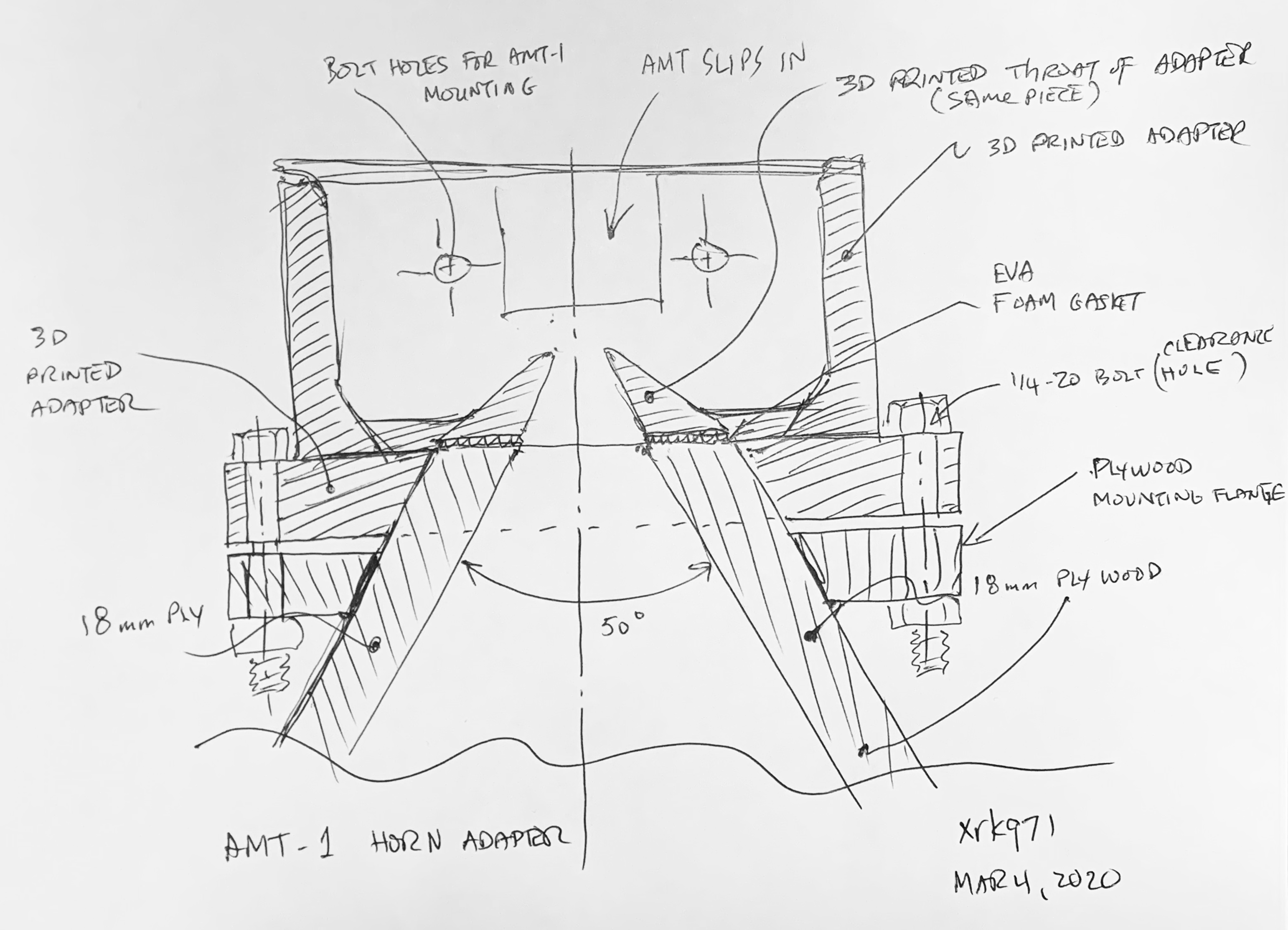

What would be helpful is if you can make the adapter to mate readily with say a Synergy horn constructed of 18mm BB ply walls. The ends would be flush sanded and slip right in. The way it looks now, it appears that the walls would need to be made into a wedge and additional layers added.
Can you make a model with the 50x30 horn constructed of 18mm ply as clear glass material and shown mated to the adapter. What we need to see is that it allows a horn of simple planar construction be connected to the adapter.
Thank you.
Please see my sketch for concept. Only a concept but up to you how we attach the adapter to the horn. I would recommend 4 bolts on the corners attached to glued on plywood flange plate on horn body. Or even 4 solid wooden blocks which are drilled later for the bolts.

You could leave the expansion as is, and have the horn wall contract to 50deg. That could work too, although the 50deg from the aperture throat is probably best.
Why narrow? Synergy horns work better when horn is restricted and directional circa 45 deg to 60 deg. Too wide and it’s not effective at integrating the multiple taps. 50deg is a tired and true Danley geometry. I have tried it and can confirm it works better than 90deg horn.
Hey fellas. If the desired horizontal angle is 50 degrees, then the resultant horn will be quite large unless the lowest frequency pattern control is raised to something closer to 500Hz, and even then, the horn will be 30 inches wide (~80cm).
I thought that making a speaker cabinet for my Audio Nirvana 15s would be large (~60cm wide), but these horns will be even wider!
Is that just the reality of building a horn? That it will need to be very wide to get a good result?
Also, is 500Hz ok for the pattern control? That seems on the high side if I look at some other builds online..

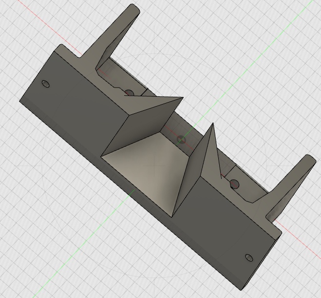

So this is the preview and a STEP model - one half. This one was not printed whole yet, the fit was tested in parts only. A 90x40 version in the same format will follow later.
Edit: It all says 50x40, but it is in fact 50x30.

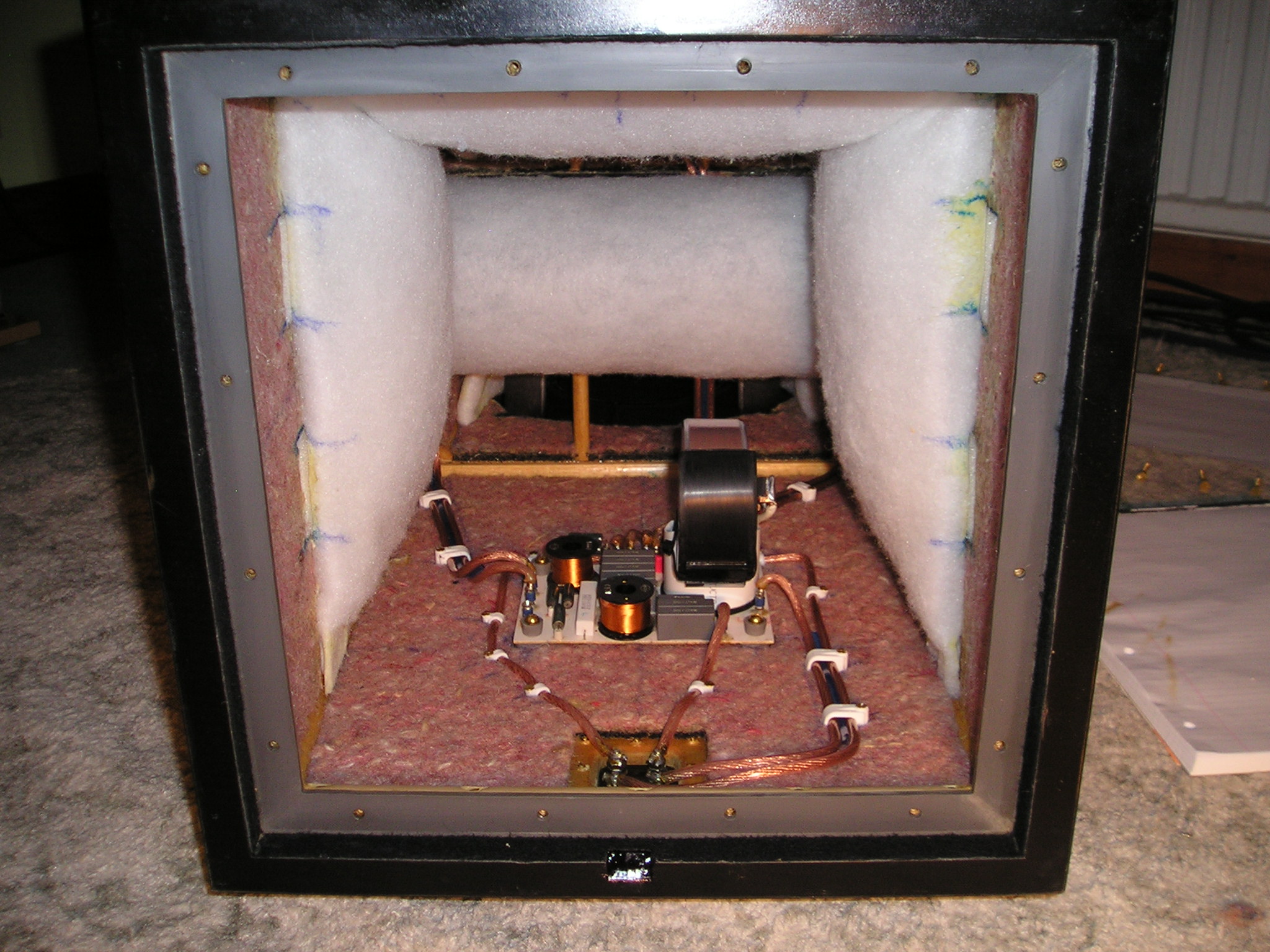

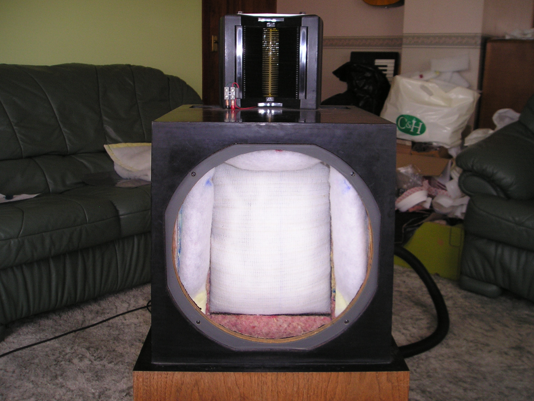

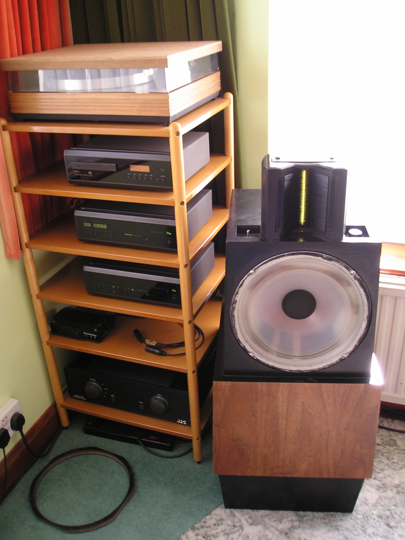

I extensively modded the cabinets, the lower plinth has been increased from 3" to 7" to both increase the height and align the Heil with ears, and to increase internal volume to 105lt.
Each cabinet has 53 braces in it. Switch gives -5dB and the pot -5dB in 0.3dB increments.
Yes I worked hard, gave it my all.

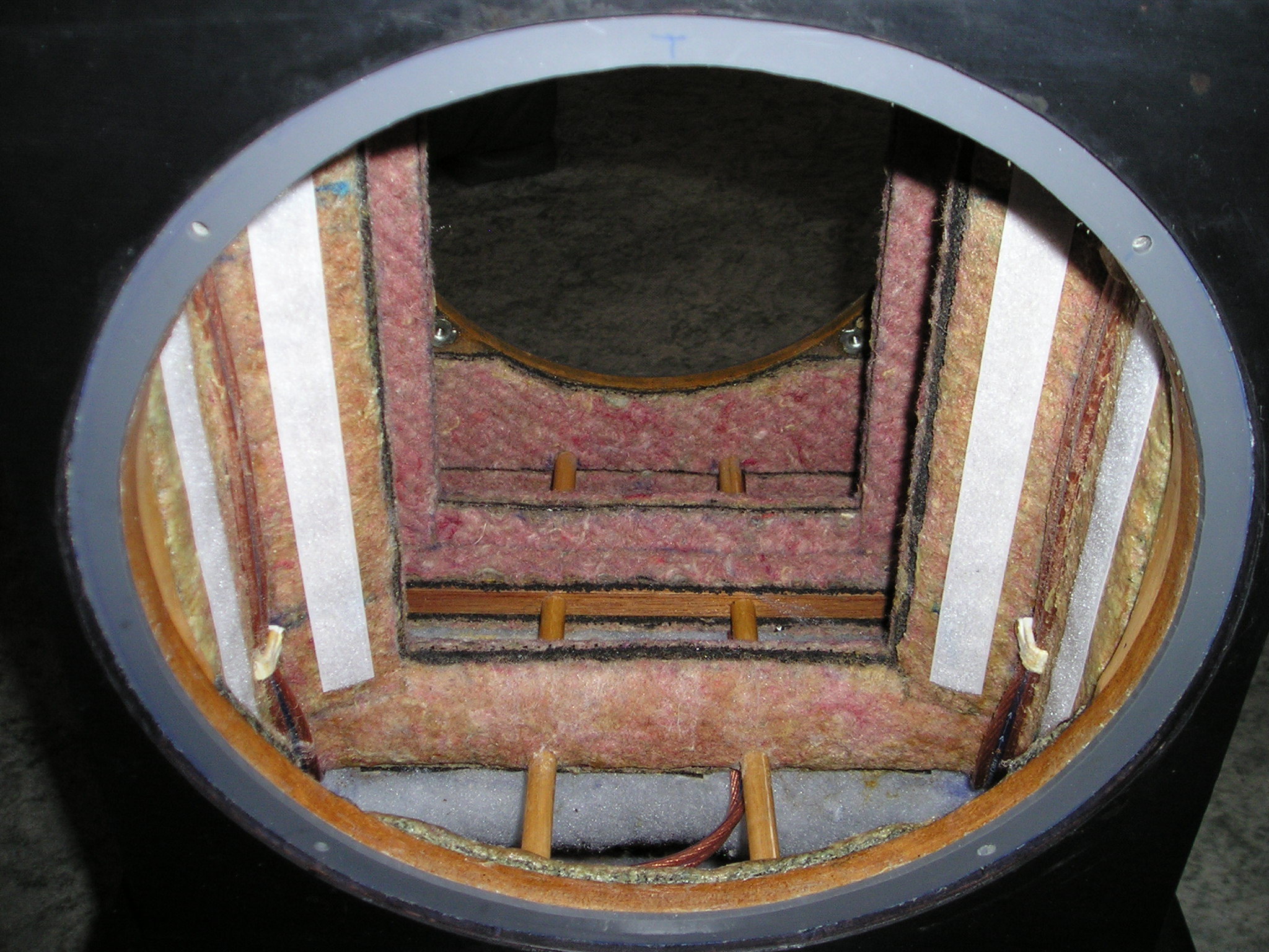

The upper and lower sections are covered in 1mm EPDM rubber to both dampen the panels, and also for durability and cleaning.. The insides were covered in carpet underlay, the type which is composed of shredded car tyre and felt/wool, (usually pink).

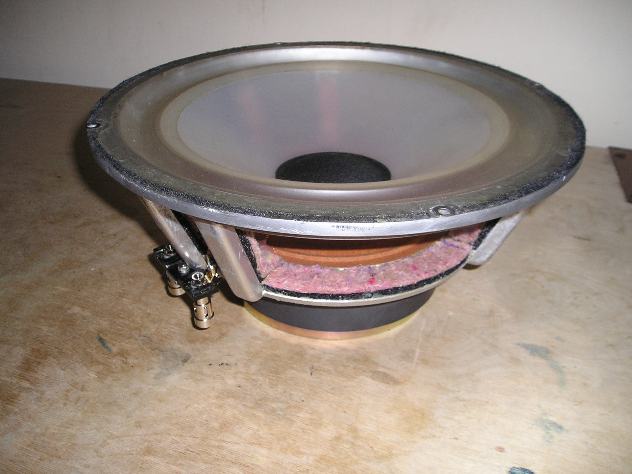

There is a frame behind the mid/woofer which contains a 'cushion' of BAF wadding contained in a sleeve of dacron holofill. This forces the low frequency air down into the bottom and back up behind to drive the rear passive, and also blocks mid range from being reflected back through the mid/woof cone.
The walls in the lower chamber have similar cushions around thew walls, leaving a 'tunnel' for bass resonance airflow. It is wired with 3.8 mm sq Xsection wire.

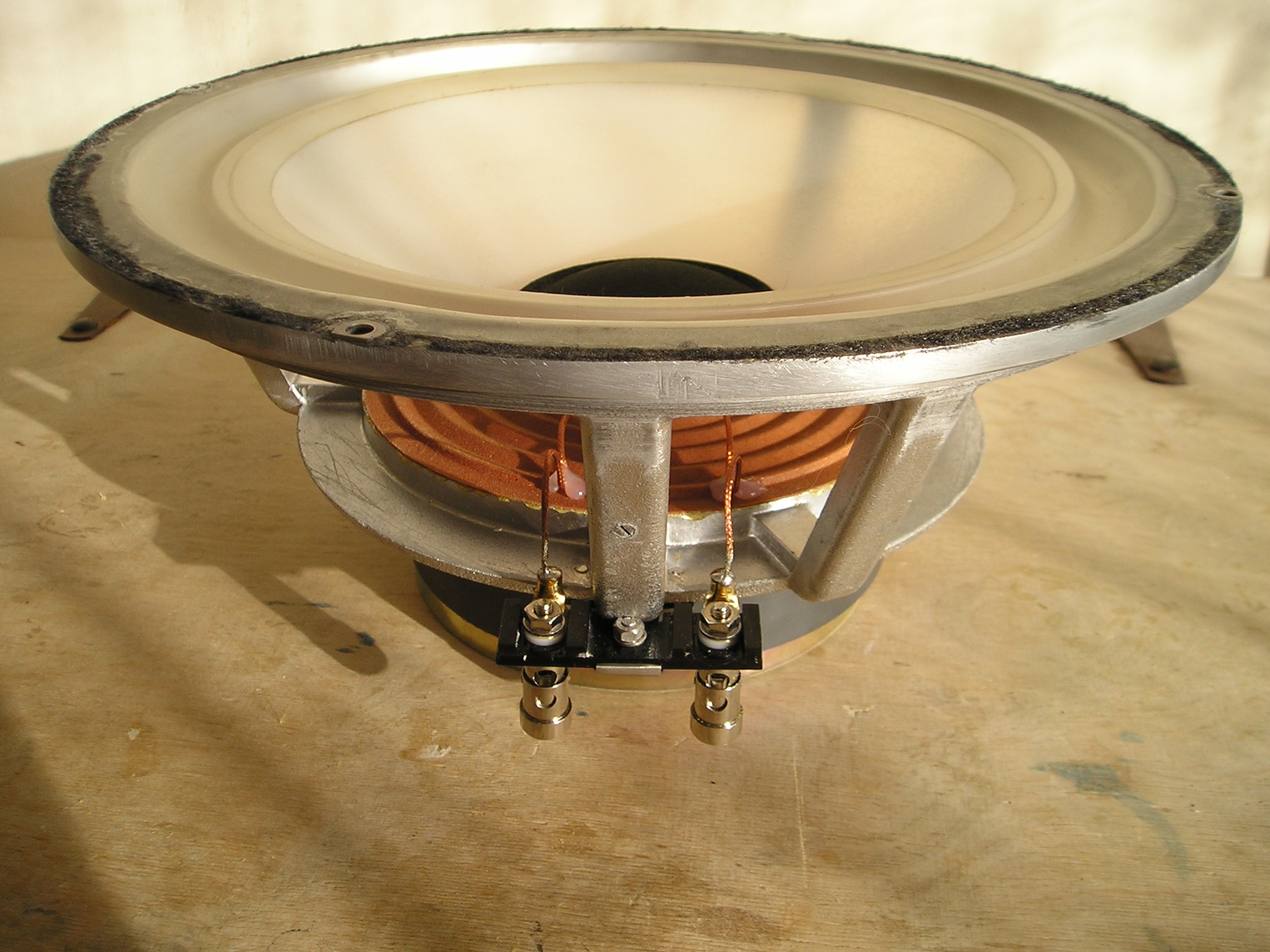

The back frame of the mid/woof also has carpet felt on any reflecting basket frame surfaces, and the surround has been superglued because it was designed for rear mounting, and I have front mounted it, didn't want it pulling away.

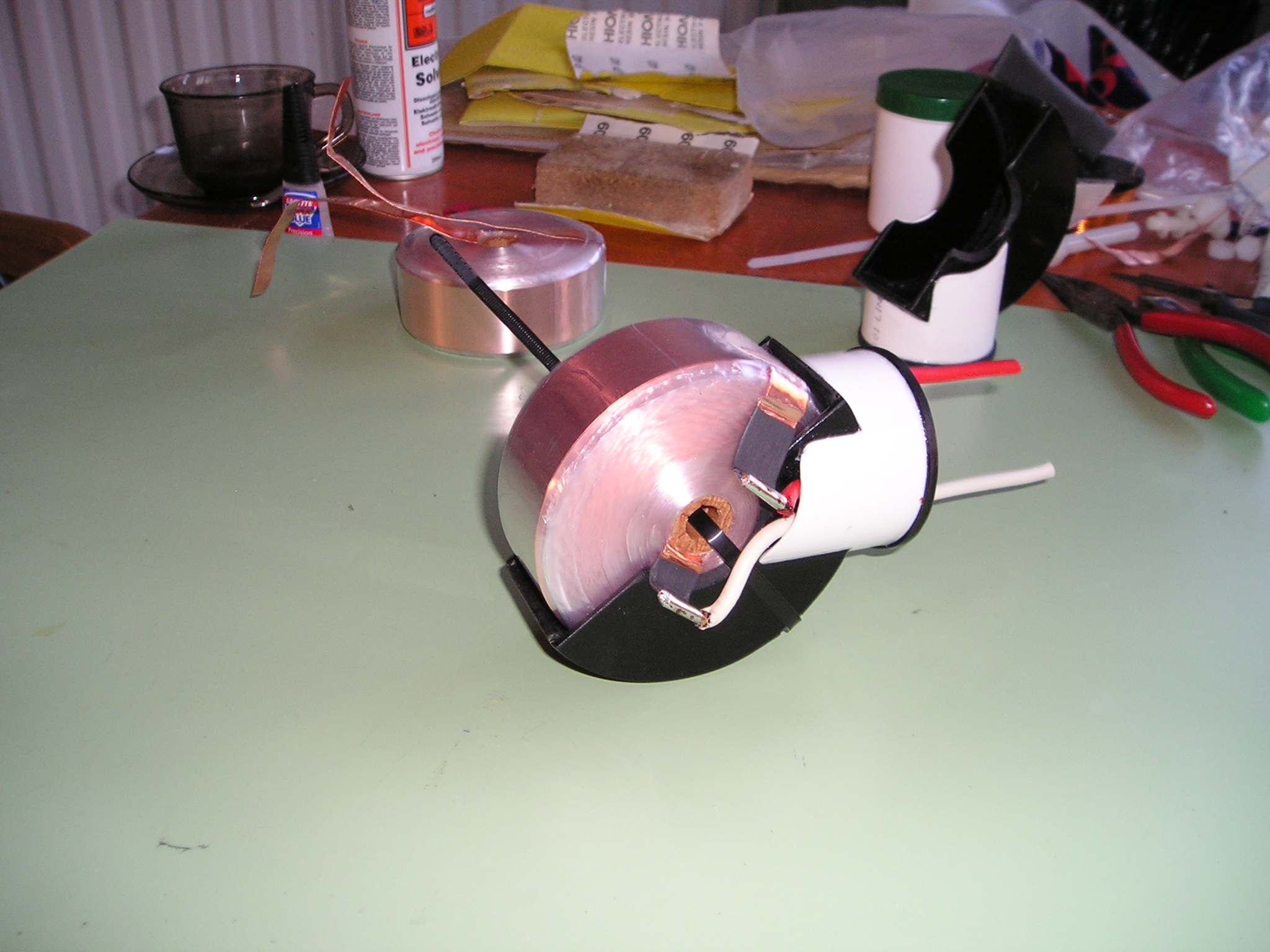

I supported the large coil with a drain piping.
