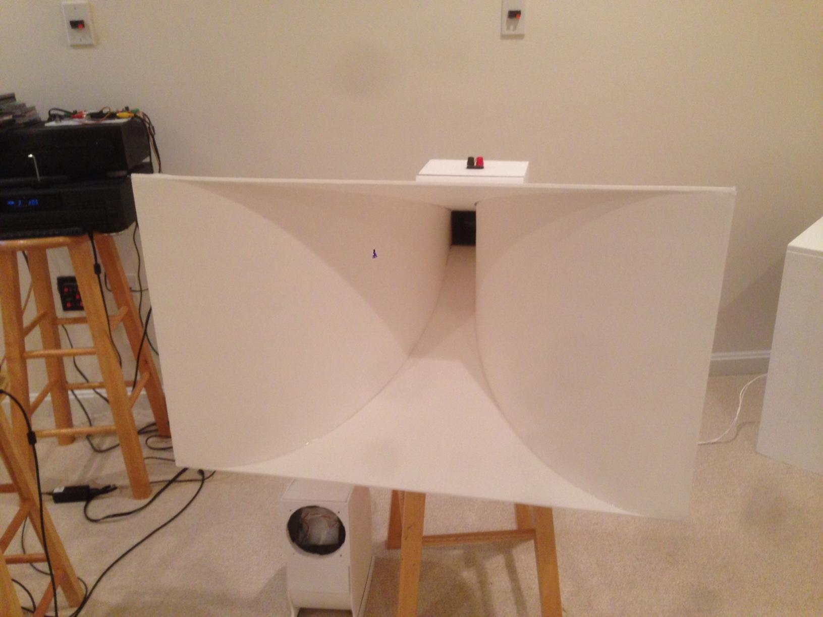

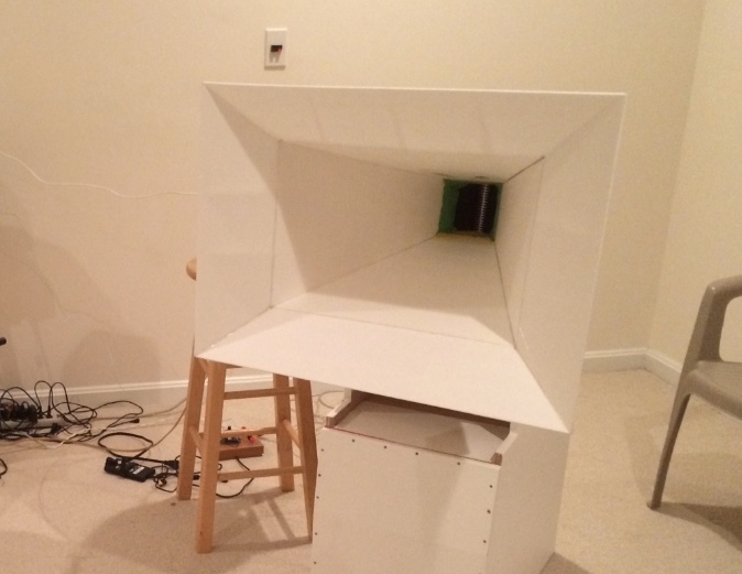

In a big horn (not these little wings), I got down to 600Hz and it sounded fantastic.
You could make an AMT synergy horn with it. A single 6.5in mid side injected into the horn will give you the mids you need and sound fantastic.

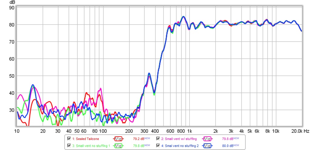

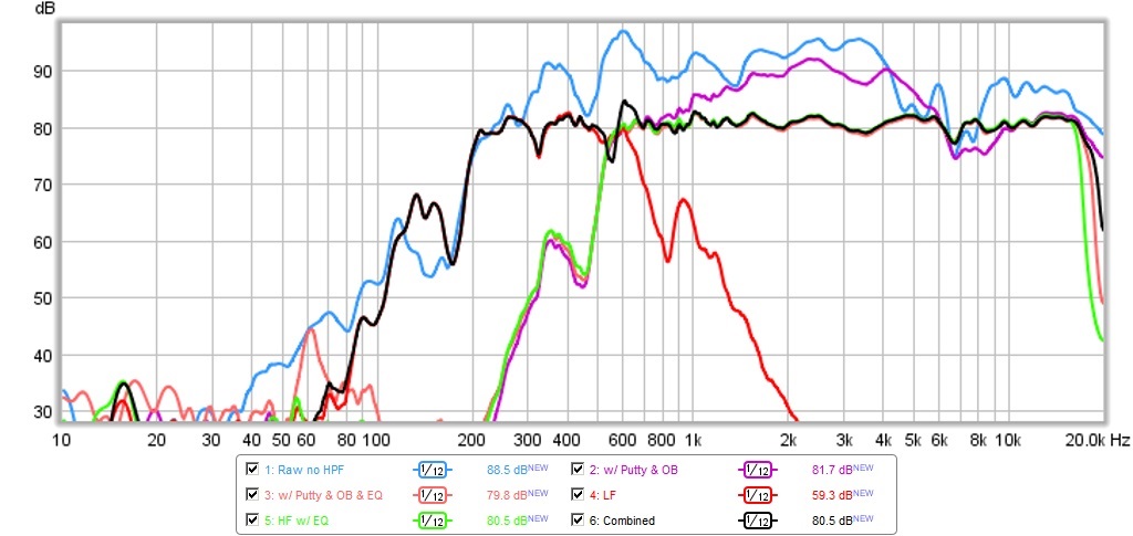

I have shown this before and it remains the best speaker I have ever heard anywhere at any price. I am using a B&C 6MDN44 mid range.
Here is response with the midrange:
Then a front loaded bass horn takes it from this to down to 40Hz.

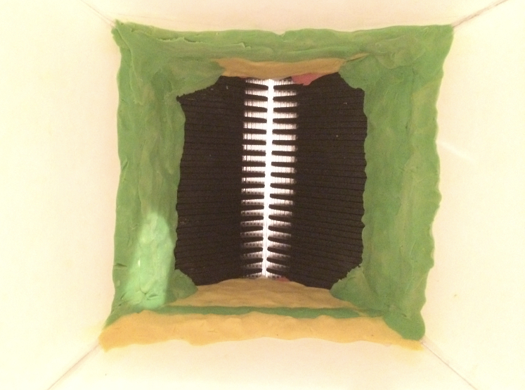

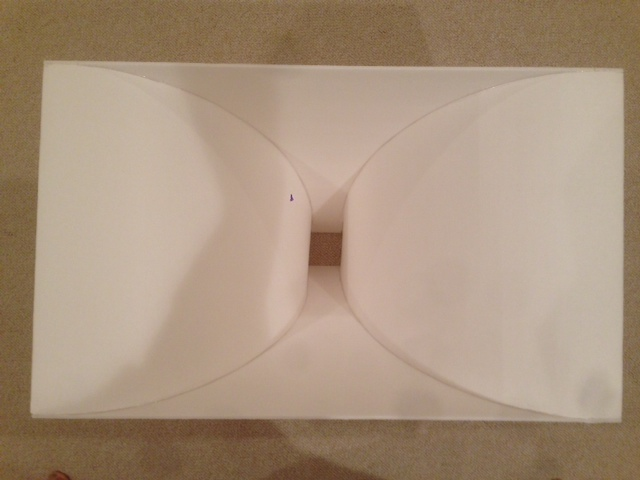

Just a couple of slots on the top wall for the mid injection. The horn throat uses a lot of plastic modeling clay to smooth out the transition. This was before I could print one in 3D.
Here is a closeup of the modeling clay throat transition. Not pretty, but proves that it works. Just avoid any sharp edges, joints, or protrusions near the throat:
much appreciated, would a better snap of the mid slots be asking too much? seems they are not against the vertical walls?
I tried to replicate this in the synergy spreadsheet but failed🙂 I am just measuring the AMT to make a 3D model for attachment of a fully 3D printed horn and back cover.
It looks like the initial angle is smaller than the angle of the opening, which is 90 degrees?

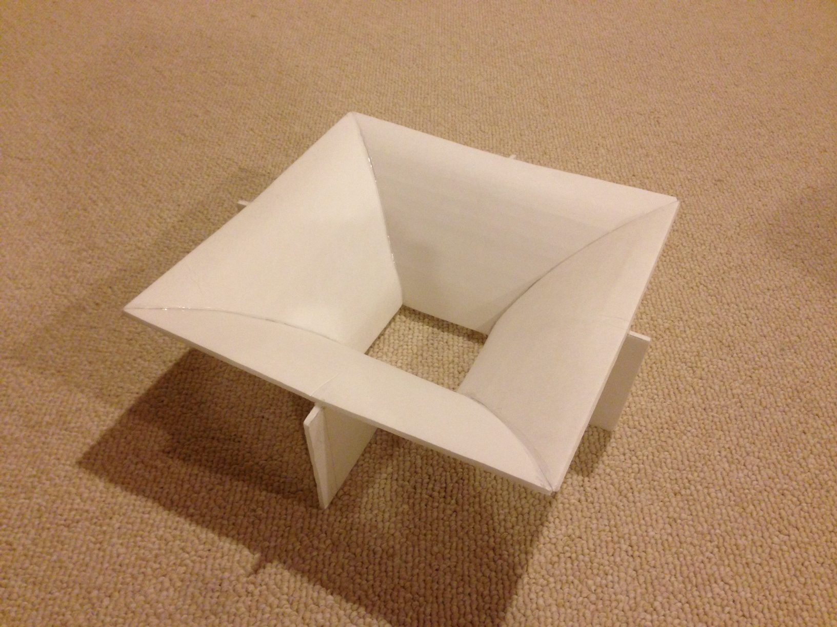

p.s. if you ever do renovate these you could 3D print the 4 sides of the horn with a true exponential profile and glue the sides together (or 3D print one side, make a mould and then cast four sides, if that works out better).

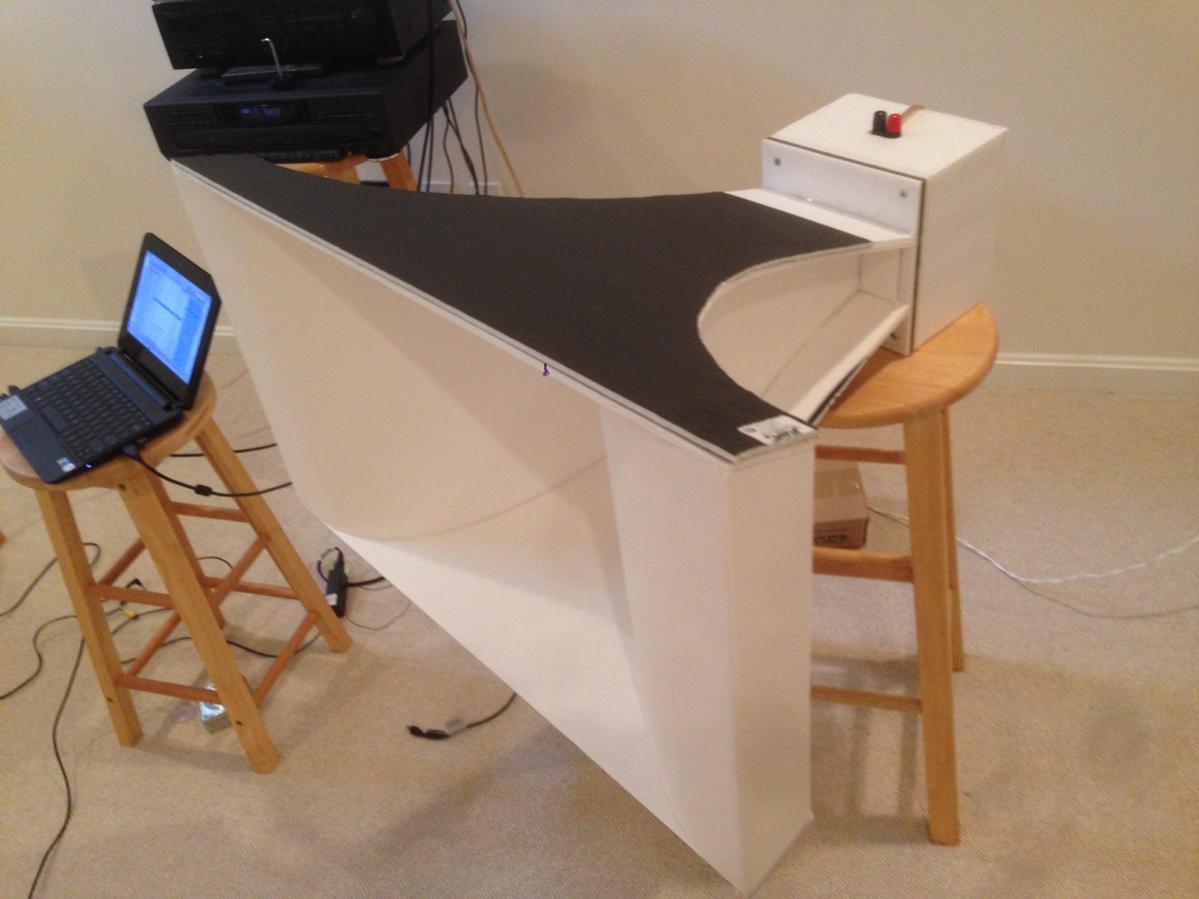

I think it was a 45 deg Horiz and 30 deg Vertical horn, adjusted frequency supported to produce exactly a 30in wide mouth horizontally as that was max width of my foamcore panels. The throat was square but I used putty to transition it to rectangular aperture of AMT. This is where a 3D printed adapter would come in handy.
It’s a big horn, I would not want to print those spade walls. That would take forever and use a lot of filament. Better off making curved foam core or bendy ply tractrix profile. Like this simple 4in throat tractrix I made:

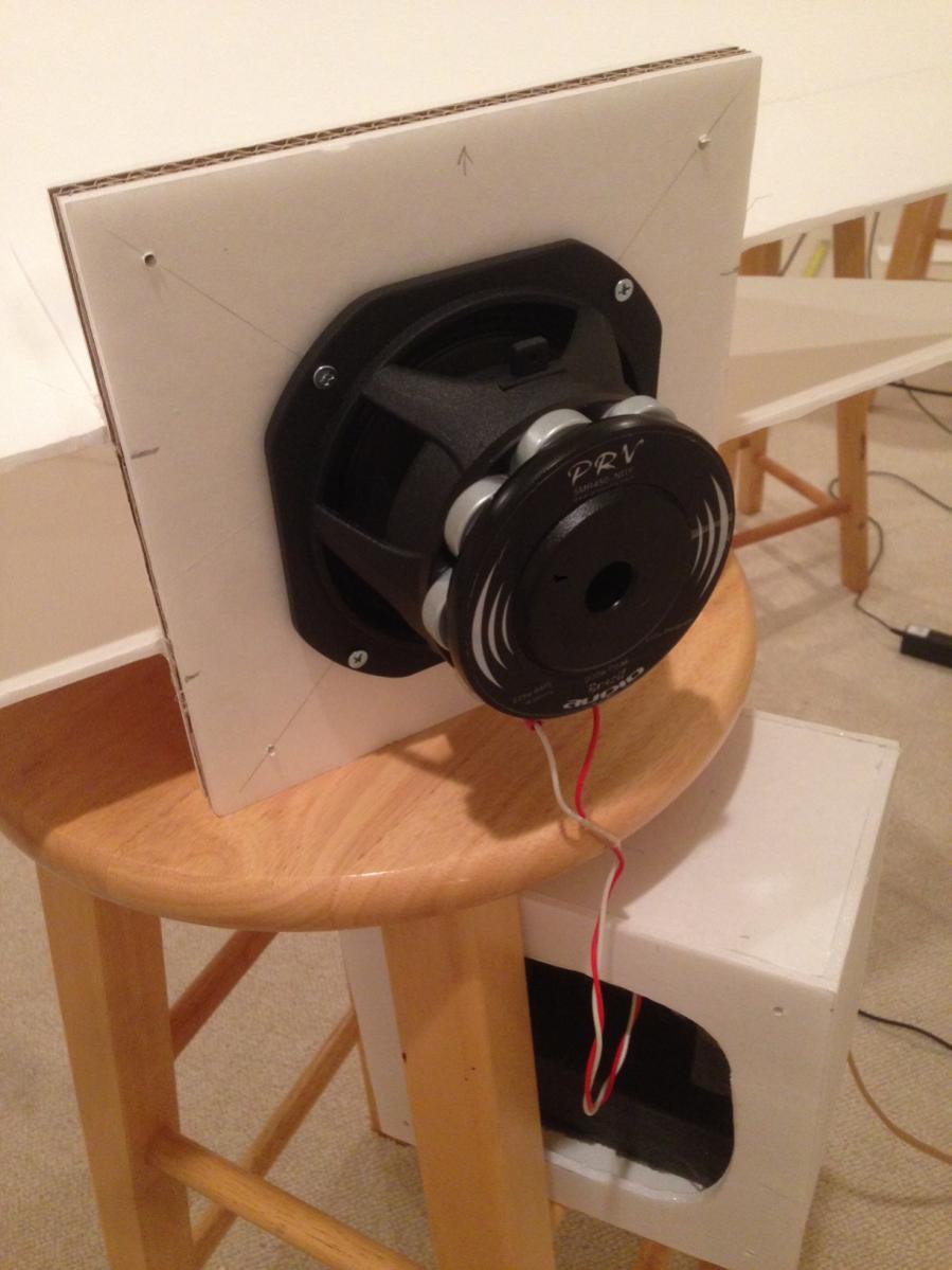

Or this much larger one for a 5MR450NDY driver:
Added layer of constrained damping foam:
Driver and rear chamber:
PRV 5MR450-NDY for FAST/WAW applications

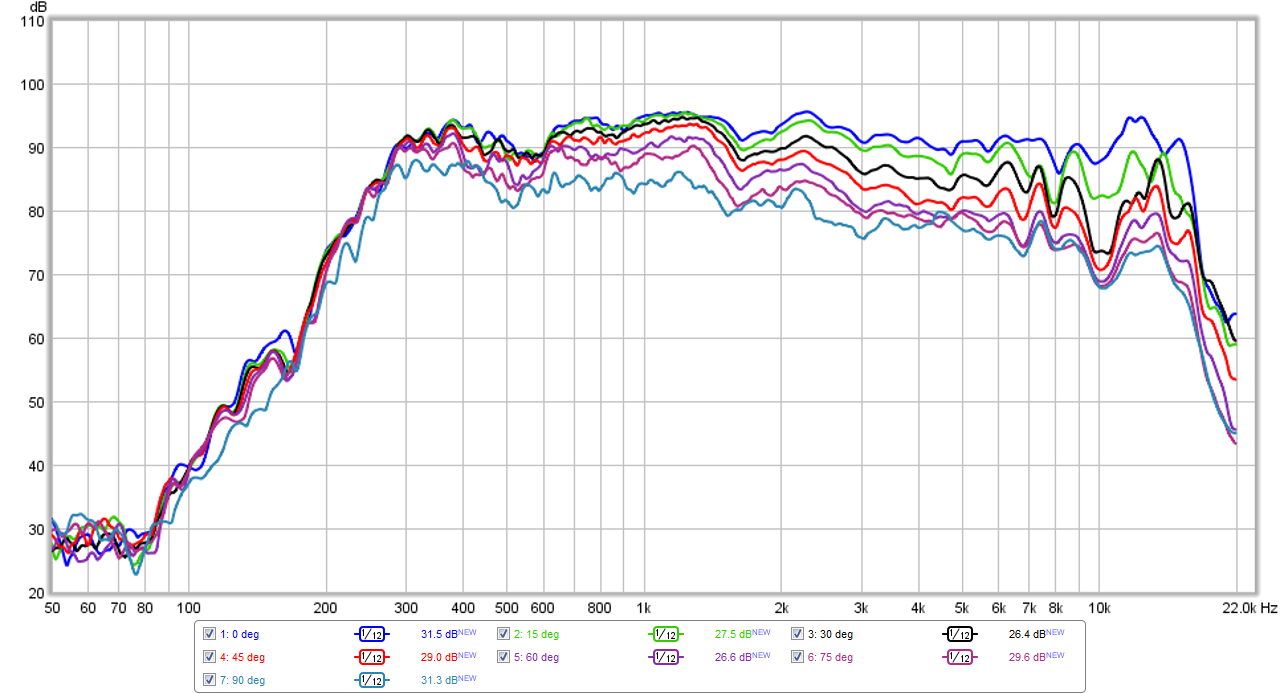

Polars:
They are crazy sensitive - about 105dB at 2.83v. Definitely need earplugs to do sweeps.
These could be used to make molds or even covered with fiberglass like a surfboard.

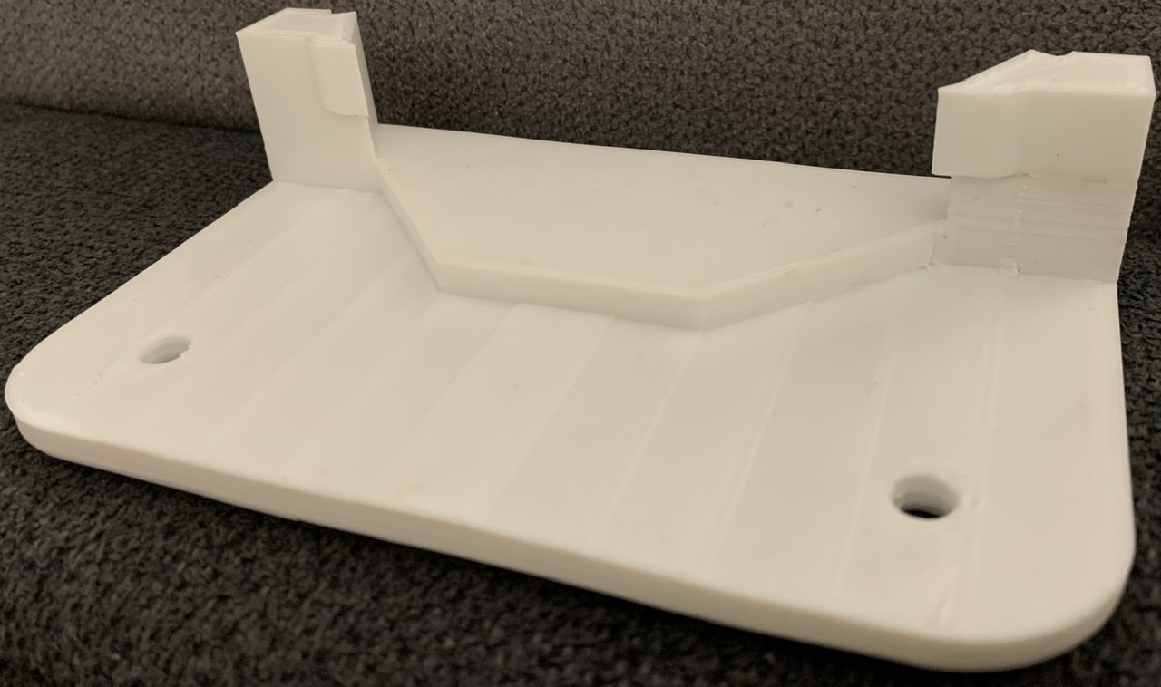

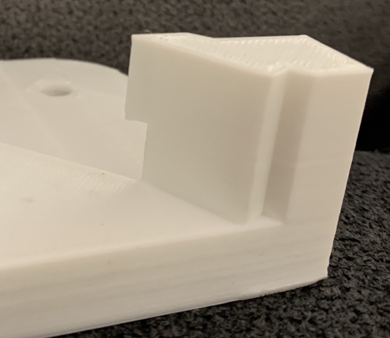

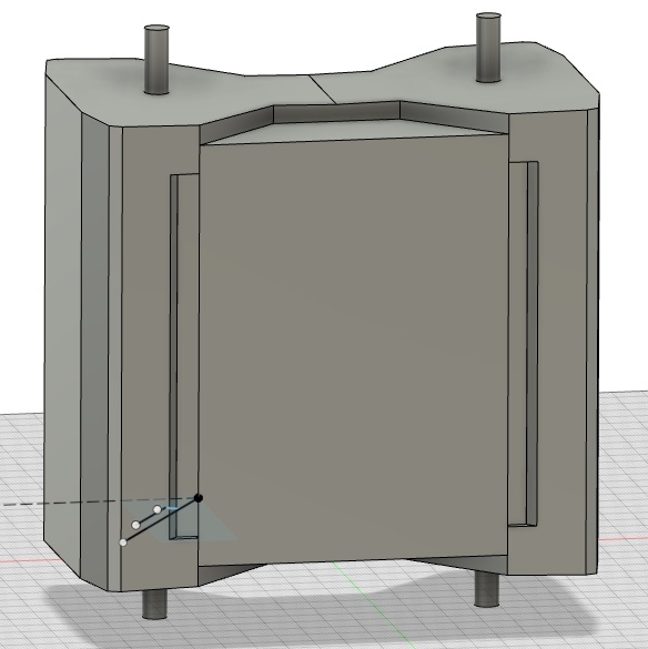

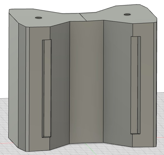

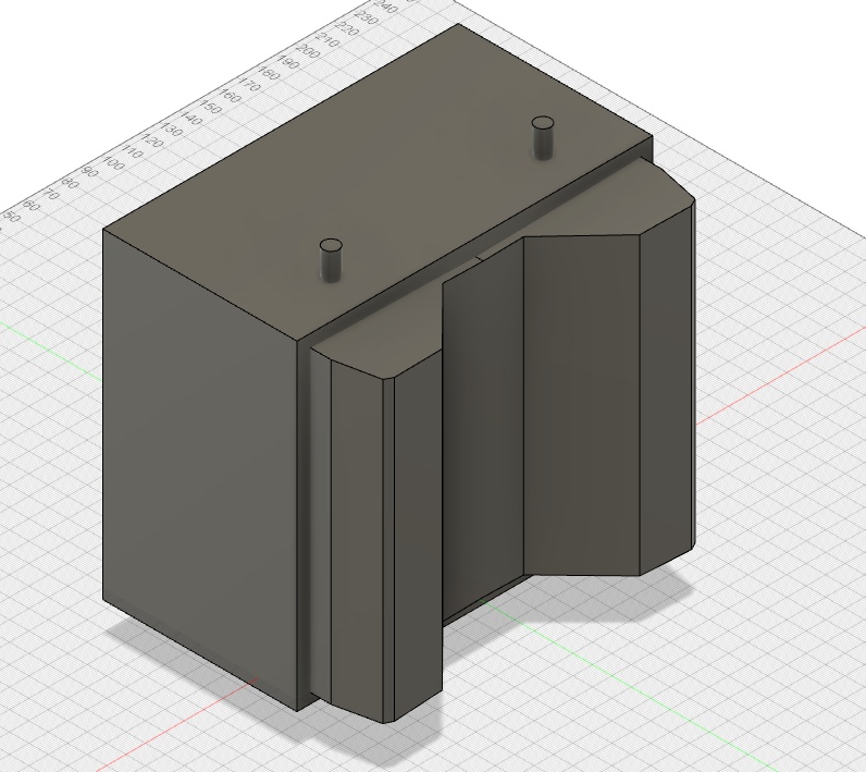

I made a 3D model of the AMT and a negative of it - and a small test print. The final will be printed in two parts. This one fits like a glove (I was surprised with 0.3 mm layer), it needs only some minor adjustments - a flat part with a groove for the wire output.
I need to think about a way how to make the front horn and how to attach it to the printed adapter.

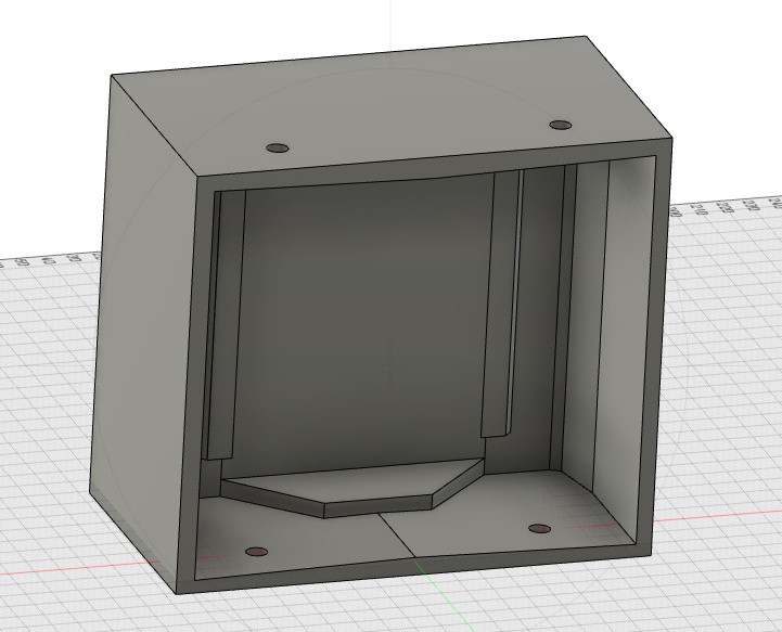

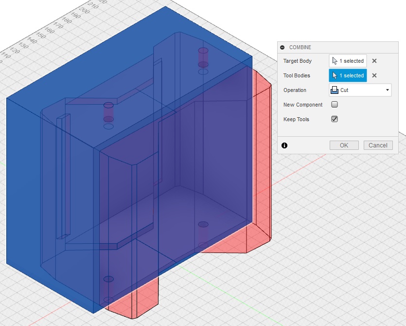

Here is a simplified STEP model of the AMT based on my measurements. I would estimate the precision to +- 0.5 mm. The "cutting tool" for making the front/back attachment is based on this (see the picture) - anyone can do his own choosing his preferred horn mounting method on the other side. It should be OK for the front down to where the stacked metal part starts.
I just made a 3D cube and hollowed it out with the cutting tool - and then it needs only shaping the front as desired.
Edit: There is a slight inaccuracy around the front grooves - that is one thing that needs to be sorted out. I modified this part on the cutting tool a bit, but maybe I should have left it as it was, there is a small edge that I removed - and I actually should have left it in because now the print would need to have this little part removed (easy to do by filing/sanding).
Yes, that is the model on the picture on the left - if you subtract that from another solid, you have a part that fits on the AMT front. It is made by extracting the holes to turn into a cylinder and a part in front of the diaphragm is added where there should be hollow place in the front attachment - on the bottom and the top I left ca 5 mm for creating the chamber. It is like a negative of the front attachment.
Edit: Added pictures to illustrate

It depends where you crossover of course, mine do at 1.8k. ESS did it at 800, 900, and 1k. Looking at both your graphs I think 1.8k is pretty optimal.
