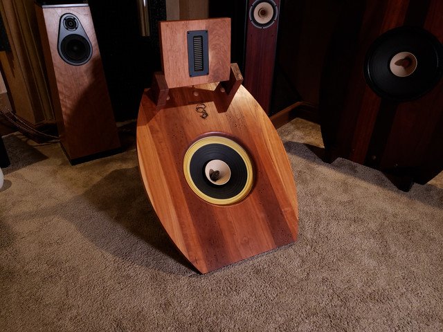

Here is a picture.

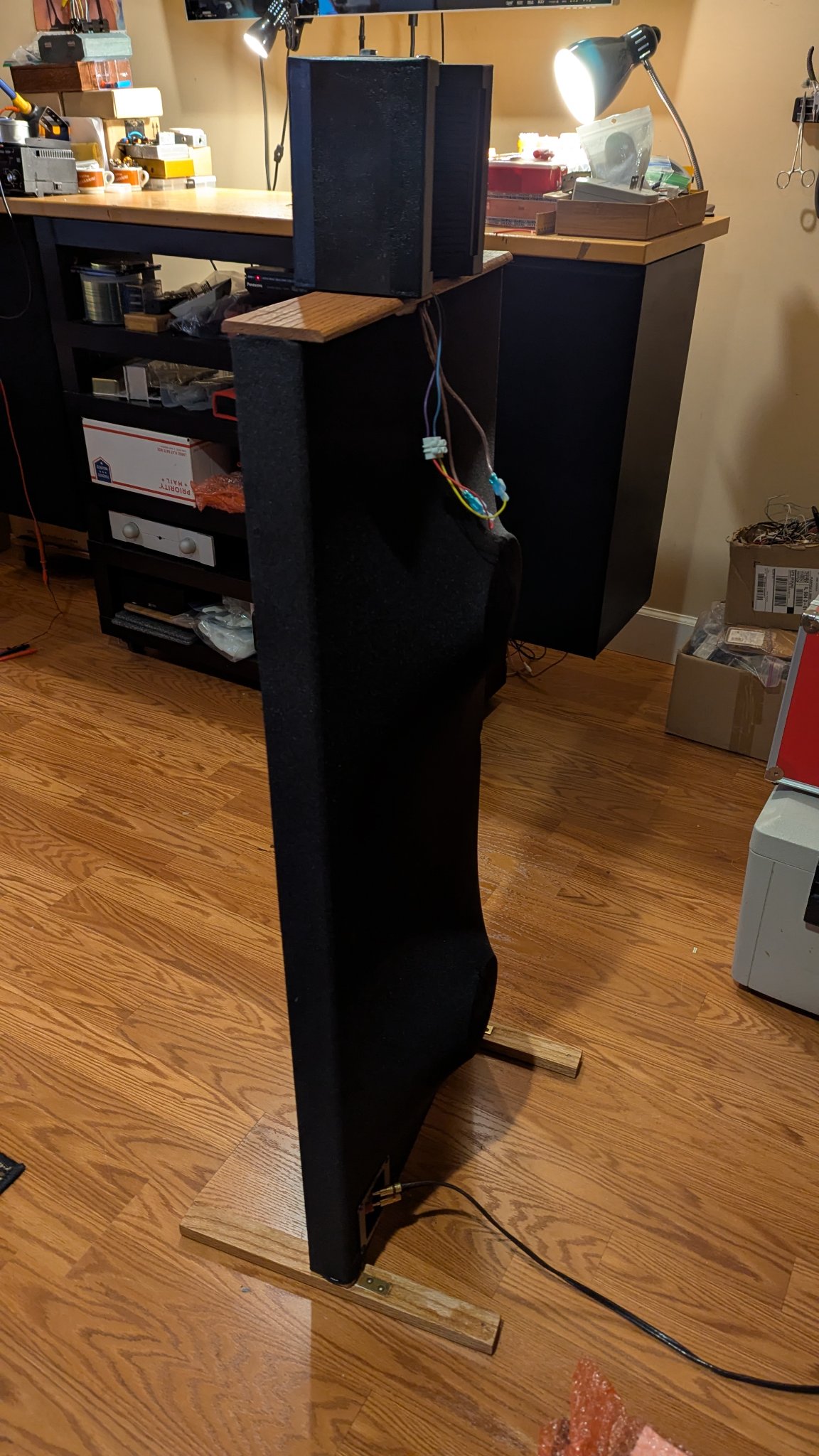

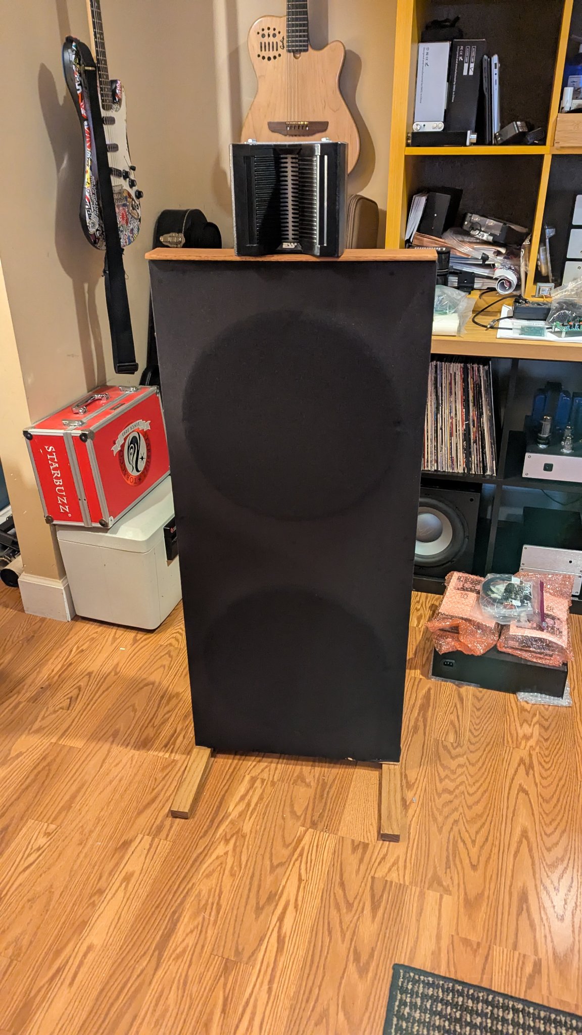

As long as we are posting AMT pics, mine are Emerald Physics CS2 clones, but with AMT Tweeters.
Just two Eminence Alpha 15A on a 3/4" thick particle board Open Baffle with AMT tweet. Cheapest speaker I ever made.
I was running them Biamped crossed at 1k with MiniDSP (and EQ'ed by REW), but have since slapped together a 1st order Series crossover at 1k with a little EQ....real sweet.
Driven by Hypex NC400, a KSA-50 clone, or a Quicksilver 8417 clone amp, depending on how I feel...

Those are cool! What is the amazonian legging-like covering? That seems ideal for an OB build for the lower frequencies!
Black Speaker Fabric from Parts Express. When it goes on sale, I buy a ton of it...
Pulled out my wife's sewing machine and made a nice super tight pillow case sleeve... like I said, cheap....and sexy.
