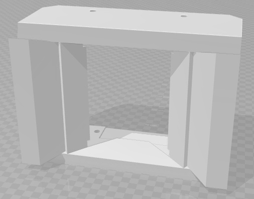

This is my first try for a 90x40 horn attachment - meant for 5mm foamcore or plywood. Do not print this one! It is provided only for viewing. There would be way too much filament wasted. It needs to be cut down, instead of the thick walls, vertical ribs will be used.
That step is for the 5 mm thick side of the horn - if you mean the same step I do. The side walls are mounted from inside and the top and bottom can be rectangular for the first part of the horn. If a flange type attachment is needed, the front part can be simply cut off and there is a 140x140 mm square throat.
You can always do very low density (like printed foam) infill for large volumes. Might actually use less material than ribs which are solid walls.
Do you have some recommended pattern/settings? I am using Slic3r and standard rectilinear fill most of the time, because it worked for me so far. There is way too much volume on this one, but I keep it as a milestone.
For “low density” I use 7% to 12% infill depending on how strong you need it. I use it with rectangular (square) crosshatching - but in an alternating 45 deg angles between layers for tighter porosity. I use Simplify 3D printing software. It’s really user friendly but not free.

wow! what a setup! wonder if the AMT will work with JBL CD horns? the end of the horn has an adapter that can be switched to accommodate any size driver...

terrydaktell: If there is a drawing of the horn available, I could check.
xrk971: I am a noob at 3D printing - Slic3r inside Repetitier Host was the first thing I tried and it worked. I just upgraded to the latest versions and it seems to work even better.
