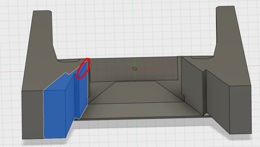

I corrected the inner dimensions of the front attachment since the test print went out slightly smaller (from now on I will heed to "measure twice, 3D print once" rule 🙂 ) and I prepared a slice of the attachment for a new test print.
I also added a part that turns the 90° horizontal angle to 50° (shown in blue). I am actually considering making it a part of the whole print. Any tips on how to make the transition from 90° to 50° better? I could think only of making the part before the step for the 5 mm side a part of a circle instead of flat (marked in red). The edge is ca 21 mm long. It could be made longer if it was worth doing that. But it cannot be moved closer to the membrane (or only some 5 mm) because there the metal inserts start. Or can I go deeper down from the acoustic point of view? It would be a bit of challenge to get it correct but a thin foam strip could be used to seal against the metal plates - if that can be done without affecting the sound quality.
Edit: A picture is worth a thousand words. Now I have the transition starting at the red line. If there was some benefits, I think it could go easily to the blue line and even to the green line with a bit of challenge and using the AMT reversed (logo to the back).

If it means anything Pelanj I was planning on having the logo side to the back as getting an adapter to fit on the on the front seems far easier without the logo being there - seeing as it won't be any more difficult to fashion a plug of sorts for the back with the logo there. Besides, in the horn, you won't be able to see the logo anyway.
If it were me I would aim for the blue line, but that is only due to gut feel and with no knowledge or experience of these drivers!
Are you now going for 50 degrees horizontal dispersion rather than 90? If so, the horn you are planning on making will be enormous!
Yes, I see the logo only as a mechanical obstacle🙂 With a few test prints, I should be able to go down to the green line. For 90 degrees, the red line is perfectly fine. For less, there may be some benefit going deeper.
I am open to both options at the moment, not yet decided. My size limit would be about the size of an SH-50, which is 28"x28" - its pattern starts to widen at 630 Hz and is 90 at 400 Hz (if I interpret the CF2 files correctly).

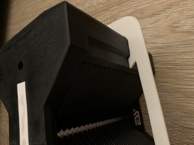

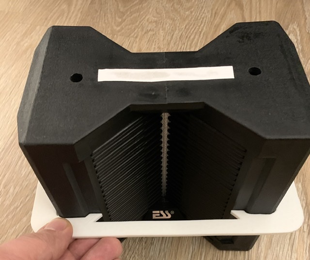

This is my first try for a 90x40 horn attachment - meant for 5mm foamcore or plywood. Do not print this one! It is provided only for viewing. There would be way too much filament wasted. It needs to be cut down, instead of the thick walls, vertical ribs will be used.

I did have a few free minutes waiting for the dinner🙂 Here is what I have - the 90x40 attachment half, 50 deg insert (for 50 degrees I will actually try to go closer to the diaphragm with the model). These are STEP files, so feel free to modify🙂 Also, there is a test slice that fits my AMT pretty well - I used it to test how it would fit the front.
