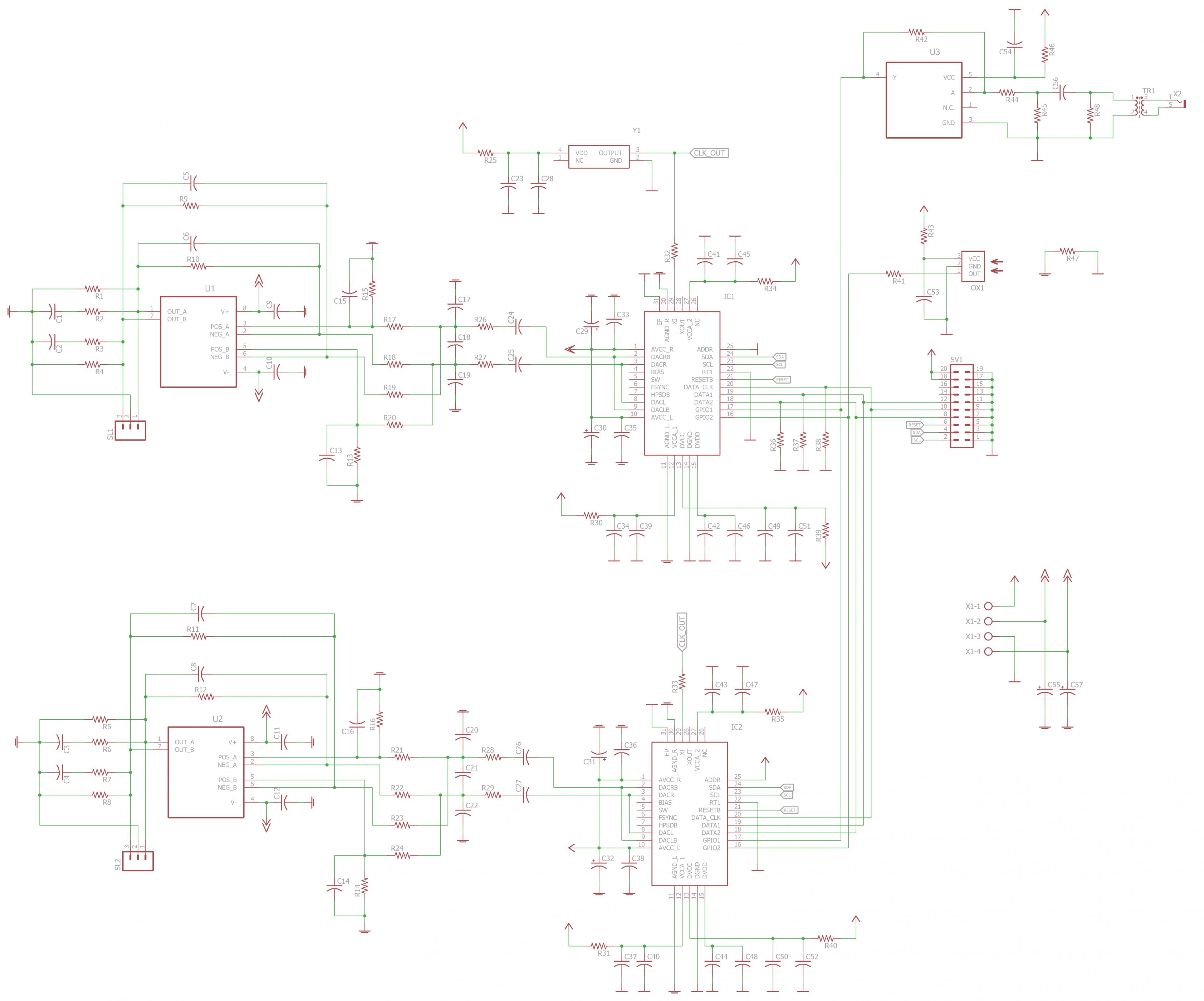

My plan: Dual mono ES9039Q2M. Power supply (not shown) will use 3x discrete shunt 3.3V. My PSU was not tested yet. But I have made +-15VDC and 5VDC discrete shunt regulator. Basic shunt regulator from Walt Jung (he used op-amp).
What are R26/C24 and the likes here for? It looks like you're trying to do passive RC filtering before the I/V stage - won't that mess up the virtual ground that the DAC output wants to see?

Don't know what experience you have with ES9038Q2M. When I look at your schematic I see many problems that can be expected to adversely affect measured and audible performance. Not sure if you posted the schematic to get feedback from us, or you just want to share? If you want feedback, I'm sure some of us would be happy comment.

Why did you think there is a problem? Where are the problem?
I do not have experience in DAC, but I have experience in embedded engineering and I have design many amplifiers, some of them cheap and others can defeat commercial product which much more expensive according to local audio community here.
for starters, as mentioned above by TFive, you appear to be designing a voltage buffer, rather than an I/V convertor. this lowers objective performance considerably with ESS. either perform the filtering within the local NFB loop of the I/V opamp, or between 1st and second stage opamps; but whatever you do, dont do it as you have now. Ideally the DAC outputs should be driving the inverting opamp inputs directly.

There is a pretty good paper that ESS published before they decided to go NDA (more recently, they decided to lift most of the NDA secrecy). Its available on their website: http://www.esstech.com/index.php/download_file/view/69/267/ ...Highly recommend it for careful study to start with. Not just the schematics either, all of the text is important to keep in mind.
Also, something I can post now is the schematic for ES9038PRO evaluation board (attached below). Regarding it, I'm not sure I would do everything just like they do because I don't think its the way to get the best sound out of their chips. I'm just sharing it as a point of reference to start with.
In addition there are some schematics attached to post #3003 of this thread that may be worth taking a look at.
When you are ready we can talk in a lot more detail about options for a really good ES9038Q2M dac design that you could hopefully be happy with.
EDIT: Sorry, was so focused on trying to think of how to start explaining, that I missed replying directly to your question regarding issues in the schematic you posted. I can't think of a great way to say this, but in my view there are more things that are problems than their are things that are right. It feels too soon to take them one by one, maybe better if we can get you thinking in a somewhat different way about these dac chips first.
