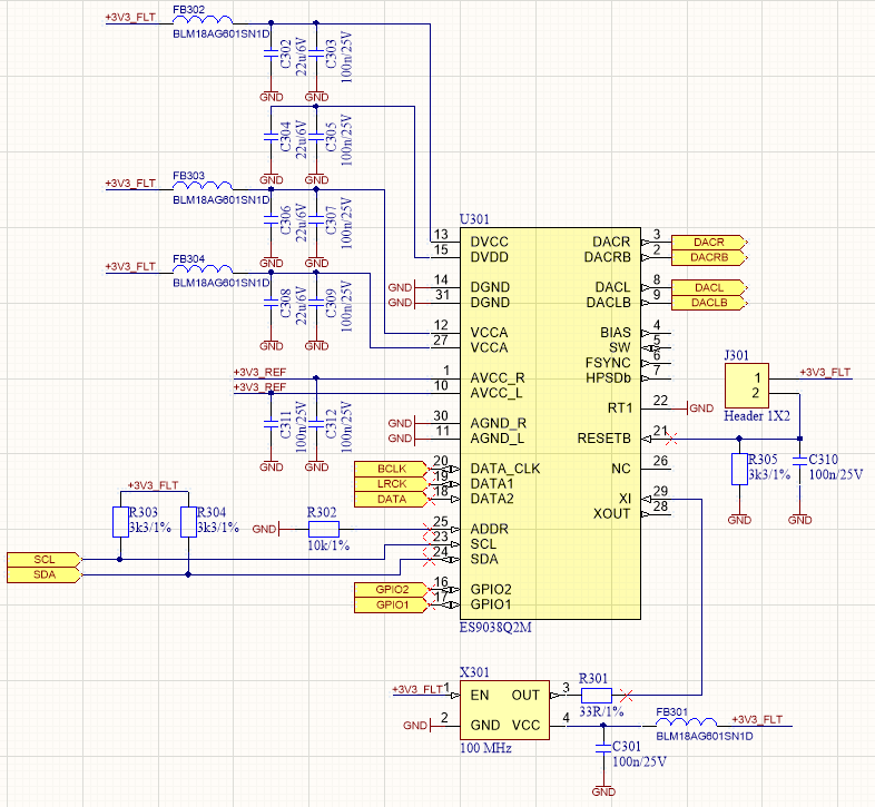

Hey guys 🙂
I have a question/problem regarding the ES9038Q2M. It would be really great if you could help me with your deep knowledge about this DAC.
I'm currently working on a project where I plan to use the ES9038Q2M for high snr sine wave generation. The data stream is generated by an FPGA and supplied via i2s.
I already found out that the DAC isn't operational using it's default register config and that you have to set Bit 7 or 6 in Register 14 in order to get any analog output. Kind of a strange design decision if you ask me, but ok.
At this point I would expect the analog outputs to ramp up to AVCC/2 after writing to register 14. However I only see them ramp up to ~730 mV, while AVCC/2 should be like ~1.65V. Do you have any idea why that is?
Also, after ramping up the outputs I don't see anything of my input data stream on the analog outputs so far. But it seems like the DAC is able to lock to my input data stream, because it will ramp up the analog outputs if I set Bit 6 of Register 14 - which means that the outputs will only ramp up when the DPLL is locked.
Any help would be greatly appreciated!
Greetings from germany, Simon

Hi Mark,
first, thank you very much for your answer 🙂
Lock status can be read from Register 64, Bit-0. At least there is no need to guess about that.
For troubleshooting purposes I would suggest to verify Lock before setting ramp-up in Register 14.
I was sort of "guessing" that the DPLL is locked because I currently don't have any I2C read logic in my HDL design. I thought that I might not need that 😀 But now I will make sure that I can also read back register contents somehow. Maybe that will help me to debug my issues.
But from reading the manual, it seems like my outputs should ramp up to AVCC/2 regardless of the lock status if I set Register 14 Bit 7, right? So the lock status shouldn't be relevant for my AVCC issues, right?
* AVCC voltage is somehow being pulled down when ramp up is enabled.
Nope, I checked AVCC after ramp up. Rock solid 3.3V.
* The output stage is somehow loading down the dac outputs.
I do have an output stage with I/U-converter and differential-to-single-ended conversion based on the AD797. But for testing purposes I disconnected the output stage. So what I measure is the DAC output with absolutely no load on it.
* The power up sequence on page 49 of the data sheet was not correct.
I have the reset on a jumper header and I manually set the jumper after power up of the board. So DVCC, VCCA, AVCC_L, AVCC_R and XI should be stable when the reset pin is set to high. There is also hardware debouncing on that pin. I attached my schematics.
If nothing else, maybe a bad dac chip?
Seems very unlikely. I got two boards and they both show the same behaviour.
Greetings, Simon

Hi Simon,
I would try both ramp-up bits 6 and or 7 in Register 14. Personally, I am skeptical of things always working right at first so I would read them back for confirmation. However, as long as you see the outputs start to ramp when you command them to, then it seems like the dac is trying to do what it should.
The voltage ~730mV seems suspiciously suggestive of a small diode biased on fairly hard. Don't know why an output would stop at that particular voltage at is all. At this point I would probably want to measure AVCC currents at ramp-up to see if abnormal current flows. The datasheet suggests normal might be about 6mA, at least under their specified test conditions.
Mark
PS: Regarding the schematic in your post, looks like it should work. However, I wouldn't especially want to use it for playing music. As a test signal generator it might work okay if low THD+N is the primary concern. If, say, something like sine wave phase noise were a critical issue, and if it didn't measure well enough to satisfy design goals, then I might try doing things rather differently.
Yeah, I don't feel like reading back those particular bits would make any sense at this point. The DAC clearly tries to ramp up the outputs to AVCC/2 on my command. I can also control the time it takes to do that by writing to Bit 4 to Bit 0 of Register 14. The only problem is that it doesn't reach AVCC/2.
Reading back registers might be useful later on for checking lock status, input selection and stuff like that. But I have the feeling that further steps make little sense while there is obviously something wrong with the analog outputs of the DAC. Seems to me that this should be solved first before I spend more time on working with this DAC.
Those 6 mA that are mentioned in the datasheet seem to be correct. I roughly measured the current. The current smoothly ramps up to 6 mA during ramp up of the analog outputs. No signs of excess current draw during ramp up. My AVCC Buffer seems to work fine. AVCC stays at solid 3.3V during ramp up.
You are right, low THD+N is the primary concern for this sine wave generator. Well, to be honest, my biggest concern right now is just getting this thing to work 🙁 I'm pretty lost at this point. I got no idea about what could be wrong.

Hey Mark (and all the others 😱)
I solved my issue. Turns out I'm an idiot. I didn't properly disconnect my I/U-converter stage from the DAC output. I disconnected the OP Amp, but I missed that it's feedback path was still connected to the DAC output. And obviously that was pulling down the DAC output to ~730 mV. After disconnecting it properly, the output ramps up to AVCC/2. Oh boy, that was a very stupid move.
