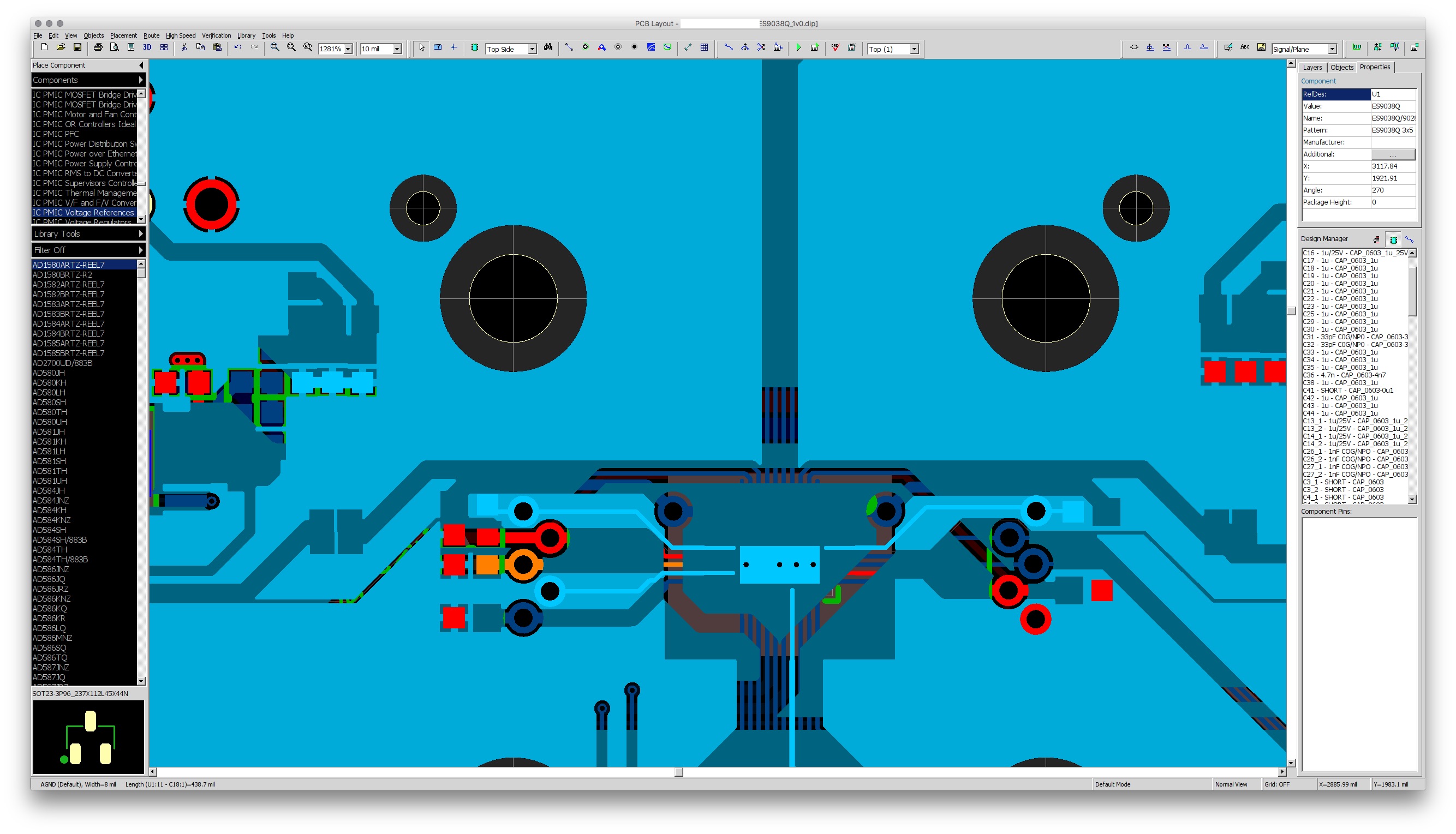

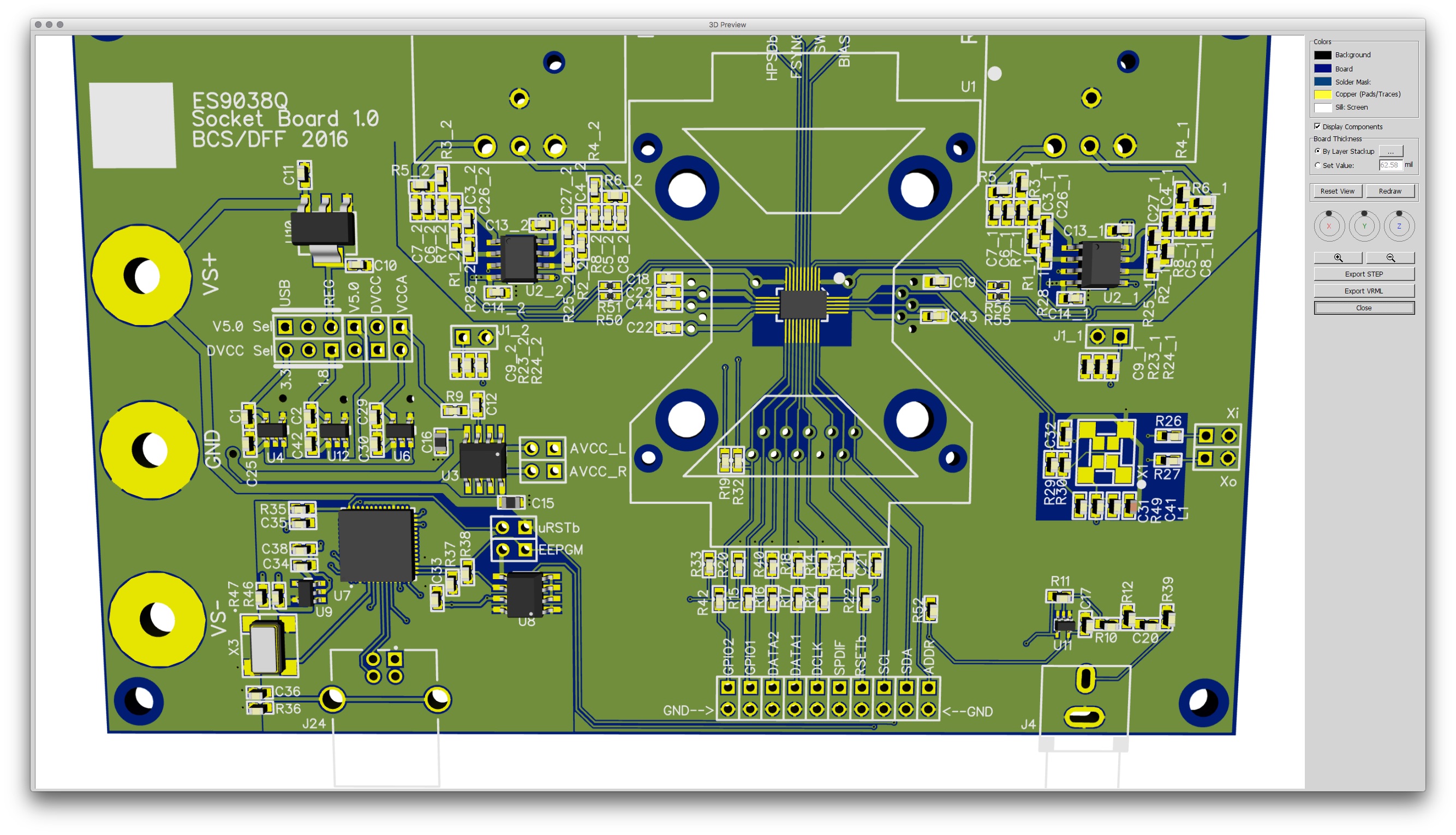

Yeah, it's not bad Mark, but its not great. True though, I guess it must be able to meet spec. presumably that also means you can get better than datasheet performance, without herculean effort.
@proid indeed, those decoupling caps are a LOOOOOONG way away. the whole power supply situation seems a bit half baked, but yes, its an eval board, for a low power mobile DAC chip, which happens to perform rather well given those constraints..

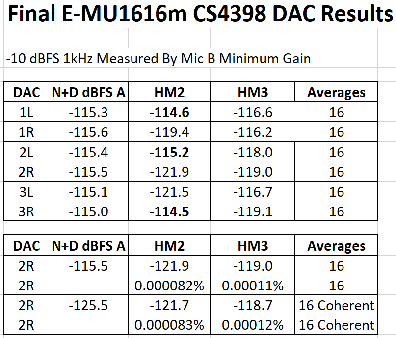

Can someone suggest a fairly simple/practical 1kHz bandpass filter to use with this ES9038Q2M DAC for the purpose of testing an ADC with a cleaner test signal?
I am working on repairing/restoring two multichannel interfaces that have nice ADC chips and I thought that this ES9038Q2M with a bandpass might be a suitable cleaner test signal. Does this make sense?
Right now I am using the CS4398 inside one of the interfaces as a test signal however the AK5394 ADC in that interface is as good (or a bit better) so that is not the best test configuration. For example, I get between -113.0 to -122.3 dB second harmonic depending on the channel for the six different CS4398 outputs but the six different AK5394 inputs range from -116.6 to -122.2 dB. So I would like to use a bandpass filter (if that makes sense) to improve the capability of loopback testing of the ADC. For testing the DAC I will use the Hall notch filter.
I am trying to figure out the mystery of why one half of a CS4398 measures -113.6 dB while the other half measures -121.7 dB. There are several channel pairs (which share the same CS4398) that have a big difference between the two sides of the same CS4398 chip. The layout looks nicely symmetric so I don't think that is the cause. So the first step is perhaps to improve the measurements to make sure they are really valid. The ADC are more uniform but there are two channels which are not as good as the other four.

Attached are the results of the six repaired channels of the E-MU 1616m (CS4398). ADC is AK5394. That is what I am using right now for testing. Three CS4398 halves are markedly better than the other half of each chip. [Repair consisted of first repairing two dead power supply sections and then replacing and upgrading over 50 dried out low quality capacitors. Over 30 on one PCB and over 20 on the other PCB.]
How well do you think the bandpass output of the Hall notch filter would work for cleaning up the ES9038Q2M output to serve as a low distortion test generator? Right now I am using LM4562NA in the Hall notch filter.

Does it make any sense to look at component matching in an attempt to understand why one channel of a DAC is -121 dB HM2 and the other channel is -115 dB? I am curious as to the cause.
I replaced the dried out old electrolytic caps, measured, replaced them again and measured again. That does not appear to be related to the channel to channel variation since after the big improvement from the first replacement the measurement results were very stable after the second replacement.
Since the two channels share the same DAC chip I guess I have the filter caps, resistors and opamps left to consider?
By the way the DAC and ADC are all balanced.
Maybe be some funky solder joints too. Don't know. Guess you will have to try some things and see what happens.
Perhaps I will try using the 5 digit DVM to measure the resistors as best I can. And inspect it some more. Then decide if I want to try upgrading one channel pair to OPA1612. (In case it is the opamp. After ten years of service in a studio I wonder if there is any chance of ESD induced issues?)
