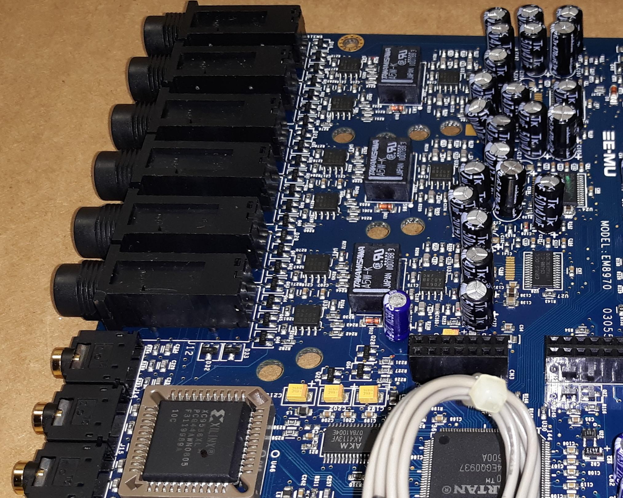

It does not look like they followed AN48. The extra electrolytic is not there.
Layout wise it has two electrolytic caps (both 47uF) placed between the CS4398 and the first dual op amp package. There is the official EVB (attached) but the physical location of the electrolytic caps in the layout does not seem to make sense for that circuit either. (Unless there are traces going the long route.)
Physically the layout locations seem to be something along the lines of:
CS4398 > 2x47uF > NJM2068 Filter > Relay (for -10 or +4 levels) > 2 More NJM2068 For Balanced Output

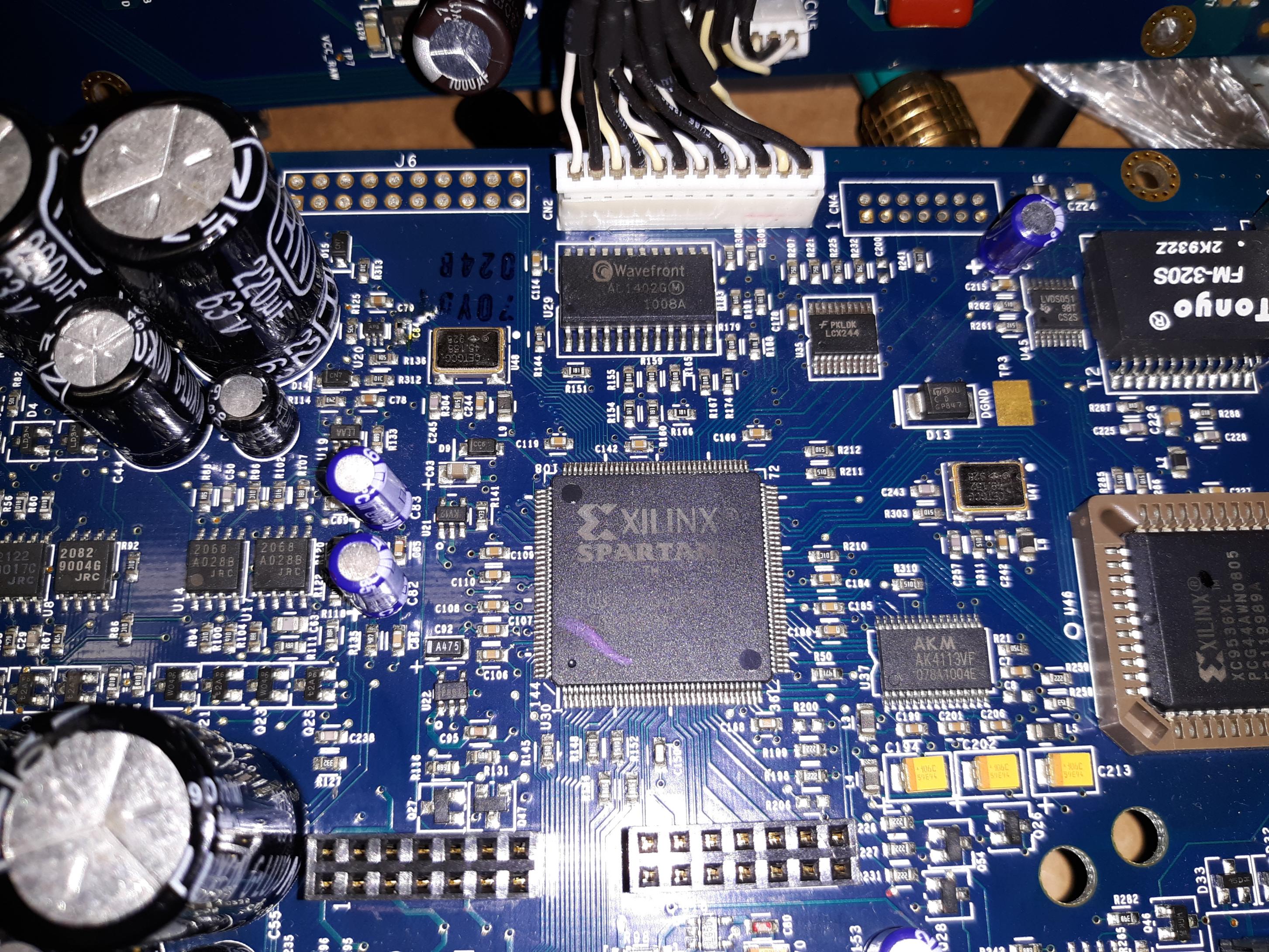

Has anyone ever managed to extract usable data from the on board controller?
I think someone in this thread once dumped the I2C registers in order to address start up issues.
What people have done is monitor the I2C bus when the dac boots up and or when inputs are switched by moving jumpers. Capturing that data gave some clues to using the dac chip. However, now that ESS has opened up the datasheets we are free to talk about how to program the dac chip to do whatever. No longer any need to watch the dac board MCU do it.

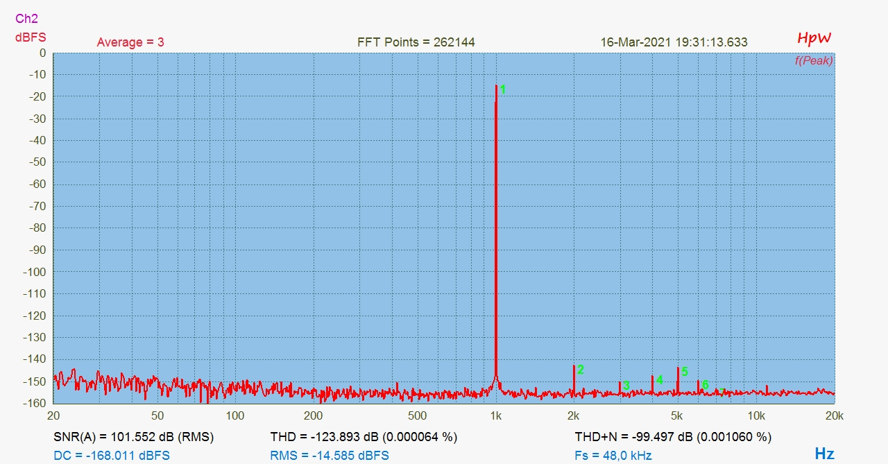

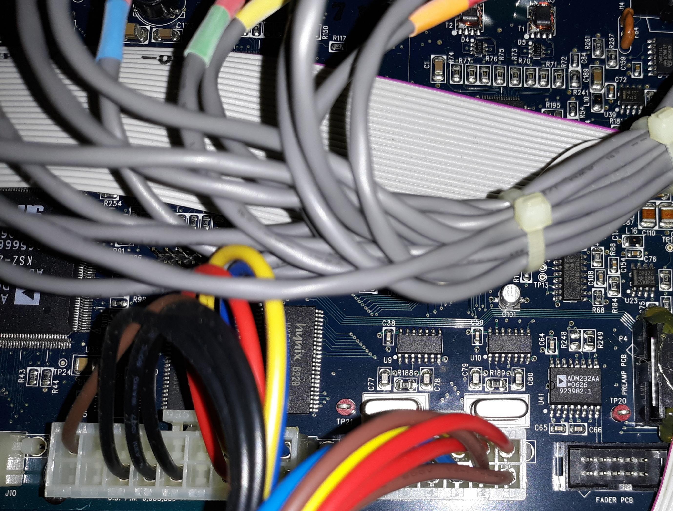

I have been working on improving both the measurements and sound quality of my interfaces (which I have used to measure my ES9038Q2M experiments) and I have some questions regarding clocks and jitter.
The first picture is from the E-MU 1616m which is the best measuring equipment I have right now for my DAC measurements. It has a very good JTest result in REW. The vendor appears to be TAI TIEN ELECTRIC for the two oscillators: CETGCG 45.158 and CETGCG 49.152 are the markings. E-MU describes it as an "Ultra-low jitter clock subsystem". I don't know if the Xilinx Spartan FPGA is part of the reason for the very good JTest results.
The second picture is from a Digidesign 003 rack which has much worse JTest results. This is disappointing for a number of reasons. Since this interface comes with CS5361 ADC which are pin compatible with CS5381 I had a number of planned uses for this equipment. (Not just making measurements.) Each oscillator consists of an HC-49 crystal, two caps, one resistor and one Philips/NXP 74HCU04D hex unbuffered inverter. Would this type of clock be expected to produce dramatically worse jitter?
I was thinking of making a small board with the CETGCG or similar oscillators and Micrel MIC5219 ultra low noise regulators to "upgrade" the Digidesign 003 rack clocks. (The MIC5219 are used for the E-MU 1616m DAC and the loopback looks very good as far as noise/absence of any spurs.)
Does this upgrade plan sound like a promising/sound approach?
I was thinking of removing the HC-49 crystals, caps and resistor and then inputting the new clock signal into the 74HCU04D input (which is pin 1 the way the crystal is connected).

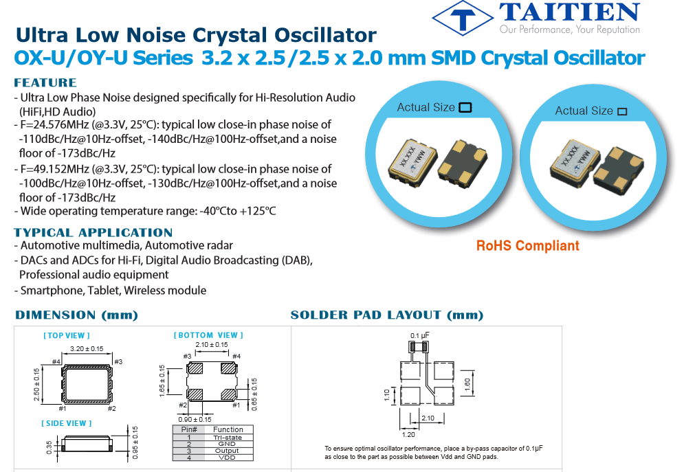

Edit: I don't know what series the "CETGCG" marked oscillators are, however I just found that TAITIEN makes low noise oscillators specifically for high resolution audio (at least that is what the datasheet says). That is the attached third image.

EDIT: Regarding the Taitien clocks you referenced, they require decoupling much like the small Accusilicion AS318-B clocks do. For the latter a 402 size cap is needed within 1mm of the clock power pad, and with a direct trace going to the clock ground pin. If not decoupled to spec, the small AS318-B clocks may not work. The layout shown by Taitien on the sheet you attached shows a very similar arrangement. The other thing about Taitien clocks is that I don't know of a source for them, again much like the situation with small case size Accusilicon AS318-B. As a practical matter it seems NDK SDA or Crystek are the best audio clocks that are easy for diyer's to find (and with a good implementation they can actually be quite good). The last thing about clocks, again IME, is that they are most stable when left running constantly. If implemented that way, it adds some complication to the design.

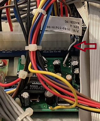

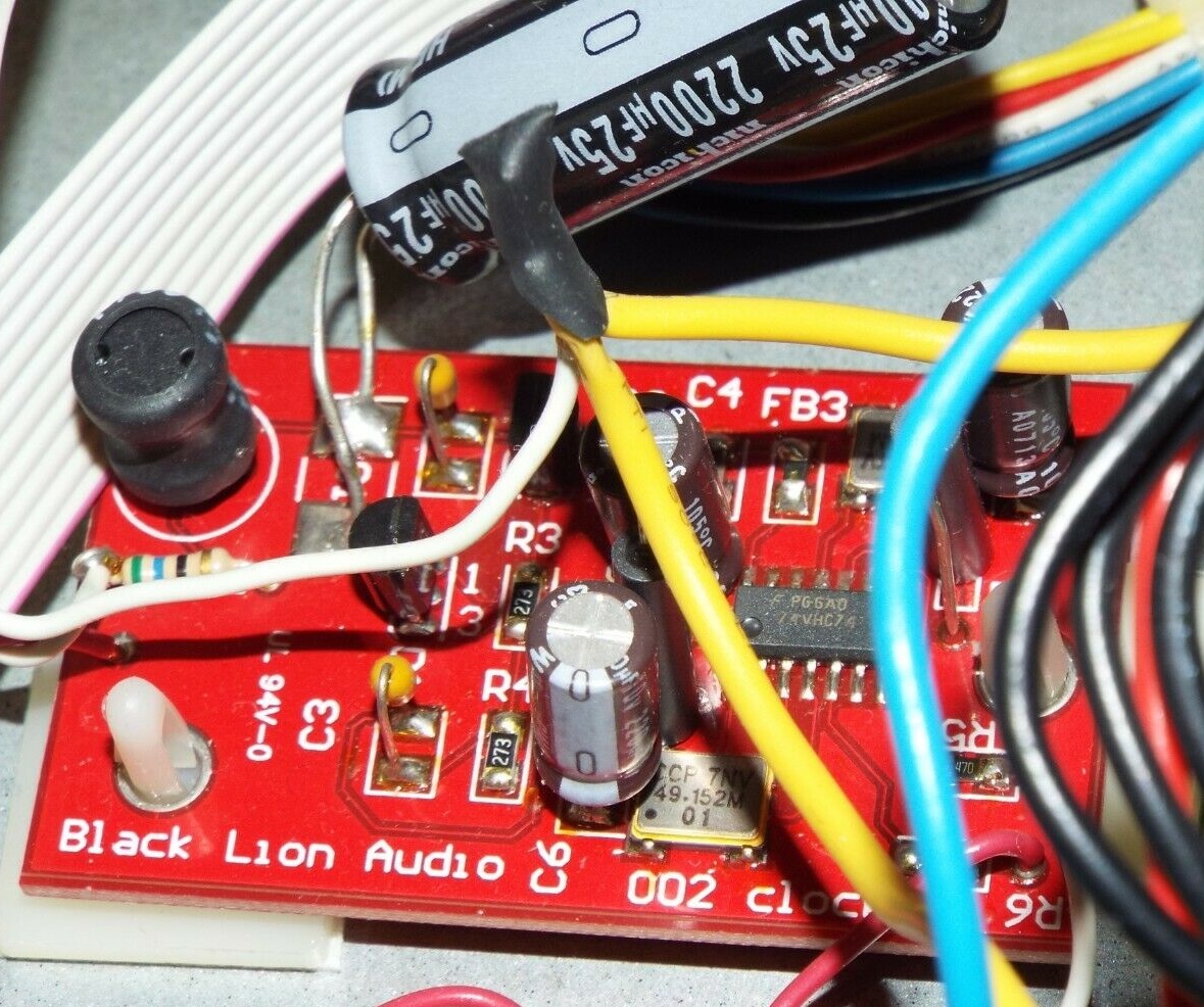

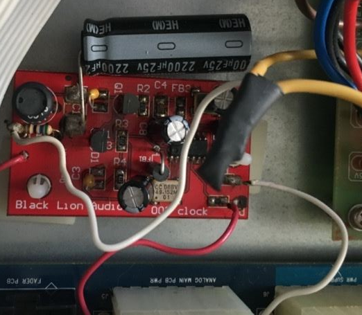

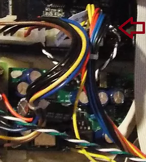

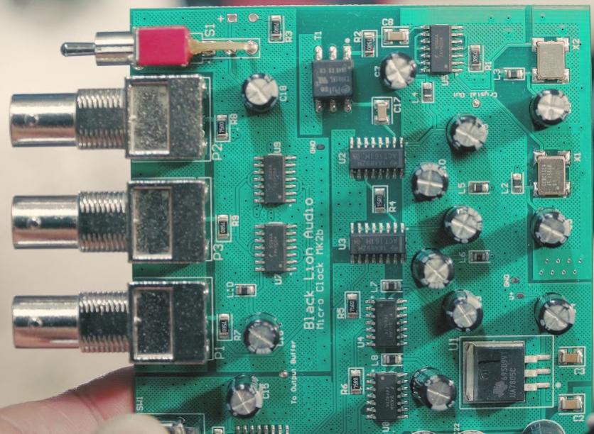

There is apparently a bit of an industry in existence which modifies/improves these recording interfaces. I have not been able to find the clearest pictures but I have attached images of:
- Image 1 & 2: Older (Digidesign 002 Rack) upgrade clock PCB (red).
- Image 3 & 4: Newer (Digidesign 003 Rack) upgrade clock PCB (green).
- Example external clock from the same vendor as the upgrade PCB.
So based upon this detective work I am hopeful it is worthwhile. I will look into the oscillators you mentioned and try to be extra careful on the regulator, layout, bypassing, etc.
On two of the images I have placed red arrows showing the black and white wires which connect to the digital PCB. They appear to be going directly to the location of the HC-49 & 74HCU04D that I showed in my previous post.
