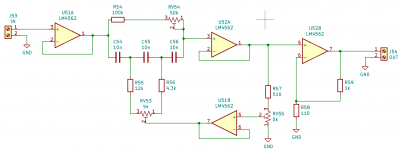

Right now I have assembled the first schematic (passive, no op-amps). So far I have not assembled the second schematic (active, shown with LM4562 in schematic).
I want to get the passive version and the passive components right before building the active version. Otherwise I suspect it will be too difficult to debug the active version.
I expect the CBB capacitors are metalized based upon the price but it was not specified. 99% sure they are not foil. They are not marked with the type.
I was reading here #118 about resistor distortion and I thought I might try building another passive one with the 1/4W 1% metal film replaced with 1W 1% metal film as an experiment. If they fit my machine pin headers I might try sockets for the capacitors so that I can try with both types of film capacitors that I have.

The notch is about 50 dB to make the measurement task more suitable for the CS5361 ADC and the stock NE5532 in front of it.
Later I will upgrade the ADC op-amps with either OPA2132 or OPA1612. (I have a few OPA1612 on the way.) Right now I am working on the DAC after having first worked on improving the clocks/jitter.

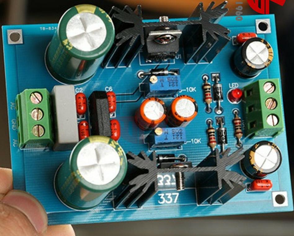

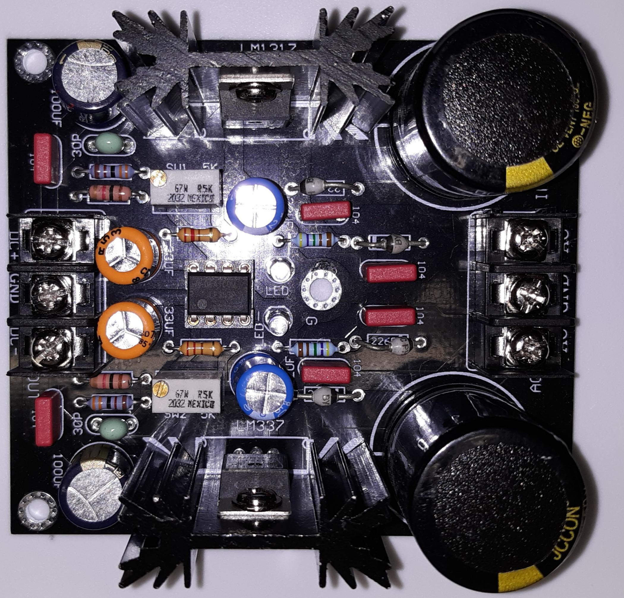

A simple beginner starting point is to use an LM317/LM337 type supply. The attached pictures show a couple of possibilities that work well and are easy to start with. The second one is low noise.

It looks like the board has a balanced AC input 15V,GND,15V, another GND,5V on the same set of terminalsAC input and a DC input jack on the front without a voltage label.
The LT board outputs DC and it has 4 output terminals, 2 positive and 2 negative. How does that work when the PCB only has 3 inputs labelled +15V,GND,-15v?
is the GND,5V input DC as well?
What about the DC input jack on the front of the board?

If you generate +/-15V from an LM317/LM337 (or from correctly connecting two independent positive supplies) you will not use the jack on the front of the board.
The comments about LT3042 refer to a more advanced application/project where the on-board low voltage regulators are disconnected and low noise supplies like LT3042 are used as upgrades.
I suggest starting with the simplest +/-15V connection first.
Well they would be connected as described by Mark. If that is not clear then it might be better to stick with a simple dual supply LM317/LM337 for better chance at success. Perhaps someone else has a diagram that they could attached. (I do not.) Did you buy the dual positive supply already? Or are you determining what you want to buy?
+/-15V is the right starting point. I don't recommend the single supply and the use of the front jack.

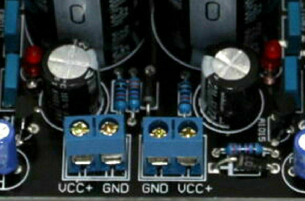

A pic of the voltage regulator board I recommend is attached below. You can see there are two sets of output terminals. Each set has on terminal labeled VCC+ and the other terminal is labeled GND. The two sets of terminals are not connected to each other, instead there are two completely separate voltage regulator circuits on the board. Therefore, you can think of each set of terminals as though they are really + and - (i.e. the + and - ends of a voltage source)
(instead of VCC+ and GND as the board is labeled).
What I do is use color coded wires: Red is +, Green is for the dac ground, and Black is for -
So, for the regulator output on the right, I would connect the red wire to VCC+
A green wire would go to GND.
For the regulator output on the left, I would connect a green wire to VCC+ (so now there will be two green wires connected at the power supply).
The black wire would go to the terminal labeled as GND.
At the dac board, the red wire goes to +
Both green wires go to ground
The black wire goes to -

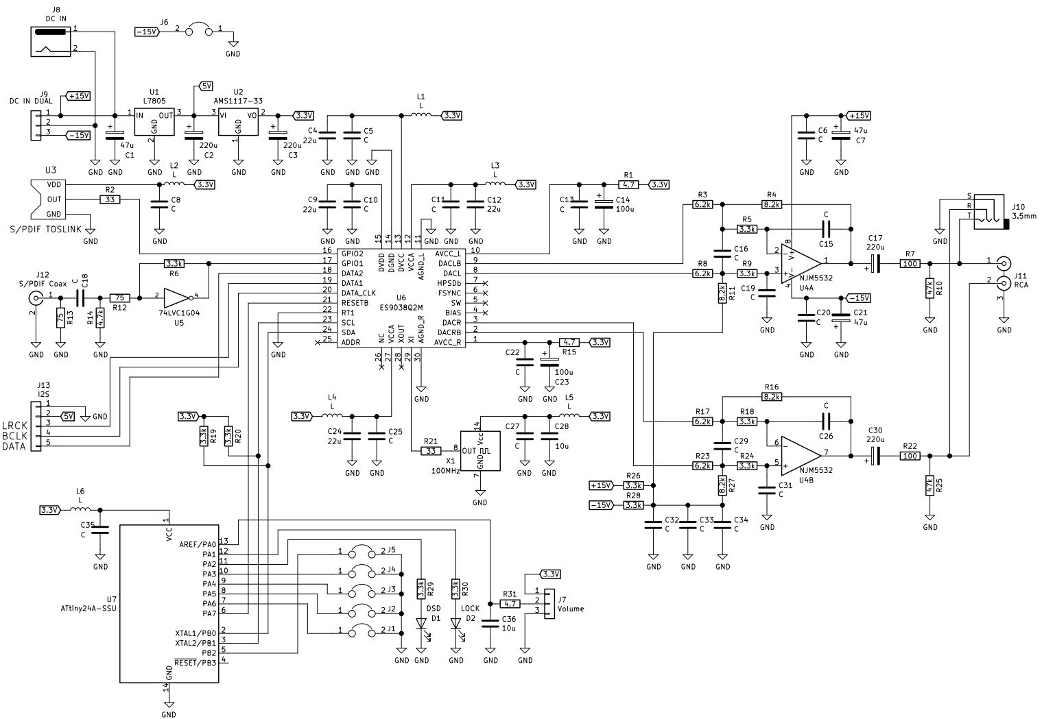

The other question was about using some additional regulators such as LT3042, that is only for if you want to remove the 5v and 3.3v regulators from the dac board and use your own 3.3v regulators instead. The existing 5v regulator uses the +15v for input and drops it down to +5v, then another smaller regulator drops the +5v down to +3.3v. That +3.3v is used to power the dac chip, the clock, the MCU, the optical receiver, and the SPDIF buffer inverter (everything that needs +3.3v power).
If the +5v and the +3.3 regulators are removed from the board, then we could talk about how to replace them with better regulators. In that case the +15v and -15v power would only be used for the opamps. However, best to keep it simple if you are having trouble understanding.
The +5v and +3.3v regulators I am talking about are labeled U1 and U2 on the schematic attached below.
