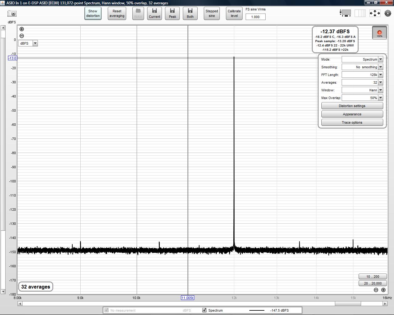

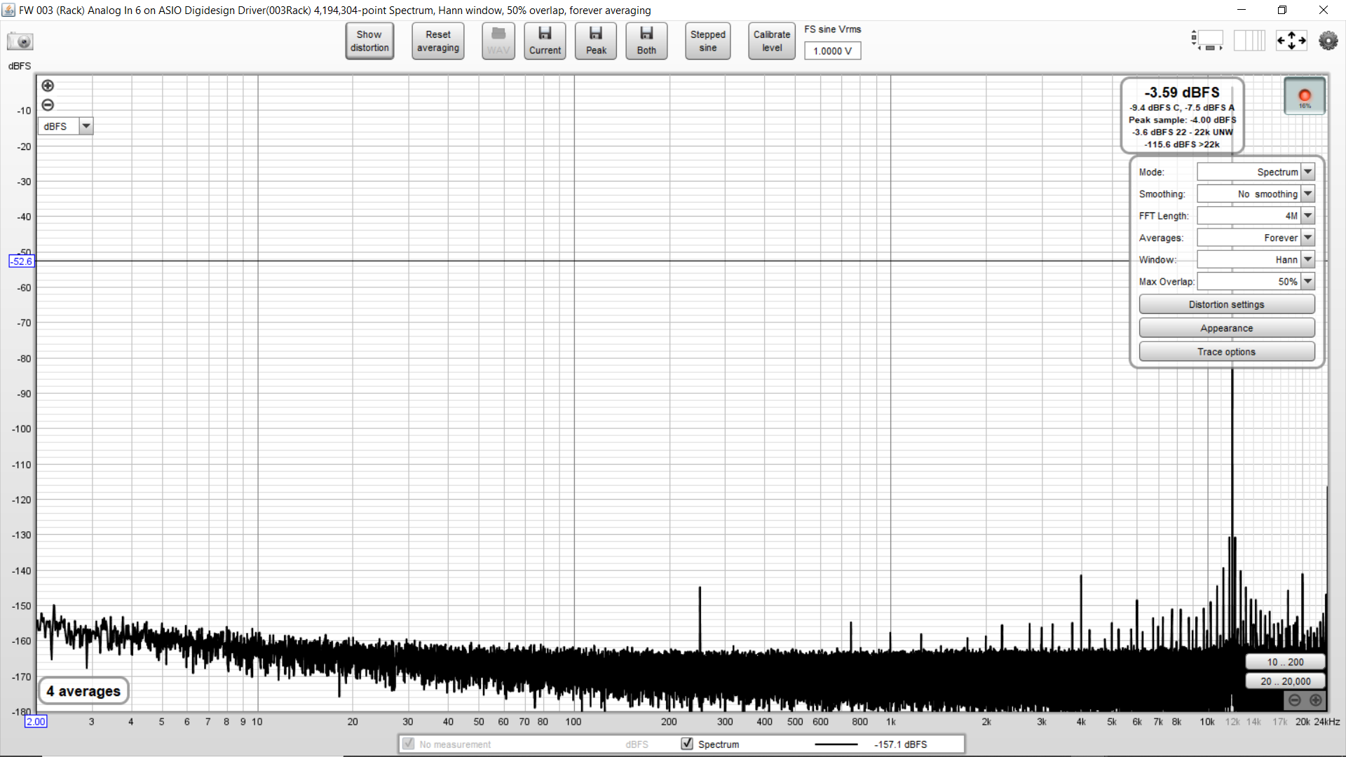

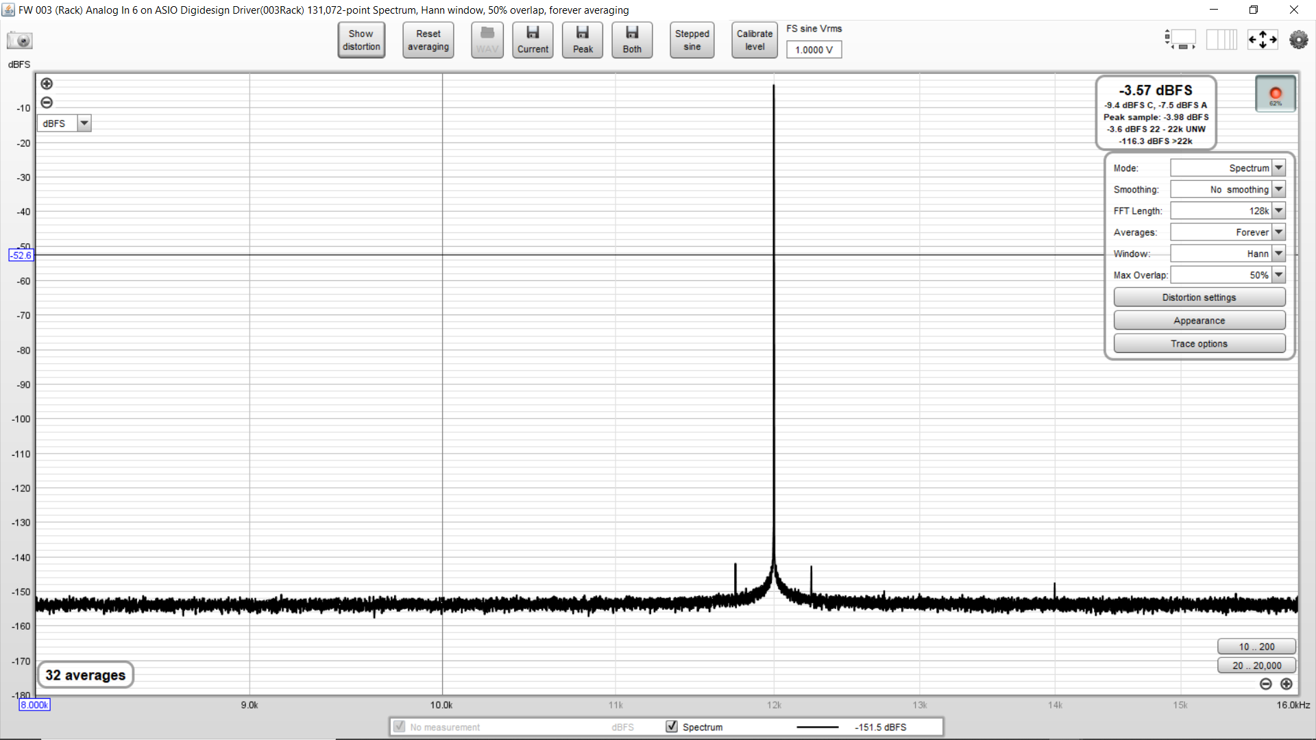

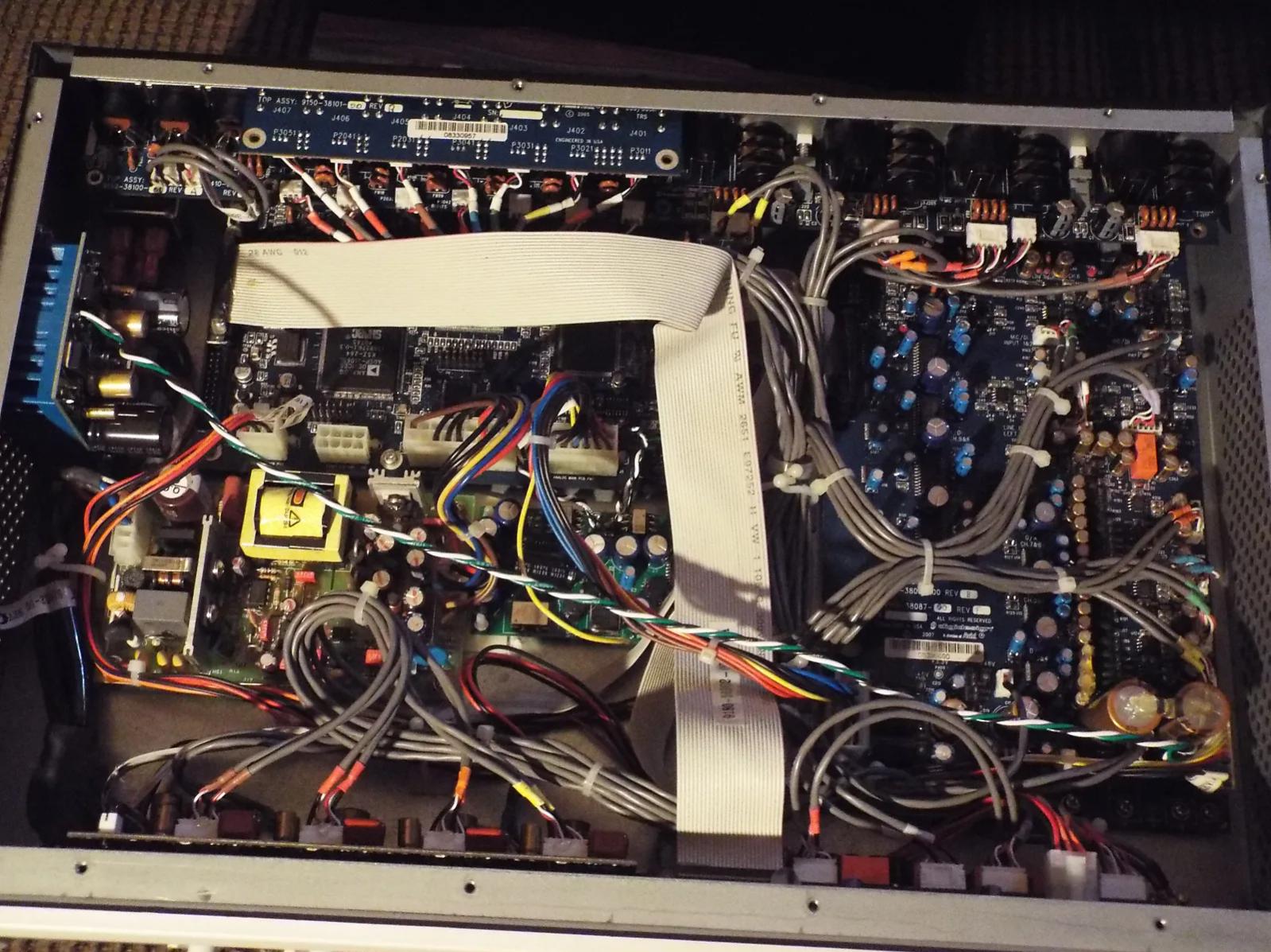

I was wondering if I could get some help interpreting the attached JTest results.
The first is my older result of the ES9038Q2M DAC measured by my E-MU 1820 which has a PCM1804 ADC.
The second is from my Digidesign 003 rack loop back which is CS5361 ADC reading the CS4392 DAC. [After I soldered 0.1uF and 1uF MLCC directly to the clock oscillator NXP 74HCU04D pins, plus OS-CON caps across the surface mount ceramic caps for each of the logic gates used to distribute the clocks to the 8 ADC and 8 DAC channels.]
[I kept the same FFT and display settings so that the new measurement could be compared to the old ES9038Q2M & E-MU 1820 measurement.]
The last image is the Digidesign again but before I improved the bypassing of the clock oscillator and clock distribution circuits. I think the close in jitter related spurs have improved by about 11 dB.
How good are these results? Perhaps I do not need to replace the clock now? (I am thinking of moving on to the next upgrades and calling the JTest "good enough".)

Looks like you got some decent improvement by relatively simple means. Taking the spurs way, way down would likely be more trouble than its worth for that old Digidesign unit. Most likely it still has other audible issues that might benefit from fixing first, assuming of course it might sometimes be used for purposes other than just measurement.

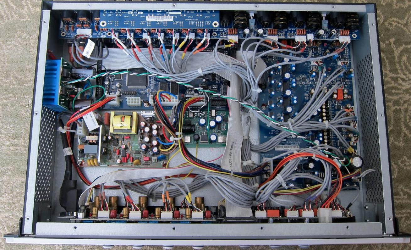

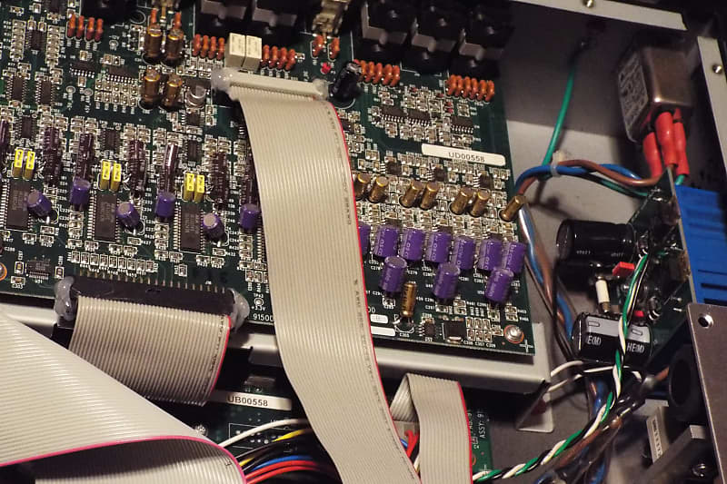

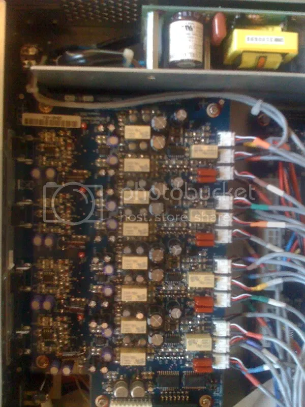

The main purpose of the Digidesign and E-MU are not measurement. It is just that when I started working on the ES9038Q2M the E-MU was the most suitable measurement tool I had.
There are big opportunities for sound improvement from the reports of many others who had their units upgraded with OPA4134 op-amps (instead of TL074) and better capacitors. I have photos of a number of generations of upgrades and in earlier units OS-CON and Nichicon FG were the main upgrades. In more recent units it appears that Vishay (for digital) and Nichicon FW (for audio) are the preferred upgrades. I am going to try Panasonic FM (audio) and Panasonic SEPC (OS-CON, for digital). I don't know which op-amps were used to upgrade all the dozens of NE5532. (Guess is OPA2134.)
In the attached photos the purple are the OSCON, the blue are Vishay and the gold are the Nichicon upgraded capacitors.
At the end of those upgrades I will either leave the clocks as they are now or investigate an ultra low noise LDO there, etc. The other main upgrades people did were upgraded analog power supplies for the op-amps and the replacement master clock boards.

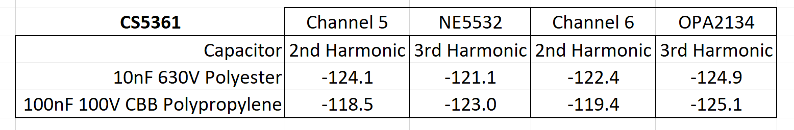

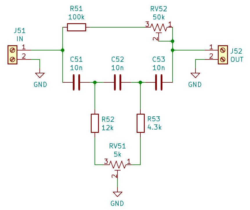

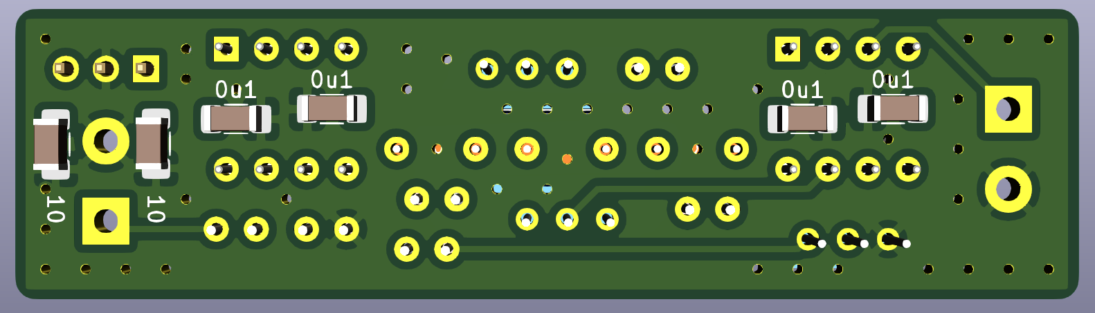

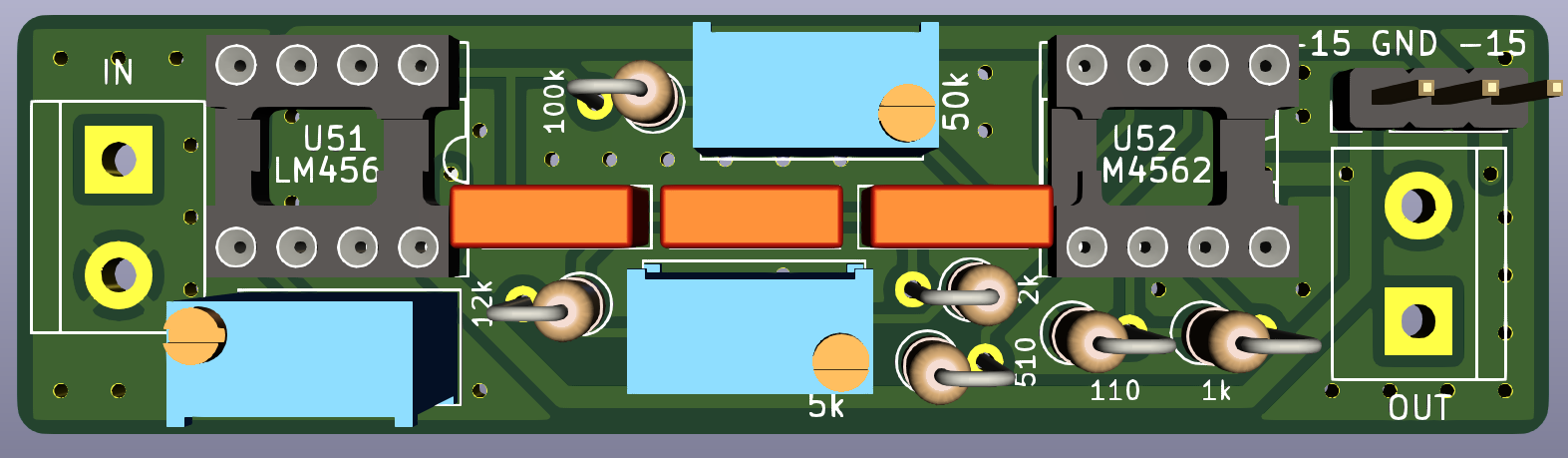

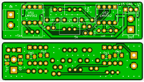

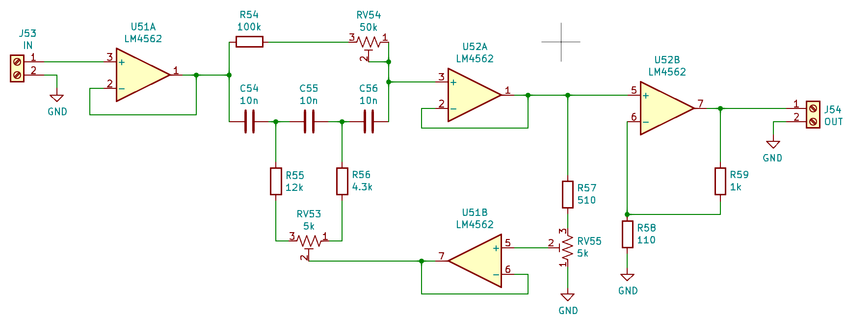

I have built and tested three of the passive 1kHz Hall Notch Filters. Before I build the active notch filter I need to understand why my measurements vary up to 6 dB between the filters.
For example, the 2nd harmonic measures better on the version that uses 630V rated green polyester 10nF capacitors. The next version was intended to be better (with lower insertion loss) with 100nF red CBB polypropylene capacitors and 10x smaller resistors.
I am using 1% metal film resistors and 3296 trimmers. I have also measured the notch three times before the DAC measurement and three times after and the overlay is exactly on top of each other. (So reasonably stable.)
Originally I thought that 630V rated polyester might have a sufficiently small voltage across them (in this application) to not produce measurable distortion. Perhaps this is a mistake and I should not use them.
I next used 100nF red CBB polypropylene capacitors so that I could reduce the resistors 10x and reduce insertion loss. Also I thought that the polypropylene might have lower distortion even though these are only rated 100V. However now I measure worse 2nd harmonic. (With polypropylene and significantly less insertion loss from 10x smaller resistors.)
For next steps perhaps I should try?
- C0G/NP0? (Caps are a bit large for C0G/NP0.)
- WIMA FKP 3 Polypropylene (PP) Film and Foil Capacitors for Pulse Applications.
- Higher quality resistors? Most of my 1% metal film resistor assortments are steel lead. At what distortion levels are this type a problem?
Added information: I just checked with a magnet and every component is magnetic. The yellow box 100V polypropylene caps (the first of the three filters), the red CBB 100V polypropylene caps, the green 630V polyester caps, and the 1% leaded metal film resistors.
I even found that the 1% 1206 metal film resistors are magnetic. (I was hoping that they were not magnetic as a possible alternative.)
Is this a problem at these distortion levels?
