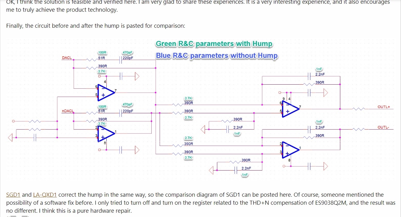

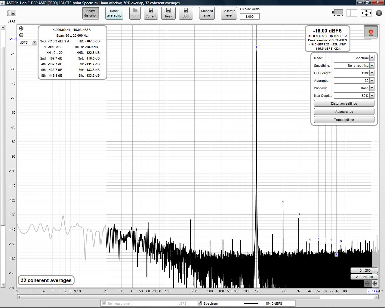

I just fired up my prototype of the "ES9038Q2M No Hump IV Output Stage" From Post 6944.
For this first test I am using the JRC 4580D and I pretty impressed at this modest op-amp. The 2.2nF are polyester film capacitors and the 220pF are 3kV blue ceramic capacitors. I need to place an order for Wima foil capacitors in these values.

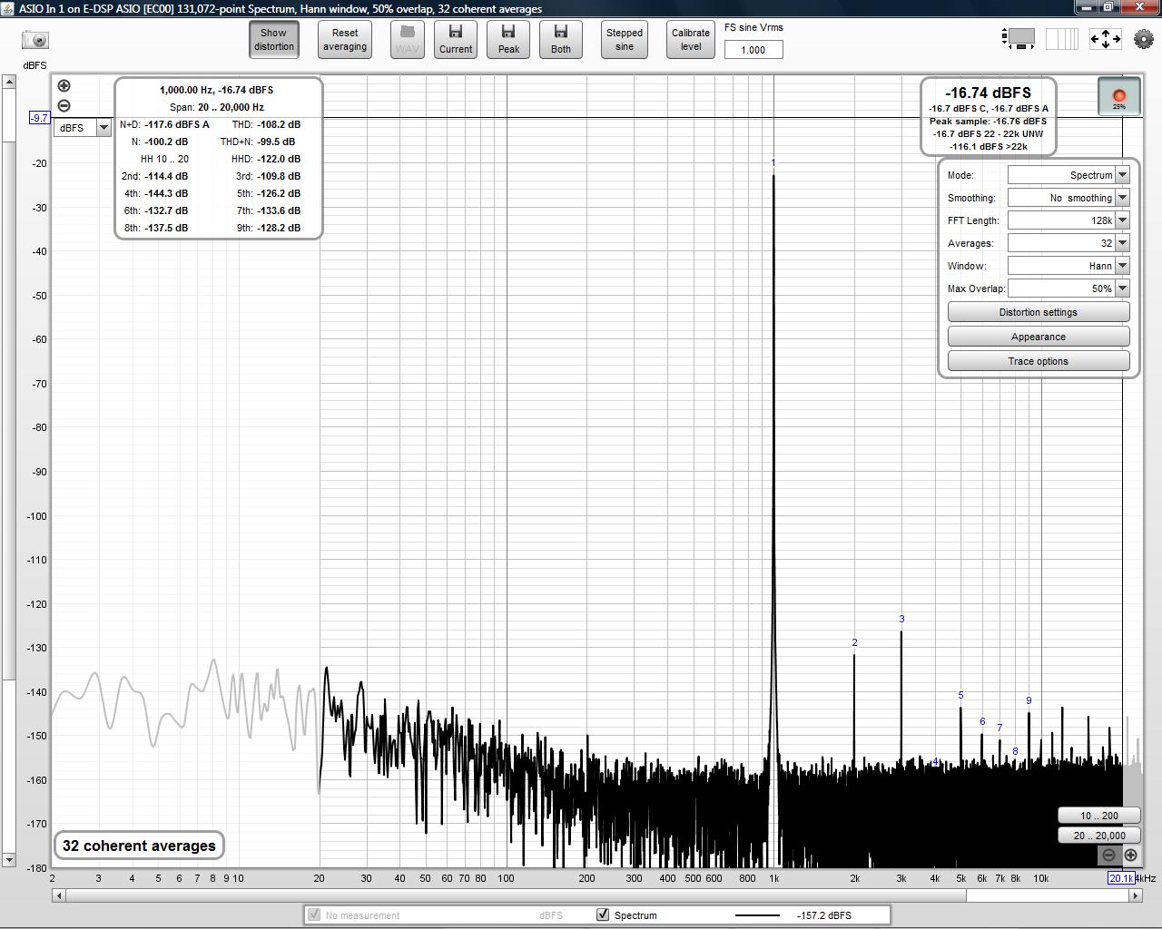

The attached results are (in order):
1. Loopback test of E-MU 1820 at the same input power (due to noise questions).
2. -20 dBFS
3. -10 dBFS
4. 0.0 dBFS
5. Schematic

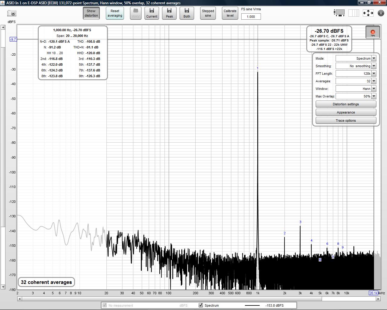

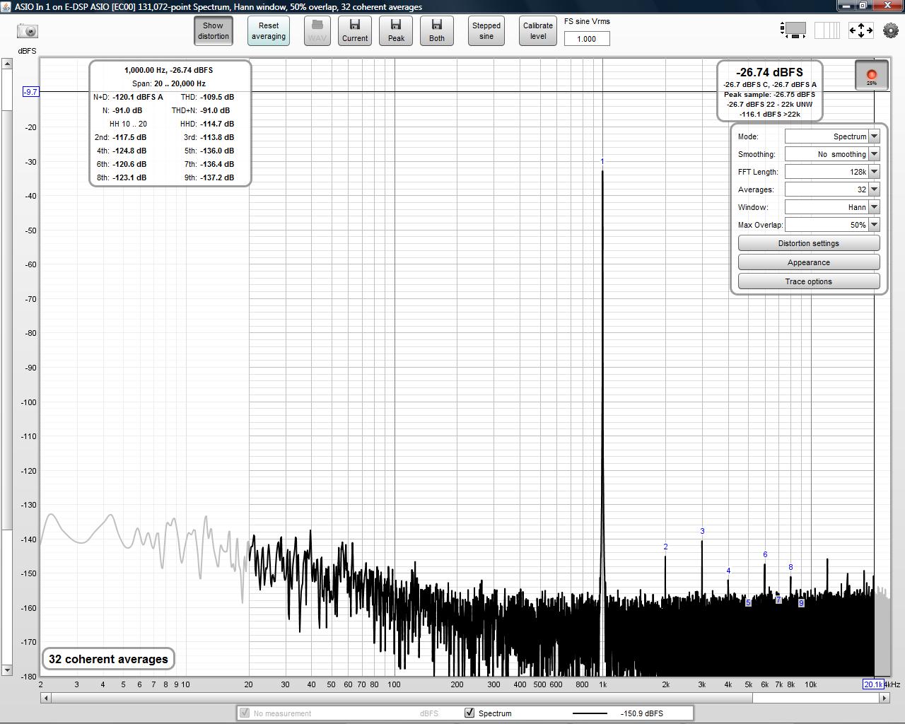

Now using the ST LM833N here are my results from my first tests of my prototype of the "ES9038Q2M No Hump IV Output Stage" From Post 6944.
2. -20 dBFS
3. -10 dBFS
4. 0.0 dBFS
5. Schematic

Have you calibrated the REW levels with E-MU1820? I would expect FS to be much more than 1 Vrms. Also your DAC output seems quite low if you have only -16.7 dbFS at 0 dBFS input (with FS being 1 Vrms).
I just got the E-MU 1820 working again on Tuesday (after a number of years not being used) and I have not calibrated it yet in REW. I can look at that tomorrow.
I am displaying in dBFS (uncalibrated) which is dB from full scale on the E-MU. The E-MU 1820 is setup in patchmix for +4dBu levels. (Professional audio levels.) Also the Mic A input (on the E-MU 1820) is set to minimum gain.
Also that output stage from post 6944 is using 390 Ohm resistors in the IV. So doesn't that limit the output voltage also? (Considering the output current from the ES9038Q2M?)
I should also note that this is single ended right now. I built a balanced IV stage but I am only looking at one side. I will later build the XLR cable for the prototype. I started with single ended cables because my test amplifier is single ended.
All of this is with the EMU 1820 set to +4 dBu (professional) levels:
With full scale output of the EMU 1820 I read 3.980Vrms output of the EMU 1820 (1L Output). Looping back into the Mic A (gain set to min) input of the EMU 1820 that reads -6.03 dBFS.
Since -6.03 dB is Av=0.499459 that means the full scale on the graphs is =3.980Vrms/0.499459 = 7.968Vrms.
If I loopback from 1L (output) to 1L (line in) it reads -8.61 dBFS. Since -8.61 dB is Av=0.371108 that means the full scale (if I use that input) is =3.980Vrms/0.371108=10.72Vrms.
So the fullscale levels are pretty high when the +4dBu setting is used on the 1820. (When the EMU 1820 is set from -10 to +4 you can hear relays clicking inside.)
If you see any mistakes please let me know!
Hooking up the DAC again I read 1.20Vrms for full scale with the 390Ohm resistors in the IV stage.

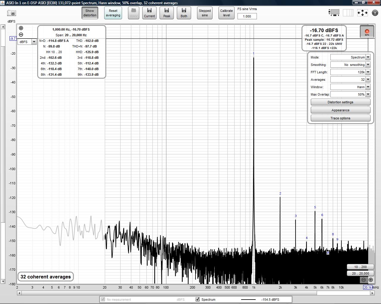

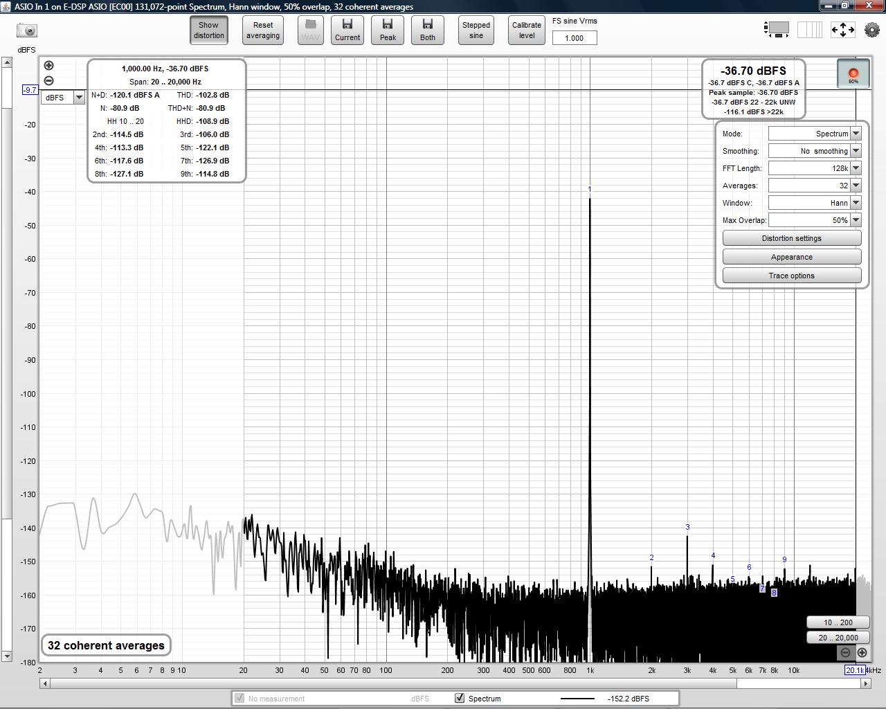

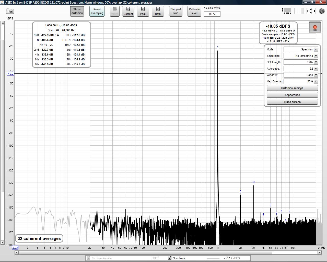

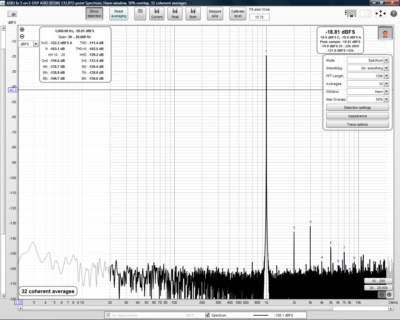

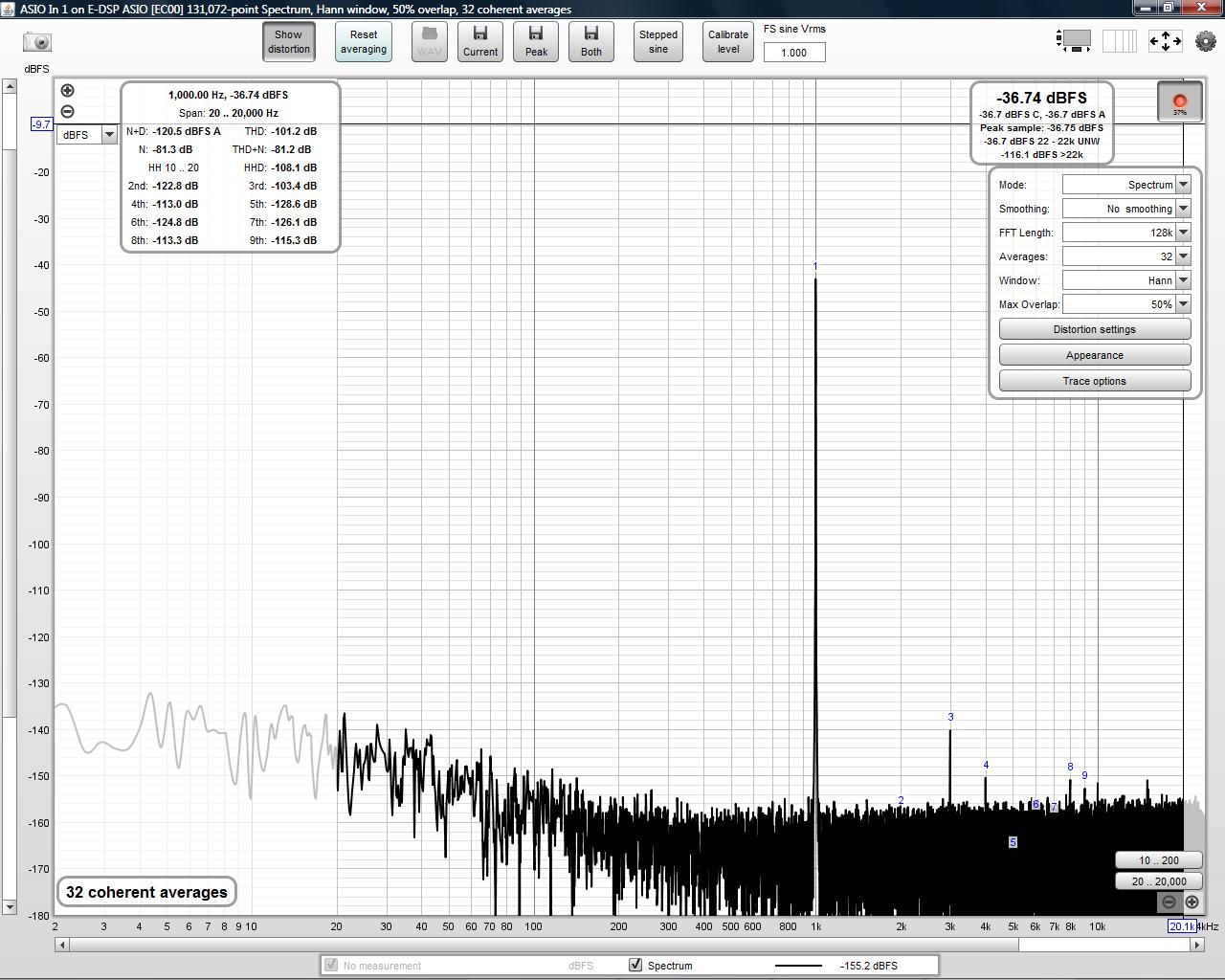

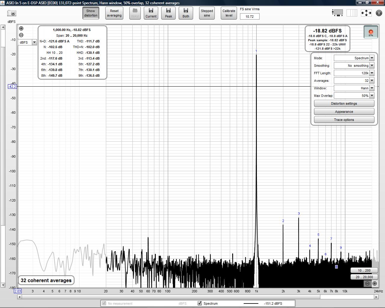

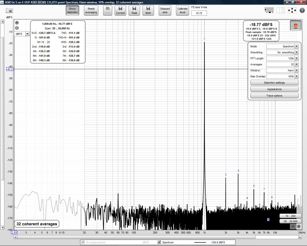

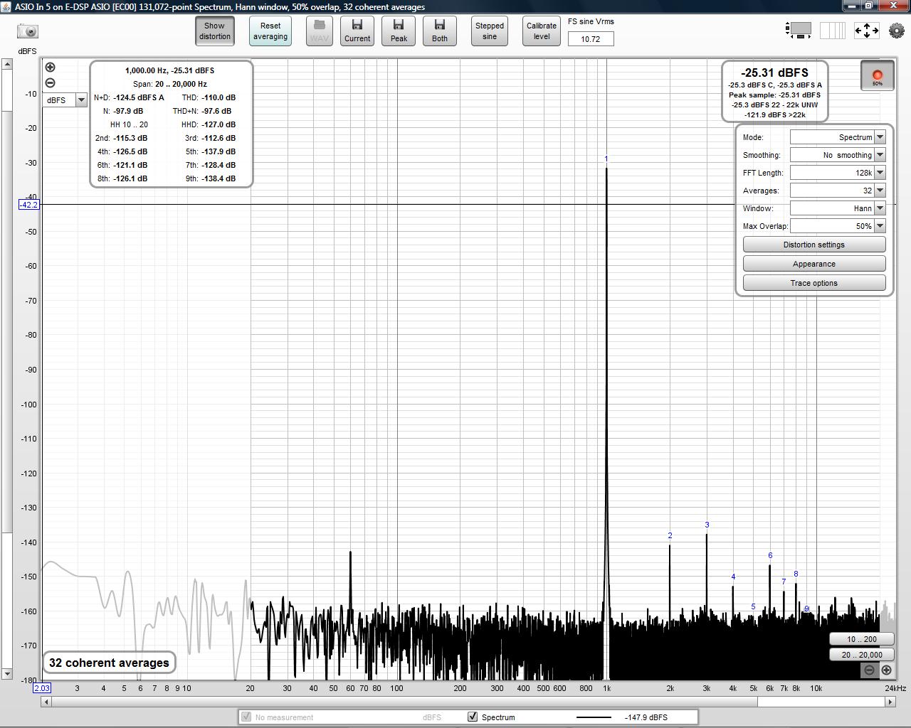

Here are some more measurements made this time with the lower distortion/noise line in (1L) on the back of the EMU 1820. The DAC is at -3.0 dBFS because something overloads in the EMU 1820 around -1.0 dBFS.
These are with my prototype of the "ES9038Q2M No Hump IV Output Stage" From Post 6944. That is a balanced output but I am currently measuring only "half" or the positive output only.
These are measurements again with the JRC4580D op amp.
Attached in order:
Before I try my last op-amps (LM4562, JRC4562 and Ti NE5532) does anyone have any component value or component type/quality suggestions?
I don't have many of the capacitor values that I want in foil and film but this is a start for a prototype. I am using standard 1% metal film resistors. Later I can order better components when (and if) I settle on this one.
Attached in order:
- No new modifications. Remeasure with different sound interface input.
- Replace 100uF Xicon output block with Nichicon UES 50V 47uF BP
- Replace 220pF 3kV blue ceramic disk in IV with 470pF polyester film
- Replace 470pF polyester film with 2x100pF Wima FKPS2
- Replace Wima with 1000pF Polystyrene (my only value of polystyrene)
JRC4580D Red Side to 1L Input 4dBu Levels Coherent -3dBFS.jpg220.5 KB · Views: 265
JRC4580D Red Side to 1L Input 4dBu Levels Coherent -3dBFS Nichicon Muse.jpg220.8 KB · Views: 271
JRC4580D Red Side to 1L Input 4dBu Levels Coherent -3dBFS 470pF Polyester.jpg220.5 KB · Views: 252
JRC4580D Red Side to 1L Input 4dBu Levels Coherent -3dBFS 2x100pF Wima FKPS2.jpg219.7 KB · Views: 258
JRC4580D Red Side to 1L Input 4dBu Levels Coherent -3dBFS 1000pF Polystyrene.jpg217.9 KB · Views: 255

Since there is an offset voltage at the I/V outputs, are you using a DC blocking cap, or does the EMU have one inside it (that would not be operating as a reversed biased electrolytic)?
I am using a Nichicon UES BP (47uF 50V) for the DC blocking cap. I first tried 100uF 25V Xicon. No difference in my measurements between the two.
