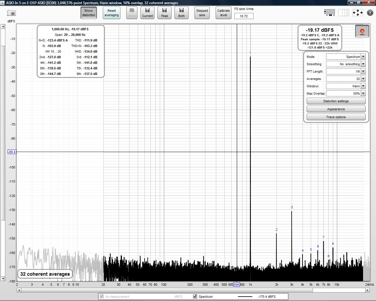

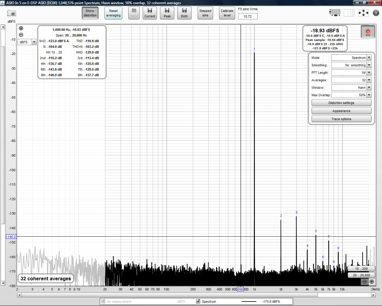

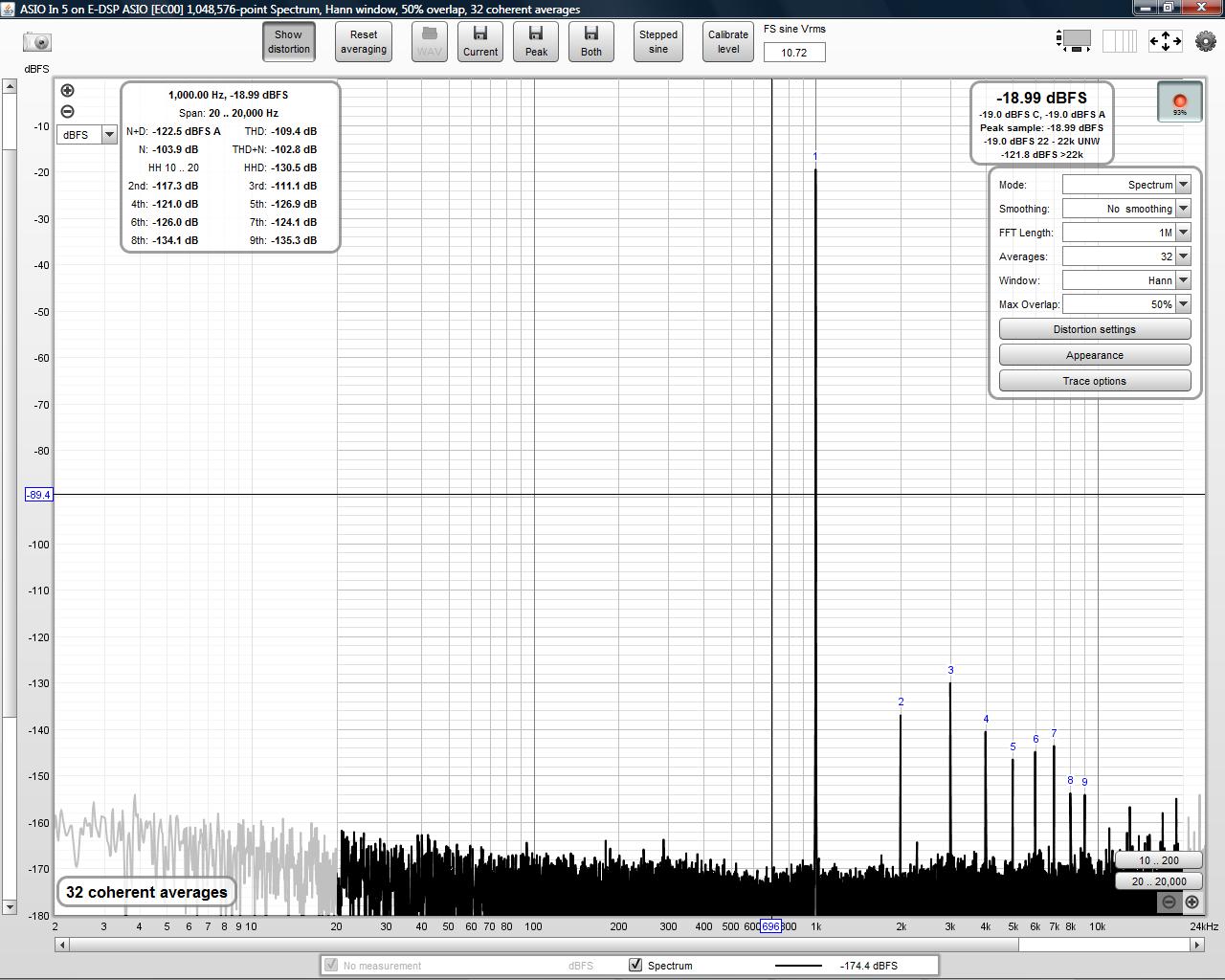

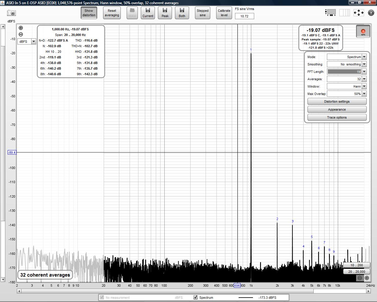

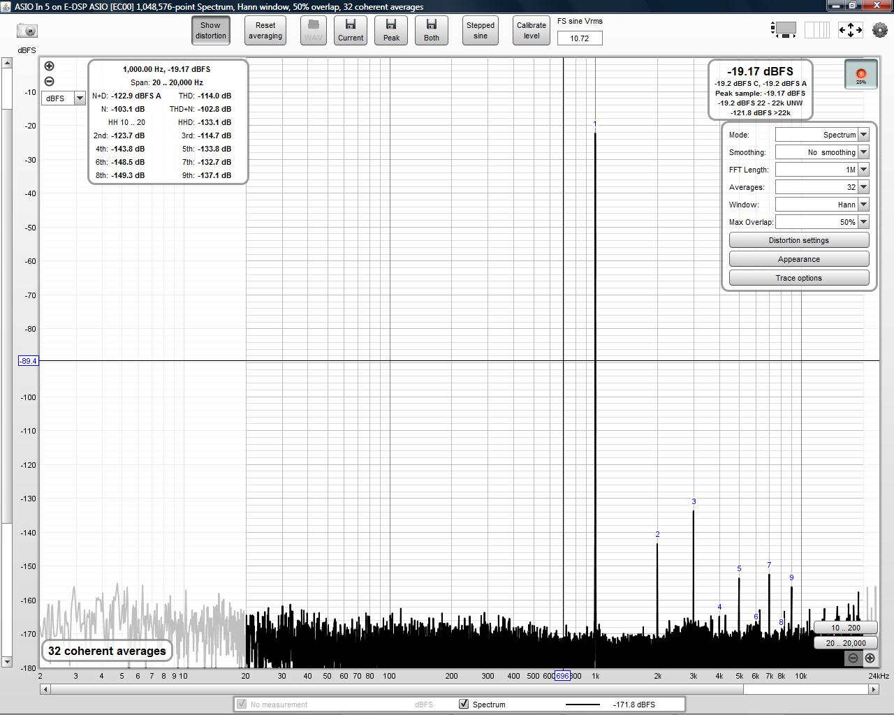

Here is a comparison of more operational amplifier models and brands. These are with my prototype of the "ES9038Q2M No Hump I/V Output Stage" From Post 6944. That is a balanced output I/V stage but I am currently measuring only "half" or the positive output only.
These measurements are made with the lower distortion/noise line-in (1L) on the back of the EMU 1820. The DAC is at -3.0 dBFS because something overloads in the EMU 1820 around -1.0 dBFS.
To deal with repeatability I increased from 32x 128k FFT to 32x 1M FFT. That is much slower but much more repeatable and stable. (Needed to compare small differences.)
Attached in order:
There were a number of surprises:
Attached in order:
- JRC4580D
- JRC5532DD (Not as good as Ti due to higher 3rd harmonic)
- Ti NE5532P (First batch, bought from Mouser distributor)
- Ti NE5532P (Second batch, bought from LCSC distributor. This is the best and I will use this batch and model.)
- LM4562NA (Best 2nd harmonic, high 3rd harmonic!)
- JRC4562D (Much higher 2nd harmonic relative to the LM4562NA)
- Due to the very high 3rd harmonic I judged the LM4562NA to not be the best. (I was expecting it to be the best.)
- The NE5532 was judged to be the best and had unmatched 3rd harmonic performance. Because of this result I found a second batch in my parts bin and the second batch was consistent with the first for lower 3rd harmonic and in fact was even better than the first batch. The first batch is about 19 years older.)
- The Ti and JRC 5532 are not comparable. The Ti has better 3rd harmonic while the JRC has high 3rd harmonic like the other part numbers.
- The Ti and JRC 4562 do not perform the same.

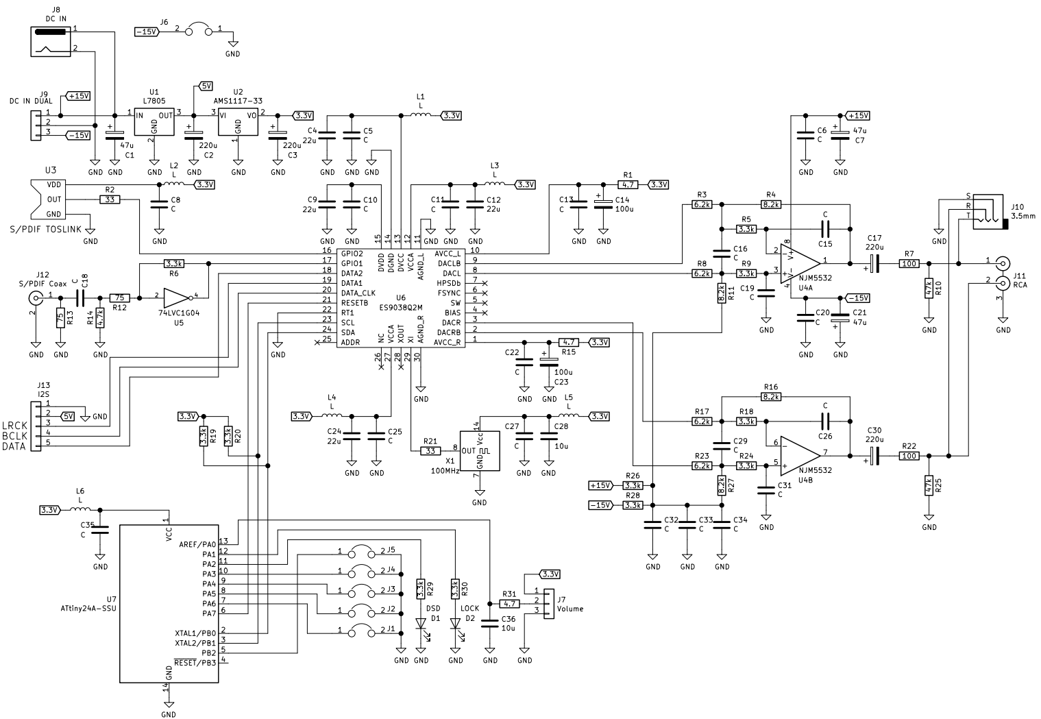

Does anyone have a circuit diagram for this?
Someone posted this as the schematic. (Attached.)
If you just got the board be aware that the output stage needs to be replaced with an I/V stage. I mean it really needs to be replaced.
