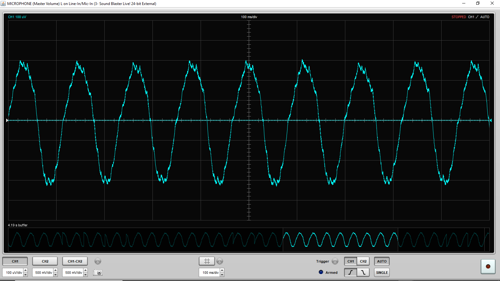

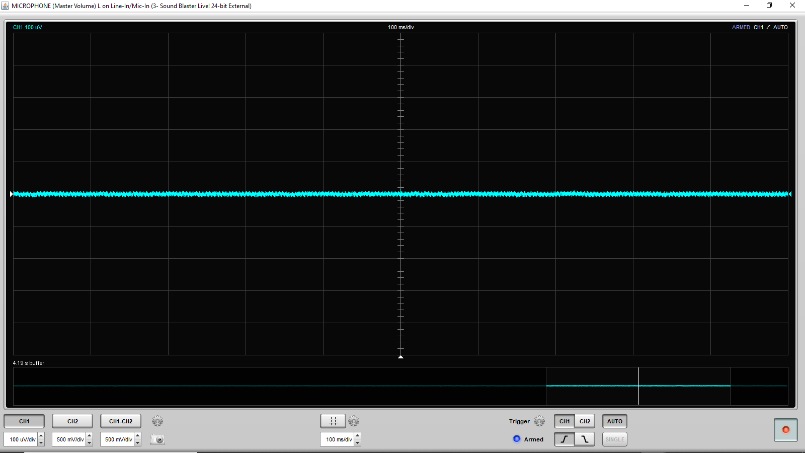

As far as using a battery it is not so simple. So if you tried a battery and did not like the results then the attached waveforms might start to help explain why. (They are just a beginning, however.)
For example, the attached images (1 & 2) show how clean AVCC_R and VCC_A can be when the board is powered with a battery (and there are OS-CON across the various individual supply pins on the board.) [No AMS1117-3.3, no LM7805.]

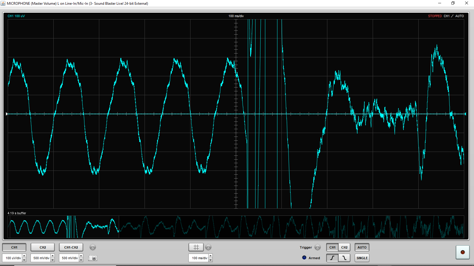

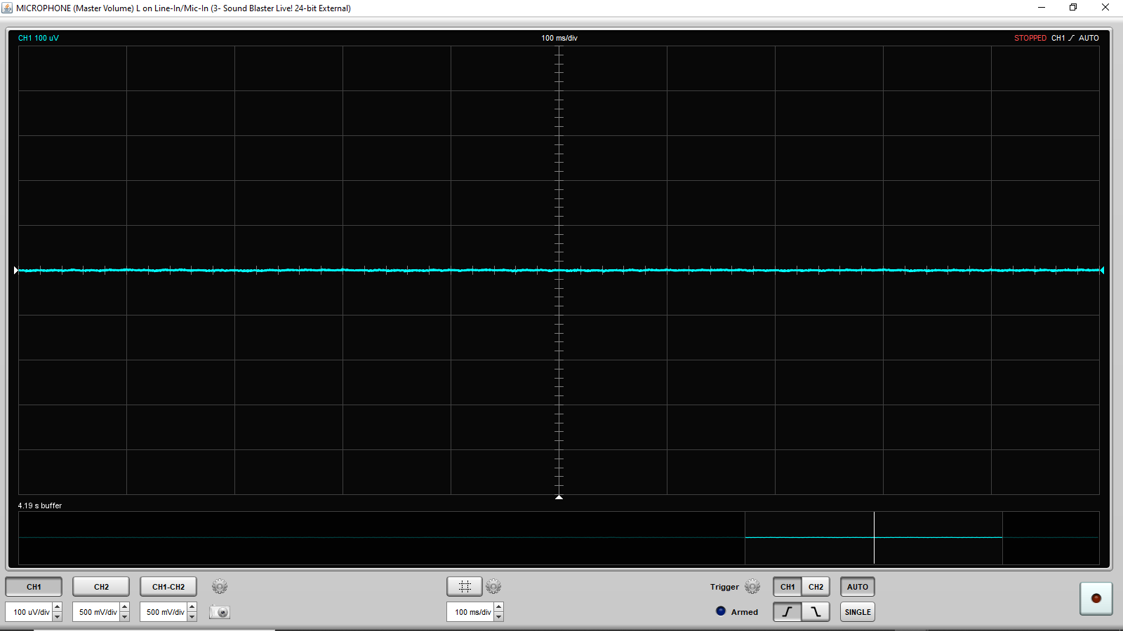

Next the attached images (3 & 4) show what happens when the optical is locked (but no signal, idle). #3 is AVCC_R and #4 is VCCA. Essentially the input power can be very clean but something on the board is a strong LF noise generator. It appears to be roughly 85 Hz not 60 Hz. [I am not saying any of this is at all surprising, I just post this reply to be informative regarding the fact that people apparently tried batteries and did not like the result. Most of you are probably well aware that this will occur.]

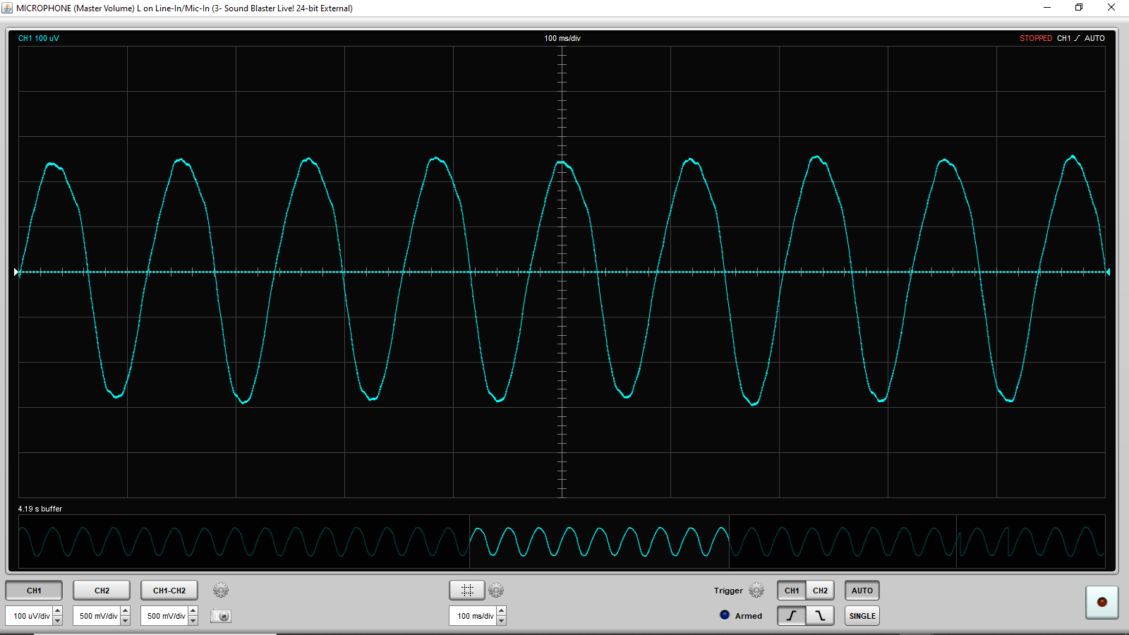

The last attached image (5) shows what happens when locked to coax and the DVD player goes from idle to playing music.
So don't think running on battery means low noise on the supplies. Like regulators it might be necessary to include multiple independent batteries, deal with power supply sequencing and even use LDOs on the offending LF noise generating pin(s).
It will take more work to find out where it is coming from. (ES9038Q2M, ATTINY, etc. I don't think it is the 1G04 CMOS inverter (5 pin SOT) for the optical since it occurs with no optical.) If anyone knows which pin (ES9038Q2M DVDD or ATTINY VCC or ?) please let me know.

When coax/optical is locked there may be something going on with the DPLL hunting around to keep it locked, dunno. Might be interesting to see if the same symptoms appear with a different coax/optical source and or if changing DPLL_Bandwidth has any effect. With coax, ground noise could possibly be an issue since the dac board doesn't have an isolation transformer. Did I say I encourage experimenting to help find clues?
