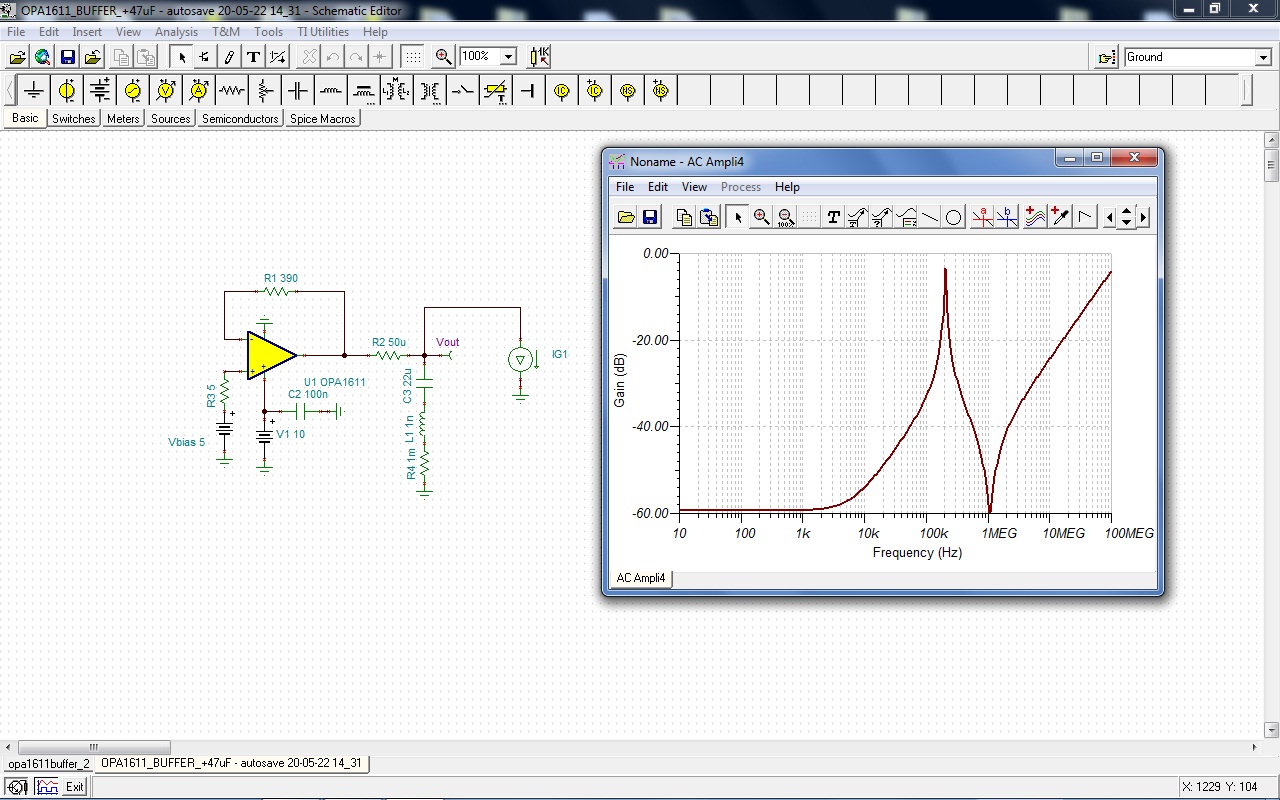

Fyi, the simulated output impedance response of the buffer configuration in fig3003, with OPA1611.
Well if the plan fails see the attached backup plan that is ready (to order), just in case. Right now my measurements show exactly the same 2nd harmonic as my SB0490 loopback. (Meaning I am measurement ADC limited.) So if the changes make anywhere near the claimed improvements then I really should be ok with it.

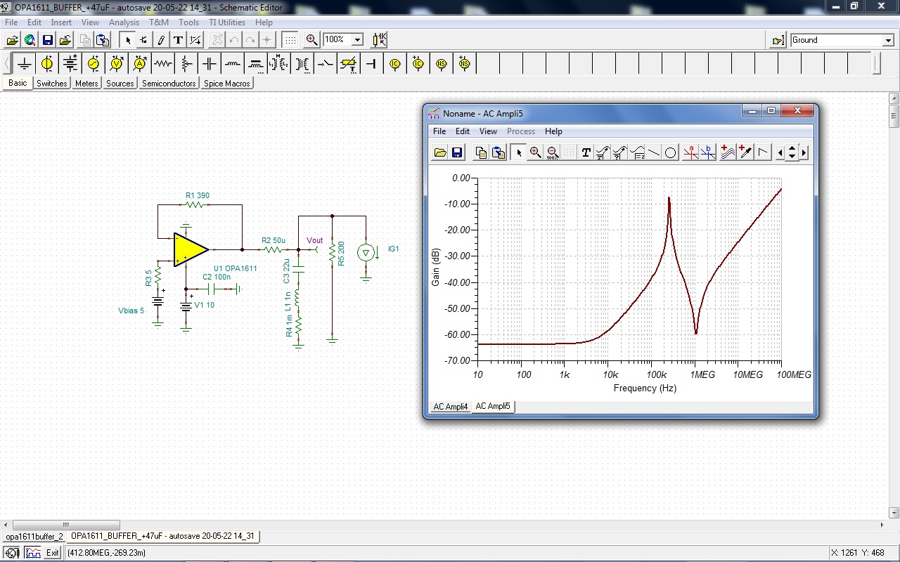

Doesn't the load look largely like a few hundred ohm resistor to ground?

I wonder if anyone has a back of the envelope guess-estimate of the DAC load? Two sets of 64 switches??? I thought someone said 50kOhm each for an older ESS chip? Maybe 50kOhm/(2*64)=390 Ohms?
Is the total 6mA for both AVCC_R/L or each? (Page 50 of datasheet.) I think they mean total.
3.3V/0.003mA = 1100 Ohms.
3.3V/0.006mA = 550 Ohms.
Note that I don't know and I don't claim to know. I am just curious/discussing it in case someone else knows. So no please.
The trick with opamp buffers is that the cap on the output will resonate with the opamp 'virtual output inductance' - - as it is shown in the sim.
The trick is to push down this resonance frequency.
John Westlake (an the M-dac..) had used 1000uF capacitance for this reason.

Here it is with 200ohm to ground
How does it look for the other output cap option? (The electrolytic cap?) My board come stock with an Elna 100uF 16V RA3 at AVCC_R/L. So if you go up to 0.6 Ohm for the model what do you see?

Let's make it clear, what is simulated is that '22uF film cap ' on the output, as option F in the schematic.
Which is ~the absolute worst scenario.
All other things, higher value, more lossy electros, are obviosly better, less resonant, but it does not "go away" until one arrives at 1mF zone.
Many tricks can be tried, like a second, parallel small elko, with some ohm ESR, which exerts a 'snubbing' effect on the created resonance.

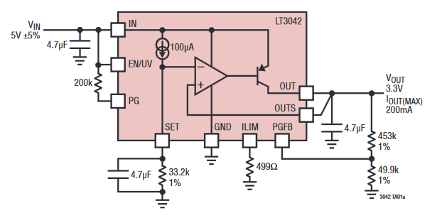

But. Why not just apply an LT3042, without complications and to good effect..
(The higher cap values are obviously slowing down the opamp response time.. out goes the fast response, that is slow and long resonaces could appear.
An LT3042 is having the fastest and best, no resonance response with exactly that, a 10uF/20uF film cap on the output..)

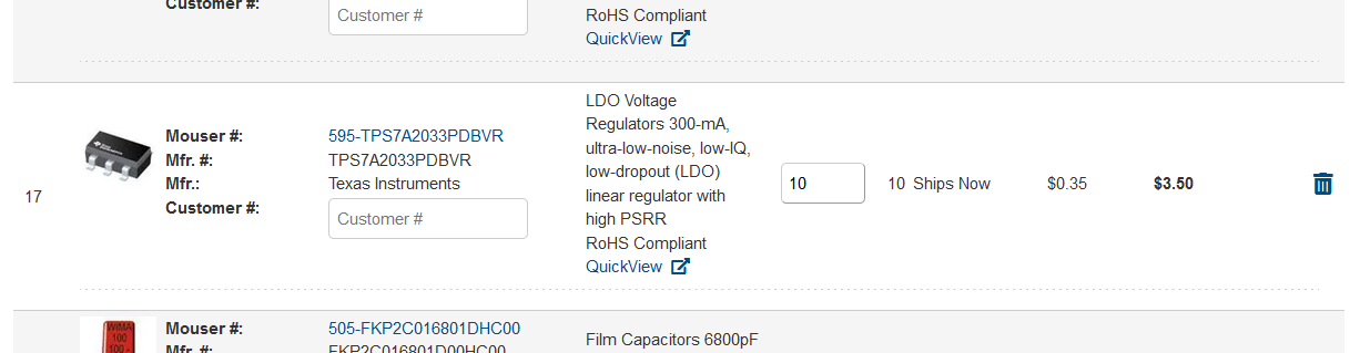

Why not LT3042? In my case I want to enjoy some DIY with the parts that I have (first). I will see what I can achieve. After that I might buy the $16 worth of LT3042 (three of them for the board).
Until then I wonder what happens in your simulation if you wire an LM4562 as shown in the attached image where the reference (3.3V) goes to the inverting input and you use a 2N4403 as the PNP shown in the LT3042?
And I will definitely consider the $0.35 TPS7A2033PDBVR before the $5.60 LT3042. I actually get a tiny bit offended when a company charges the DIY community obscenely more than they charge their main customers.
