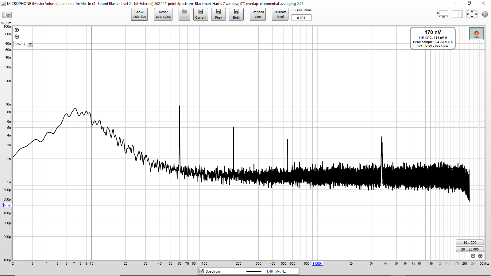

EDIT: Completely agree 0.5nV/rtHz is not credible. Something has to be wrong somewhere, maybe more than one thing.
EDIT2: Your FFT display shows you are using exponential averaging. You understand that the processing averages out displayed noise?

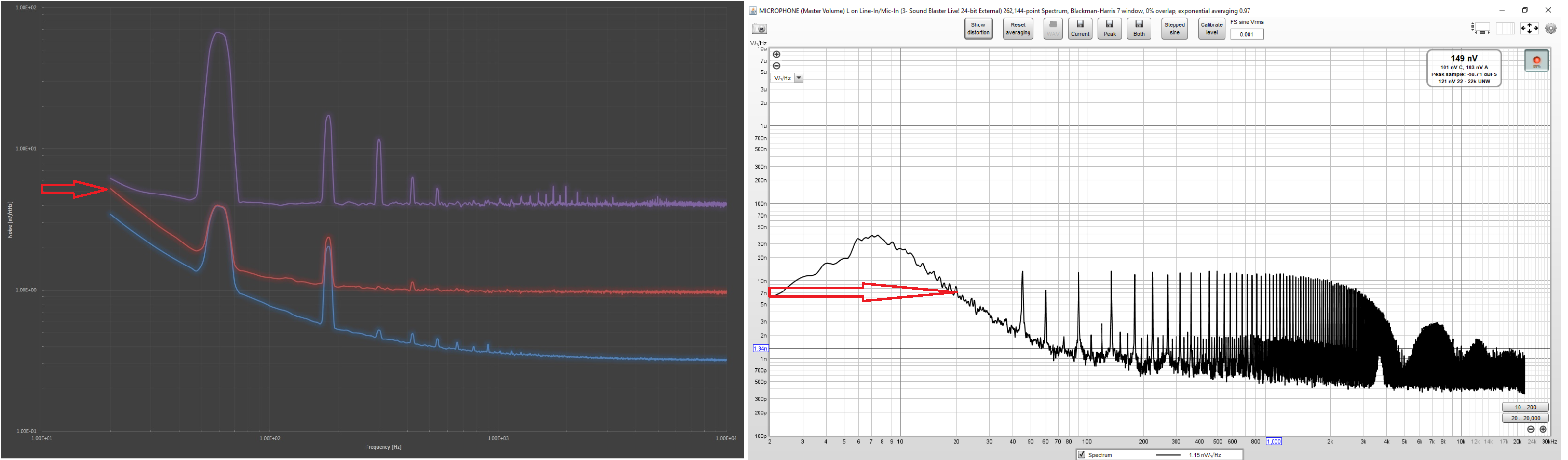

In the attached image I have your data on the left and my data on the right. My noise level is clearly higher. So why are you saying my noise is 0.5nV/rtHz noise? Is there any chance that perhaps you read the graph wrong?
The red arrow on your data corresponds to 5nV/rtHz on your Y-Axis and the red arrow on my data corresponds to 7nV/rtHz on my Y-Axis.
What am I not understanding? I thought your noise levels were:

If I understand your post you have noise levels that are ten times 0.5nV/rtHz and my measurement looks like higher noise than yours.

Your graph has lots of hash but inbetween those spikes the noise floor seems to be at 0.5nV/√Hz which is highly suspicious. Another suspicious thing is that the hashes are not related to mains frequency (e.g. one at 45Hz).

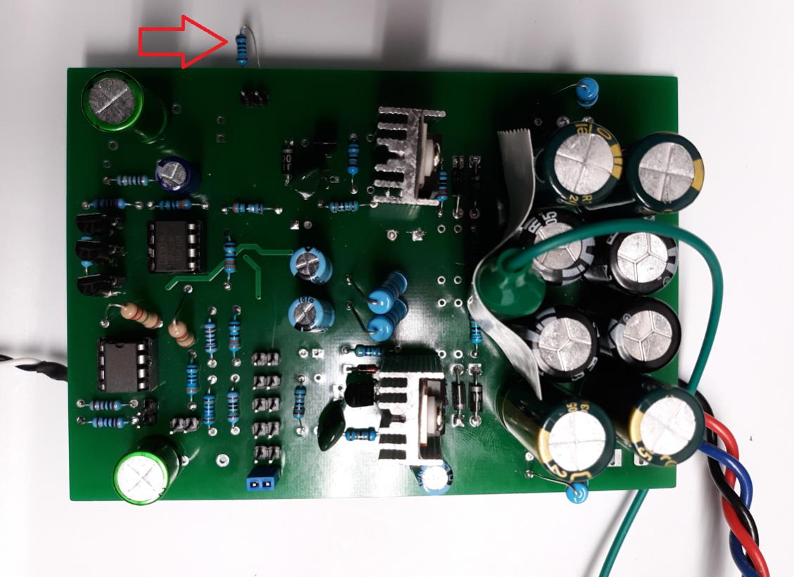

The last stage is a capacitance multiplier for "cleanup" after the shunt regulator. The shunt regulator charges a large low ESR capacitor which is followed by the capacitance multiplier. The capacitance multiplier uses three parallel large die/low base resistance die and the output of that capacitance multiplier charges a large very low ESR capacitor too (1000uF).
Is it possible that the low noise floor at 1kHz is due to the use of the very large low ESR bypass capacitors? Especially the last one on the output?
Edit: I followed the shunt regulator with a capacitance multiplier after reading the article: https://www.edn.com/simple-circuits-reduce-regulator-noise-floor/

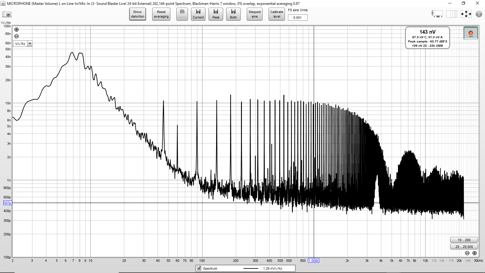

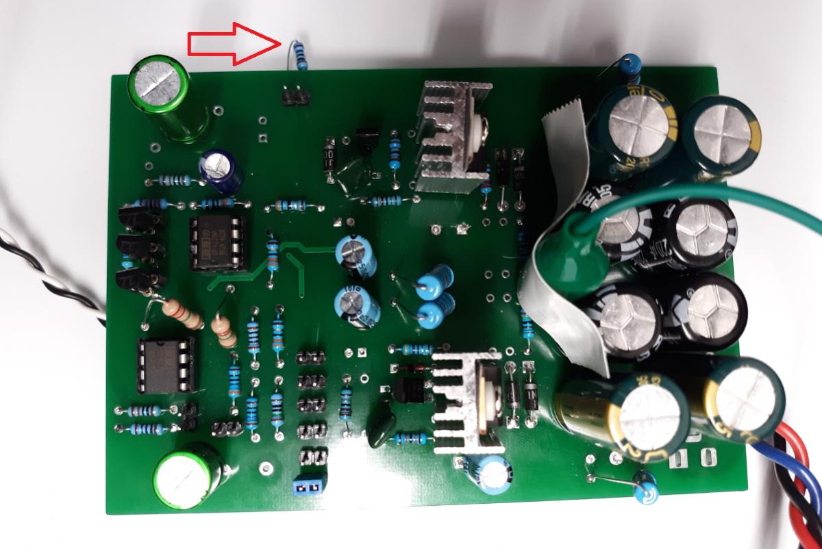

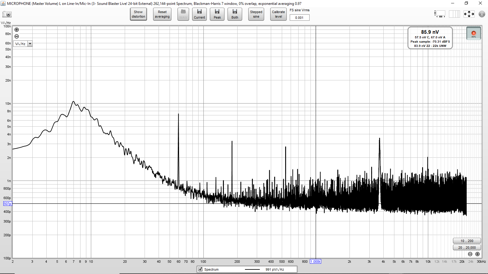

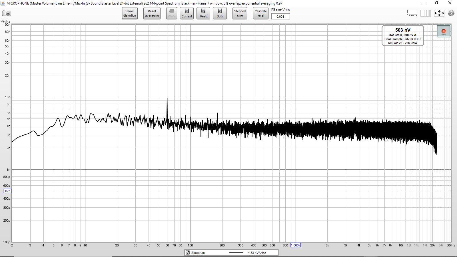

Attached in order is:
- LNA Shorted.
- 100 Ohm Resistor (Soldered to LNA input.)
- 1000 Ohm Resistor (Soldered to LNA input.)
- Output of preregulator. The 45Hz seems to come from the preregulator so I will need to find out what is wrong.

My resistor measurements seem to agree very well with the 1.3nV/√Hz for 100Ohm and 4nV/√Hz for 1000Ohm.
The LNA is basically the Wireless World Douglas Self MC LNA with improved components (such as op amps) that are now available. [And some adjustments for measurement usage instead of MC preamp.] It should not be surprising that it works.

Relax everybody. Today was just the very first prototype put together for a hobby project while enjoying my morning coffee... Sigh... And no, I don't know what the 45Hz is.
And this is just the preregulator. It will be followed by the LM4562 as per post 3003. The LM4562 PSRR can easily reject a low frequency noise hump. I have not decided on film versus electrolytic let alone which manufacturer or series...

We must be living in parallel universes, I don't see that in fig. 9. What I see is a comparison between:
- A bad LM317 design
- A good LM317 design (bypassed properly)
- A passive RC filter
- A passive LC filter
- The TPS7A4700 noise
- His measurement tool noise floor.
Now, can you read the noise levels on the Y axis in fig.9? I read the TPS7A4700 having 20nV/rtHz @ 10KHz, which is what I would expect. His measurement setup has between 5 and 6nV/rtHz.
Your measurements are showing a noise of 0.5nV/rtHz both for the LNA with shorted input (first plot in #6834) and at the preregulator output (last plot in #6834), so the power supply noise and the LNA noise floor are the same. The only difference is the amount of hash of unknown origin on the preregulator noise plot.
Your results make absolutely no sense, that's what everybody is trying to convey, while you keep ignoring advice and keep truckin'. Good luck.
P.S. If I would be forced to place a bet, I would put my money on the input electrolytic in your LNA having enough leakage (at the pre-regulator output voltage) to saturate the LNA input stage and make its gain virtually zero dB. Hence the illusion your pre-regulator output noise is virtually zero.
