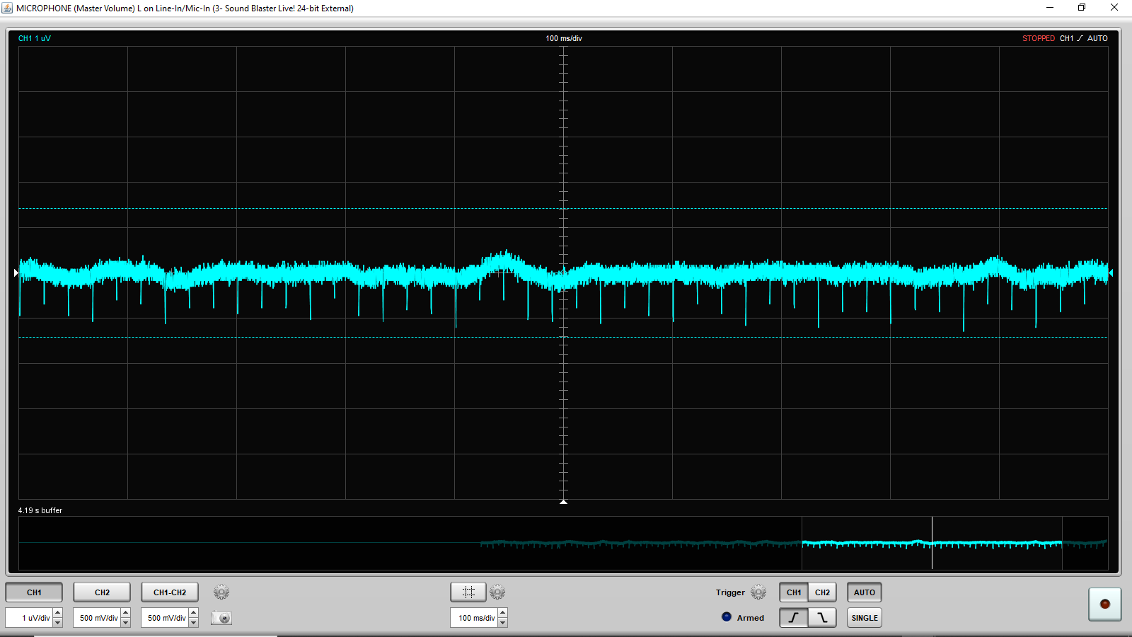

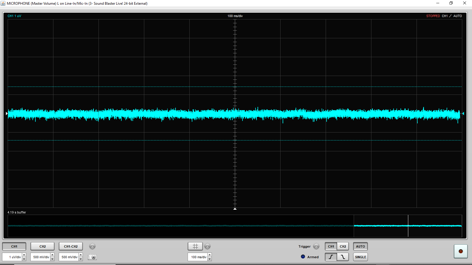

So I built and tested my first attempt at a low noise pre-regulator. This is intended to power the reference and LM4562 AVCC_R/L filter type supplies.
It consists of a CRC prefilter, followed by a shunt regulator followed by a capacitance multiplier. The shunt regulator is made of 3x parallel large die/low base resistance devices. (And the Zener, low value metal film resistors and large low ESR capacitors.) The capacitance multiplier uses 3x parallel large die/low base resistance devices, low value metal film resistors and large low ESR capacitors.
I would appreciate your assistance in interpreting the results from a noise standpoint.
I have attached the voltage waveform and spectrum from the LNA input shorted measured immediately before the voltage waveform and spectrum from the preregulator output. The preregulator output is running at 50 mA. Waveforms are 1uV per division.
I wonder what the sudden downward pulses are in the output. They are strangely regular in spacing. ???

No need to further show the scope noise, that's largely irrelevant, the noise spectra are good enough, once you calibrated and confirmed the noise scale.
What can I say, if your current noise spectra are at the same scale as your previous measurements, then your current results are suspiciously good. I am having a hard time believing that a linear power supply of whatever type and quality may have a noise of 0.5nV/rtHz. Besides, these values are much less than what you showed earlier as the LNA input shorted noise (some 2.5nV/rtHz). Are you sure your LNA is AC coupled with the power supply?
As of the "pulses", I don't know. They could be driven by your USB measuring setup, since USB has 1KHz and 8KHz frames events, but I am speculating.
