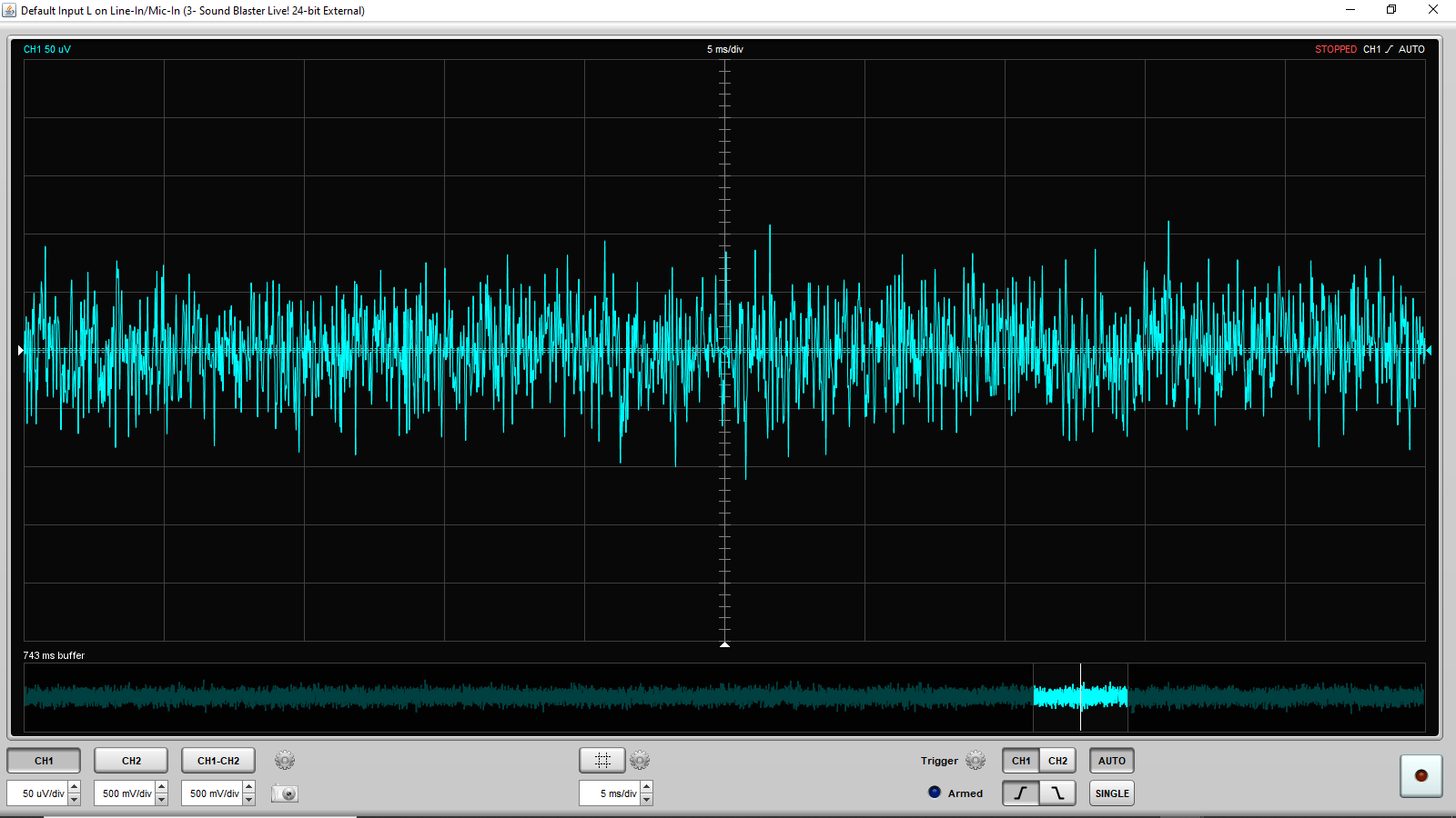

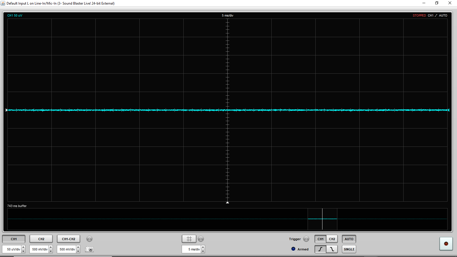

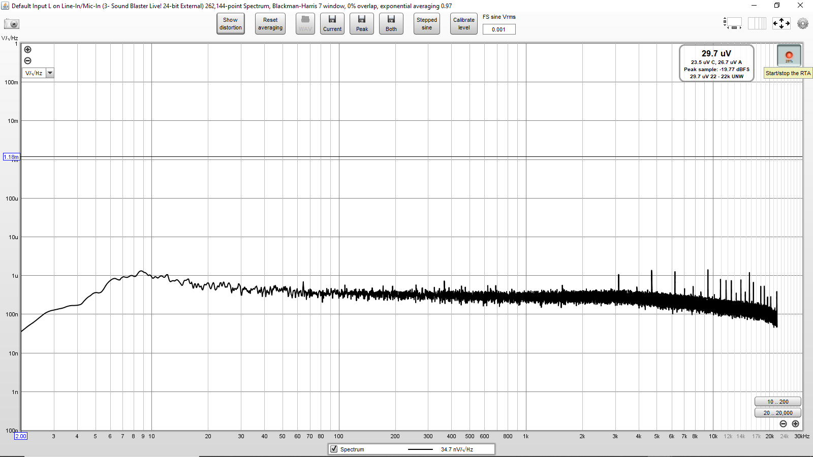

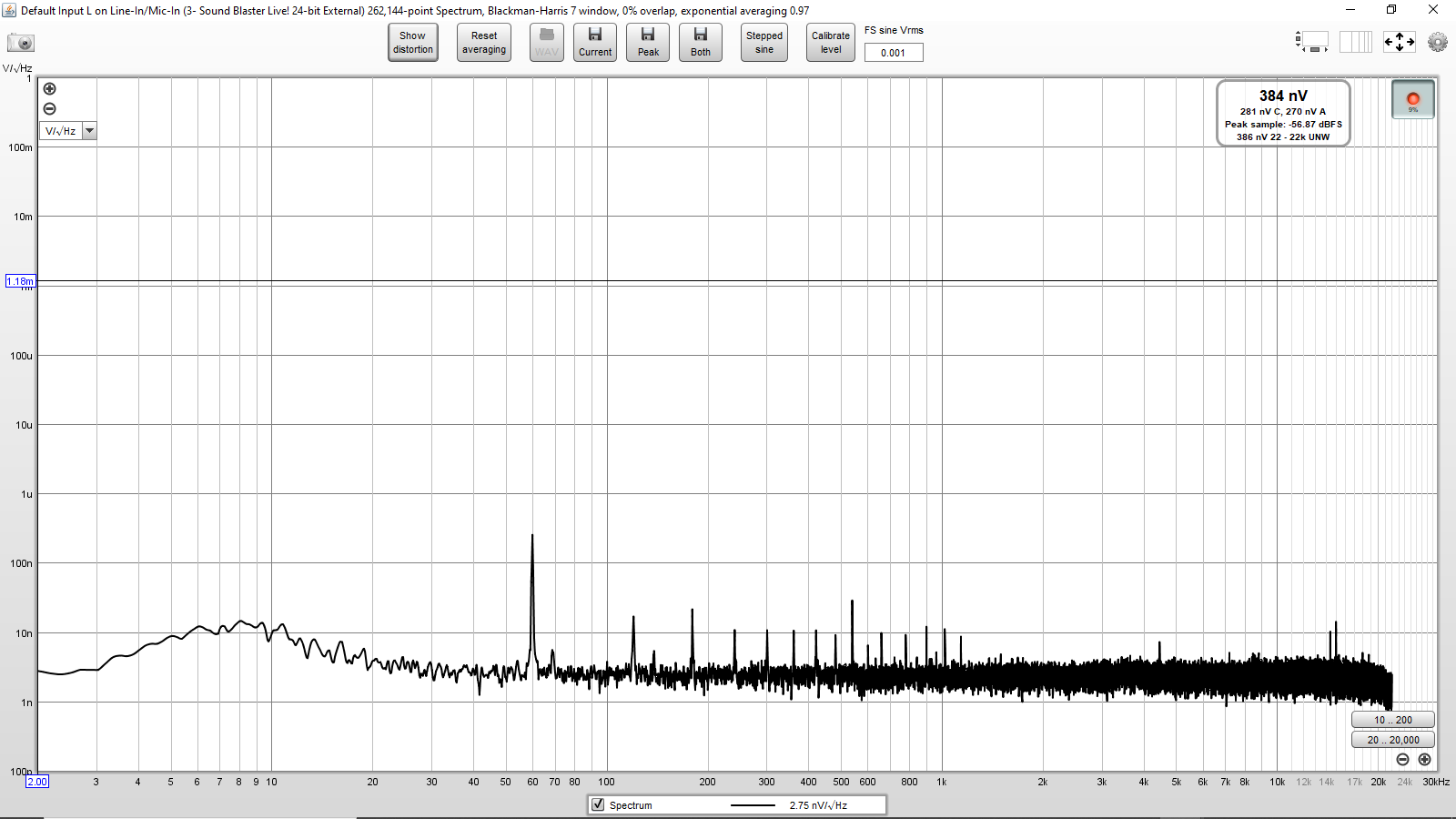

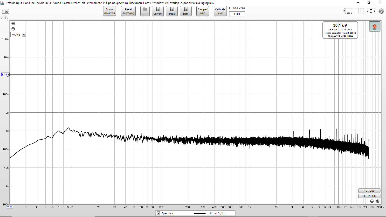

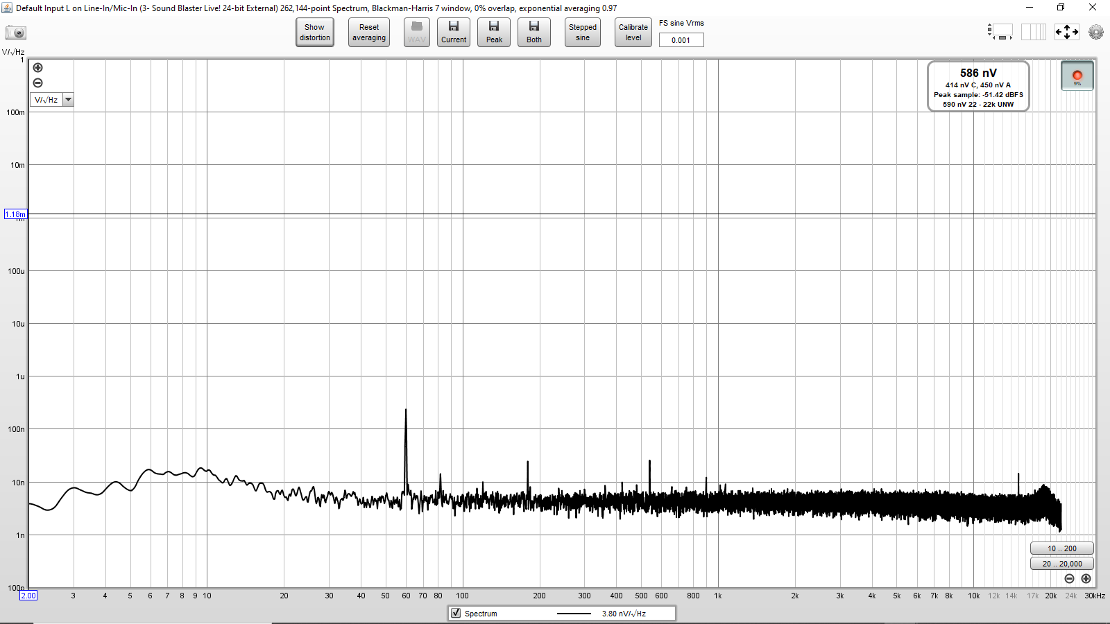

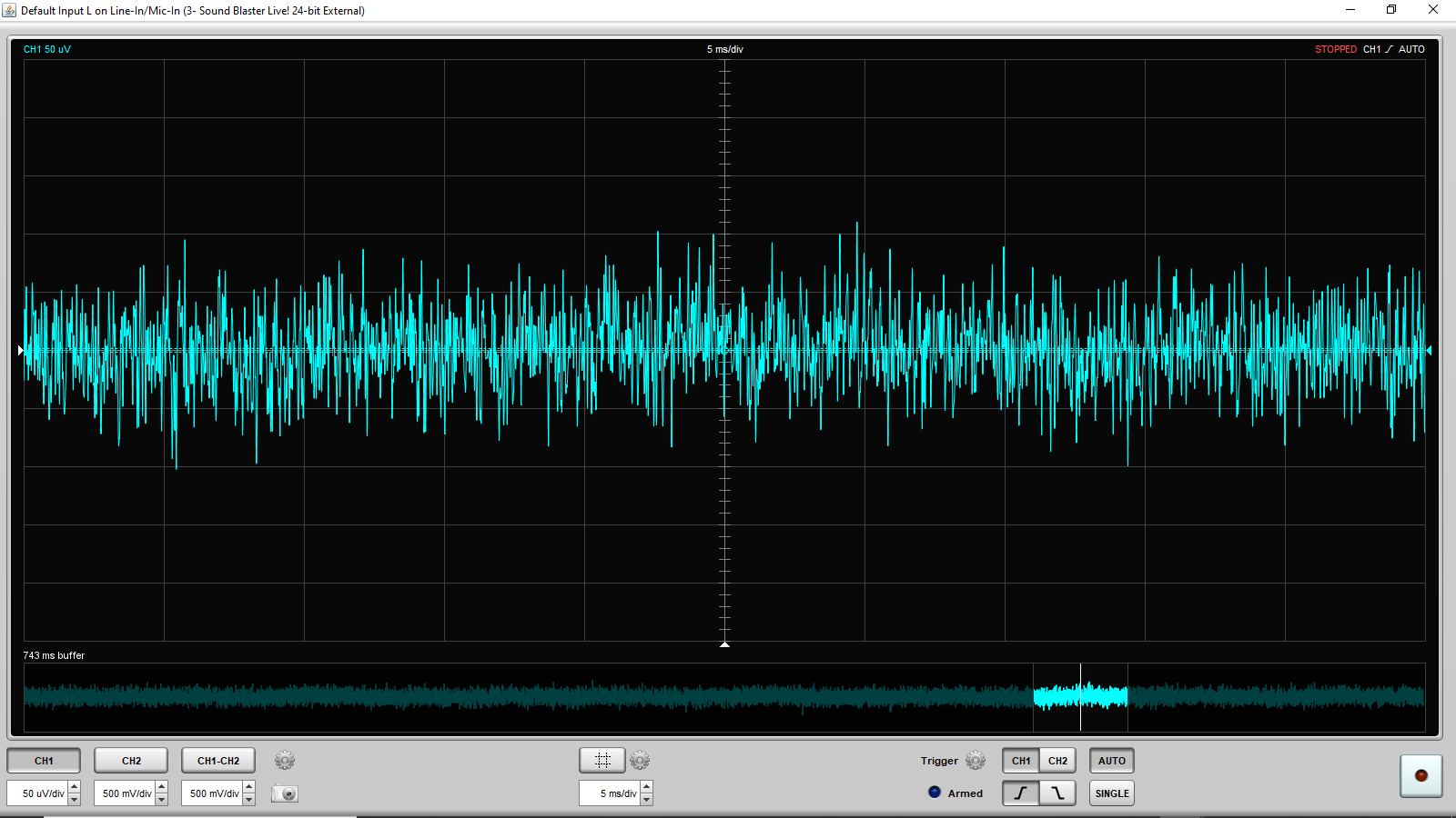

You keep doing your thing, please slow down and look carefully at what you are doing.

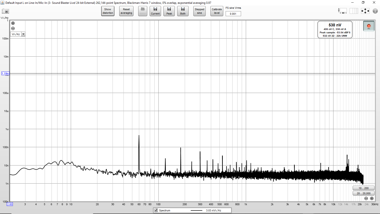

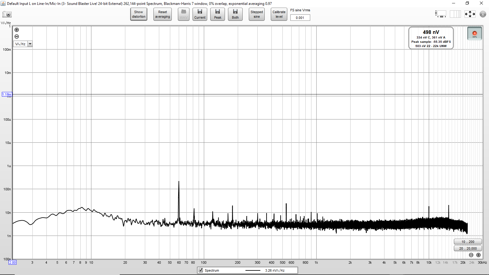

There's nothing to compare the cable short results, other than maybe with your previous result with the DAC "idle" or powered down? Please check the input short result, as follows: your cable has two ends at the DAC board: ground and "hot". The ground end goes to the DAC board ground; keep it there, then connect the "hot" end to the same ground. Do not touch anything between measurements. Now, measure with the DAC powered down, "idle", then with the DAC board @1KHz full scale. Post the results.
You mean like images 2, 3 and 4 from post 6753 but with the cable hot shorted to the ground that the cable ground is already soldered to?
Yes, like in all 1-6 in that post. Or anything else that could allow a direct comparison between shorted measurement and the real measurement. Better do a new set of both,
a) Decide for something to measure, say the AVDD noise
b) Consecutively (measure the AVDD noise, then measure the short noise). Don't touch anything else in between.
c) Repeat b) for the next DAC state - powered down, idle, 1KHz full scale
d) Post the results

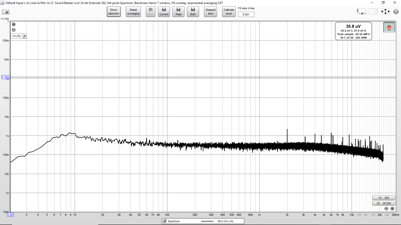

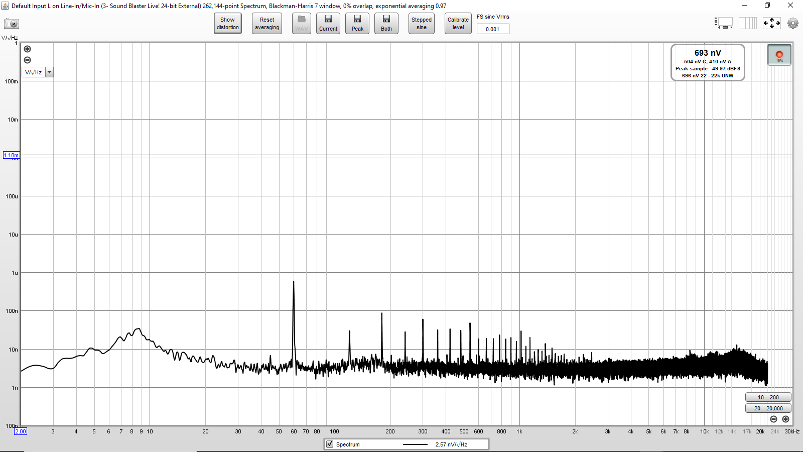

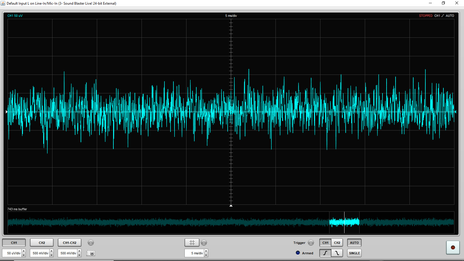

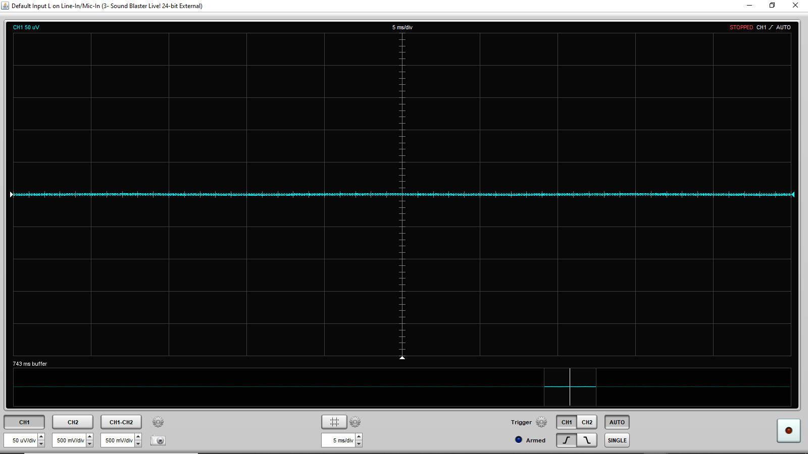

Ok. That took awhile and fortunately I was able to do it without damaging anything.
I am pretty confident that the 60Hz would be lower if I had designed the boards and used a tiny connector (maybe IPX) for test points. Anything sticking up is another antenna when trying to do this.
This is the AMS1117 input (output of the LM7805). All scope images are 50uV per division. Shorted means probe cable ground and hot both grounded to AMS1117 ground. In order they are:
DAC powered on, output section powered on. DAC idle:
DAC powered on, output section powered on. 1kHz fullscale:
The rest in the next post due to the number of attachments.
All DAC power off:
DAC powered on, output section powered off:

You probably picked the less relevant place to measure the power supply noise, the output of the 7805, the AVDD DAC pin would be much more so. Nevertheless, the results are showing that while you have some ground loop noise (if I’m reading correctly, 3nV/rtHz is over your alleged LNA noise) and then the 7805 output noise is about 200nV/rtHz, which is of the order of magnitude I would expect (50uV/sqrt(100khz)=160nV/rtHz).
This value is very high, I have no idea what would be at the AMS1117 output, much less at the AVDD pin(s) since there are some filtering and decoupling on the way. Measure if you want to, you are not doing me any favour 😀. You can for now skip the short measurement, since you know your measurements limit, the LNA noise. For your reference, the VREF noise (LTC6655 plus LT3045) for my instrumentation ADC project is slightly over 5nV/rtHz and the AVDD noise (LT3045) is around 7nV/rtHz. These are about 50 times less than what you currently get at the 7805 output.
AVCC_R is in post 6754. VCCA is in post 6756. Not surprisingly both are lower. I measured the 7805 output because I plan to replace it and I want before and after measurements. I don't plan to stick with the noisy regulators. But I do like to measure before and after I make changes.

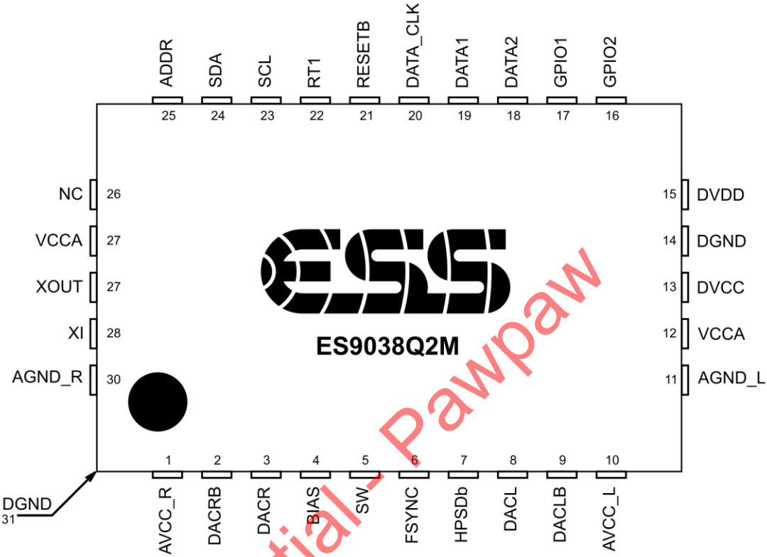

FYI: I am using the pin names that ESS uses in their datasheet. (Attached.)

Any chance you can post some measurements from the LTC6655 plus LT3045? (At the DAC pin? Not a reference or regulator alone.)

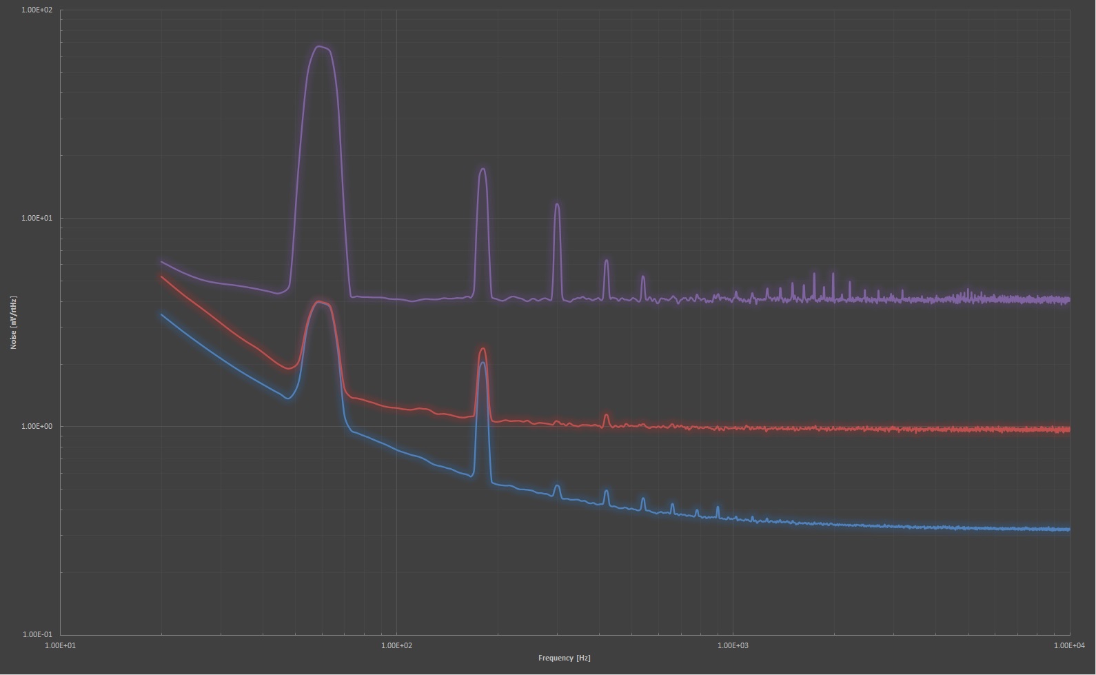

Attached, 20Hz-10KHz. Bottom (blue) is the LNA input shorted, mid (red) is a 50ohm resistor, top (purple) is the 2.5V VREF noise, ADC running with a 1KHz FS input. The LNA and the ADC are not shielded in this case, hence the rather large mains harmonics. LNA gain is 60dB.
Thank you for the data. When I start putting together candidates for the Vref I will trying measuring them along with small resistors such as 0, 50, 100Ohm. I have 3x parallel 2N4403 right now but I might be able to get some 2SB737 but that will take time. If that doesn't work out I can get ZTX951 in the order with additional good op-amps, ref and regulators.
There are actually a couple variants of the LNA setup and when I have to use SPDIF and when I have to measure something physically large that is actually the worst setup. When I measure something physically compact and also when I don't need SPDIF then a couple of interfering factors are reduced. In addition the better setup has much better LF response. The LF response is poor for the setup with SPDIF.
