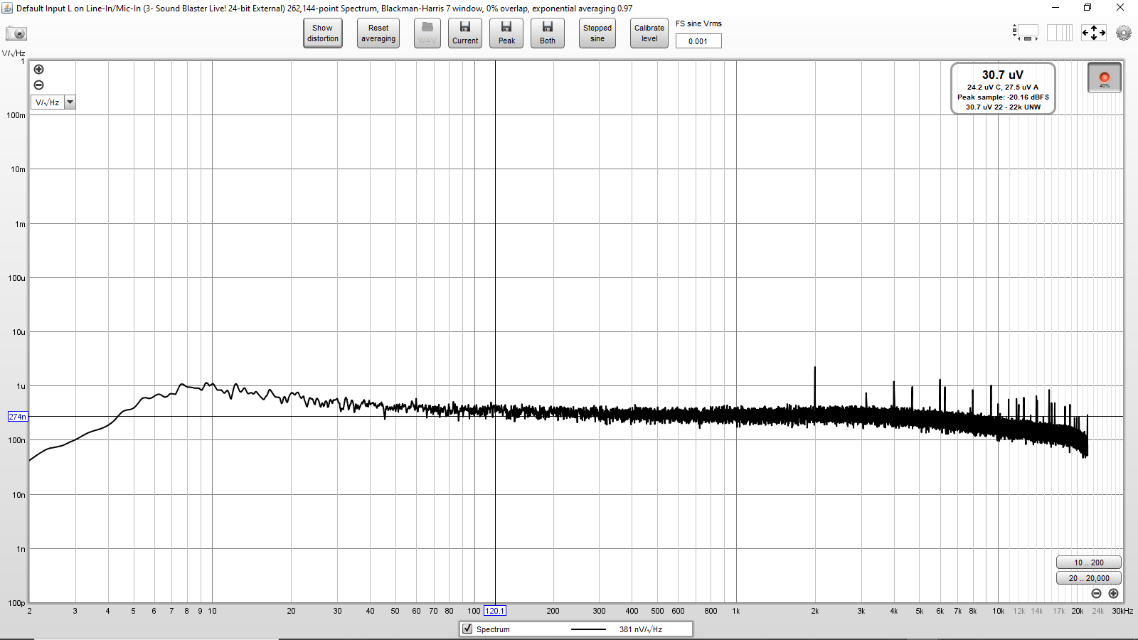

LM317 regulators with Cadj cap are in the low hundreds of nV/√Hz so the overall noise level is quite high. Also the mains related hash is too prominent. Maybe you should first try to clean that.
Yes, with all that Junk on the line; no chance of sorting the wheat from the chaff. thats really enormous. its like 25-35db higher than it should be. I think there are far too many variables in application to make someone elses measurements applicable to you.
Trying to figure that out right now.
And this is with the DAC output measuring about 30 dB improvement already. (2nd and 3rd harmonic at the limit of the ADC of my SB0490.)

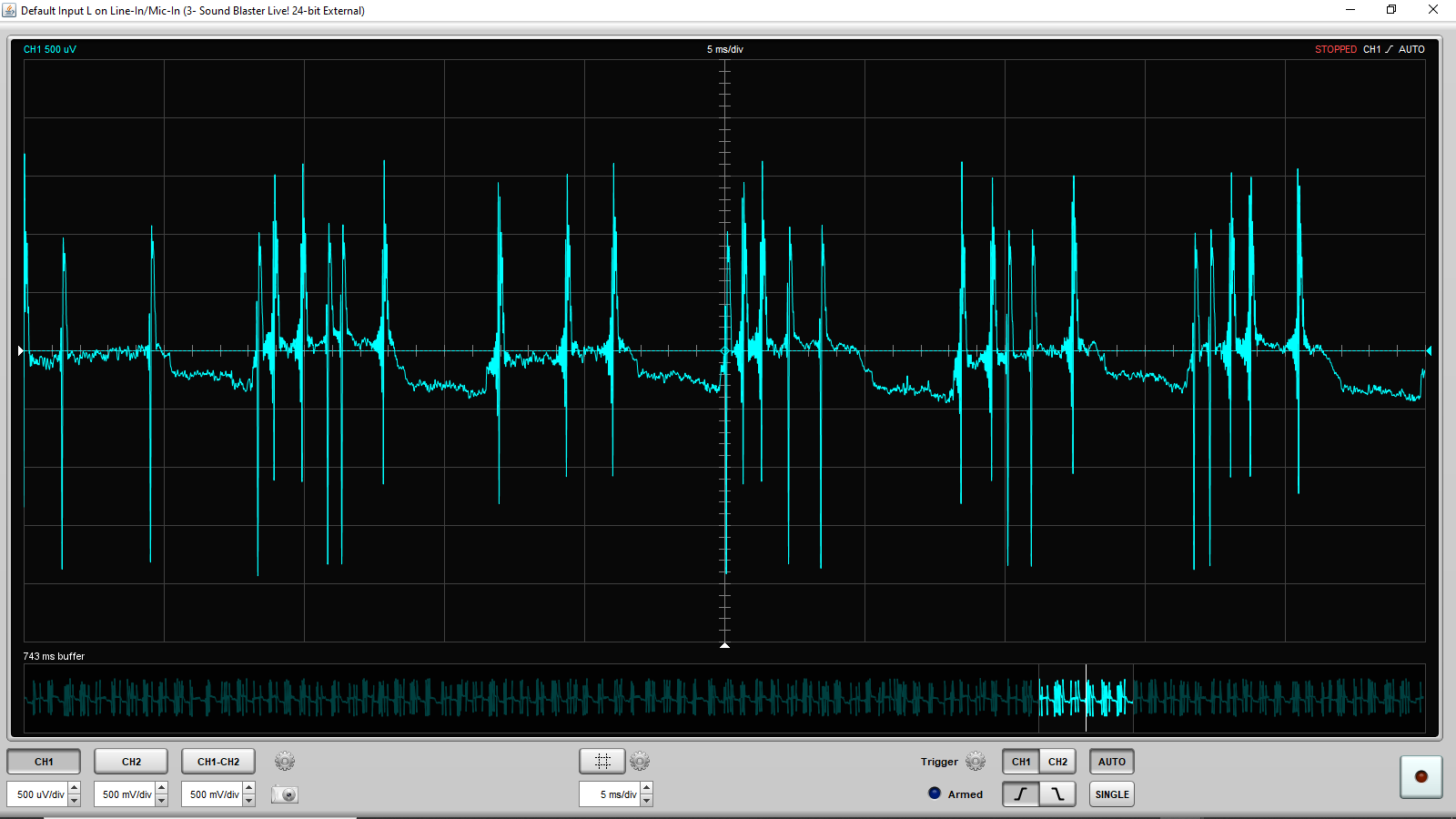

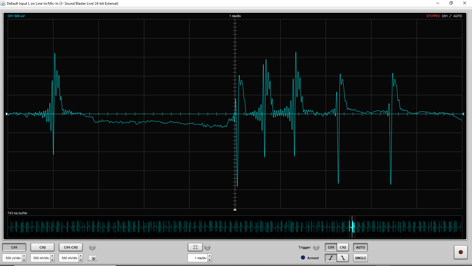

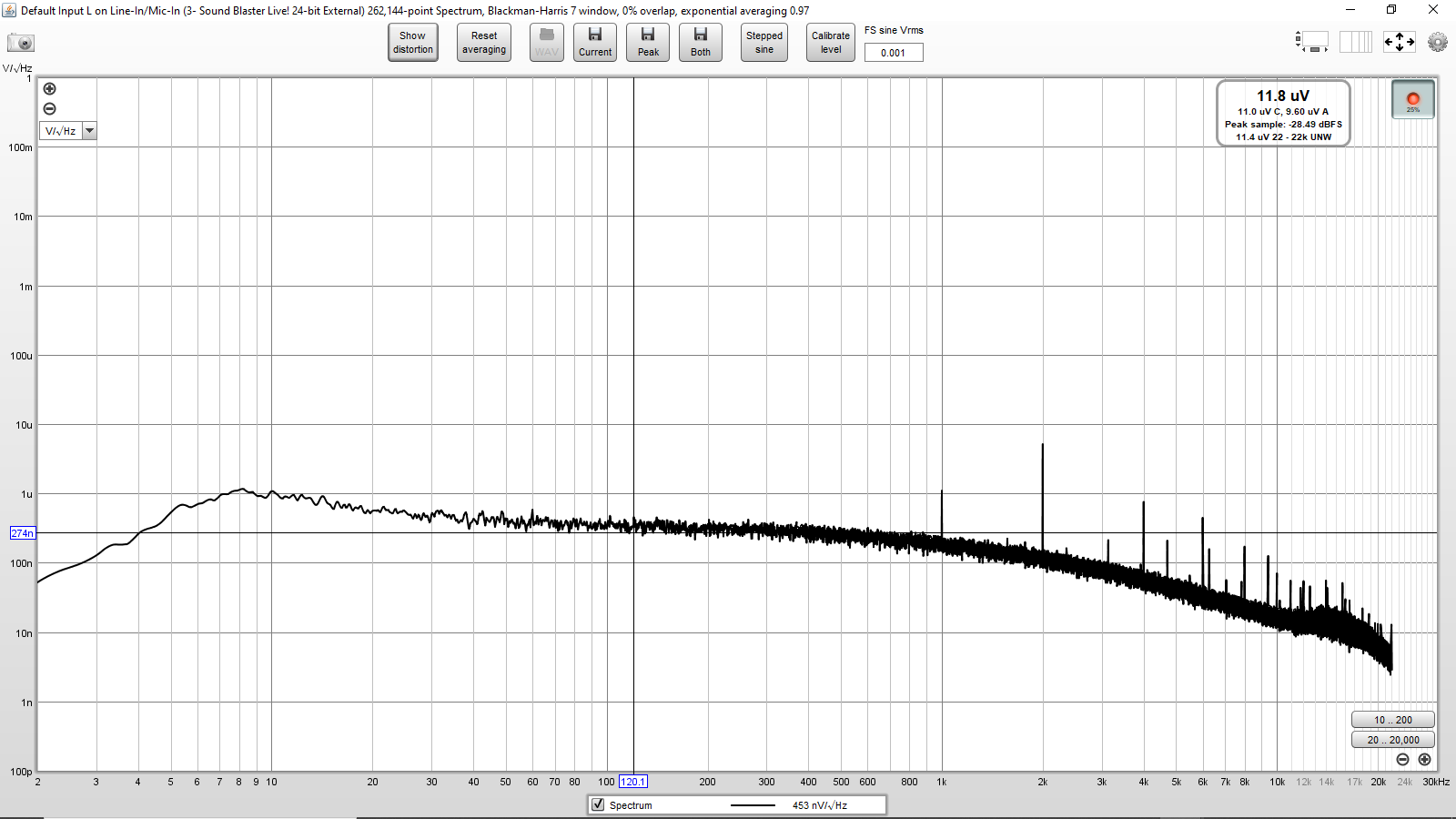

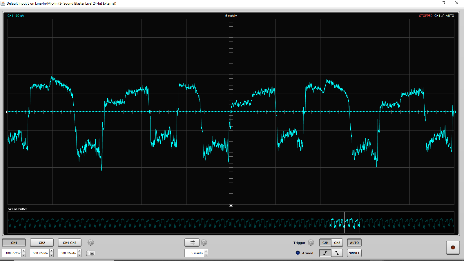

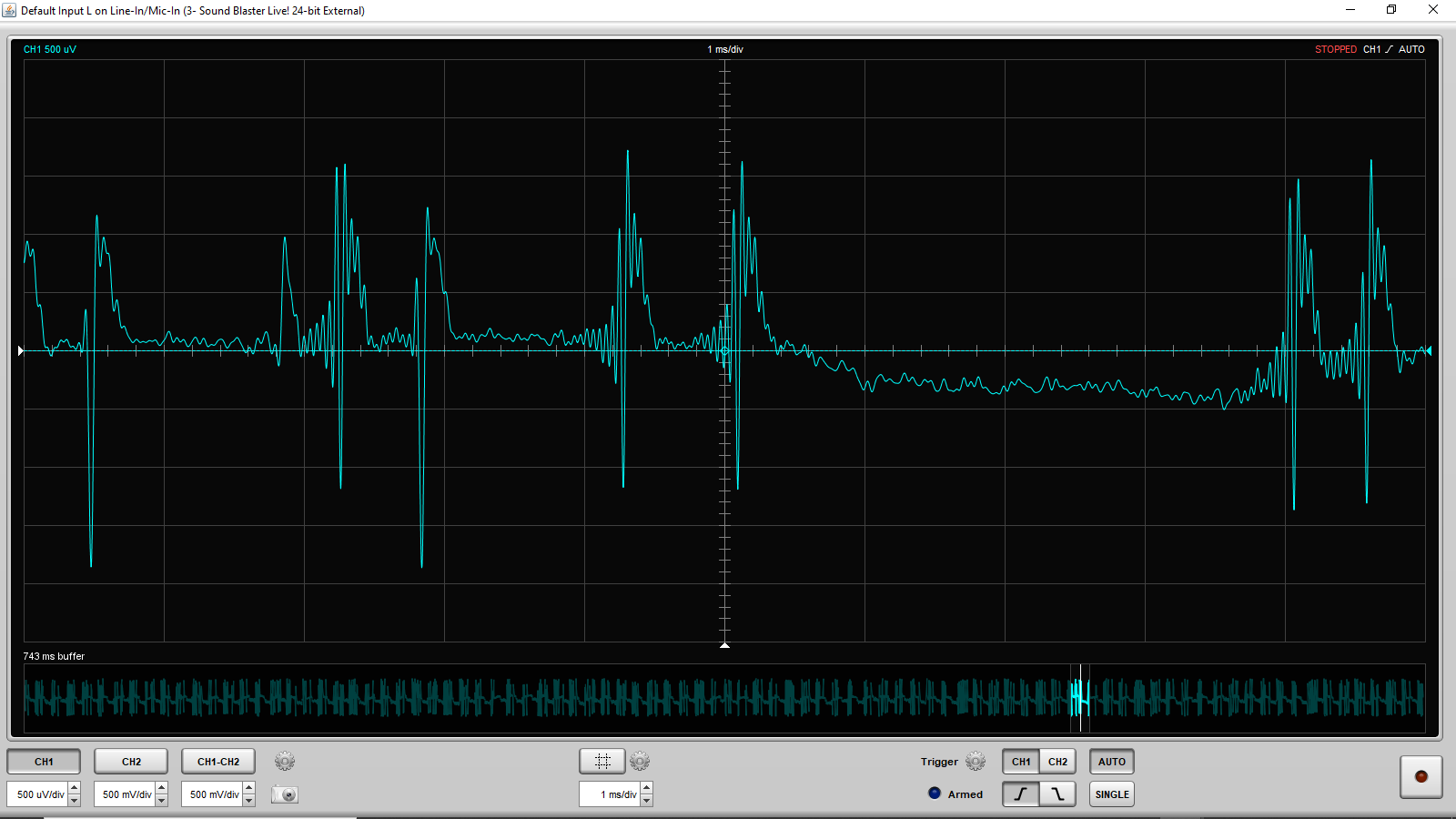

I have attached voltage waveforms from AVCC_R (powered by the stock AMS1117-3.3) and the input of the AMS1117-3.3.
The AMS1117-3.3 input is the output of the stock LM7805 which itself is being powered by an external 9.6V regulated HPRO/Harman Pro regulated power supply for musical instrument effects processors.
A square wave would explain all the higher harmonics...
Any ideas what is going on? Anyone have measurements to share? I would like to see what it looks like when it is working well. I am going to work on the power supply just in case the HPRO supply is outputting something ugly.

Attached images in order:
[Edited: The channel one scale is obscured in the screen capture. Not a good feature!]
- [100uV/Div] AVCC_R Idle
- [500uV/Div] AVCC_R 1kHz Full Scale
- [500uV/Div] AVCC_R 1kHz Full Scale Zoom In
- [500uV/Div] Regulated Input To AMS1117-3.3 Idle
- [500uV/Div] Regulated Input To AMS1117-3.3 1kHz Full Scale
- [500uV/Div] Regulated Input To AMS1117-3.3 1kHz Full Scale Zoom In

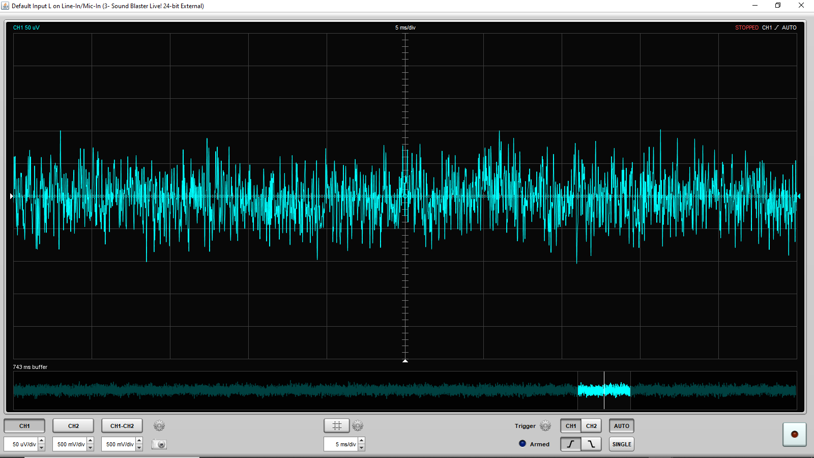

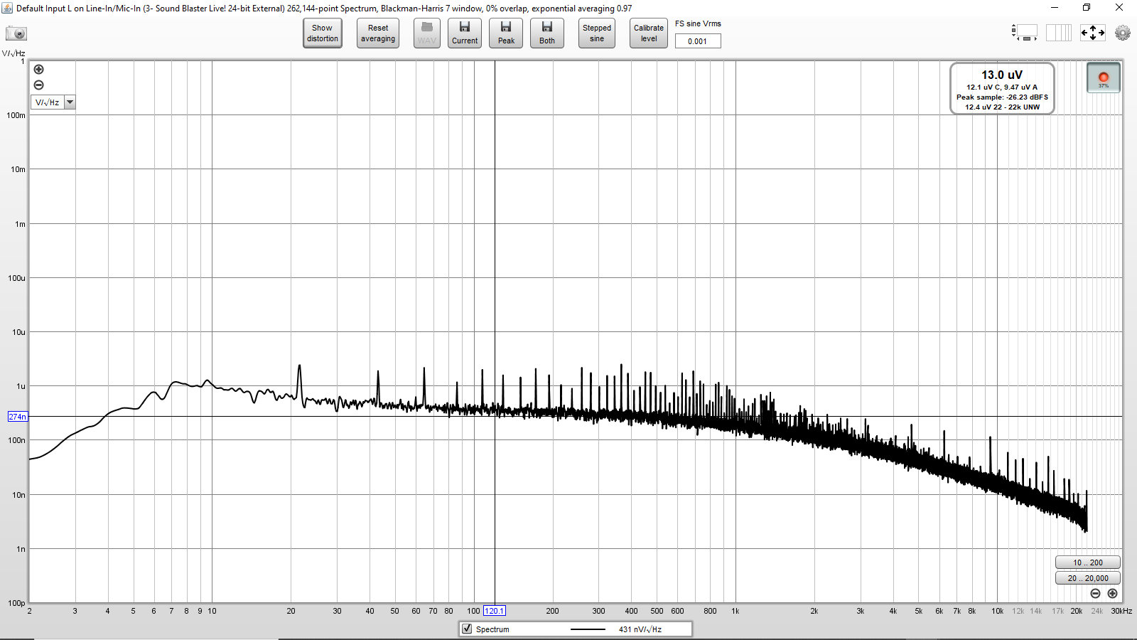

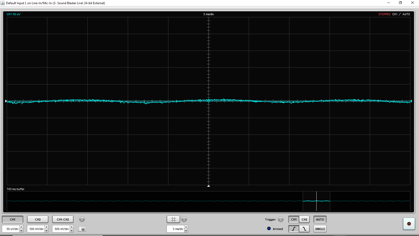

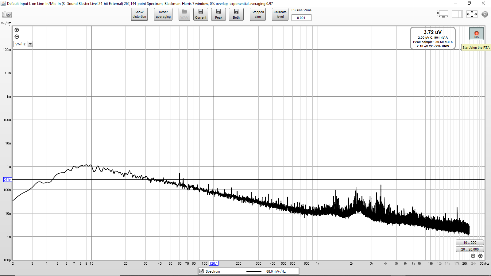

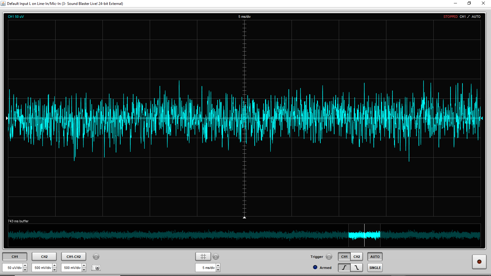

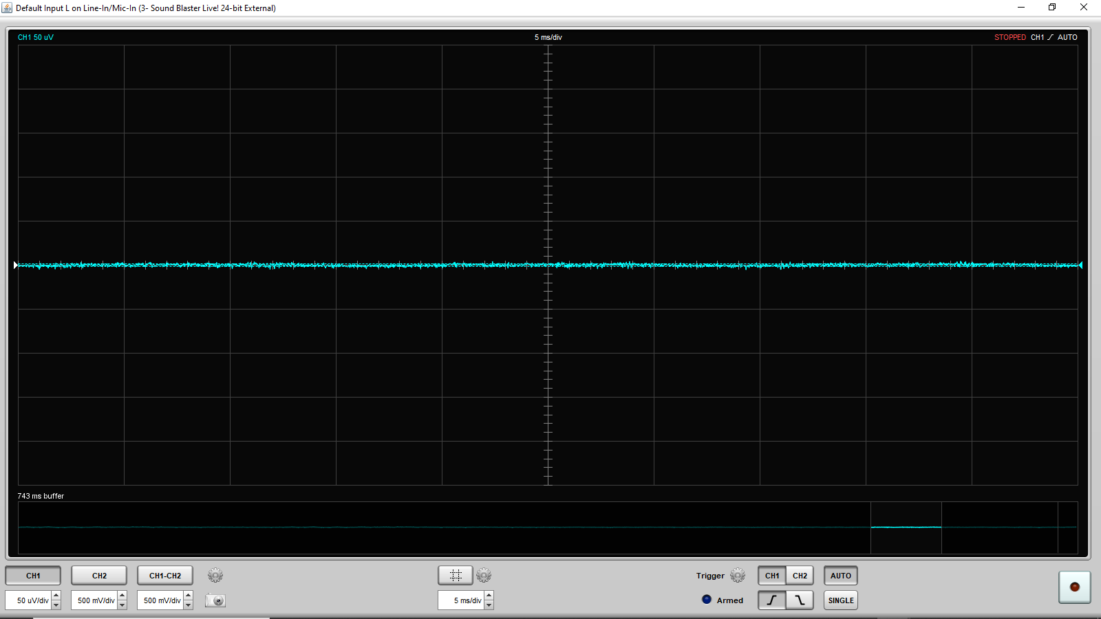

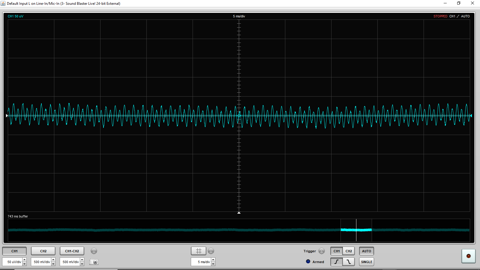

Ok. The HPRO power supply was a really bad idea. I thought a power supply for musical instrument effects processing would be pretty clean. I was wrong. The good news is that all these measurements just resulted in a massive improvement.
Here are new measurements. Note the scale change for the voltage waveforms.
This post/first post will be the input of the 3.3V rail regulator. (AMS1117-3.3).
The scale is 50uV per division for the voltage waveforms. Attached images in order:
- [50uV/Div Voltage Waveform] All DAC Power Off
- [50uV/Div Voltage Waveform] DAC Output Powered
- [50uV/Div Voltage Waveform] All DAC Power On, Idle
- [50uV/Div Voltage Waveform] 1kHz Full Scale
- [Spectrum] All DAC Power On, Idle
- [Spectrum] 1kHz Full Scale

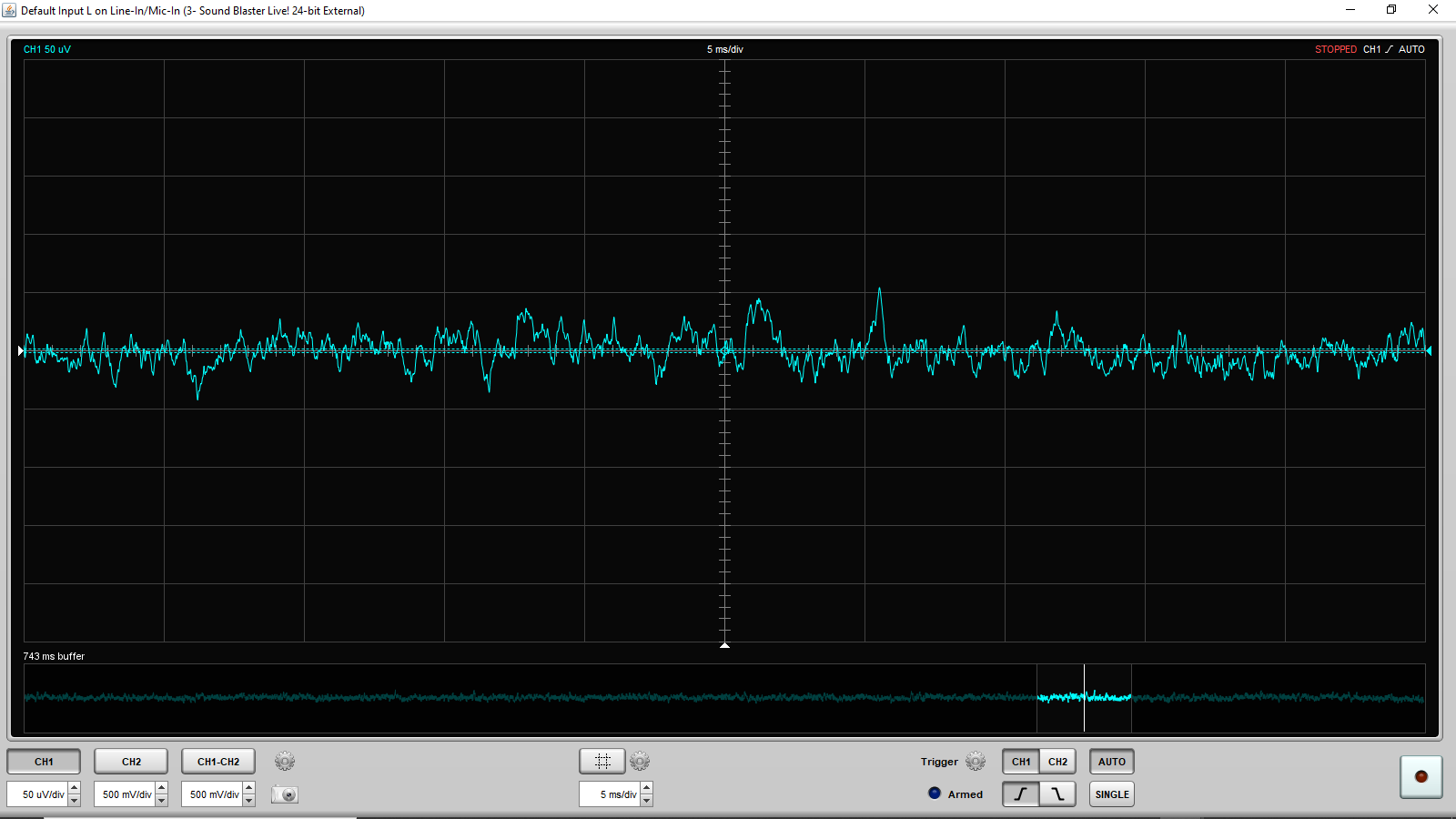

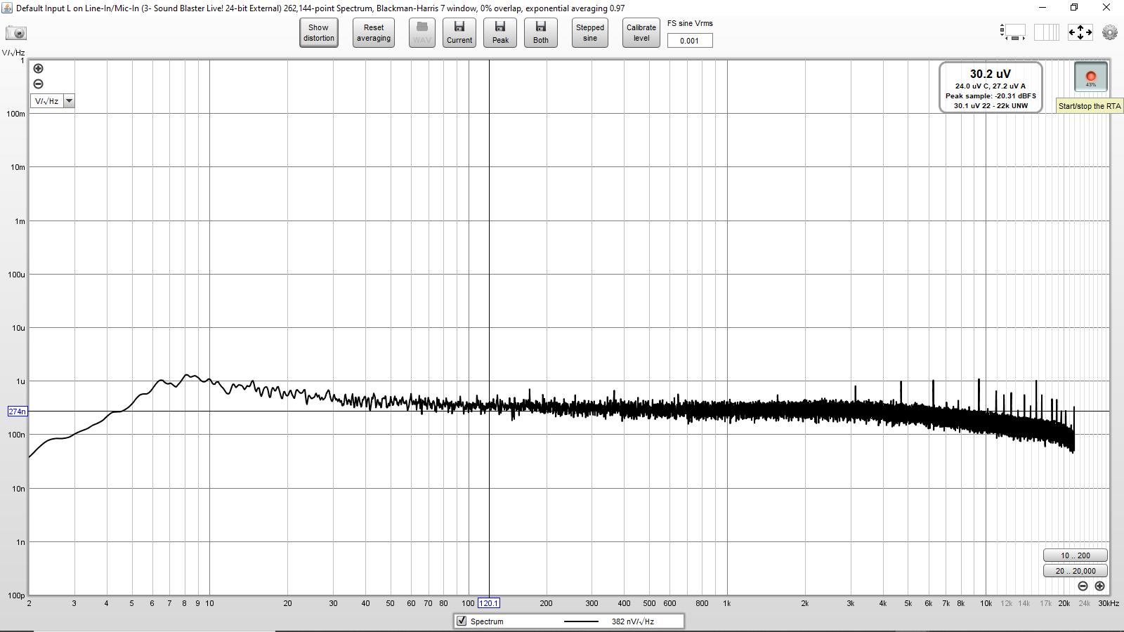

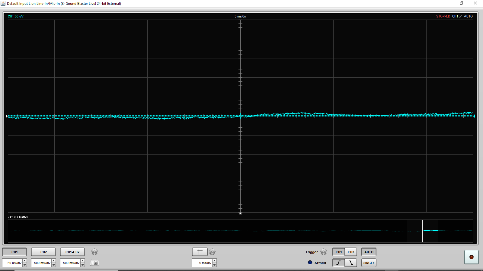

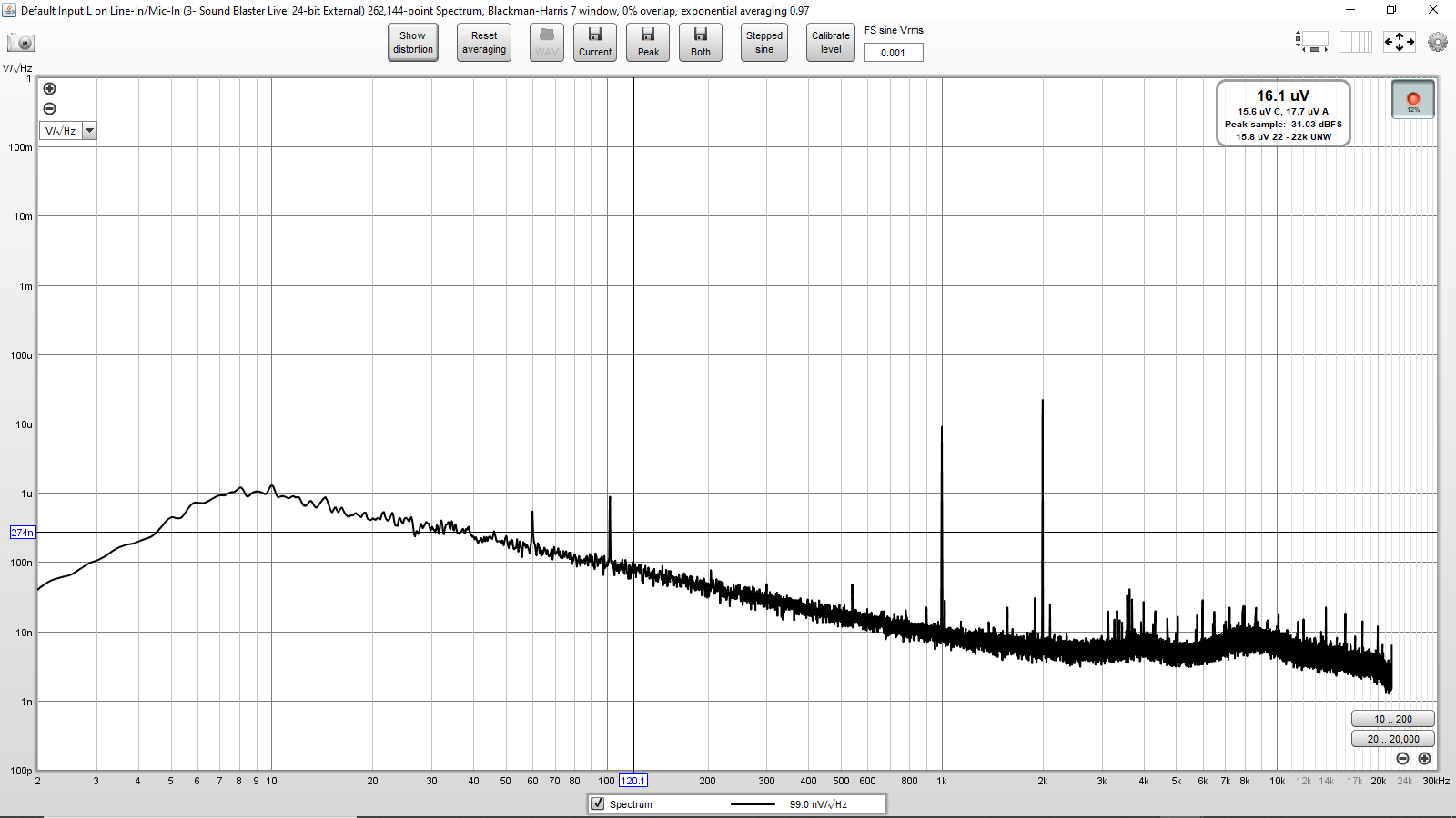

Now AVCC_R: The scale is 50uV per division for the voltage waveforms. Attached images in order:

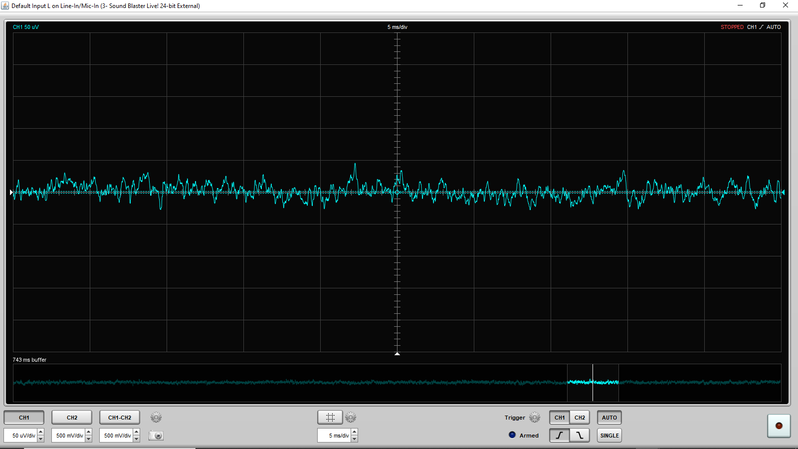

Now VCCA: The scale is 50uV per division for the voltage waveforms. Attached images in order:

1kHz Full Scale
Is that spur at 2kHz a harmonic of the 1kHz? like what if you change the 1kHz frequency, does the 2kHz spur follow it?
At least now your noise measurements are on par with what 7805+AMS1117 should deliver.
