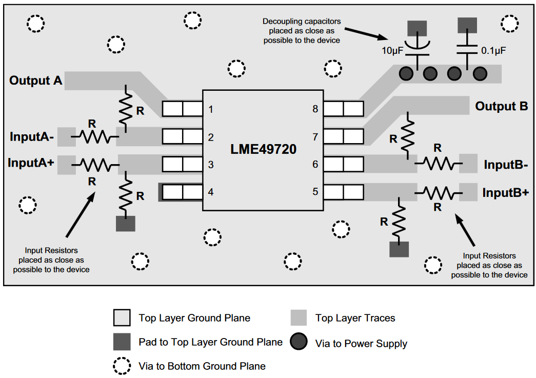

One free upgrade for SMD bypass caps. USE 2 or 3 vias per terminal in your patterns instead of 1, to lower the inductance. this is when placing directly under the DAC. on top, make a ground island and use a whole bunch of vias, but I prefer underneath, to free up routing.
Maybe like the attached tutorial.

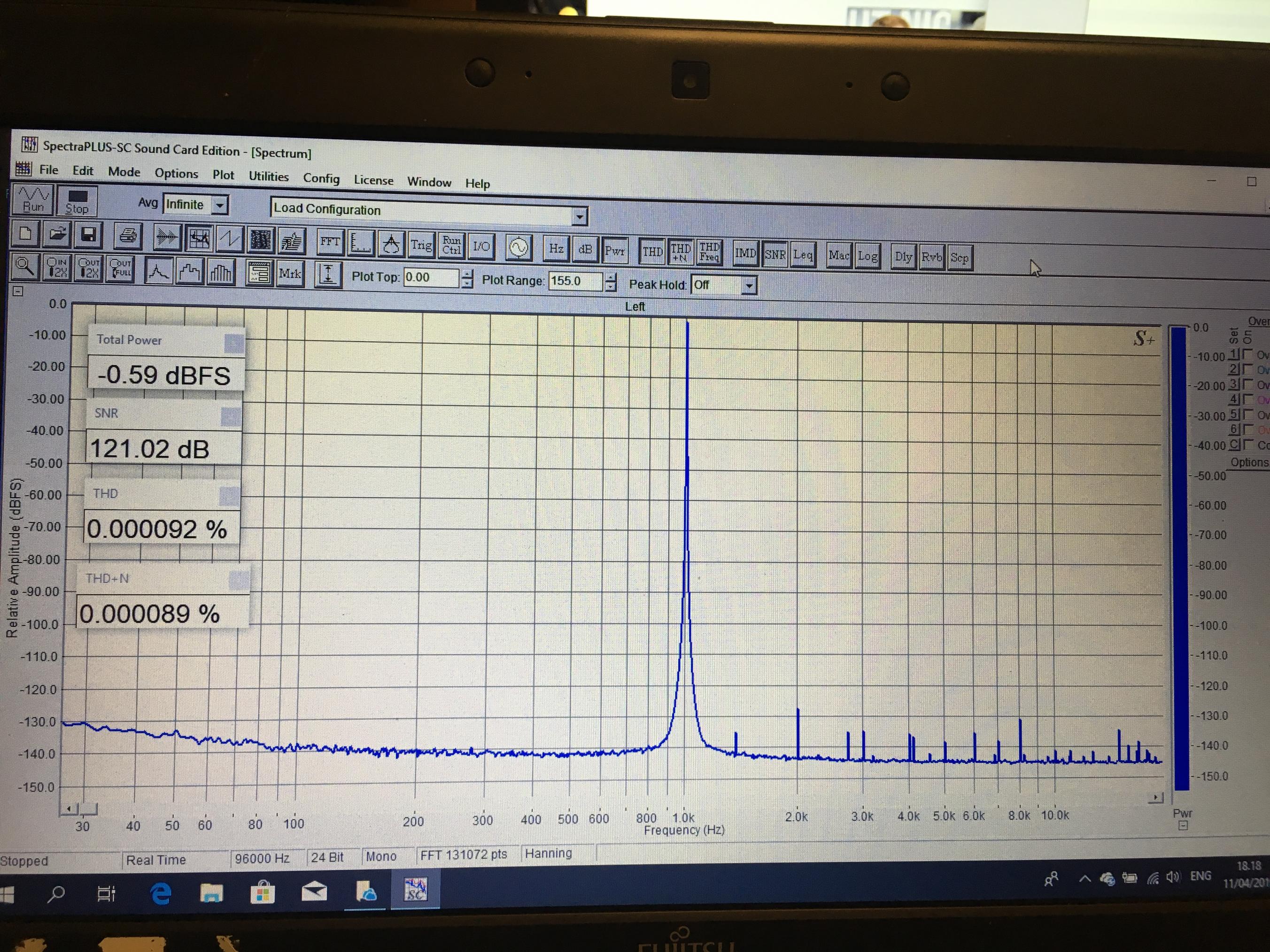

yes, and for those measuring thirsty here I attach the graph for ES9028pro with a discrete AVCC PS onboard, and LT3045 for digital and LT3042 for the clock.
certainly for the correct measurement one would need to use a rejector, but I was too busy enjoying the music that I never did this 😀
