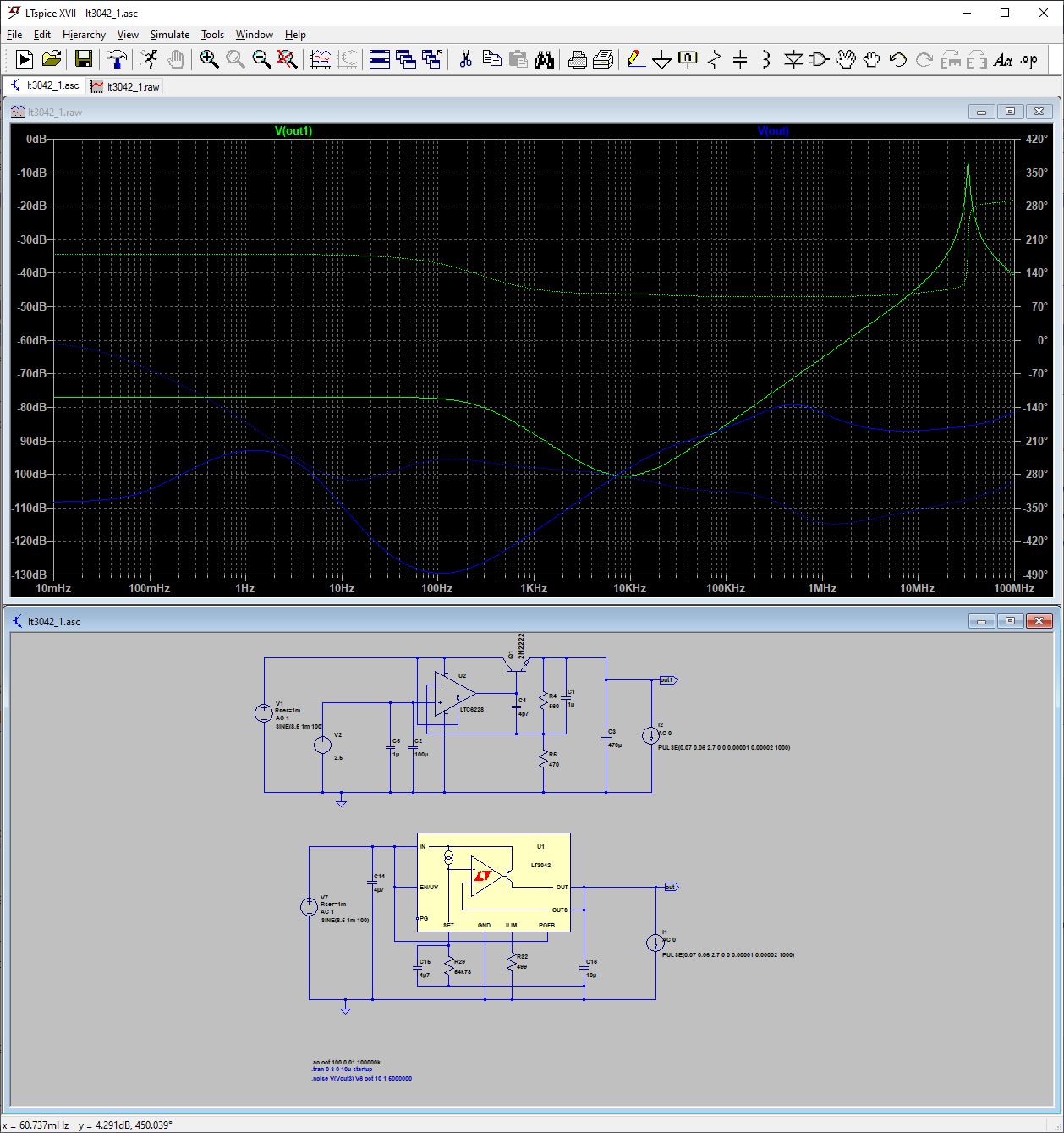

It would be very nice if Pavel would retry that simulation of the LT3042, with 10uF output capacitance, instead of the simulated 470uF. It is not by accident that the producer strongly recommends that filter capacity value.
With 10uF we will get back the claimed min. 1Mhz bandwith, which dictates the response inside 1usec instead of the <<16usec claimed in the sim..
Could we say that maybe it had been set up on purpose..? No that cannot be. On a positive note I see that a minimum bias current of 60mA had been maintained, at least.
Otherwise the result, cca 10mohm output impedance is not that far from reality. I have measured cca 5mohm, or a bit better, with 1MHz bandwith. Rising to 20mohm at 2Mhz.

Maybe Pavel should also simulate PSRR (green is discrete, blue LT3042).
But anyhow simulations at these low levels are not to be taken as references. Implementation details (such as trace lengths as George mentioned) may totally turn the table.
So, please only measurements as evidence. Ok, results from controlled listening tests are also fine as evidence 😀

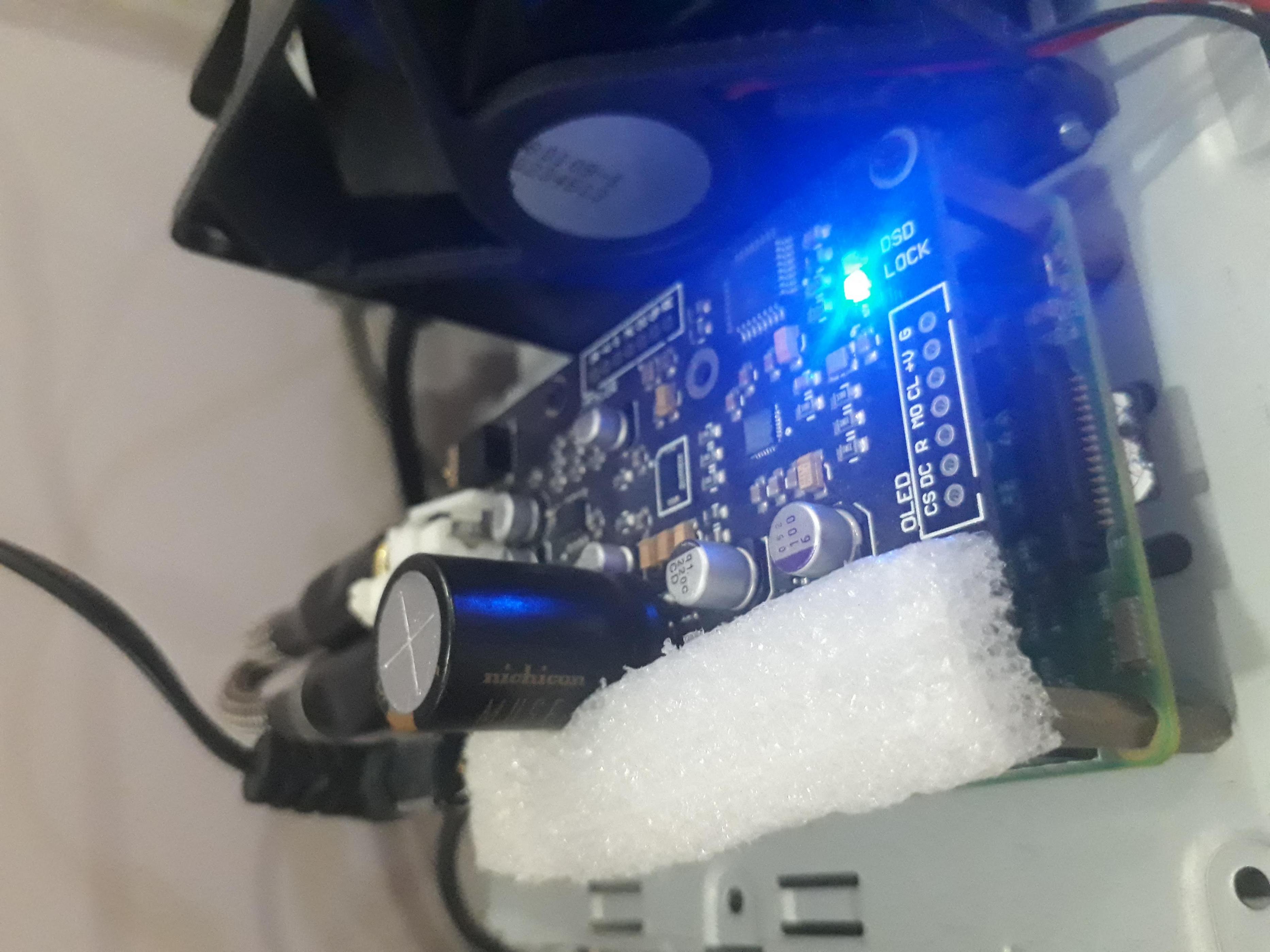

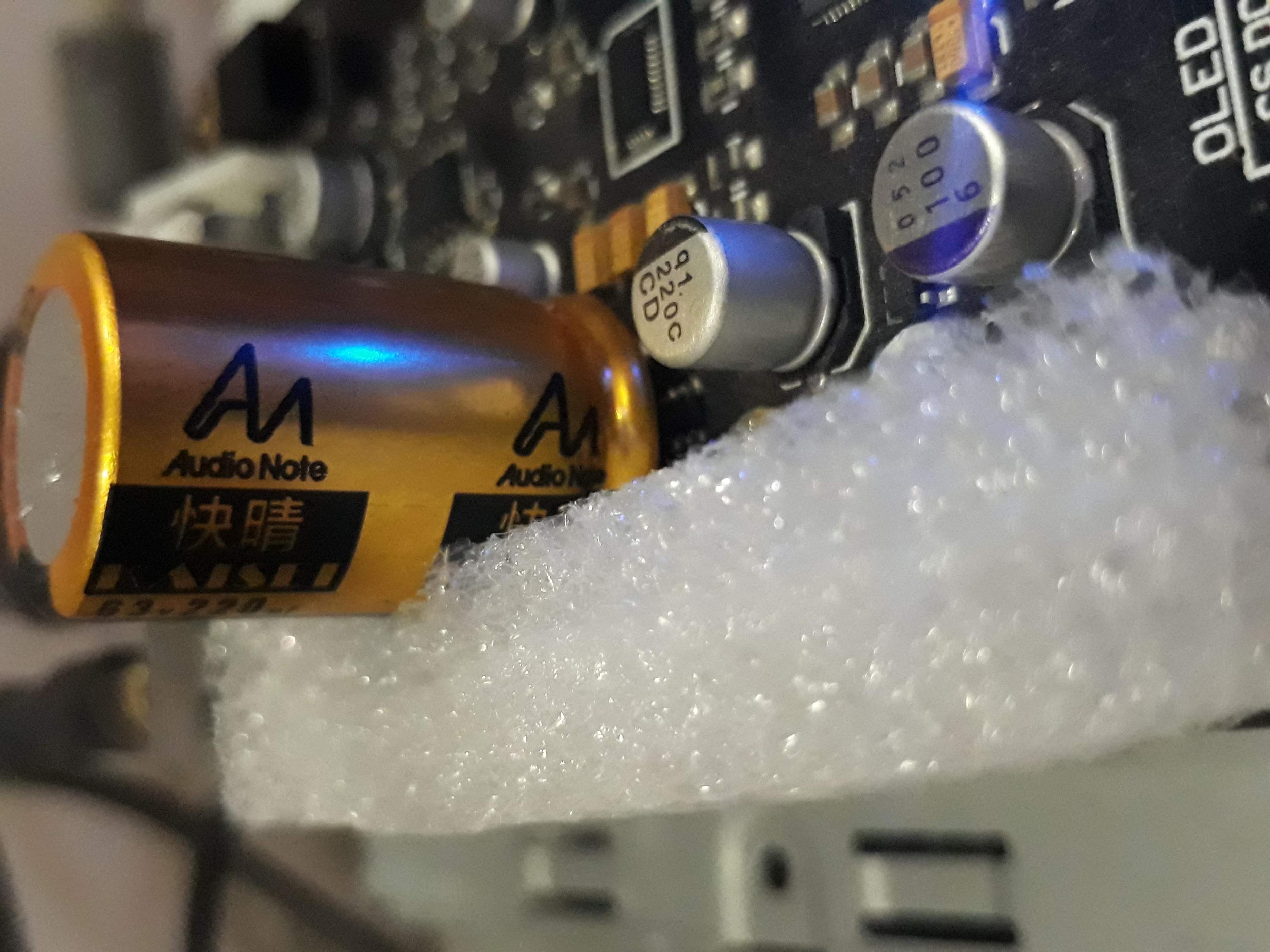

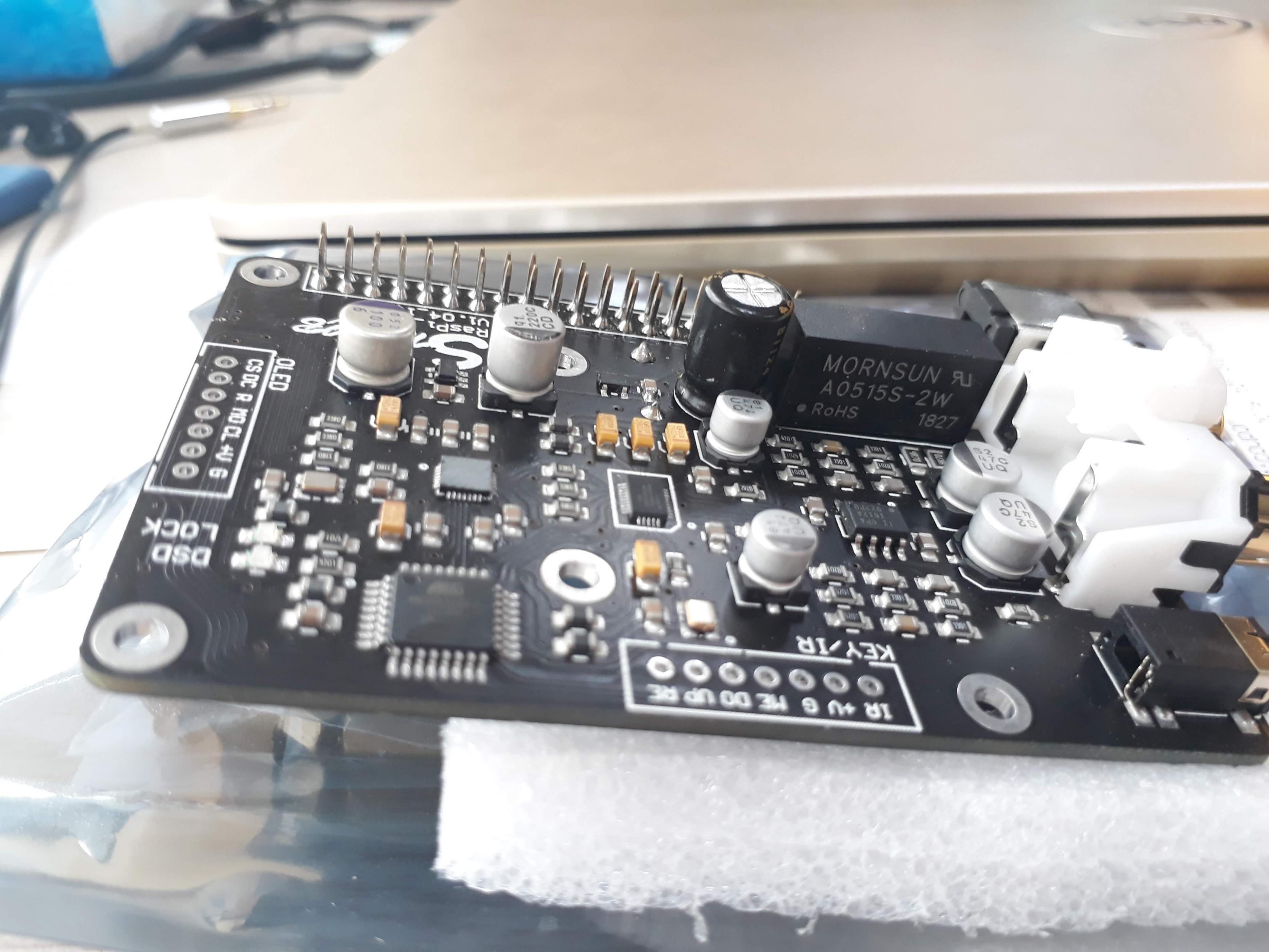

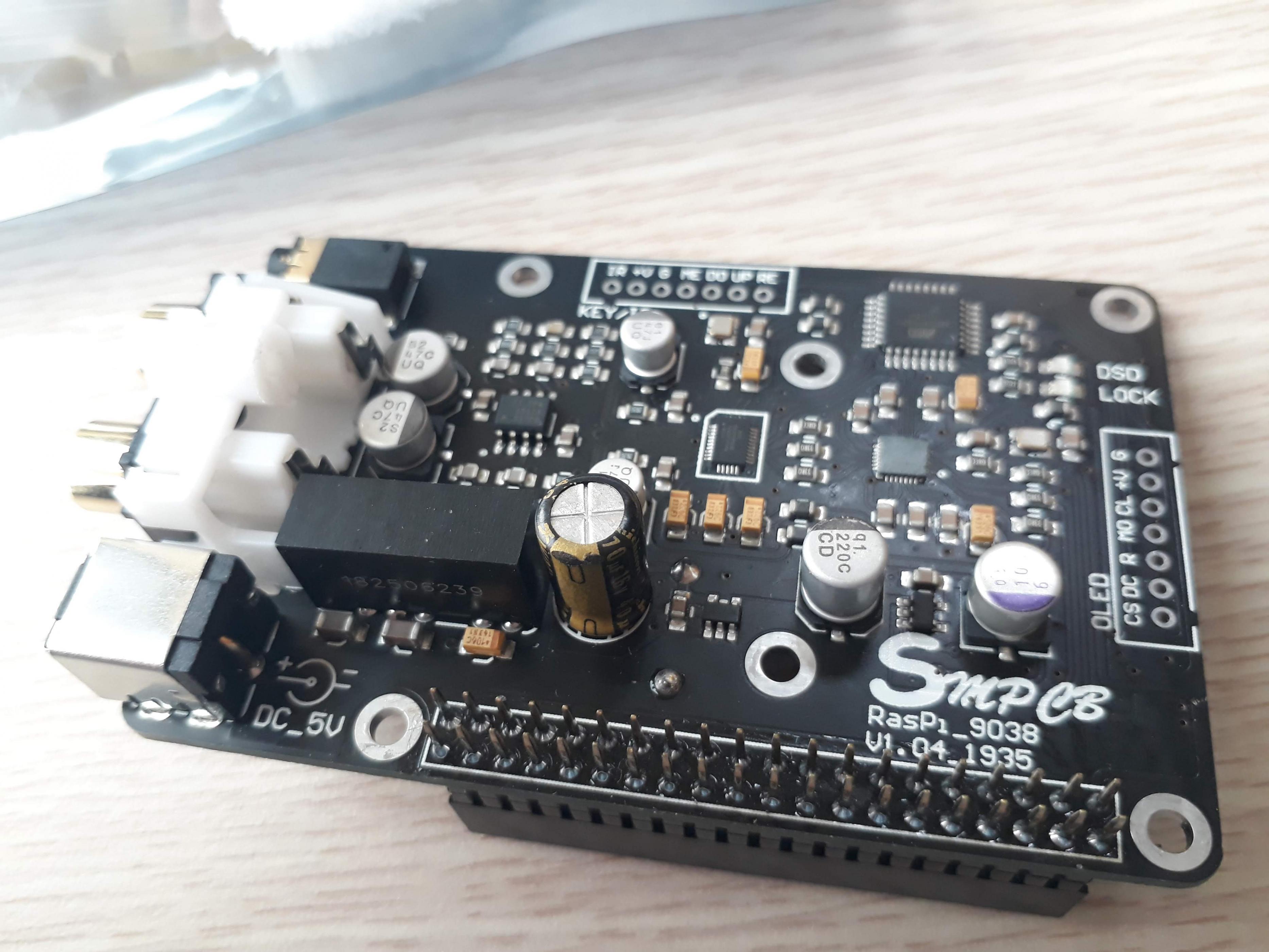

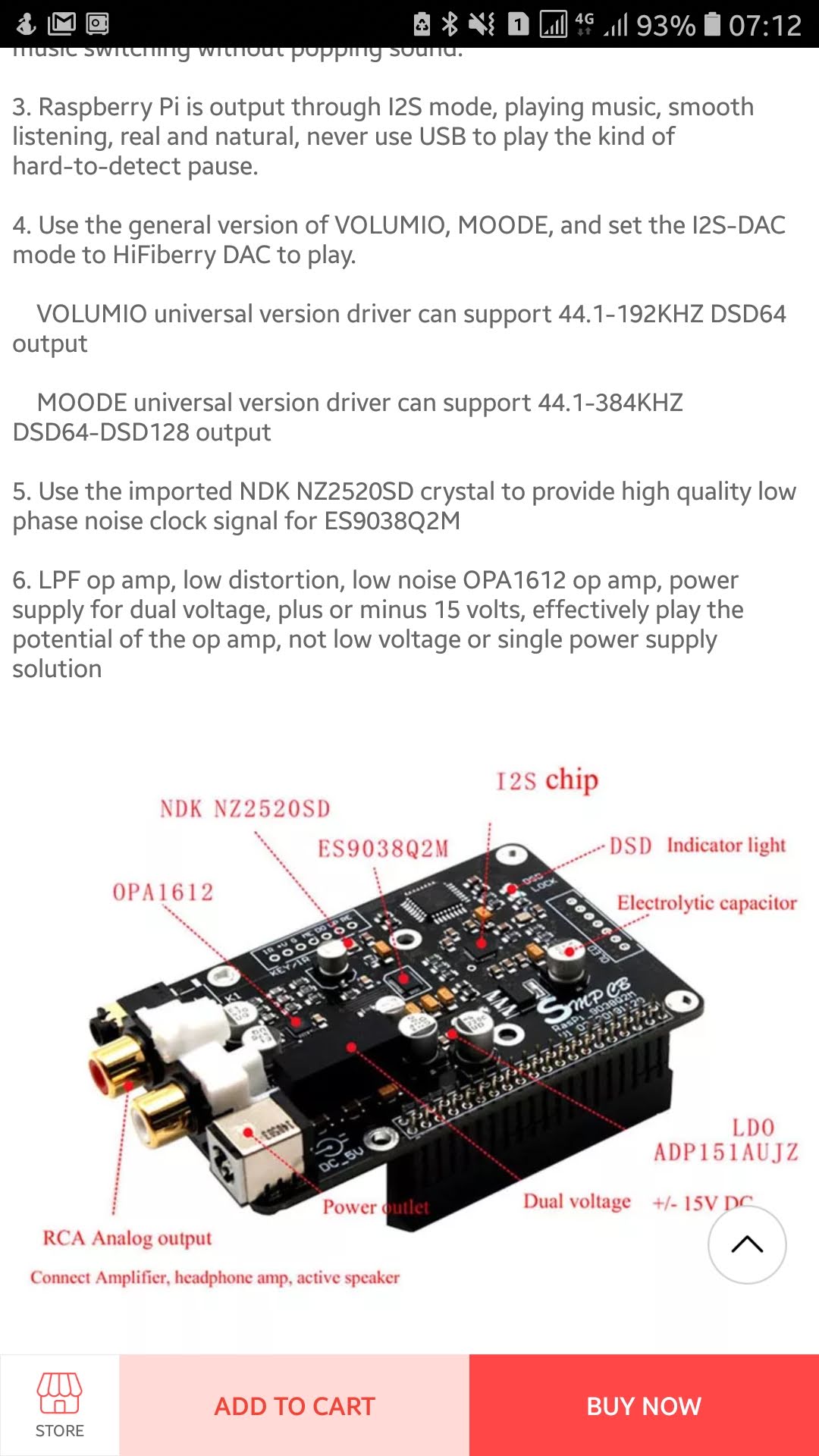

Anyone using this i2s DAC HAT for pi? Any recommend mod is highly appreciated. (It seems less room for modding).
ES9038q2m OPA1612 Op Decoder Digital broadcast board I2S 32bit/384K DSD128 for Raspberry pi 2B 3B 3B+ DAC G3-001
I just upgraded 1 cap (Audio Note) with wima 0.1uf in parallel.

These boards don't come with 3042 or any high performance regulators for that matter. They have only LM7805 and AMS1117-3.3 on them.
By dynamic performance I assume you are referring to either line or load regulation? If so, would the combination of AMS1117-3.3 + 560uF ultra low ESR be better or worse (and in what way) on these boards?

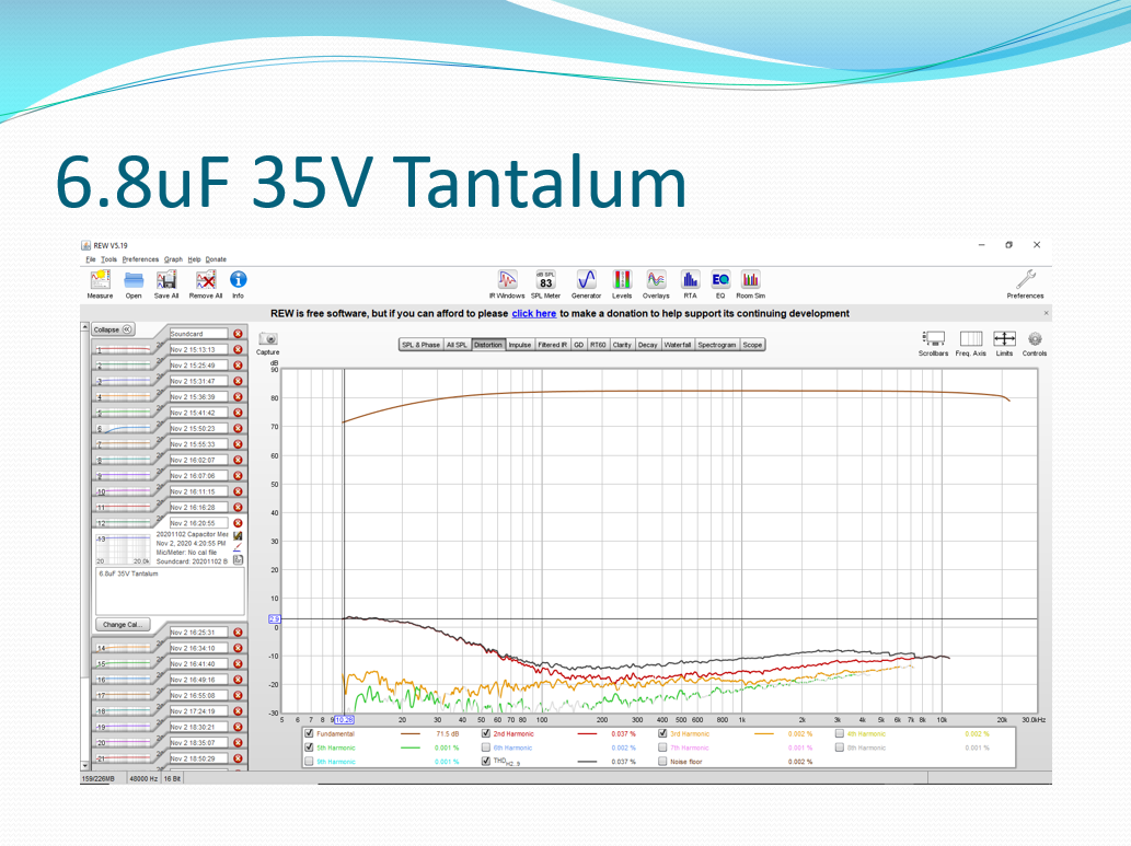

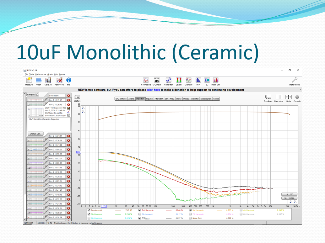

I did build a 60 dB LNA so that I can examine actual data regarding noise. (Picture attached.) I was planning to use that later once I bought the low noise regulators and also started to make the op-amp based (filter type) AVCC supplies.
As for capacitor types I am generally only concerned about non-bypass usages such coupling capacitor or filters in ultra-low distortion circuits. Thus I read about measurements on capacitors and performed some of my own (signal coupling) distortion measurements. (Two illustrative examples are attached.) When bypassing my general approach is to keep the voltage across the capacitor constant. I try to make a nice broadband short using an appropriate combination of small to large capacitors. Obviously on this board I can't change the layout but if I was making a layout I would place the capacitors and ground vias as close as possible. For bypassing what is your concern regarding capacitor type?
I recently assembled an ultra-low distortion headphone amplifier with 8x parallel high current op-amps with the intent of extending the range of my distortion measurements. However my concern was not for bypassing. Are you perhaps concerned about insufficient bypassing (when the capacitors are too small) where there are large ripple and noise voltages remaining riding on top of what you want to be DC instead? (And then perhaps being distorted and generating harmonics of the ripple and noise?)

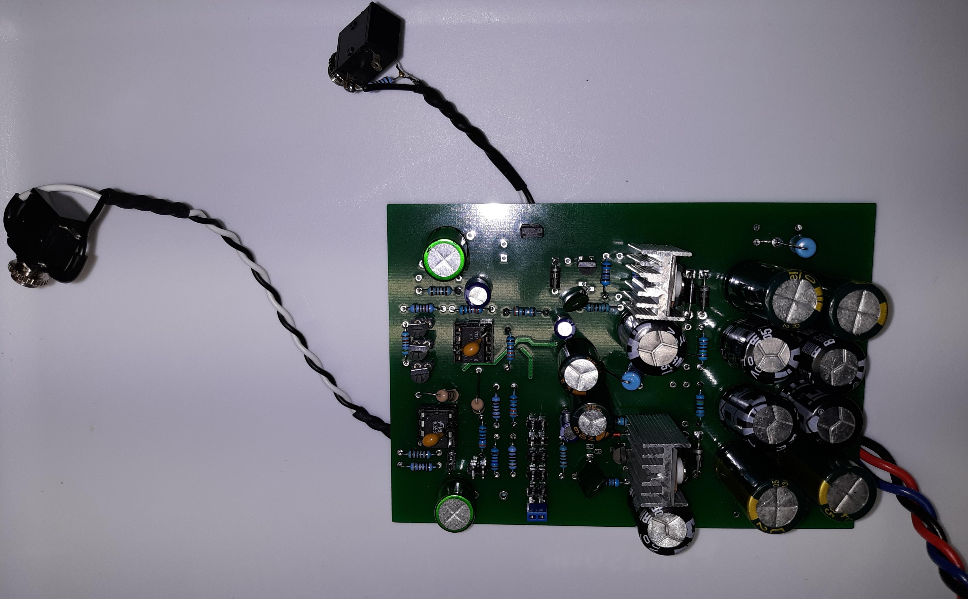

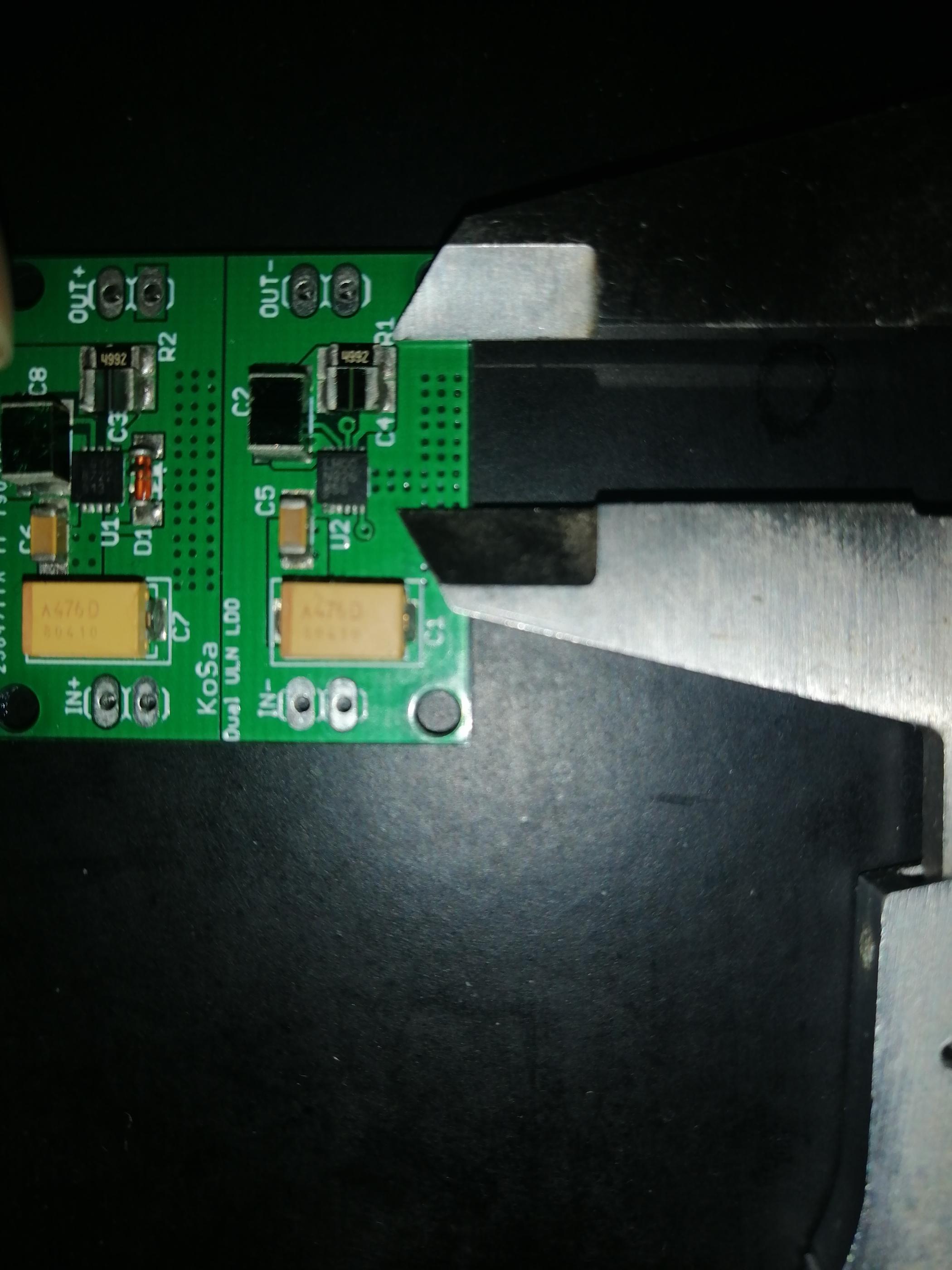

What regards the space, yes I was exagerating a bit - though not too much? See photo, there I was really not 'sparing' sul quality, 1206 precision set resistor, 1210 filter cap (PPS), PMLCAP in output. 1cm is indicated.
On a board, the big input capacitor is not really needed.
(while with a floating board the inductance of the external wiring harness should be absorbed by some more uF)

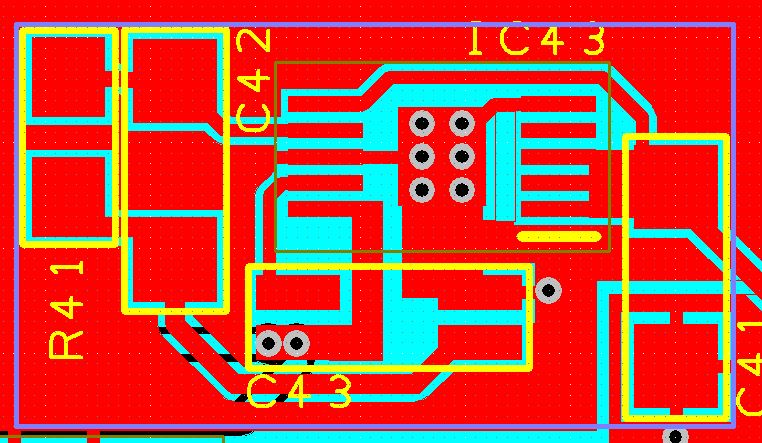

Here is a 2-layer LT3042 layout that I have used on some designs. This uses the "easier-to-solder" MSOP package. Caps are 1206 and Rset is 0805. The whole regulator fits within 14x8mm (blue rectangle). Note also the "Kelvin-connected" output capacitor as recommended by the datasheet. Don't know if it is actually doing any good 😀
Anyhow one of the advantages of the small space required is that once you have a decent layout it is easy just to copy-and-paste the same layout on other designs.

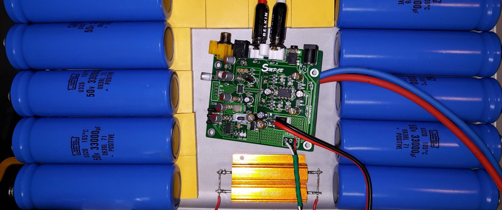

So I was wondering if the ultimate AVCC performance would be achieved with two batteries. Low noise, low impedance. However it seems to be difficult to get the right voltage. Two NiMH would be around 2.4V and three around 3.6V. Single Li-ion would be too high around 3.6V to 3.8V.
But I think I have found the solution.
Please see the attached picture. The idea is to have a low impedance shunt regulator (1 Ohm resistor shunted by a fast 2SC6145 ring emitter transistor) charge a 5x33,000uF capacitor (battery like) which is also bypassed by a bank of film capacitors. The individual connections to AVCC would be 1 AWG 6N pure copper (red and blue in the photo).
Each AVCC has a separate low impedance battery like shunt regulator with separate capacitor banks.
Due to concerns about the thin ground plane see the second photo. I could use a dremel tool to gently remove the solder mask and then I could solder the pure copper plate under the ES9038Q2M QFN package on the back of the board.
