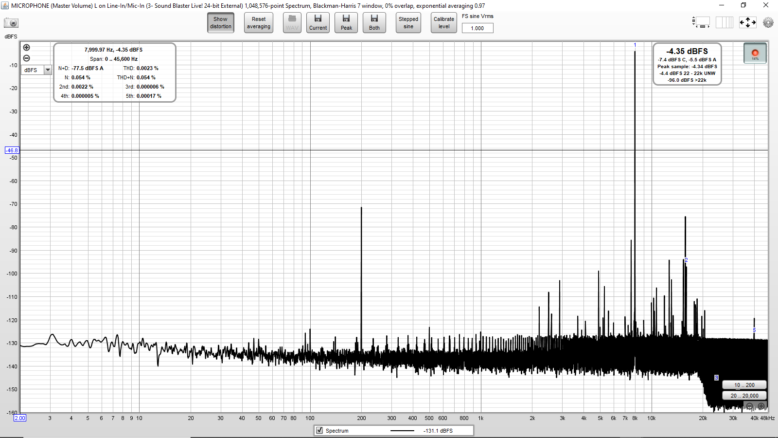

Thank you for the old measurements.
They don't look like my spectrum with the huge 200Hz & 15.6kHz spikes/spurs. No sign of that mess in your spectrum.
So I wonder if I have a defective board or ES9038Q2M chip?

Here are some more measurements after attempting to deal with supply noise at the noise sources.
Since there are ferrite beads all over the board I thought I would try to use them to an advantage and suppress noise from the sources getting to the sensitive clock and analog pins.
What I did was Noise Source > Low ESR OS-CON > Ferrite Bead > Power Buss > Ferrite Bead > Low ESR OS-CON > Analog Pins
Edit: To be more accurate (and considering the caps already on the power buss it is more like):
Noise Source > Low ESR OS-CON > Ferrite Bead > Power Buss & Existing Supply Capacitors > Ferrite Bead > Low ESR OS-CON > Analog Pins
So: Noise Sources > Shunt C > Series L > Shunt C > Series L > Shunt C > Sensitive Pins
Since the problem was not modulated I suspect the problem is not noise or supply related. If it was I would expect at least some response from the changes.

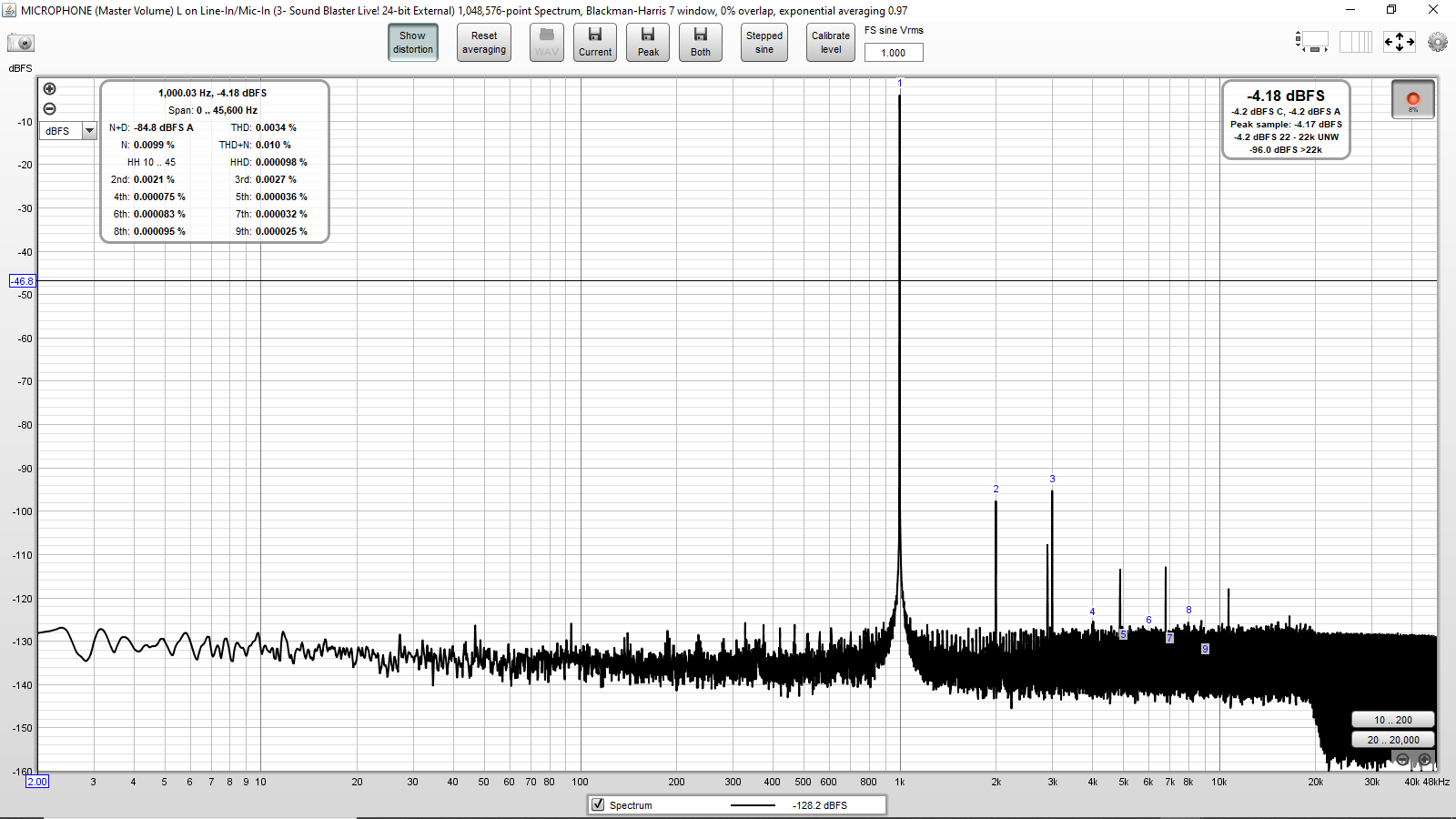

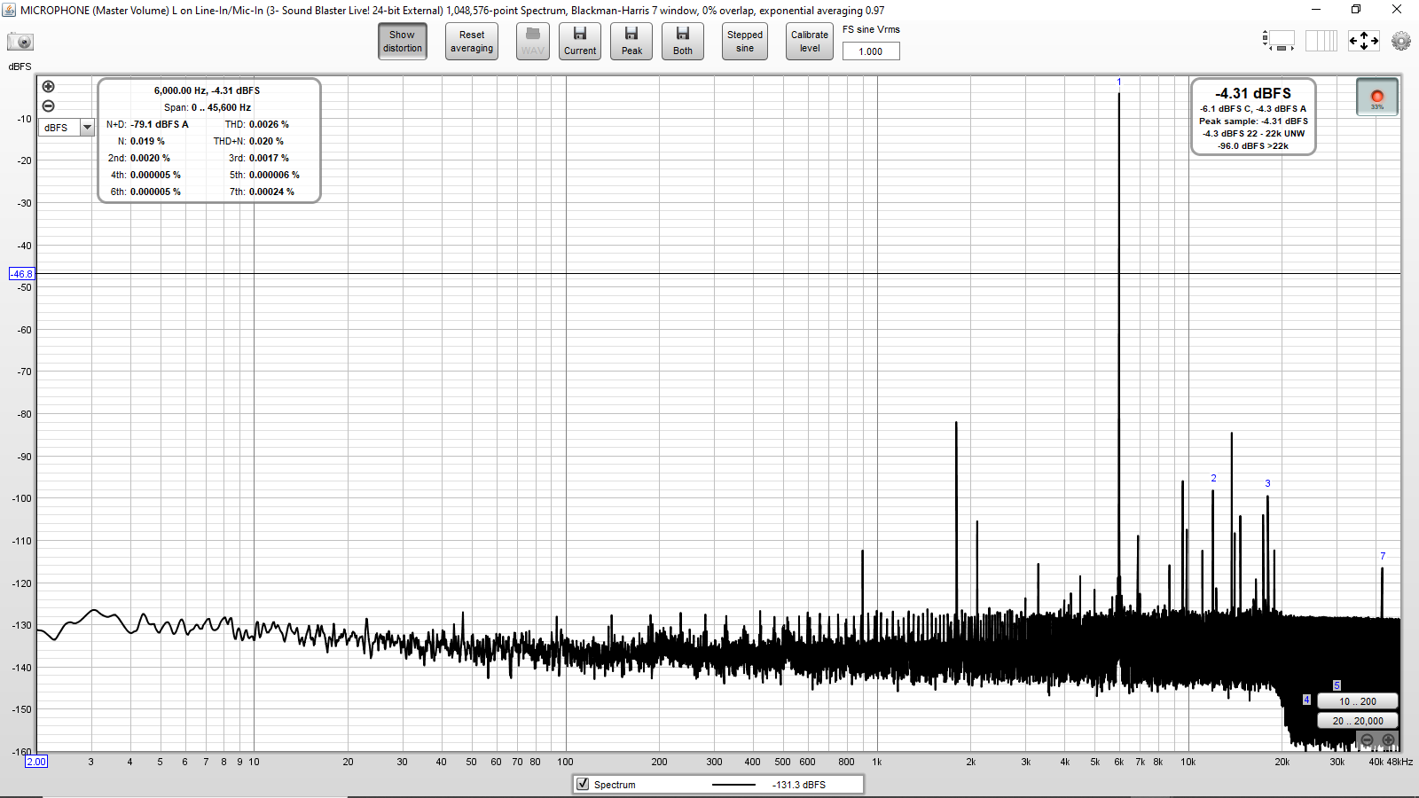

In the below measurements the Sine waves are at (in order): 1kHz, 2kHz, 4kHz, 6kHz and 8kHz.
1kHz, 2kHz, 4kHz are not too bad, especially consider we are at -9 dBFS (to avoid overloading my ADC).
But at 6kHz and 8kHz the results suddenly and greatly degrade.
Any ideas?

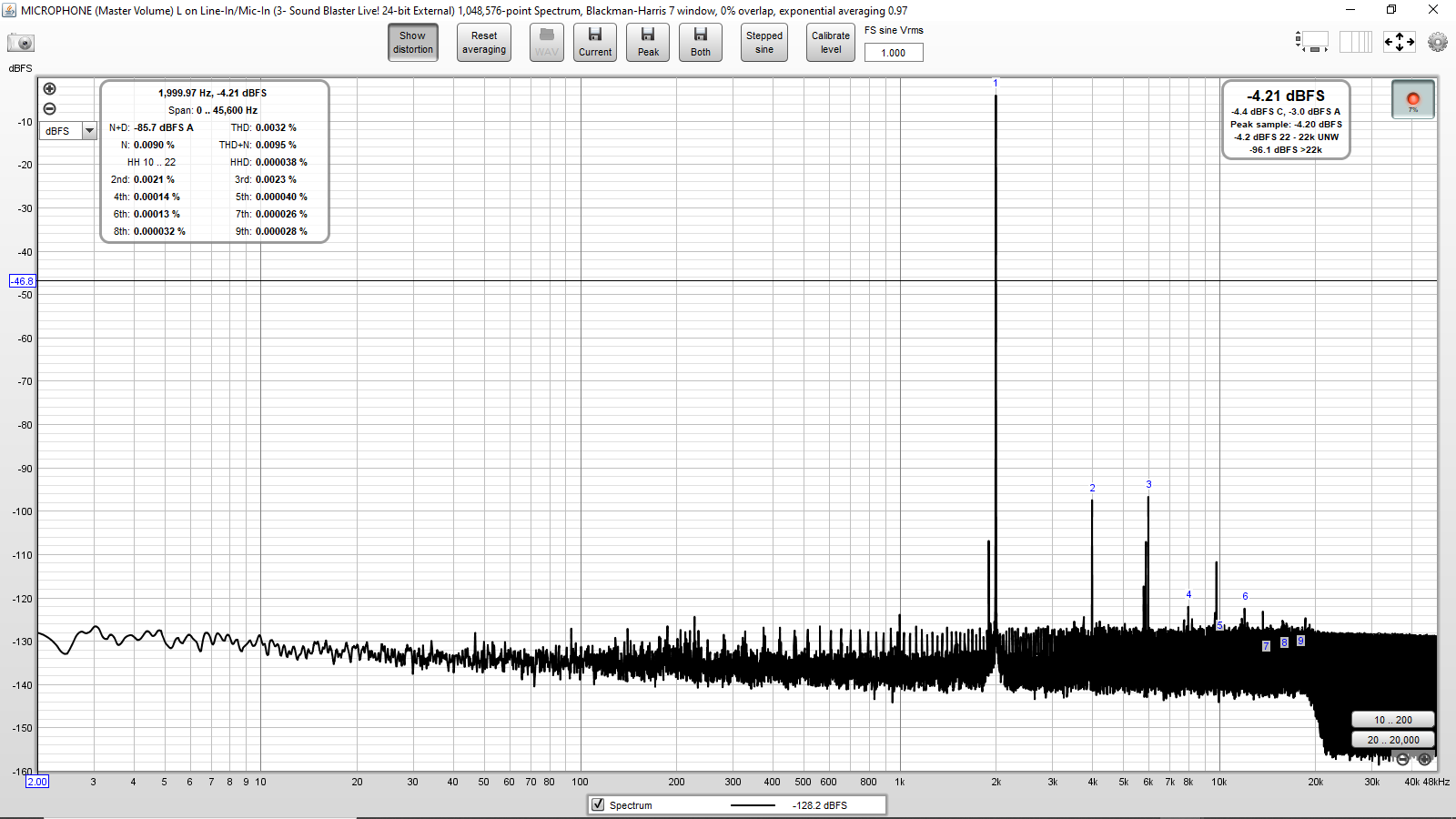

The measurement setup does not show any similar problems with the LJM CS4398 or the AK4396:
Measurements of LJM CS4398 USB DAC With NJM4580D
Measurements of AK4396 DAC with REW
So I don't think it is a measurement issue.

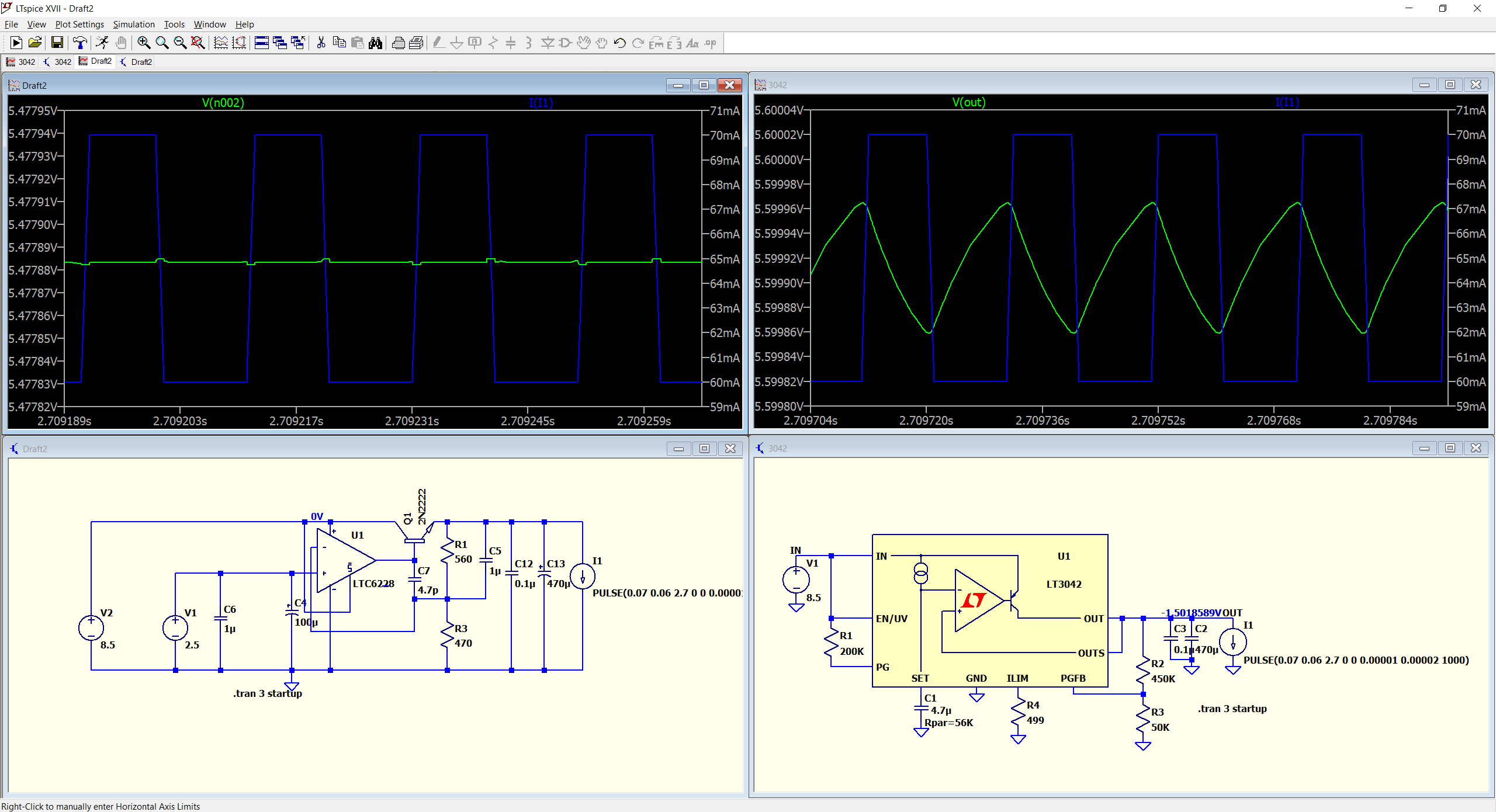

this has been discussed, simulated and measured. here I attach a sim by Pavel Pogodin, posted on another forum for 50kHz/10mA load). I am not claiming that this is a final truth and now everyone should do like this, but practical results are clearly in favour of discrete regs for audio as well.
The LT3042 is not in the best configuration, using a bypassed SET resistor only, as shown, but keep the PGFB disabled provides the best performance. Also, for an apple to apple simulation/measurement comparison, the LT3042 ILIM current limiting resistor should be set to zero (no current limiting). And the "discrete" schematic uses as a reference an ideal 2.5V voltage source (decoupling it is useless, BTW, it has a zero impedance at all frequencies anyway) which is, ahem, a rather gross approximation.

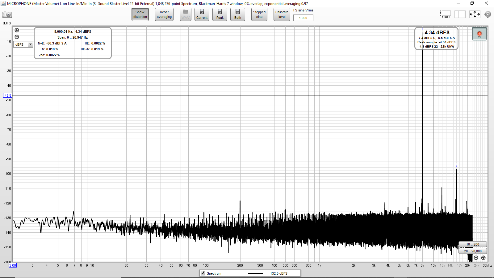

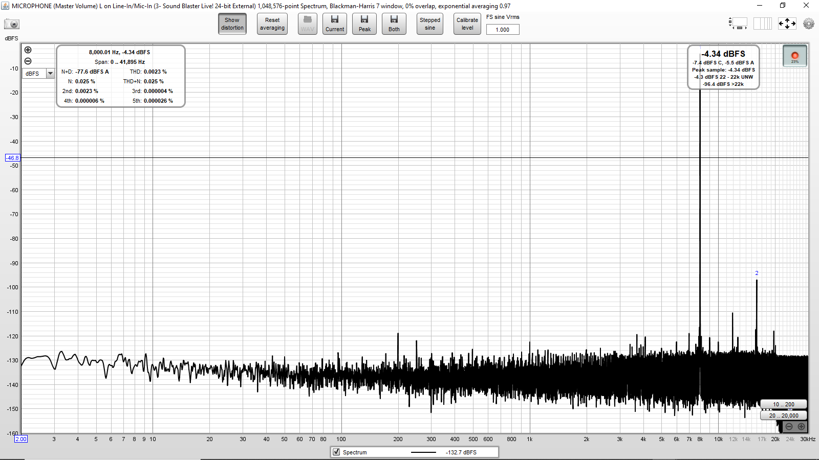

Take a look at these measurements (all 8kHz sine being generated by the ES9038Q2M & REW software) using the coaxial input. I think we have found the first major/gross problem.
The first is a sample rate of 44.1kHz from the computer/SB0490.
The second is a sample rate of 48kHz from the computer/SB0490.
The third is a sample rate of 88.2kHz from the computer/SB0490.
The fourth is a sample rate of 96kHz from the computer/SB0490.
So the first/most major problem seems to have nothing to do with the analog side/supplies/output section. Instead it appears to be on the digital side related to sample rate. We can turn it on and off by picking the sample rate.
Any suggestions/ideas? I have not seen this before. Has anyone else seen something like this with the coax input?
Right, LT3042 is a very good reg, and no doubts the discussed board would benefit from it at some extent. But that is not the point. Virtually all commercial DACs are designed departing from “indispensable and sufficient “ to have a market share and make a profit. In contrast here in DIY world we can afford go beyond this and construct the things that not qualify above but please us. And share views and feelings. Of course some common sense should be still with us 😀
Have you tried running loopback on your soundcard at that frequency and sample rates?
