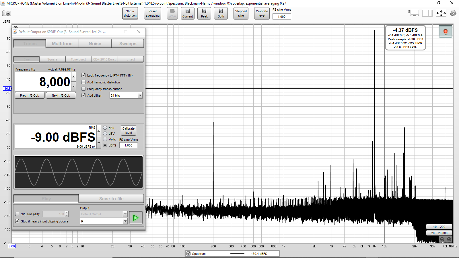

Does anyone have distortion measurements on their ES9038Q2M (the recommended board in this thread) that they can please post?
I would like to know if my board is defective or whether other samples of this board really start out with such high distortion.

Thank you for the old measurements.
They don't look like my spectrum with the huge 200Hz & 15.6kHz spikes/spurs. No sign of that mess in your spectrum.
So I wonder if I have a defective board or ES9038Q2M chip?
