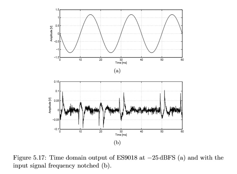

Might be worth mentioning that in addition to the FFT measurement-based hump removal info at ASR, there is a time domain measurement technique that was shared by Scott Wurcer (see attachment below).

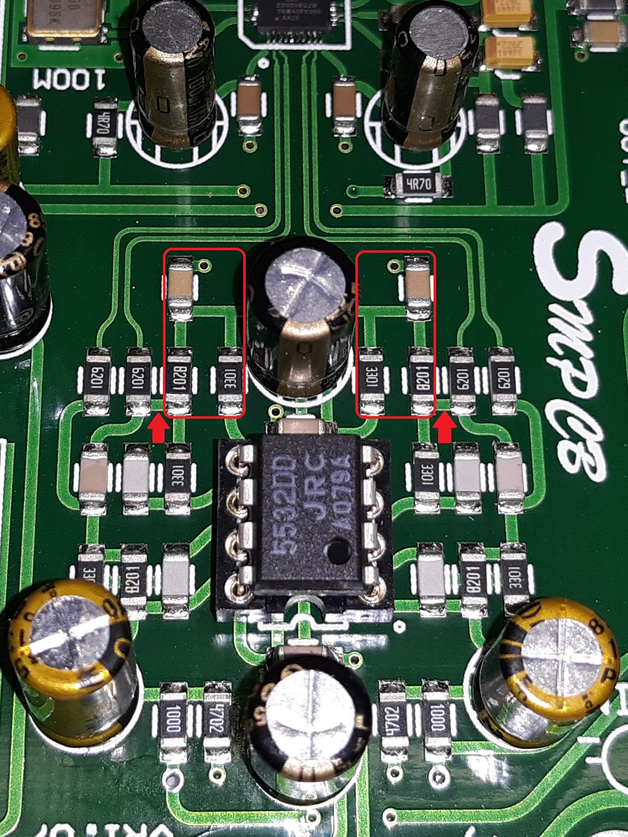

Is it correct that the output section that is supplied on the recommended ES9038Q2M board has a supply derived offset that is added to one of the two outputs from the ES9038Q2M? Perhaps Vcc/2?
What is the purpose of this? Is this to aid (enable) single supply operation (along with jumper J6)? (And along with the two output blocking capacitors?)
See the attached highlighting in the enclosed picture.
Since I am not using a single supply can I remove this "feature" and the added supply noise by lifting the 8.2k resistors? [Edit: This is likely the wrong way.] The color of the ceramic dielectric of the bypass capacitors connected to those 3.3k and 8.2k resistors is obviously not NP0 or C0G. (And must be relatively small values.)
Or is that the wrong way to remove this feature? Does anyone have a schematic of the supplied output section? I guess I should start sketching it out. Perhaps I need to remove the 3.3k resistors and connect the other side of the 8.2k to ground? (As opposed to the supply derived offset voltage?)

AVCC/2 is the reference voltage for the I/V noninverting opamp inputs (AVCC_L for the left channel, similar for the right channel). That's because AVCC is used to supply power to the internal dac output array resistors. Their average output voltage (if measured in voltage mode operation) is equal to AVCC/2.
It is possible to use some voltage other than AVCC/2, such as to change I/V opamp output offset voltage (e.g. set it to zero volts of offset), but that makes the current in the dac output resistor array current flow asymmetrically, say, for example, with respect to the positive and negative peaks of a sine wave. Better option is probably to remove the DC offset by some other means, such as in the differential summing stage.
Yes, that makes sense.

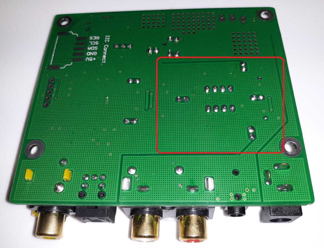

But the problem is on the supplied board I don't see a direct connection in the output section to AVCC. I have looked at the front and the back of the board and as far as I know this is a two layer board. See attached picture. No jumpers on the back from the output section to AVCC.
Instead I see the 3.3k resistors in the output section connecting to the Vcc and the ceramic bypass capacitors.
Does that mean offset from AVCC is being cancelled with a different offset derived from a different supply (+15V)? (Derived from a different supply, 3.3k Ohm resistors and small ceramic bypasses.)
Cancelling an offset from one noisy supply with a different offset generated from a different noisy supply??? What am I missing?

Yes, thank you. I understand that (post 3003) and I do plan to look into implementing the improvements. (However in a slower/more orderly fashion later on.)
But I would still like to understand what the purpose is of those 3.3k resistors and ceramic capacitors around the Pin 4/5 end of the op amp on the stock board.
Because I wonder what consequences that has to the performance of connecting those to the relatively noisy 15V supply and then the outputs of the DAC/inputs of the output stage/op amp. The only time I have seen something like that before is with single supply op amp circuits.

The dac board has a solder jumper to run it from a single, say, +15v power supply. IIRC the jumper grounds the -15v rail. In that case, the noninverting input of the opamps has to be lifted above ground. It gets set to Vcc/2 IIRC. The ceramic caps are to keep the ground intact for AC purposes. If you follow the traces around its possible to sketch out the circuit. That said, one of the traces runs under the opamp socket and under one of the big filter caps, again IIRC. An ohm-meter may be helpful to trace that one.

Great, thank you. That is what I was trying to get at/propose/verify with post #6564.
I am going to remove that so that both the DAC and DACB connections/components to the inverting and non-inverting inputs of the op-amps both use the real ground as the reference as opposed to one (such as DACRB for example) using ground (one side of one of the 3.3k resistors) and the other (such as DACR for example) using this Vcc/2 resistor divider virtual ground.
I don't know how much of a concern it is but with different references and one being derived from the +15V supply (which supplies the 7805 and AMS1117-3.3 and everything on the board) I suspect this puts noise on the DACR side (and DACL side) that is not present on the "B" sides and thus will not cancel. (And right at one of the inputs of the op-amp.) The concern is that noise will degrade the ES9038Q2M performance significantly from the datasheet specs.
Of course multiple clean regulators and a better output section will be better still, in the future.
In reality it actually does not produce Vcc/2. At least on my boards I probed and read about 0.32V with well trimmed +/-15V and an LM4562.

Vcc/2 only happens when the solder jumper is used for single supply operation. Again IIRC, there is a voltage divider that sets the DC reference voltage at half way between the + and the - opamp rails. That should approximately be ground if using +-15v supplies. When the - rail is grounded for single supply operation, then the voltage divider still works the same way but one end is at ground instead of at -15v. I would agree that grounding the reference node would be better if continuing to use the voltage mode output stage. Otherwise, if using the recommended output stage then all that stuff can be removed from the board, it isn't needed.

Yes, that matches what I concluded from the board. The divider consists of two 3.3k Ohm resistors and three ceramic capacitors. (The two 3.3k Ohm resistors next to the -15V bypass capacitor for the op-amp.) However when I probe I read about 0.3V (no jumper) and well trimmed +/-15V supplies.
I guess that it is 0.3V due to current through the 8.2k Ohm resistors that connect to the 6.2k Ohm resistors which then connect to DACR and DACL.
That does not occur on the other side (DACRB & DACLB) because the connections are to the real ground, not the resistor divider virtual ground.
