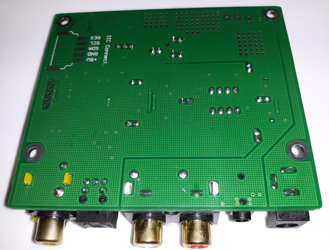

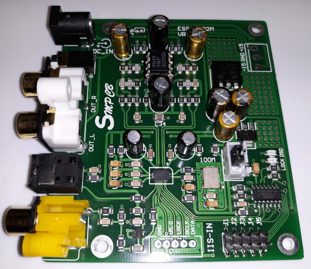

So my ES9038Q2M board has arrived. (Pictures attached.) Physically it looks pretty nice but so far I am not happy with the sound of it.
After three days of listening I am a bit shocked at what I would call a fatiguing, harsh or piercing high end. I guess others might use the word "bright" but I think it is more than that. This is in comparison to my AK4396 with all other components the same in the test setup.
For now I am just using a coaxial input (same as with the AK4396) that comes from an ES6629 Vibratto-II DVD Processor inside a Philips DVD player. (Basic, but seems to work well with the AK4396 board.)
I was not expecting it to start out with this sort of sound based upon what I have heard about the ES9038Q2M. But perhaps this is a lesson for me in terms of implementation. I am using the same LM4562 in both.
My first guess (from reading this thread for a month or so) is that it is power supply implementation related. I don't see radical differences between the output sections of the two boards and I am using the same LM4562 chip in both. Since my CS4398 board has six regulators and the AK4396 has six regulators I guess I can not be shocked when this board has only two. Especially given what I have read about the AVCC having zero PSRR and it is the same cheap AMS1117-3.3 that is shared for 8(?) supply pins on the board.
I was hoping to make modifications slowly because I don't like massacred boards. But this isn't very listenable out of the box. Perhaps I try 2200uF 16V low ESR on the AVCC (solder to the 100uF 16V ELNA RA3 pins under the board) as a first quick adjustment to make it more listenable? Or use some of the 560uF or 1000uF OS-CON that I have?

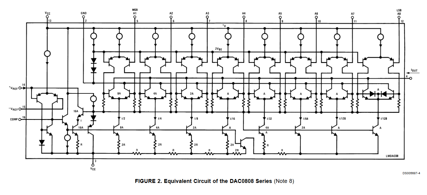

It is not inventing anything. Zero PSRR for DAC Vref goes back many many years. Go look at the schematic for the ancient DAC0808. It is simple and easy to understand. Everything on pin 14 & 15 (+Vref & -Vref) will get to the output. It is how it works.
