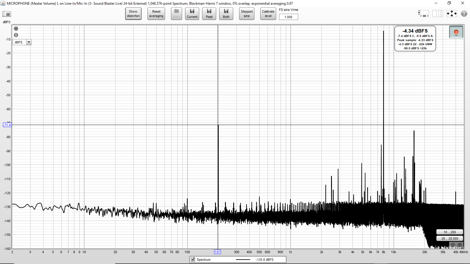

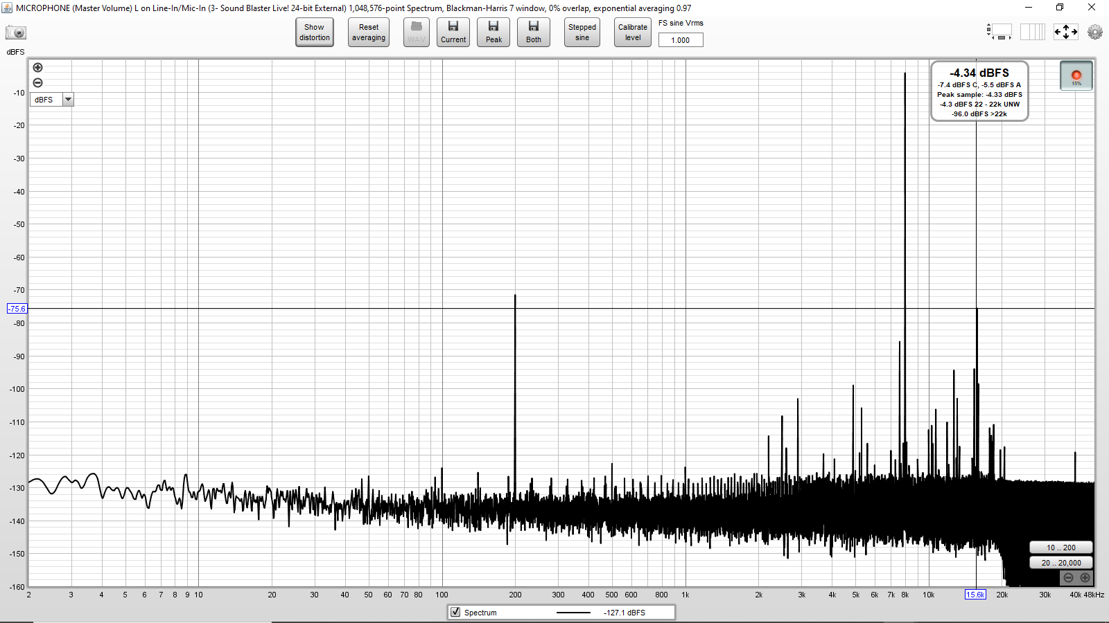

What in the world is all this junk coming out of this ES9038Q2M board at 200Hz and 15.6kHz and in general 2kHz to 20kHz? Only 67 dB and 71 dB below???
No wonder this sounds so terrible :eek:

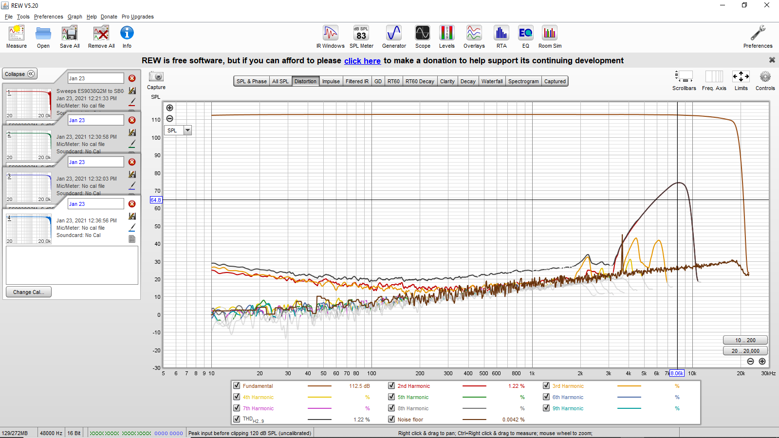

Exactly. Voltage mode output stage is bad. Failure to properly filter RF noise is bad. Digital power supply noise on AVCC is bad. In stock form this thing is about as bad as it could be.
I did not remotely realize how terrible this board was before I bought it. My impression was that it was a good "recommended" board that could be made great. Instead it appears to start out as pure junk.
Hopefully my measurements will serve as a warning to others so that they know what they are getting into.
This board makes my AK4396 (half the price) and LJM CS4398 look like super stars.
