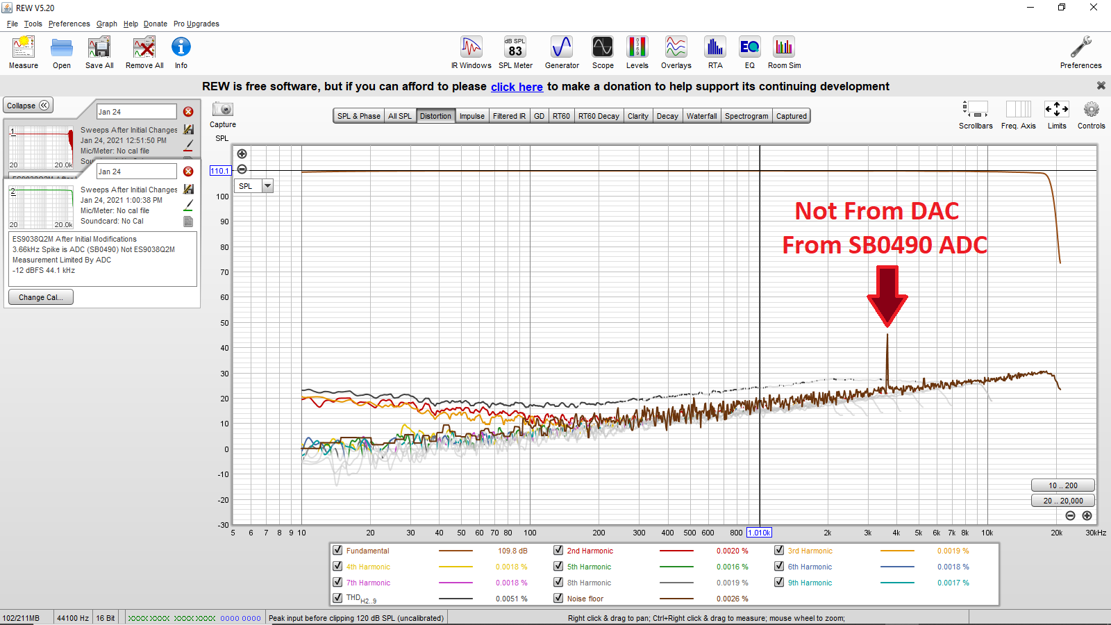

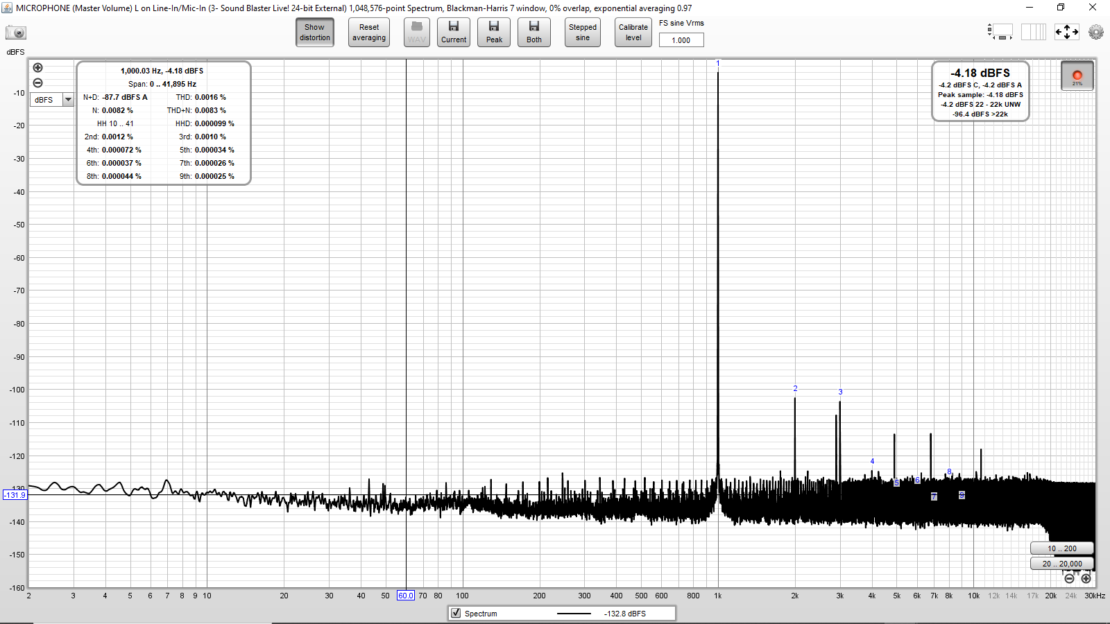

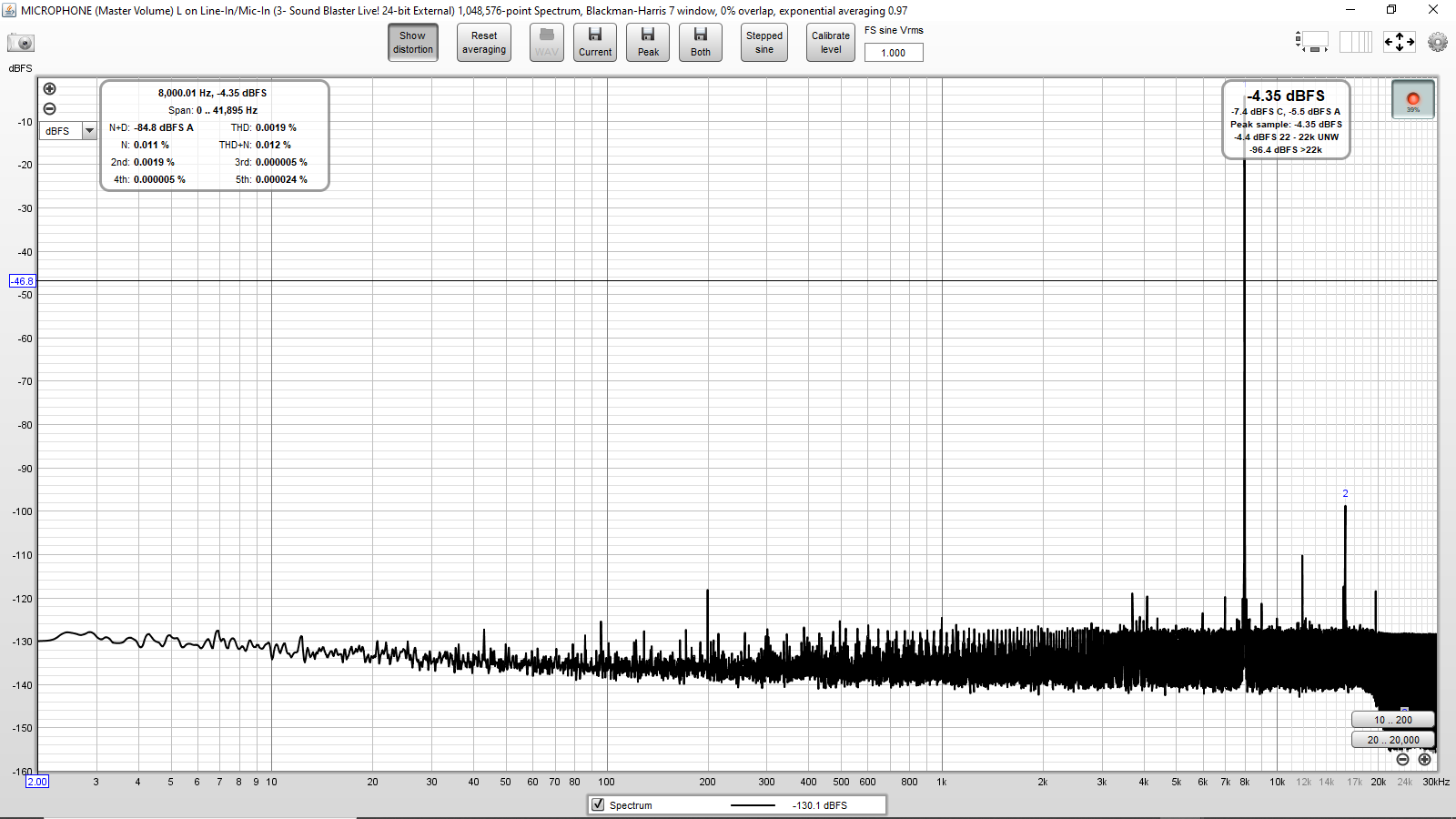

After my initial “quick” changes I have enclosed a sweep along with 1kHz and 8kHz spectrums.
  • 1kHz spectrum reads about 0.0012% for 2nd and 0.0010% for 3rd.
  • The quick single sweep reads about 0.0020% for 2nd and 0.0019% for 3rd.
This appears to be at the levels which signify the limits of my SB0490. About 100 dB down at 1kHz. I am sticking with 44.1kHz until I understand what is going on with 48kHz and 96kHz.
To measure lower distortion I will need to get a better audio interface/ADC working for measurement. Perhaps the Creative Professional/E-MU 1820 will allow me to do that later.
Note that the 3.66kHz spike is from the SB0490 and not the ES9038Q2M.

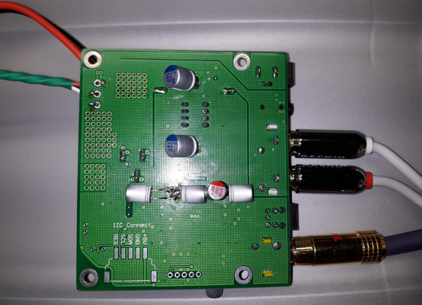

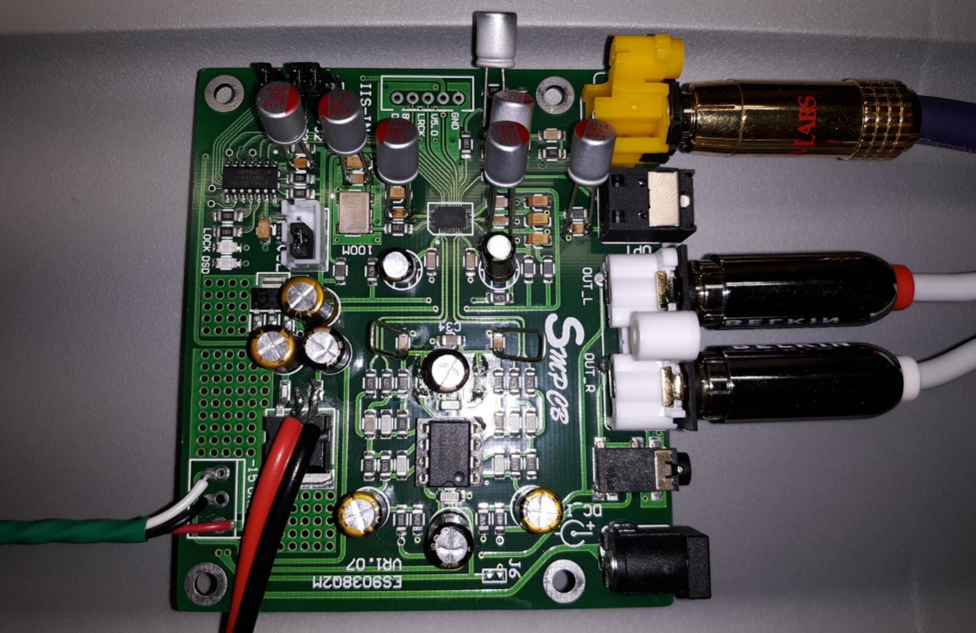

The initial “quick” changes are as follows:
  1. Supply ONLY the output/op-amp with a discrete current source and shunt regulator (+/- 15V).

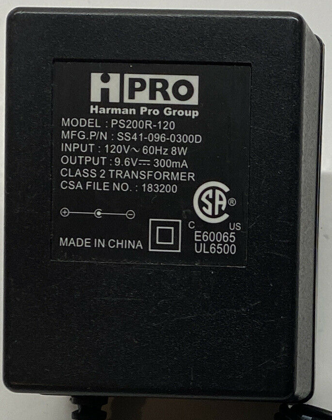

  2. Supply the LM7805 with a separate regulated 9.6V supply (from Digitech/Harman International for musical instrument signal processing equipment).
  3. Add one Panasonic 6SEPC560MW OS-CON 560uF 6.3V across all the stock 1206 ceramic bypass capacitors. Leaving the stock ceramic and tantalum on each pin.
  4. Add two Panasonic 6SEPC560MW OS-CON 560uF 6.3V for each AVCC pin leaving the stock 1206 ceramic bypass capacitors, stock 4.7 Ohm 1206 resistor and stock 100uF 16V ELNA RA3 in place.
  5. Add one 270uF 16V solid polymer capacitor (unknown brand, measured 4mOhm) to each op-amp supply pin. Leaving the stock bypasses in place.
  6. “Remove” the Vcc/2 “offset generator” from the output section (used for single supply operation) by placing copper wire shunts over the bypass capacitors. I want both sides of the output section connecting to the same ground specifically the ground plane on the board. I don’t want one side of each ES9038Q2M output pair connecting to a noisy virtual ground generated from the power supplies.
  7. “Remove” (short) the output capacitors using copper wire shunts. I have film capacitors in all of my amplifiers.
  8. Using LM4562 for output. That is presently my best dual op-amp.
The logic/objective of the Panasonic OS-CON ultra-low ESR capacitor usage is as follows: Attempt to prevent noise from noisy sources (such as 3.3V digital supply pins) from transferring over to sensitive analog pins. Since there are ferrite beads all over the board I thought I would try to use them to help prevent noise from the noisy sources from getting to the sensitive clock and analog pins. It is a little bit like two CLC filters between each noisy source and each sensitive supply pin on the board.
Considering the supply caps already on the power buss and the added OS-CON capacitors on the 3.3V supply buss it is a little bit like:
Noise Source > Low ESR OS-CON > Ferrite Bead > Power Buss & Existing Supply Capacitors > Ferrite Bead > Low ESR OS-CON > Analog Pins
Or a little bit like: Noise Sources > Shunt C > Series L > Shunt C > Series L > Shunt C > Sensitive Pins
At each sensitive analog pin there is now the stock ceramic decoupling/bypass capacitor, stock tantalum and now an added OS-CON 560uF 6.3V. That should provide a pretty decent upgrade over stock in terms of offering a solid low impedance across a respectable bandwidth. The combined three types of bypasses should result in a solid and respectably wide band low impedance now.
The Panasonic 6SEPC560MW OS-CON is rated 7mOhm in the datasheet. I freshly calibrated my meter to the socket interface using copper wire and when I measured this bag of 6SEPC560MW I read 3mOhm. On the AVCC pins I used two in addition to the stock 100uF 16V ELNA RA3 and stock (unknown) 1206 ceramic bypass. So perhaps around 1.5mOhm after the stock 4.7 Ohm 1206 resistor that is on the board between the 3.3V buss and each AVCC pins.
I am hoping that this is now a reasonably listenable initial configuration allowing me to work more leisurely on more substantial upgrades such as:

  3. I already had the Digitech/Harman International supply but I think it cost $15 or something like that.
