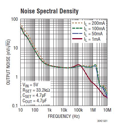

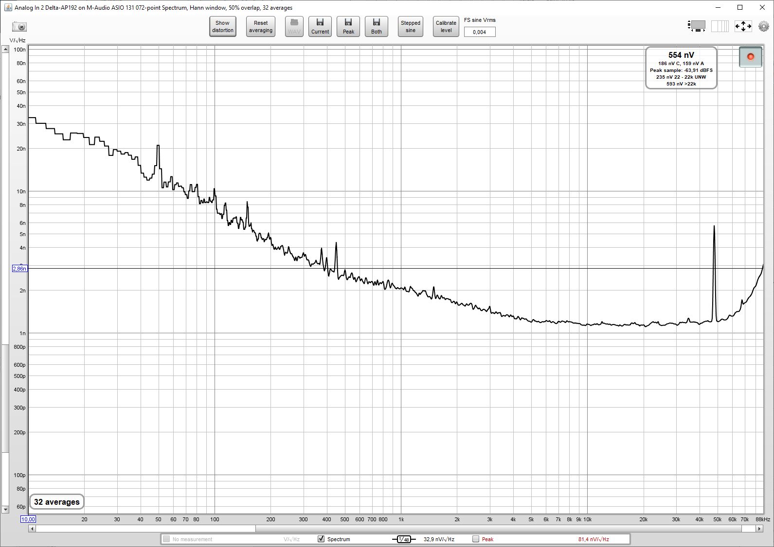

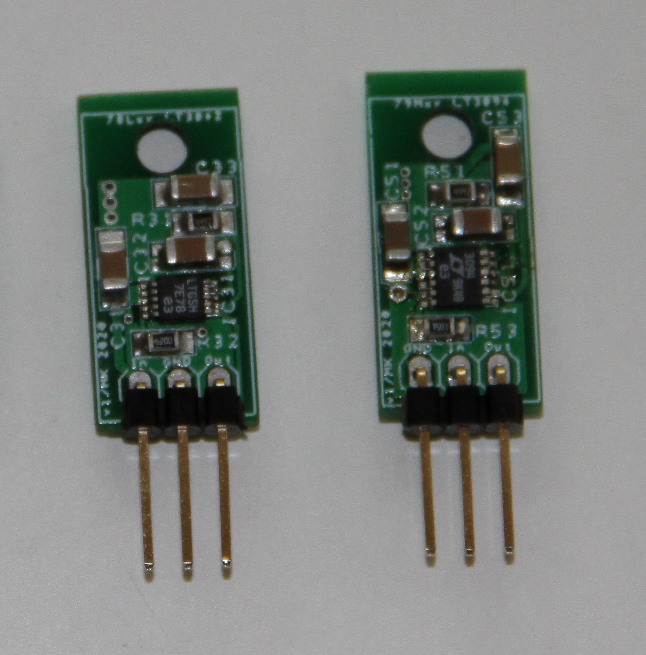

Here is the noise measurement from a 78xx-type LT3042 5V regulator I made just for fun some time ago. It probably uses the same shitty components I listed above. The rising noise above 20kHz is unfortunately due to the soundcard. Anyhow this is definately not the way I would use LT3042. I also included the noise measurement from the datasheet for comparison.

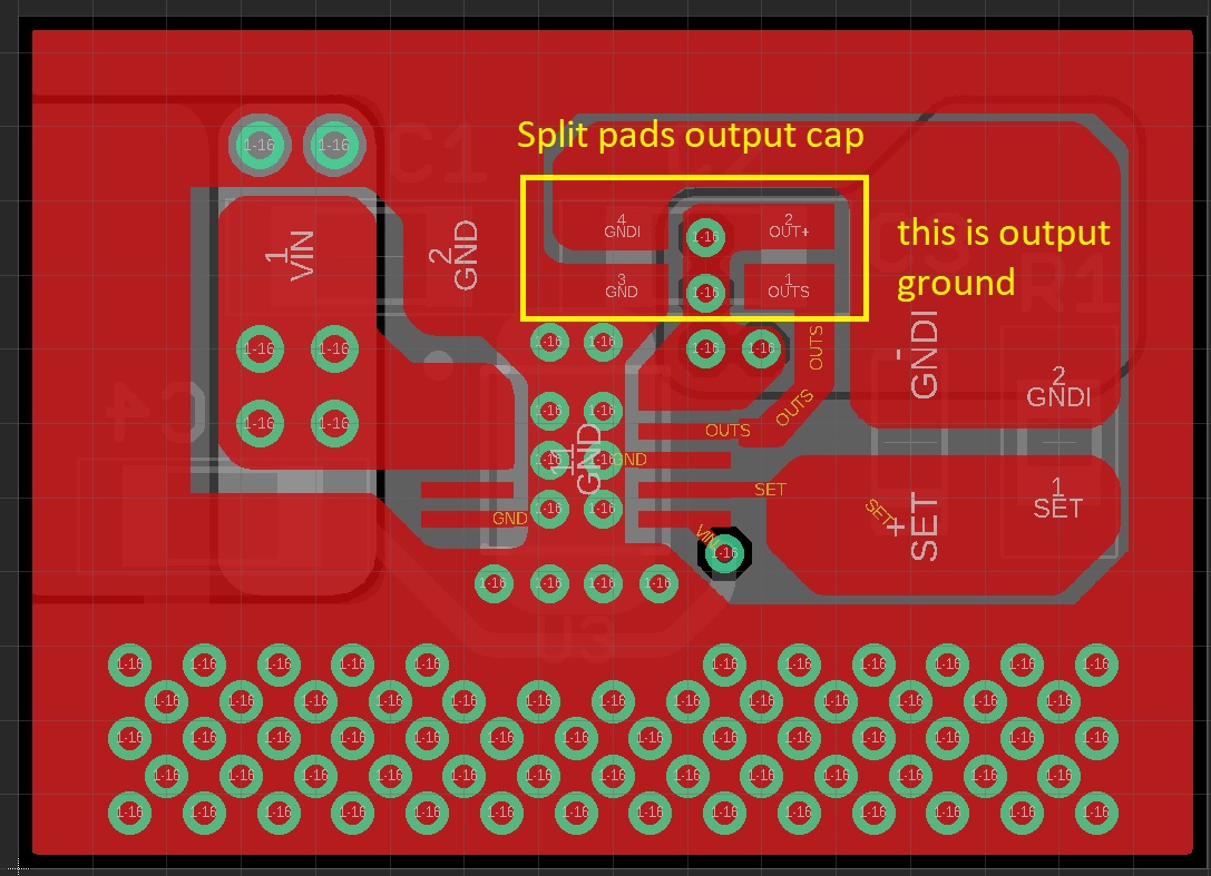

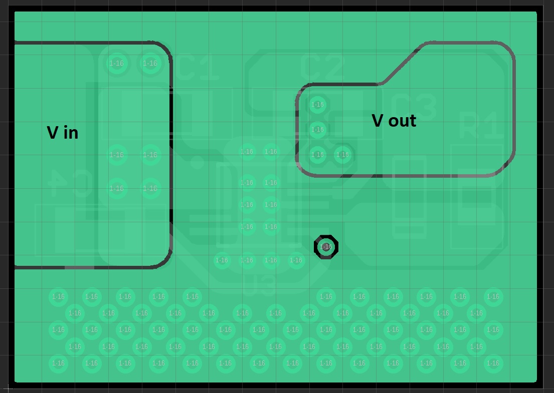

Circuit layout also has a big impact to result, not only the components quality.
The best circuit a have found so far, you can see it in attached pictures. It is inspired from LT3042 refference design.
Would agree that layout is critical for certain circuitry. When I try to give people advice about dac building often seems the part about layout is ignored. People mostly seem to want a schematic, and maybe discuss/debate opinions on what opamps and caps are best. There is so much more to it in reality.
