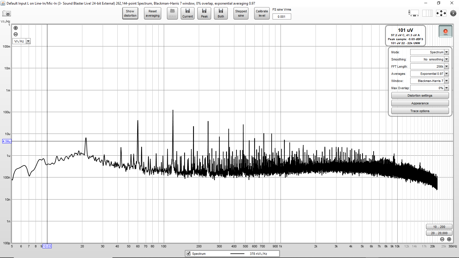

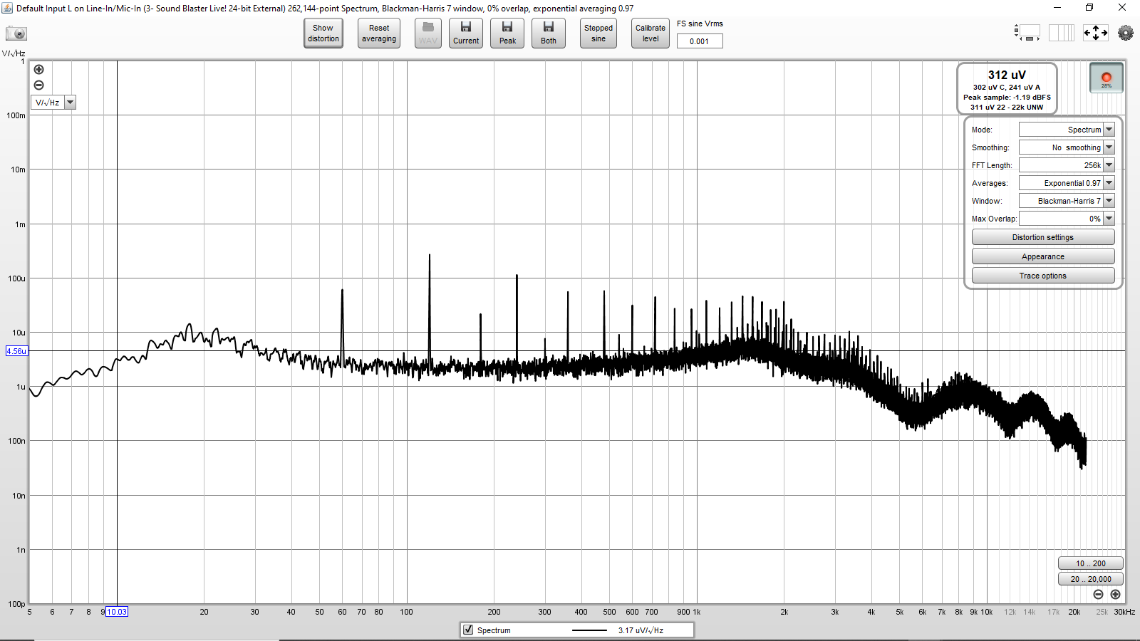

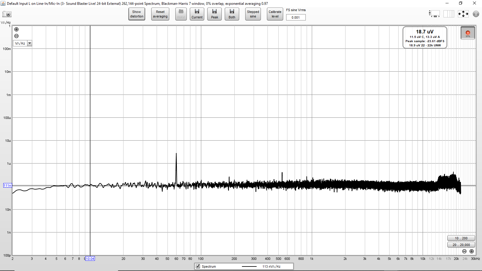

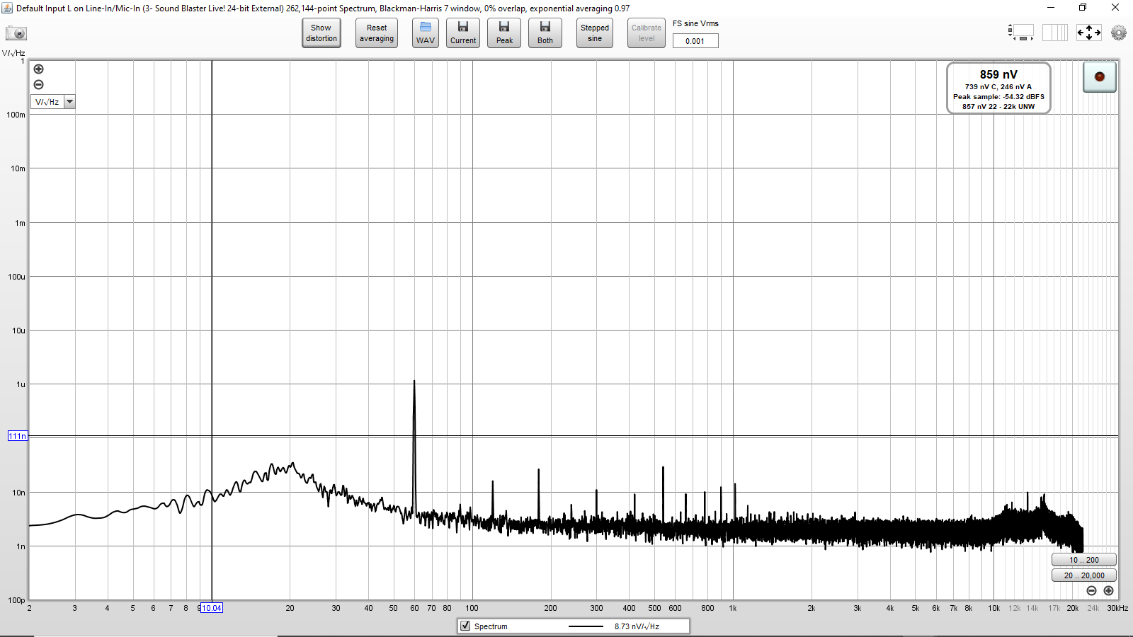

I did some noise measurements on the AVCC-R today.
Attached are:
First: AVCC-R with DAC powered down.
Second: AVCC-R with DAC powered on but idle.
First: AVCC-R with DAC powered on with 1kHz full scale on right channel.
Interestingly I don't really see a 1kHz spur.
Any chance you can repeat such measurements with your recommended AVCC supply? I would like to see measurements of the recommended/more expensive/more involved changes.
I think I can improve my measurements further. The 60 dB LNA is well shielded. But I need to find a larger outer shielding so that the DAC and probe cable can be shielded better.

Not sure how meaningful that is. Maybe more interesting to look at AVCC current, or both voltage and current. Or, maybe try AVCC voltage verses dac board analog output noise.
That said, it all seems a bit academic at this point. We already know the AVCC supply needs some serious work.
That said, it all seems a bit of academic at this point. We already know the AVCC supply needs some serious work.
But the question is what is the noise level with the various proposed changes? Is it better than what I am reading? If so how? Are there less or lower spurs? Or is the baseline noise level lower?
Did anyone measure noise before and after making the proposed changes on the recommended board?

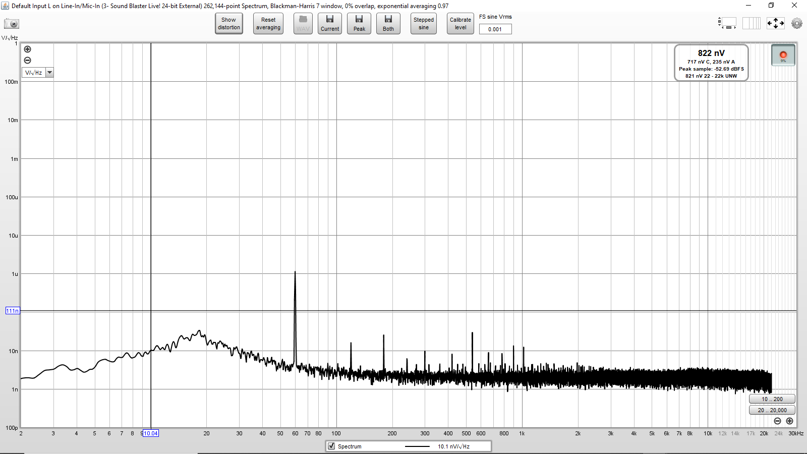

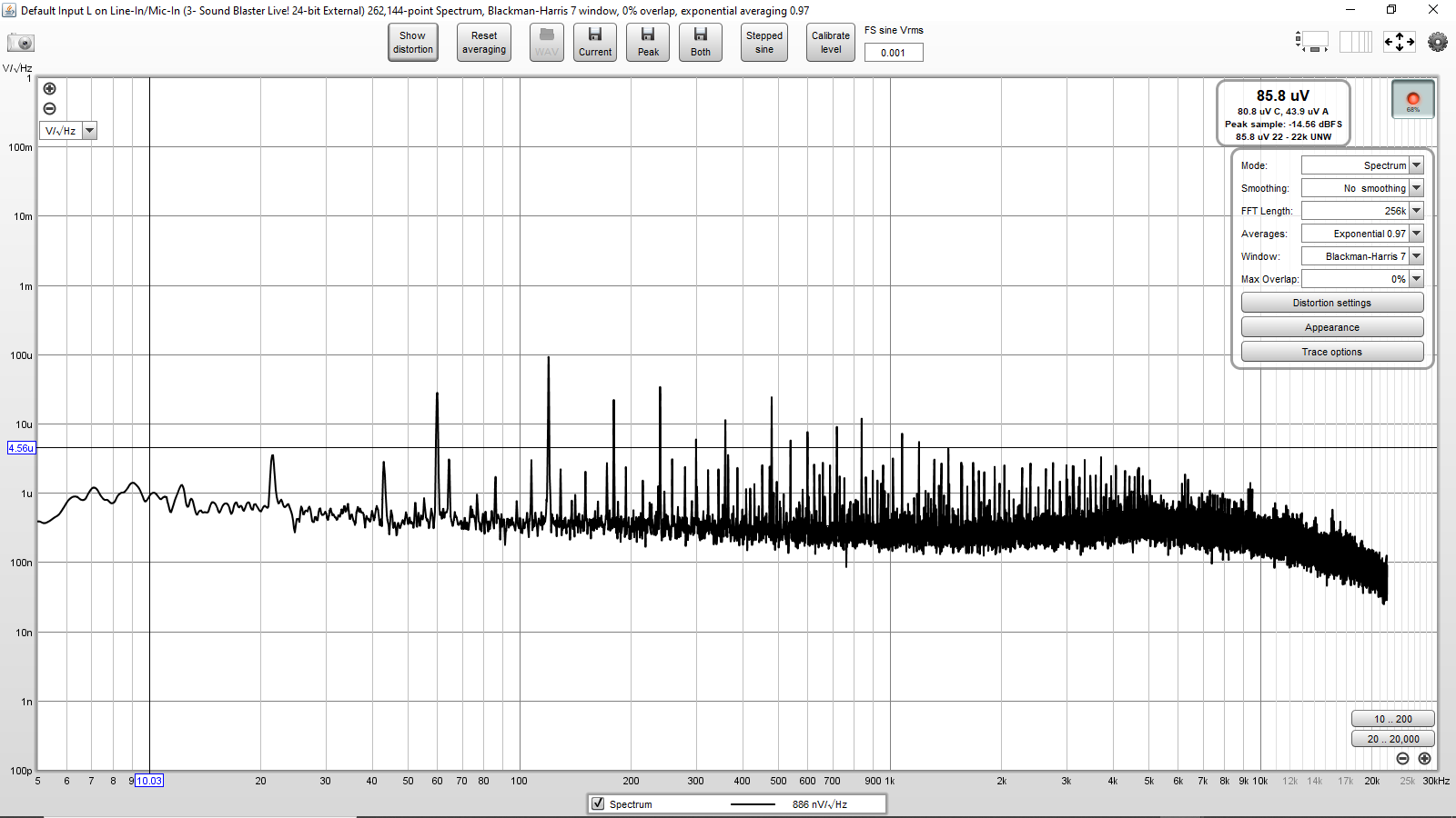

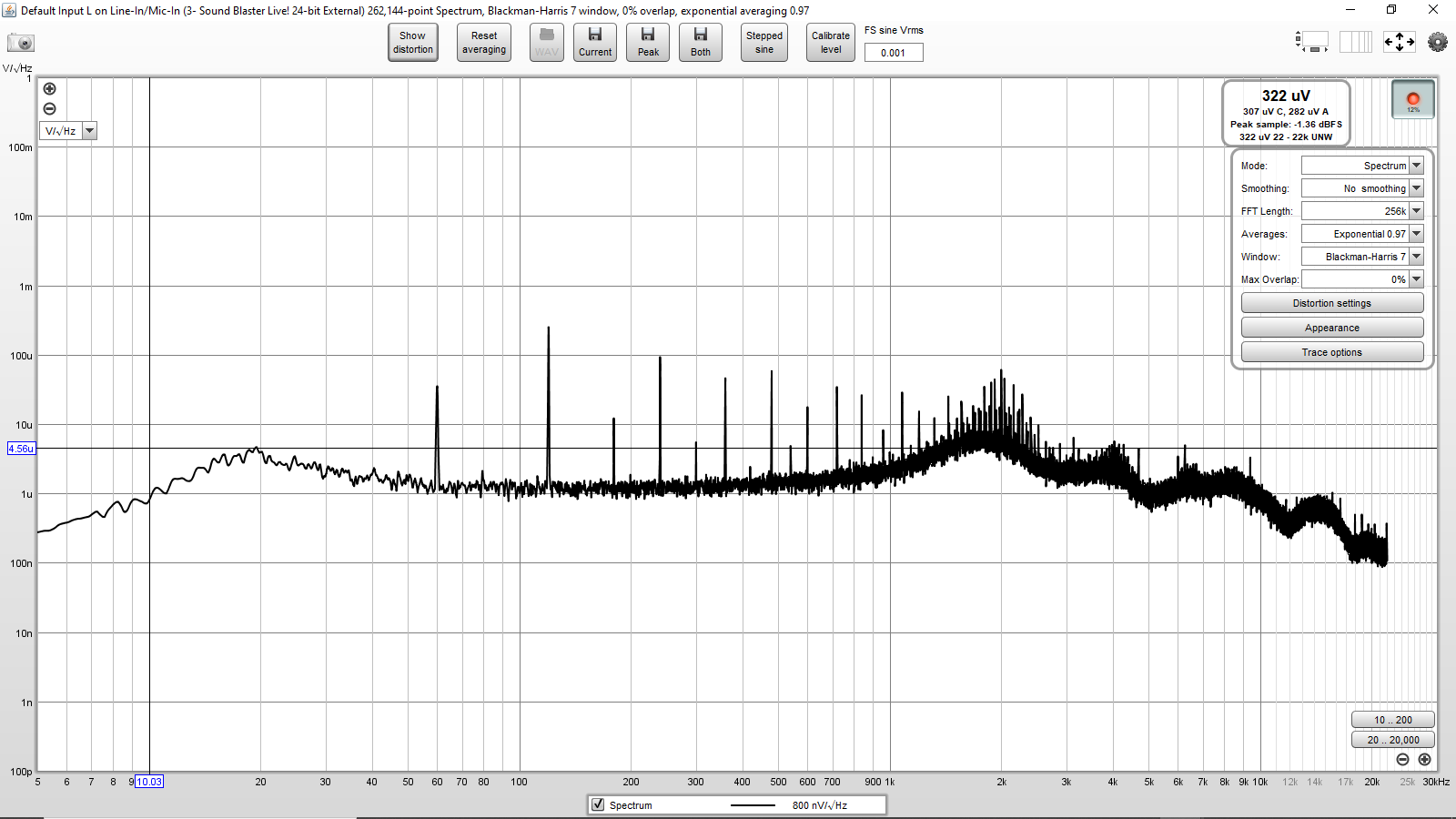

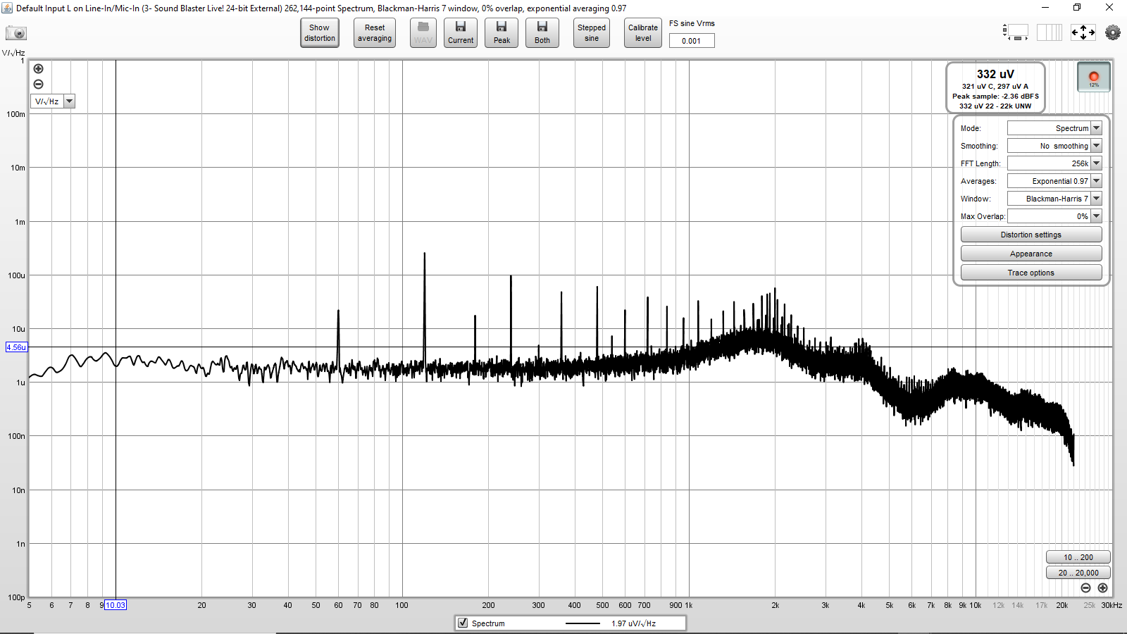

I did some noise measurements on VCCA.
Attached are:
First: With DAC powered down.
Second: With DAC powered on but idle.
First: With DAC powered on with 1kHz full scale on right channel.
I would like to compare these with any measure done before and after the proposed changes on the recommended board. If anyone has that data please post it.

Why are you measuring VCCA? You want to check the RF analog rail too?
Why don't you just measure the shared 3.3v rail that everything uses? Might give you an idea of where a number of problems arise.
Regarding you questions re measurements, I don't think anybody measured them. First of all, it would probably be wise to measure various rails with a wide bandwidth scope first using an active differential probe. Then you get good view of the big picture.
Then to work back in the other direction, measure an FFT at the audio output of the dac board. Introduce a signal, say, at AVCC using a signal generator, maybe cap coupled and through a current limiting resistor. See if you can figure out how much test signal can be tolerated at AVCC without affecting the dac board output. Isn't that what you really need to know? You could do it with or without the caps. With some more thought and depending on the test signal source there is probably some way to get a good handle on injected signal level at AVCC without having to look at all that other noise garbage maybe coming in from the shared 3.3v rail and or from stray coupling.
kozard,
One reason is that I want to see where certain noise and spurs originate. Thus I am looking at each pin and then the supply buss, as well as the input to the regulator. If I can pinpoint and cleanup the largest generators of noise that should help the most sensitive pins. I also I want to see which regulator and bypass scheme results in the least noise at the sensitive pins.
What are you referring to as the RF analog rail?
I am. I just measured the input to the 3.3V rail. It takes time to do these measurements. Which points would you measure?
