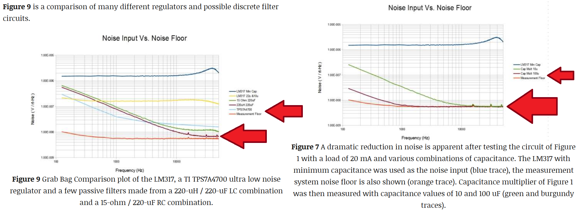

We must be living in parallel universes, I don't see that in fig. 9. What I see is a comparison between:
- A bad LM317 design
- A good LM317 design (bypassed properly)
- A passive RC filter
- A passive LC filter
- The TPS7A4700 noise
- His measurement tool noise floor.
Now, can you read the noise levels on the Y axis in fig.9? I read the TPS7A4700 having 20nV/rtHz @ 10KHz, which is what I would expect. His measurement setup has between 5 and 6nV/rtHz.
Your measurements are showing a noise of 0.5nV/rtHz both for the LNA with shorted input (first plot in #6834) and at the preregulator output (last plot in #6834), so the power supply noise and the LNA noise floor are the same. The only difference is the amount of hash of unknown origin on the preregulator noise plot.
Your results make absolutely no sense, that's what everybody is trying to convey, while you keep ignoring advice and keep truckin'. Good luck.
P.S. If I would be forced to place a bet, I would put my money on the input electrolytic in your LNA having enough leakage (at the pre-regulator output voltage) to saturate the LNA input stage and make its gain virtually zero dB. Hence the illusion your pre-regulator output noise is virtually zero.
I have put the TPS7A4700 graph (in figure 9) next to the LM317 + cap multiplier (in figure 7) together in the attached image to make it more clear. If you read the article and look at the graphs isn't the LM317 + 100u cap multiplier lower noise than TPS7A4700? A lot lower noise? [Hits the noise floor of the measurement?] So if I do that with a shunt regulator that is already much lower noise than the LM317 do we have a chance at even lower noise?
I don't have huge film capacitors but I can try using the biggest crossover film capacitor I have to test out the leakage theory with the LNA. Why would a 50V Nichicon UES series have that much leakage?
Would the cap multiplier reduce the noise at higher frequencies? Would leakage in the cap multiplier capacitor increase noise at lower frequencies? I can try different capacitors types and sizes tomorrow and I can probe with the capacitor multiplier removed and with only films caps in the capacitor multiplier for low leakage.
That's part of the problem. You refer fig.9, then add fig.7 for an unwarranted comparison (what's the point of comparing a cap multiplier noise with a voltage regulator noise?) then you make the unwarranted assumption that if a cap multiplier noise is low, whatever noisy stuff you add in front will not go through, then you make the unwarranted assumption that a regulator + cap multiplier is a better power supply for a DAC (when in fact the output impedance and its frequency dependence will be as poor as it gets), etc...
Slow down and read the article carefully. Right under figure 7 it says (exact quote):
Figure 7 is a comparison of the performance of the capacitance multiplier of Figure 1 and the LM317 used as a noise source. The capacitance multiplier can be seen to work well in reducing the noise from the LM317 regulator rather dramatically.
So yes, it does reduce the LM317 noisy stuff that was put in front of the cap multiplier. So it is a completely warranted comparison. I guess you just don't get it. Reading comprehension.

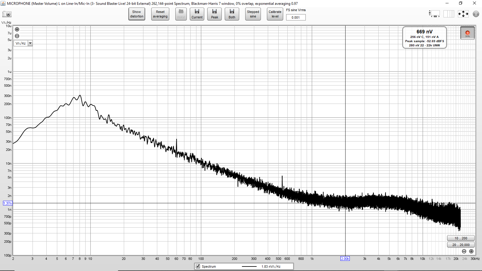

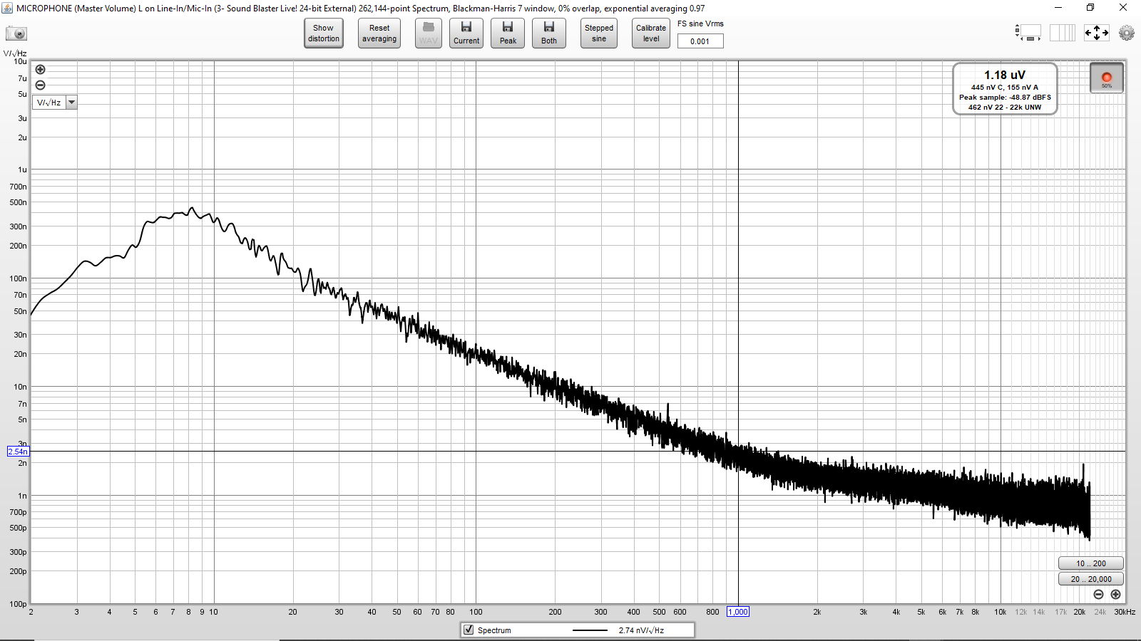

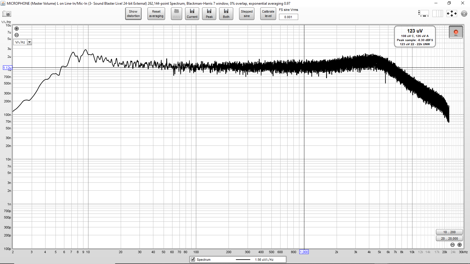

Due to the technically incorrect information being posted yesterday I decided to replicate the published results shown in the EDN article "Simple circuits reduce regulator noise floor".
The link to the article is here: https://www.edn.com/simple-circuits-reduce-regulator-noise-floor/
My results (attached) agree well with the published results. So it is no longer possible (in my opinion) to continue posting technically incorrect information about the noise floor reductions possible with a capacitance multiplier.
First I recreated the LM317 regulator shown in Figure 4 of that link. In Figure 7 of that link the LM317 is used without a bypass on the ADJ terminal deliberately to create a high amount of noise. That is the top (blue) trace in Figure 7 of that link and shows about 1.5uV/√Hz. In my first attachment I measured about 1.1uV/√Hz with my duplicate using the information and schematic in the article. That is pretty reasonable agreement considering I don't know much about his construction methods, equipment, etc.
Next I added the capacitance multiplier of Figure 1 (in the above linked article) after the LM317. That was to recreate the red trace in Figure 7 of that link where the author showed about 6nV/√Hz at 1kHz. In my second attachment I measured about 2.5nV/√Hz (at 1kHz to compare to the linked article) with my duplicate using the information and schematics in the article. I am not sure if the agreement would be better if I knew the manufacturers, part numbers and series for the capacitor he used or the brand of LM317. (Or other details of the construction, etc.) But it is close enough agreement.
Here is a crucial quote (direct quote) from the linked EDN article:
It is also crucial to understand Figures 7 & 9 of the linked article together along with the text of the article. It shows that the noisy LM317 (even without ADJ bypass) and the very simple capacitance multiplier (when used together as in the linked article) has a much lower noise floor than the expensive and specialized TPS7A4700. That is published in the linked EDN article and I just recreated the data.
Next I improved the noise even further using techniques that can be read about in books like The Art of Electronics or Wireless World articles like the Douglas Self MC Preamp (the basis of my LNA).
In attachment 3 I made the capacitance multiplier lower noise by switching from 1000 Ohms to 100 Ohms, from 100uF to 2200uF and by paralleling four 2N4401. (The EDN author used 1000 Ohms, 100uF and one 2N4401 in the capacitance multiplier of Figure 1 in the linked article.)
Next I added the LM317 ADJ terminal bypass capacitor that the EDN author deliberately omitted (to create a high noise output from the LM317.) That is my attachment 4 and shows a dramatic reduction in the noise in agreement with my other work.
So I believe by duplicating the linked published work of another independent author I have thoroughly disproved the technically incorrect information that was posted yesterday. I think it is reasonable to ask people who don't know what they are talking about to please stop posting technically incorrect information and also to please stop disparaging the work of others that they do not understand.
Also please note that the suggestion posted yesterday about input capacitor leakage saturating the LNA input is also wrong. The Nichicon UES capacitor works perfectly well here and does not need to be replaced with a film capacitor.
Next I believe these experiments and measurements (included the linked article) show that the leakage current and associated noise of the electrolytic capacitor in the capacitance multiplier does not appear to be a significant contributor in these circuits.
Also the prior suggestion that discrete circuits and special techniques can not exceed specialized circuits such as TPS7A4700 is also false. There are advantages of a monolithic IC. There are also disadvantages such as small transistors higher base resistance, much smaller capacitors, etc.
Finally the only way I found to reduce the 45 Hz spurs was to add another shielding tin. This time the DUT is in the added shielding tin and the two tins are isolated. (The LNA tin and the DUT tin.) The connection between the two tins is now twisted pair.
