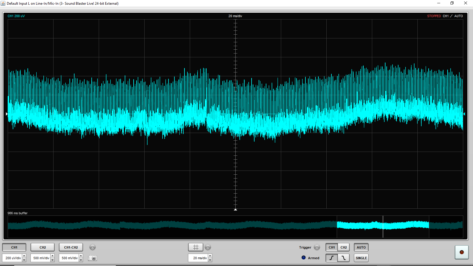

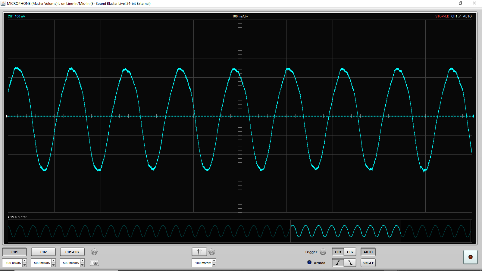

Regarding the registers, one can read and write them with an Arduino or other MCU, although keeping the original dac board MCU makes it a little more complicated. Another option might be to watch as the existing MCU programs the dac. The latter can be largely done for about a $10 investment. One example of a Chinese logic analyzer which is fast enough for I2C, but not I2S: https://www.amazon.com/Comidox-Anal...eywords=logic+analyzer&qid=1612094841&sr=8-17

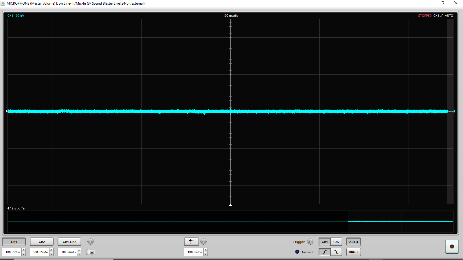

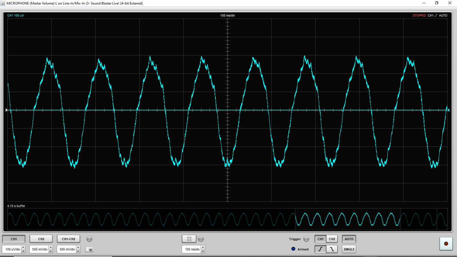

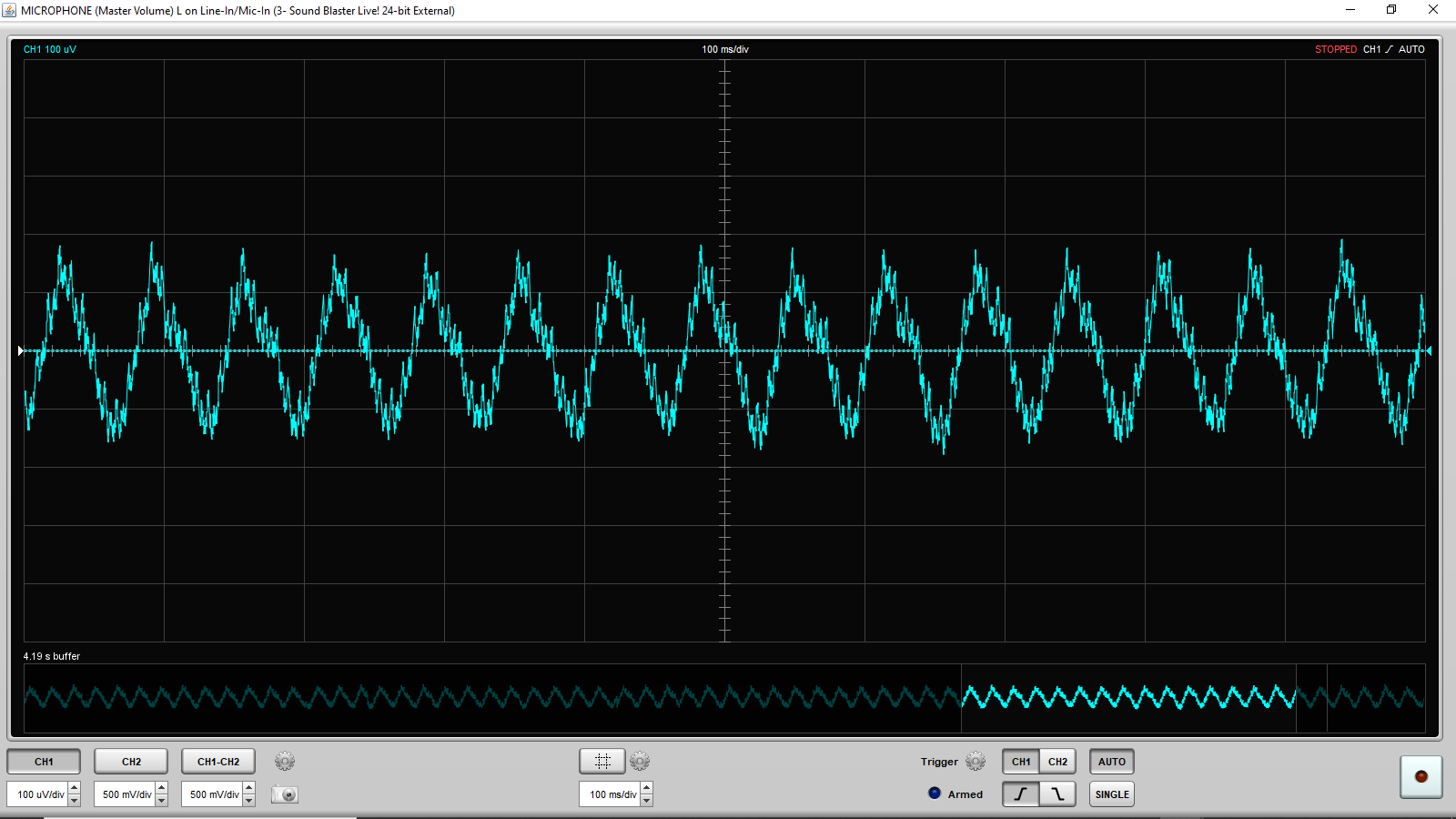

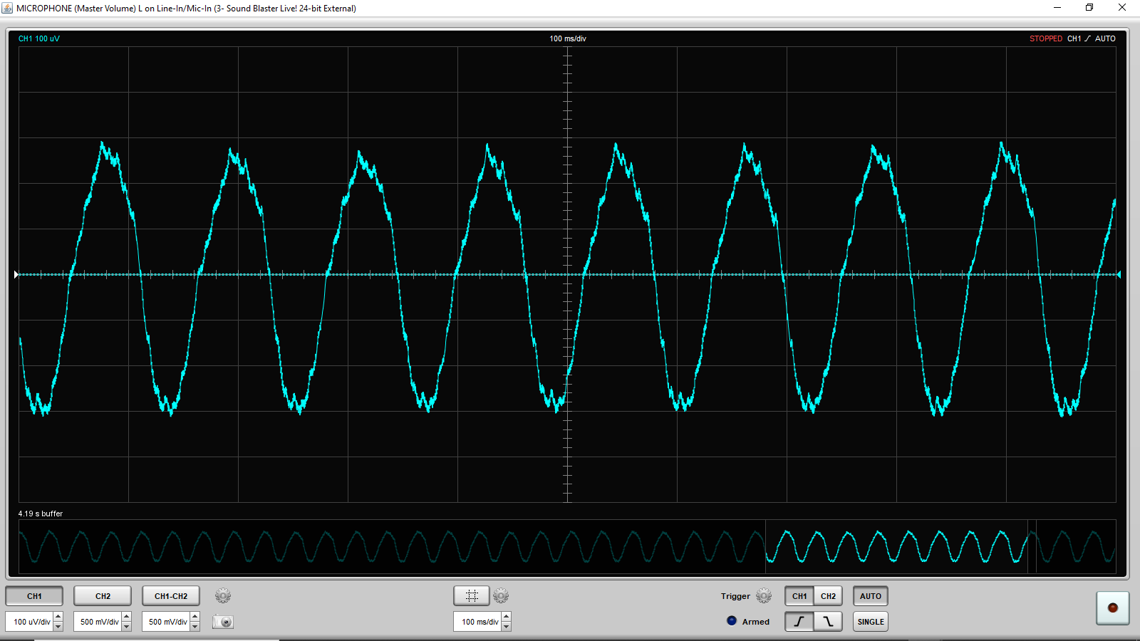

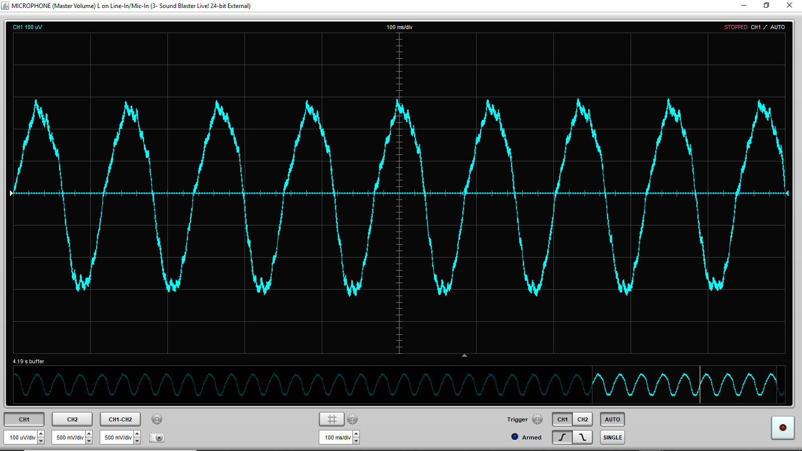

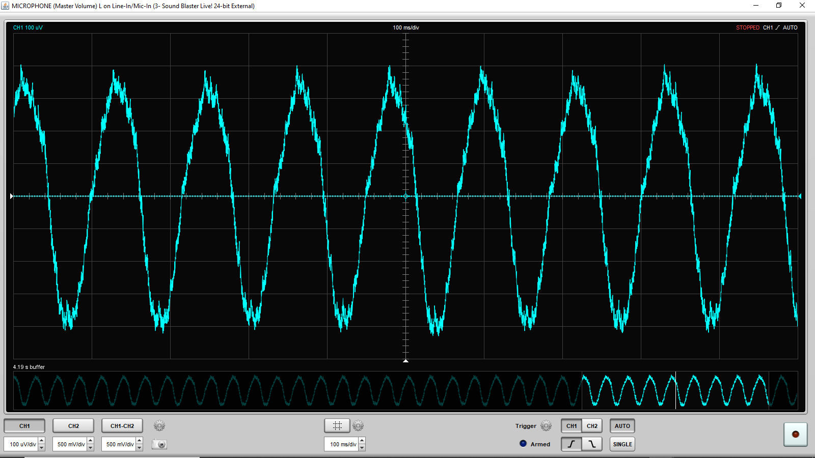

I added several more test points (100MHz Osc, ATTINY VCC and ES9038Q2M DVCC).
The noise is strongest on the ES9038Q2M DVCC so next I will try a modification to put that on a separate supply. (To get that noise off of the AVCC_R/L and VCCA.)
Please note, this is not 60Hz and has nothing to do with the input power or the measurement. It is 85Hz generated by the ES9038Q2M.
Attached, in order:
Attached, in order:
- AVCC_R: Locked to optical but idle.
- VCCA: Locked to optical but idle.
- DVCC: Locked to optical but idle.
- OSC (100MHz stock): Locked to optical but idle.
- ATTINY VCC: Locked to optical but idle.

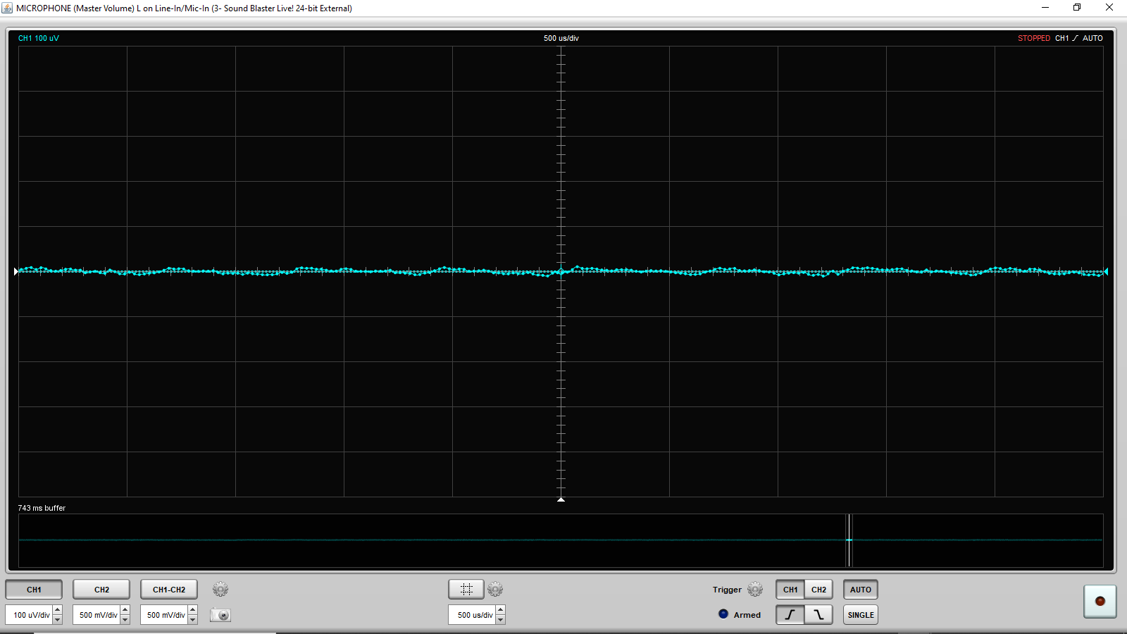

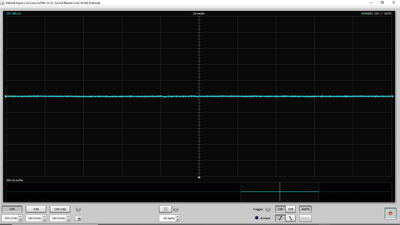

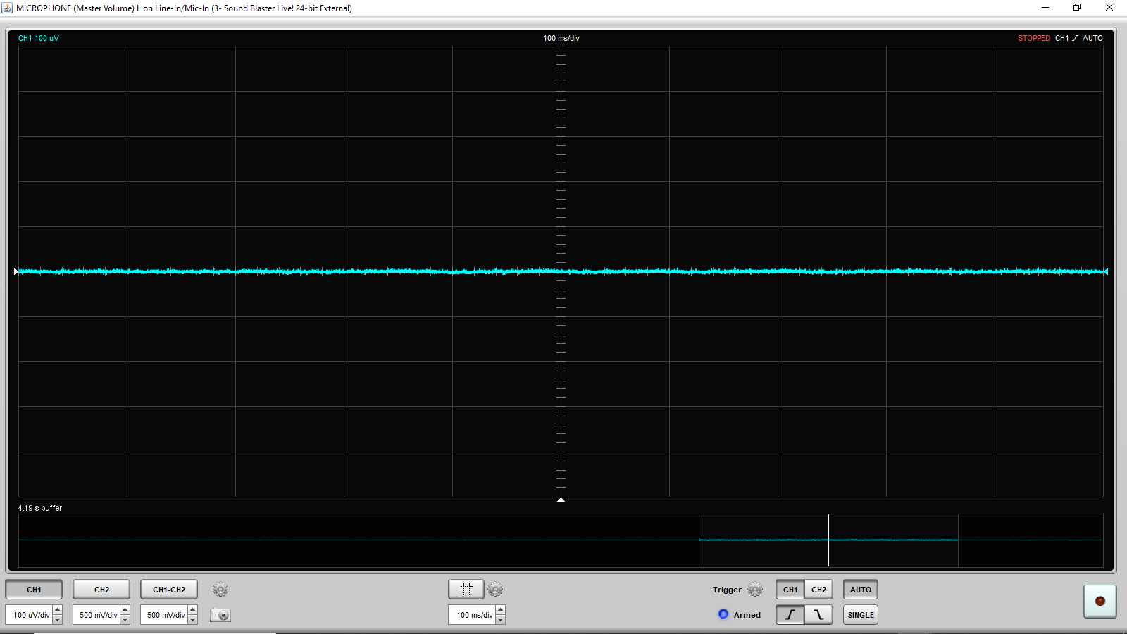

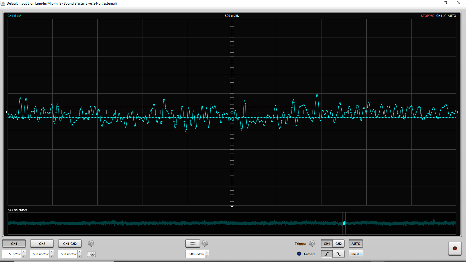

Ok. The ES9038Q2M DVCC is now running on the second of two batteries.
The noise is now vastly lower...
Attached, in order:
So now the DVCC noise is not getting all over the board. The separate supply for DVCC is attached (power and ground) to the Tantalum DVCC bypass on the top of the board. The ferrite bead for DVCC is removed to detach it from the 3.3V power buss on the PCB.
Attached, in order:
ATTINY VCC Idle Zoom Two Batteries DVDD Separate Battery Optical Locked.png53.7 KB · Views: 129
OSC 100MHz Idle Zoom Two Batteries DVDD Separate Battery Optical Locked.png52.1 KB · Views: 128
DVCC Idle Two Batteries DVDD Separate Battery Optical Locked.png117.5 KB · Views: 123
AVCC Idle Two Batteries DVDD Separate Battery Optical Locked.png46.9 KB · Views: 128
VCCA_R Idle Two Batteries DVDD Separate Battery Optical Locked.png47.2 KB · Views: 133

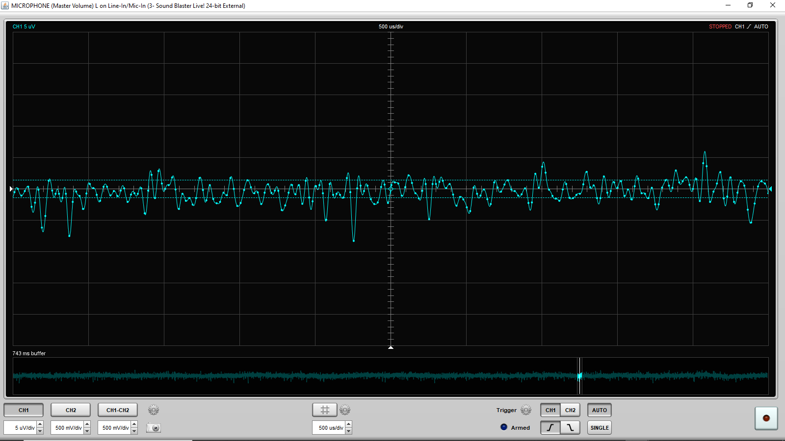

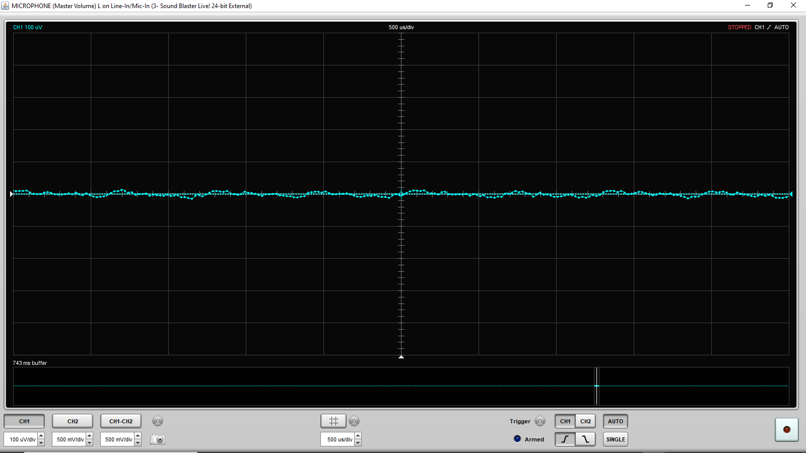

On a 5uV scale using a 60 dB LNA here is VCCA_R. First is locked to optical but idle and the second is with 1kHz full scale.
I would love to see such data posted from other approaches (such as op-amp buffer, specialized Ti or LT regulators, discrete regulators, discrete references, etc) to help inform my decisions on my modifications.

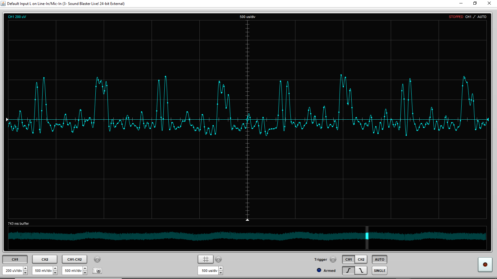

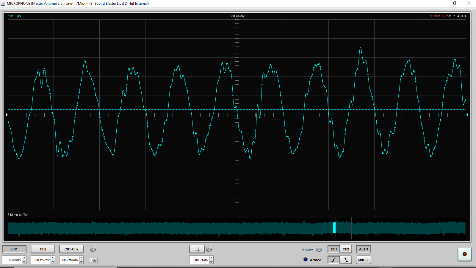

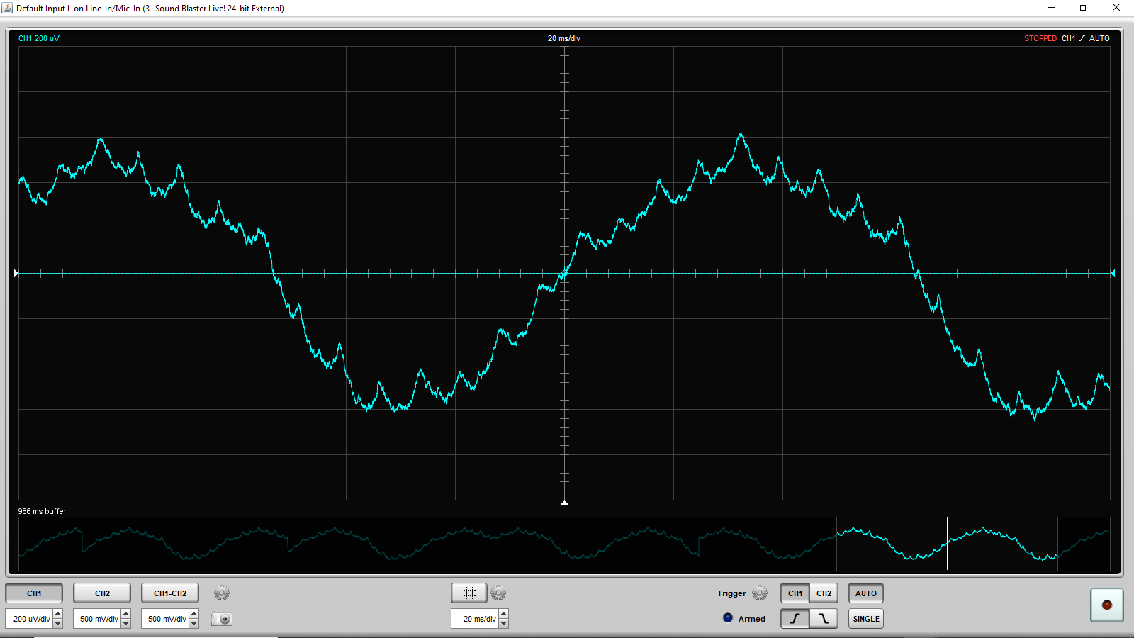

DVDD Experiments
Please note: These experiments are just for learning and gaining information.
It is not suggested that these are appropriate changes for others to make to their board.
DVDD is the output of an internal 1.2V LDO fed by the external 3.3V DVCC supply.
The purposes of the next experiments include trying to learn about:
Attached in order (without added 100uF Xicon):
Next post is with added 100uF Xicon.
1a. What sort of noise is on the DVDD?
1b. Is the largest noise component (the 85Hz seen on DVCC and VCCA) present on DVDD? Is that the source? Or is DVCC the source?
2. Does the observed DVDD noise signature appear on the other pins (DVCC, VCCA, AVCC)?
3. Does a DVDD bypass capacitor change noticeably change the noise seen on DVDD?
- DVDD
- DVDD (different timebase)
- DVCC
- VCCA
- AVCC_R (5uV scale)
AVCC_R 5uV All Battery Powered Optical Locked Time Base.png96 KB · Views: 255
