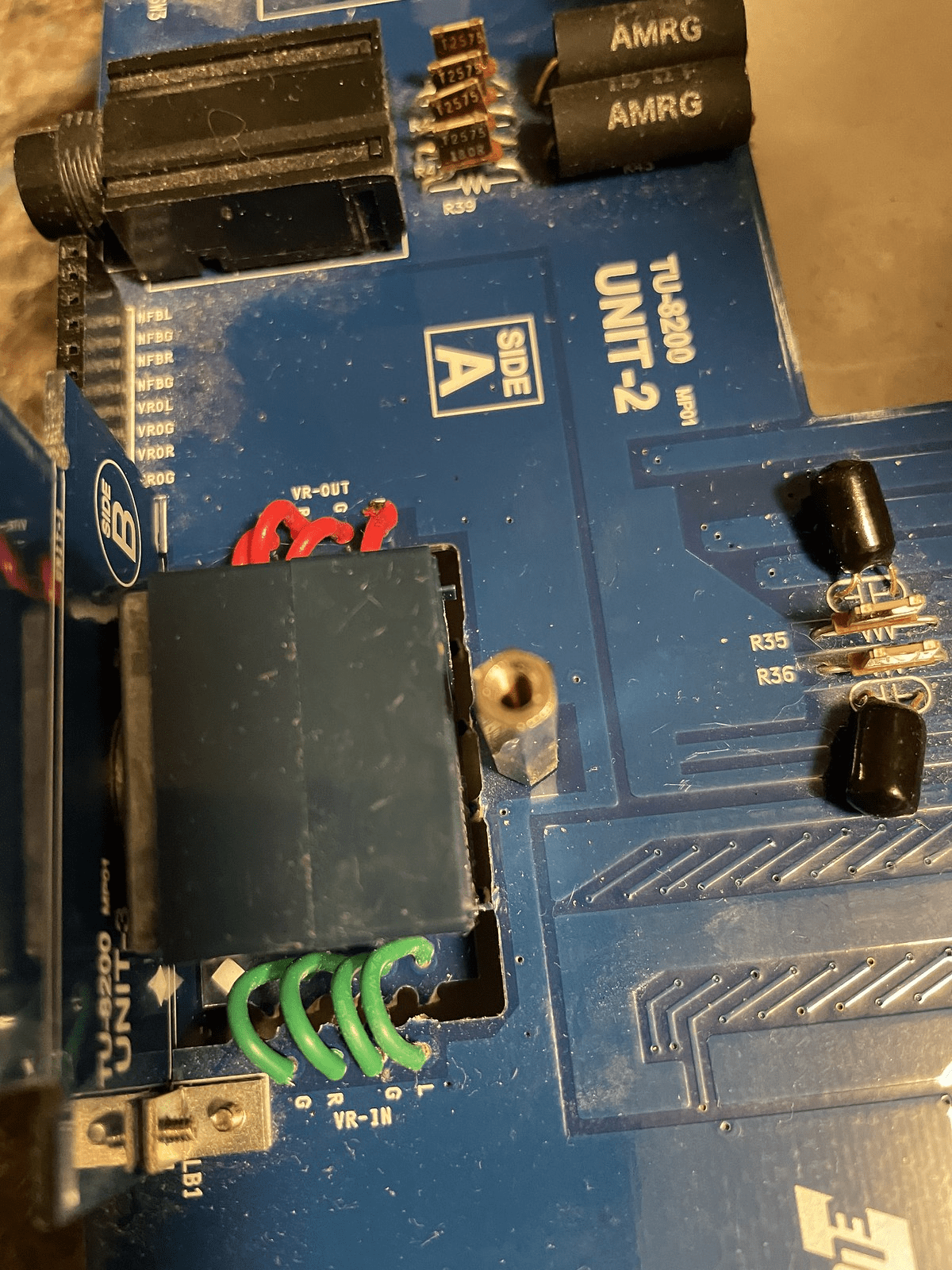

I am proud owner of tu8200r and i would like to upgrade sound on it. Many options so i wonder where to start..
I will go step by step first tubes then caps then if not satisfied at last opt lundahl. Concerning opts, they are 2/3 of price of all kit so i wonder is it worth of it? I would like to try first everything else before opt upgrade. Can anyone point me to right upgrade path. Thanx
I am aware that OPTs are biggest step in the upgrade path but also most expensive. I am pretty satisfied with stock amp but also curious is double better or just nuances. Maybe rather to invest in 8600. I tried at least 6 solid state amp in my sistem triple the price elekit beats them all in sound but not driveability or conectability, but i care only about the sound. I belive that for real solid hifi system no need to spend a fortune like these days... And most important is to have fun and gain some experince.
If you want to buy TU-8600, buy it with Lundahls for sure. But consider the price for better quality 300B tubes. A pair of Western Electric 300B will cost you the same as the TU-8600SVK amp.
I suspect the definition of subtle is relative to the observer. I can safely say that with my five Elekit amps (including the TU-8600), the largest improvement in sound quality was the Lundahl xformers. I haven't tried the high priced WE tubes, but I have rolled quite a few tubes in my other amps and I'd still give the nod to the Lundahls for most bang for the buck.
Thanx everyone. Conclusion is RK27 pot because channel inbalance, lundahls and i have some mundorfs in a draw, but they are EVO aluminium, is there so much diffrence with SUPREME SILVER/GOLD? Any experience on these will be nice to share with me..

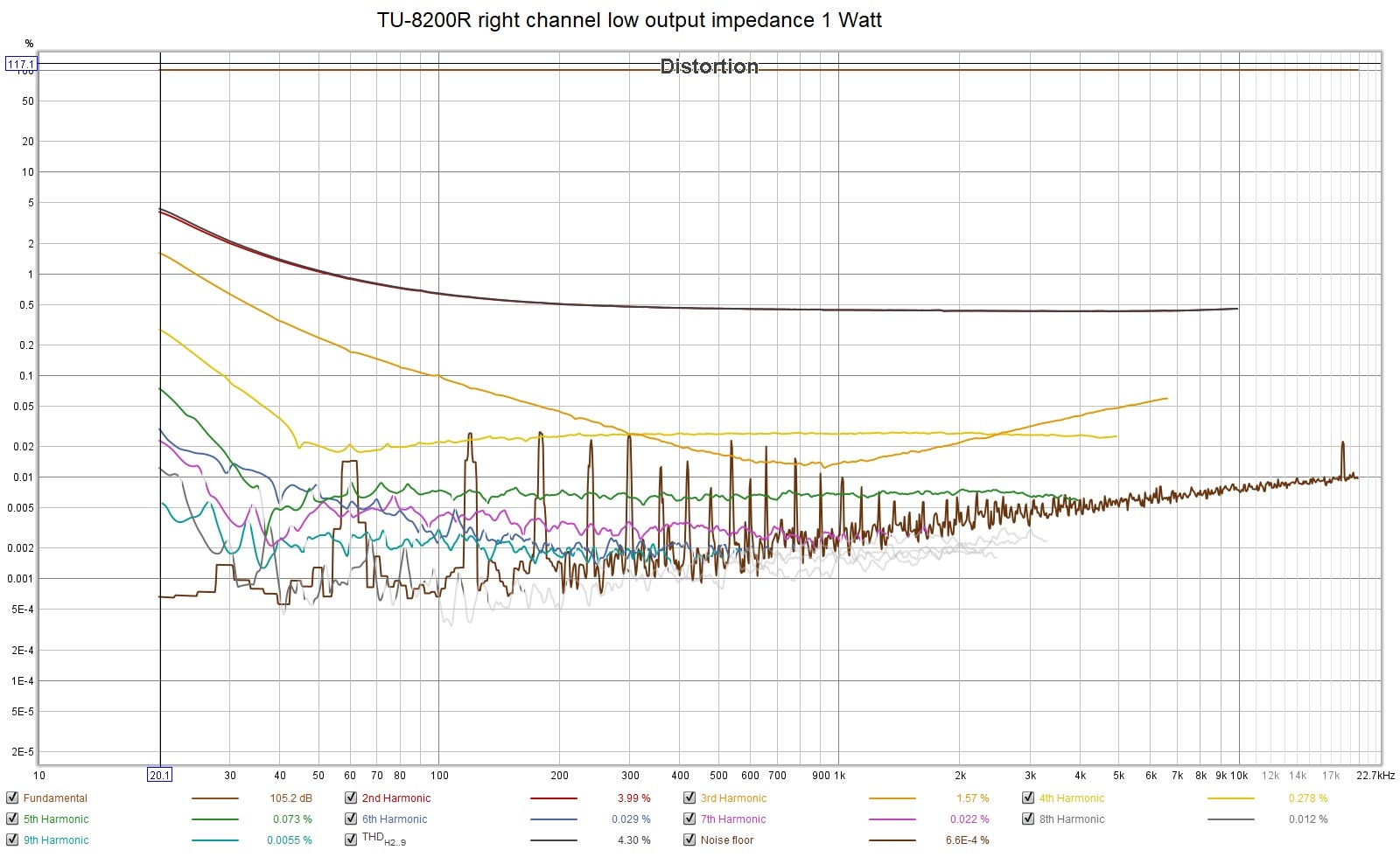

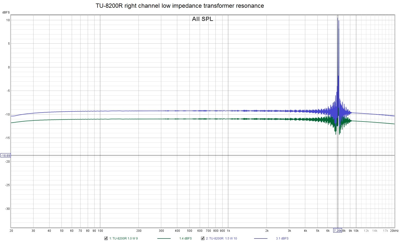

Hi did you ever find out if this issue with the output transformer resonance at 7.2k is due to a defective transformer? ie is it the same resonance for both Left and Right Channels? Also I wonder if this happens with the original stock transformers instead of the LLundahl. I am assuming the results posted are for the amp with LLundahls. ThanksThe 2nd harmonic suppression is present over the whole frequency range. 'Normal'/expected behavior at 1 Watt output power; the 2nd harmonic dominates THD:

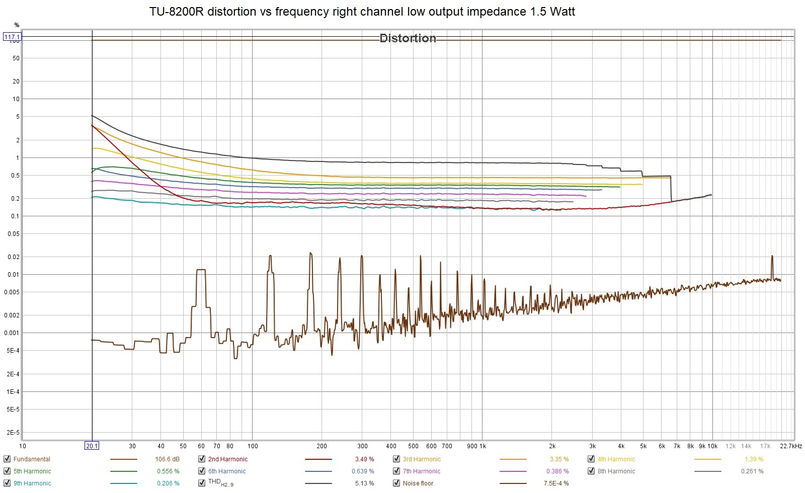

At 1.5 Watt, the 2nd is suppressed:
And here is the output level (voltage) as function of frequency; the resonant behavior is pretty obvious:

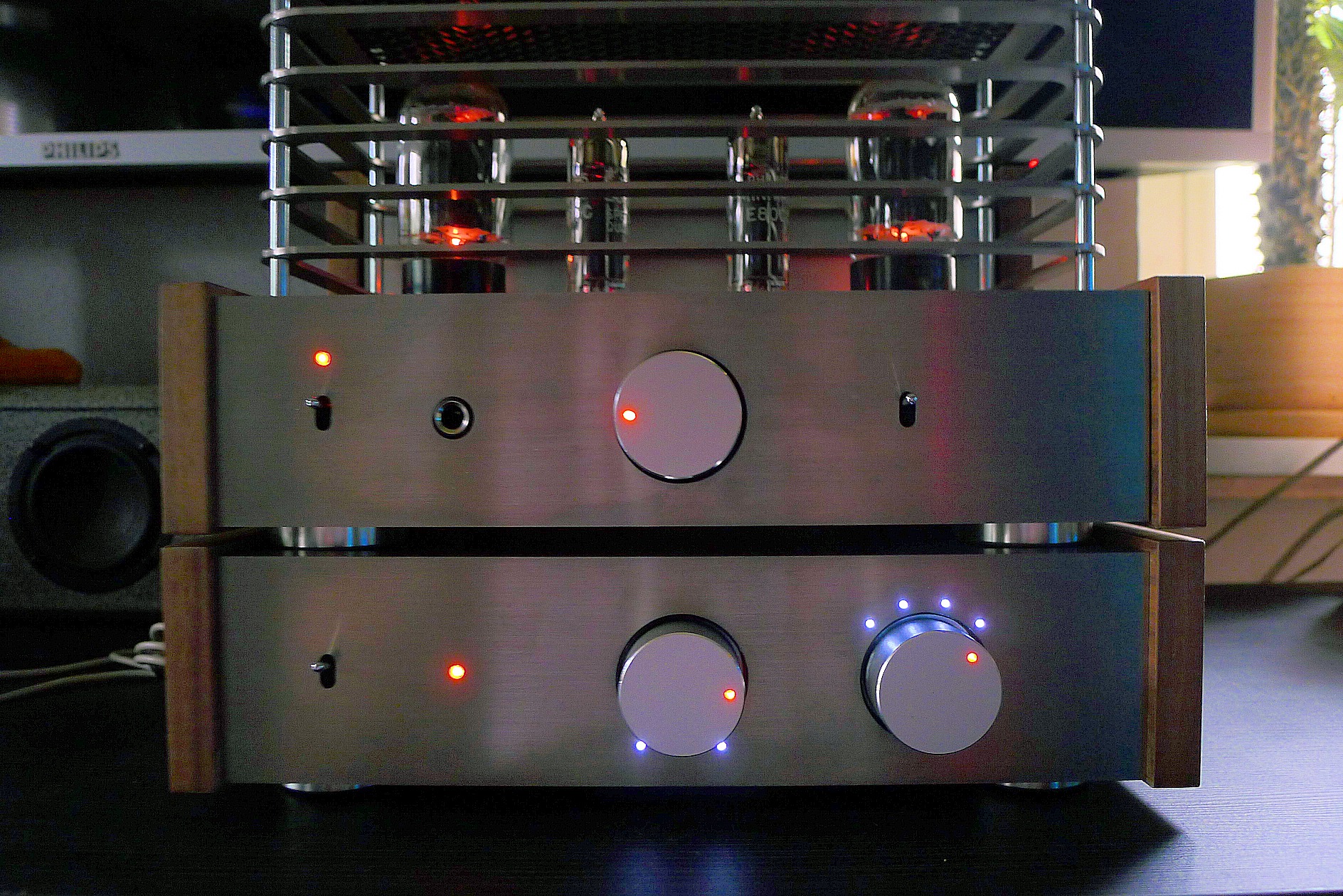

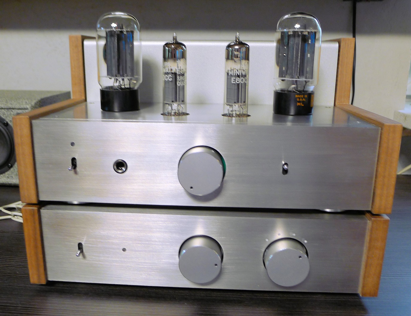

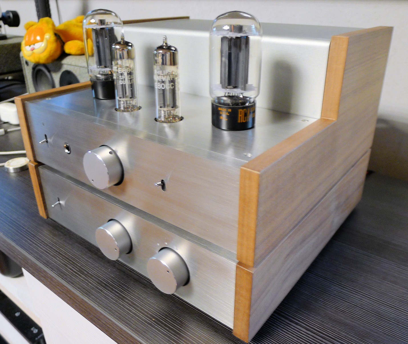

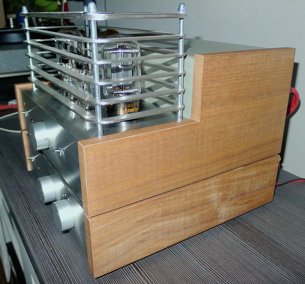

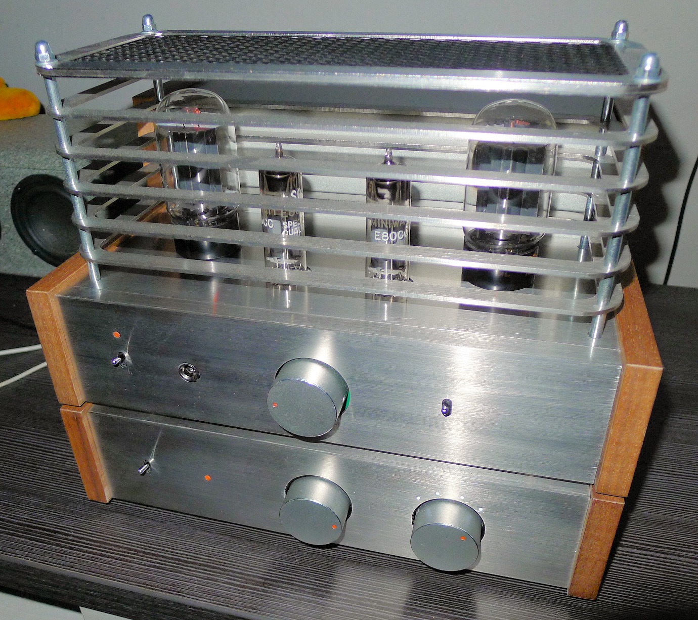

Oh how did you attach another led light to the control knobs? I would love that feature especially when finding the knob in the darkHi folks! Finally after three months of cutting, drilling, welding, soldering, tweaking I have finished my set including all possible mods and I feel a need to brag 😎
TU8500 - visual tuning (new stainless front, walnut veneer side panels, LED lights), coupling caps, opamps MUSES01, voltage regulators from Sparkos, RCA 12AU7 black plates inserted
TU8200R - visual tuning like TU8500 and tube cage, coupling caps, full upgrade by paczeltf (great many thanks for help once again), Lundahl onboard, Holy Grail 6L6GC RCA black plates side O getter 1950's and E80CC Philips Miniwatt SQ.
Guys, holy s**t - how it sounds now! The only drawback is the final cost. In Poland Elekit is more expensive than anywhere (bloody taxes) and set costs 1 600 USD. With full upgrade it reaches 2 850 USD 😢
And not only sounds, now it has the look 😁 I am rather miserable photographer, but, well, something is visible at least...
View attachment 1208481View attachment 1208482View attachment 1208484View attachment 1208485View attachment 1208486
