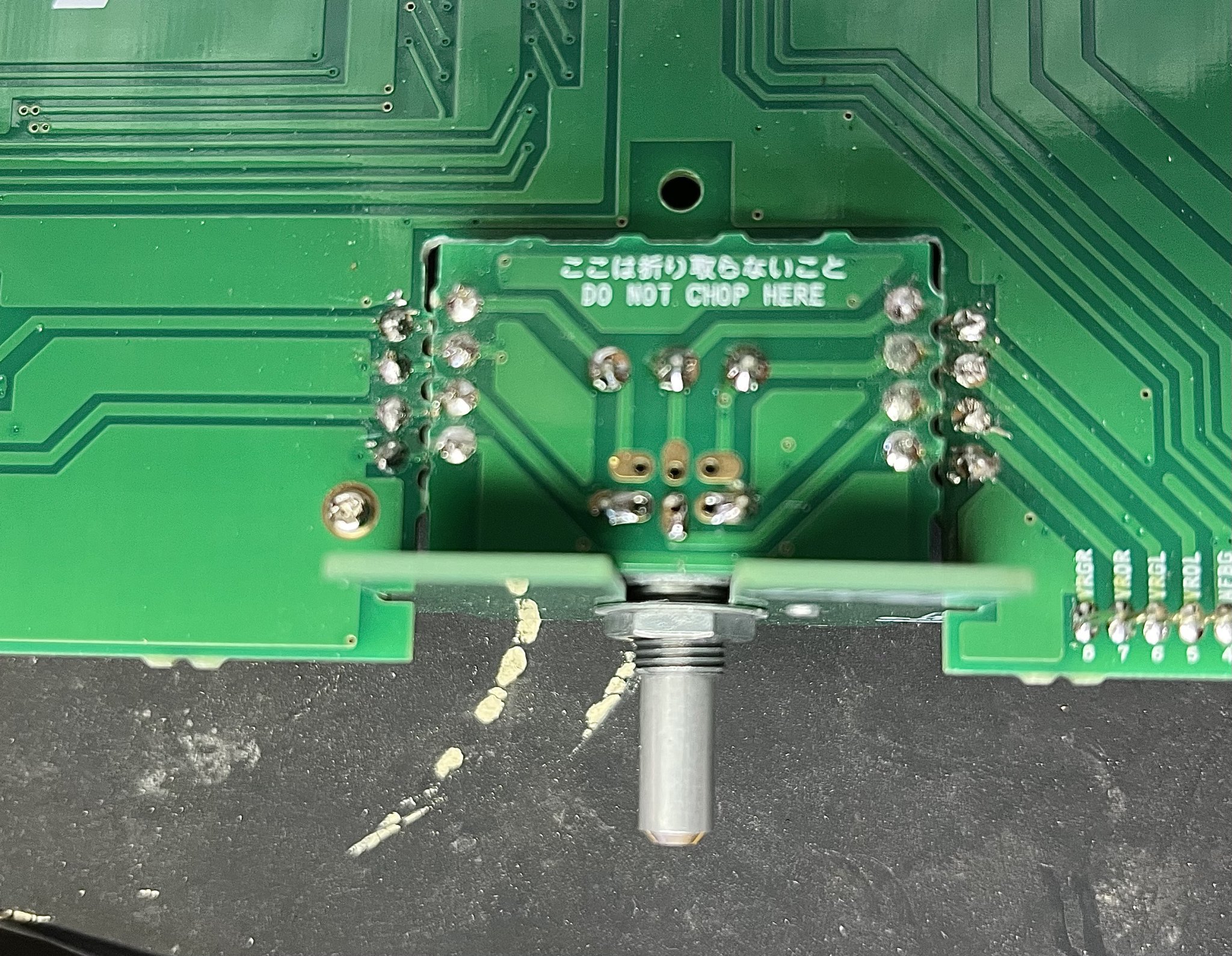

Folks, I’m concerned about this volume control, the upgrade Alps27 pot installed with the chopped PCB. I show continuity between all solder joints on the right side. The left side is fine. I’m afraid I’ve damaged the board when I separated it. Does anybody have anything to offer? Many thanks. Looking forward to finishing this kit.
